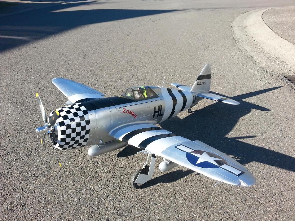

    Here's mine painted up as Zombie. Overall it looks good I think. I haven't put the stars and bars on the side aft fuselage yet because I am debating making those black invasion stripes wider. They came from Callie and they are not quite as wide as I hoped, and they are glossy where I would prefer flat or matte like the white. The reflective nature of the metallic silver paint I used turned out to really accentuate the foam cells which was a bummer. But overall it looks pretty good! What do you guys think? Should I paint wider black invasion stripes or keep as is?

      Looks great Aros! I do vote for the wider stripes though, looks too nice to neglect that detail. As for the motor mounting, everything is covered in post #235 on the previous page. Basically just opened up the cowl a bit and had to redrill some of the X mount holes. I used a 125A gecko ESC for this combo as well.

        Thanks! I'll check that out. Yeah I am going to definitely paint the black stripes on. It's a lot more masking and painting but it will look a lot better.

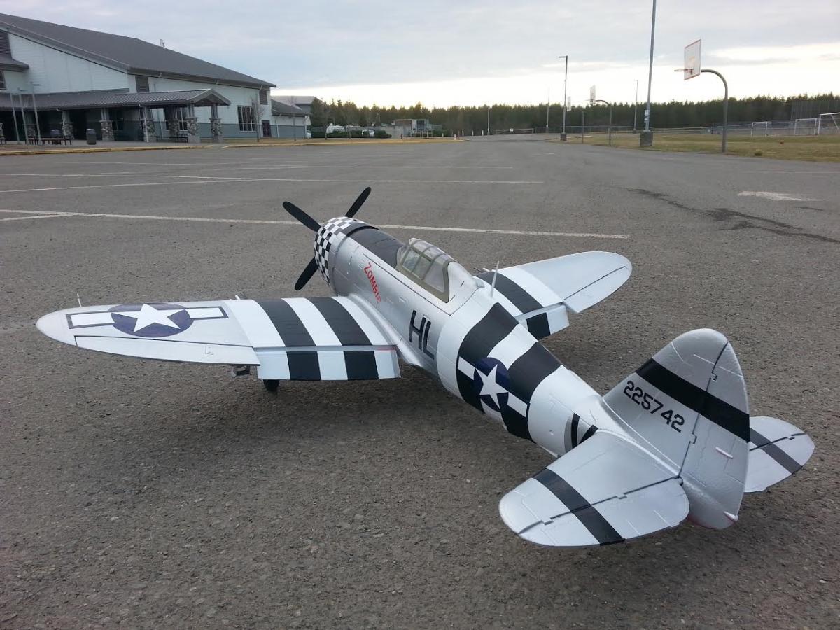

              I removed the glossy black stripe decals, masked off and hit it with flat black in a rattle can. MUCH better! Took her out and flew her...Got her trimmed in and flying on rails. She looks like a million bucks on a fly by with this livery!! Came in for a 2 wheel greaser only for the wheel to go flying off again! So my E clip replacement didn't hold either, even though I hit it with some CA for insurance. So I popped another one on tonight and this time I gave it some dabs of epoxy. If THAT doesn't hold the dang clip I am at a loss.
              Finished up the fine detail paint work tonight including getting the white and black invasion stripes aligned in the flap gaps (the photo below was taken before I did the final detail work) so it looks seamless with flaps deployed. It's the little scale details that rows my boat, lol.

                That P-47 is BEAUTIFUL with no freakin wheels.....;):D
                Did you use old style price tag stickers for your masking on the checkerboard area?

                  Looks beautiful! Totally agree that the flat black looks much better. Looking forward to the reports on how the 550kv works out as well. Would definitely be better for balance, since with my setup the battery has to be secured aft of the sliding tray for proper CG

                    Nice looking livery Aros :cool:. How difficult was the factory decal scheme to remove?

                      Thanks fellas!
                      TomC - I painted the cowl white and had Callie send me the black checkerboard decals. Two sheets, 1 for each side of the cowl. Made the process go so much quicker.
                      OV10 - I painted over most the original decals. I have a 400 policy. If the model costs more than $400 I remove all the stock decals before painting a new livery. Anything under $400, I paint over (most) of them, lol. :)
                      The one thing I really wish FMS would improve is the density of their foam. I get that this is a light foam which keeps the model itself light (It looks so heavy until you pick it up) for better performance with their stock setup but it's easy to make dents and impressions unintentionally. The foam cells are as prevalent as ever as well. The white and black invasion stripes helped hide a lot of that but the silver was really revealing, and not in a good way. Still, I shouldn't complain because the end result turned out as good as I could have expected. Has that composite look from 10 feet away.

                        Looks fantastic Aros. I wouldn't worry about the invasion stripes in the flap gap. The didn't paint inside the "gap" on the real aircraft.

                          Thanks Beeg! I've seen warbirds that did have the gap painted as well...Perhaps they were contemporary models never in battle? Either way it sure looks cool. ;)

                            Looks great Aros! I hear what you're saying about the FMS foam. You can feel the difference right away if you're used to Freewing or FlightLine. What did originally on BBD and every other airplane, is to coat them with at least three coats of Varathane or Minwax in the case of my earlier birds. I think BBD has five coats, but she feels a tough as nails. You can work it into the foam cells to fill the micro gaps and then paint over the whole thing with whatever color you want. There are some great silver acrylics out there, we have a paint code section in the painting tips and tricks section. In the case of my RocHobby Waco, the cells still show so I got out my jug of white acrylic house paint and repainted all the white areas. Good bye foam cells. The beauty of anything water based is that you're not really adding much weight after the water dries. Worth a try.

                              Good to know Grossman, I am always looking for new tips and tricks for painting/hiding foam cells. I laid down a couple coats of water-based Polycrylic to seal the foam before painting thinking that would help but the enamel metallic silver I chose really caused the cells to rise a bit, like being exposed to the Sun for a few minutes too long. The day these foam birds no longer show a single cell imprint will be a day of rejoice for sure.
