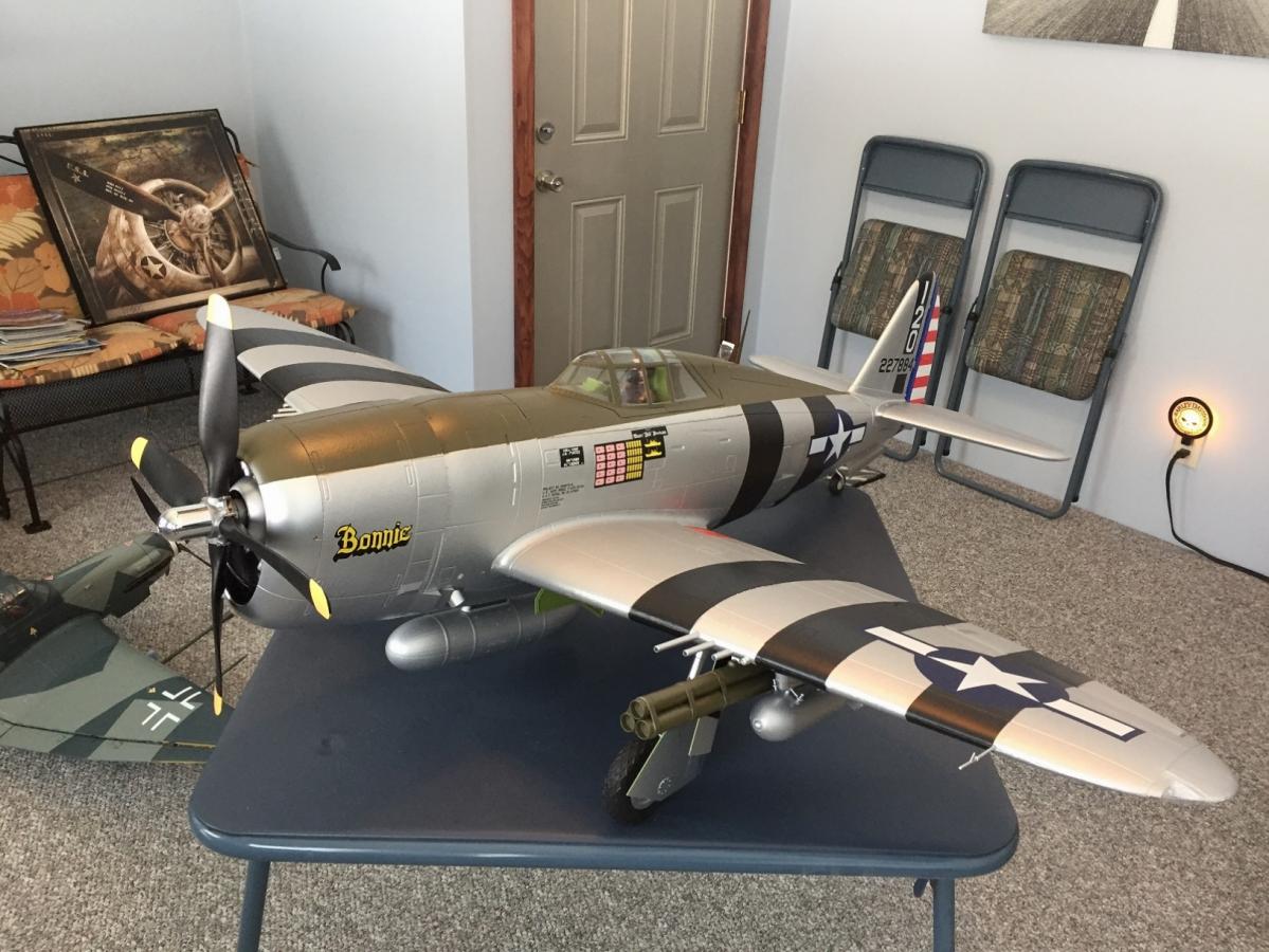

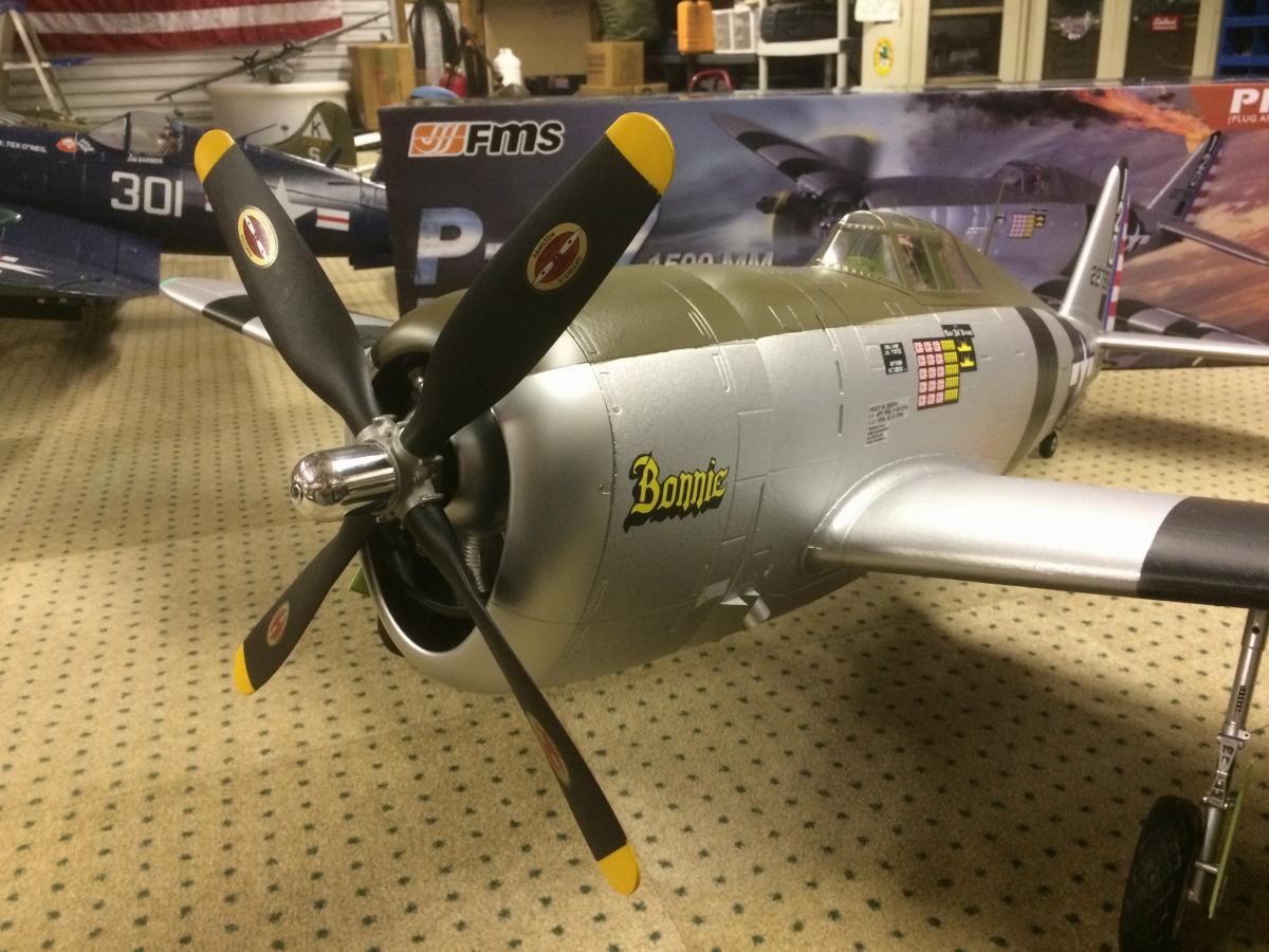

      #282
      I told you :) ...now paint that hub.
            That got done after I got the numbers posted :cool: and I think I told you about the 550 and you followed!! :D

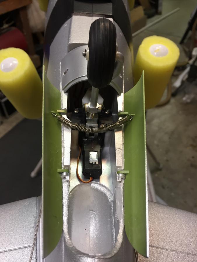

                                    Finished getting it together this morning. I did a spring mod to the tail gear doors. Couldn't find on this forum or the other if any owners had any complaints about the stock closing springs but is was basically a crap arrangement so I used a similar setup that FL used on the Tigercat and it is a much better operation with no more doors flapping when the tail gear is turned!! I also attached the bomb pylons with neodynium magnets cause I just like my armament removable. I also used some slit pushrod tube over the wing bolts to minimize the slop that has been noted on the wing movement and I also made the wing connector on the fuselage side moveable by not having it hard point mounted(removed screws). Like everyone else that has basically remarked about the softer texture and lighter weight of this airframe, I'm in the same boat as those that are not excited about how easily it dents up but at the price I snagged this am not gonna whine too loud. Hope FMS goes back to the texture of the P-40B foam but if they don't I'm not gonna get all bent out of shape(like the foam) about it cause FlightLine is taking over the show now.
                                    Now am just waiting for this :Poo: weather of upstate NY to go away. :Crying2:
                                          Click image for larger version Name:	IMG_0552.JPG Views:	1 Size:	63.9 KB ID:	60782Click image for larger version Name:	IMG_0553.JPG Views:	1 Size:	144.6 KB ID:	60783
                                          This spring mod works great for the FMS 1500mm P-47D. The original setup by FMS was a joke. I've been flying my plane with this mod since early December last year, it works flawlessly!
