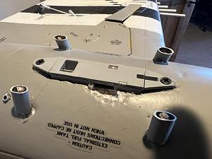

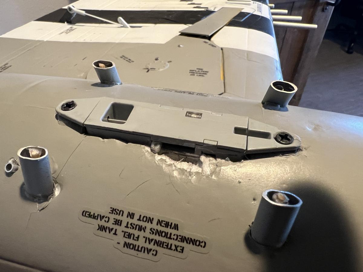

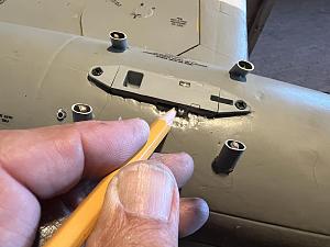

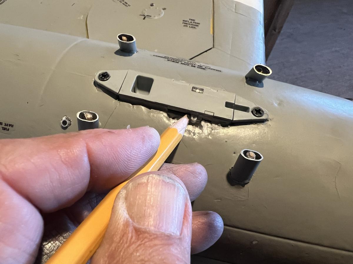

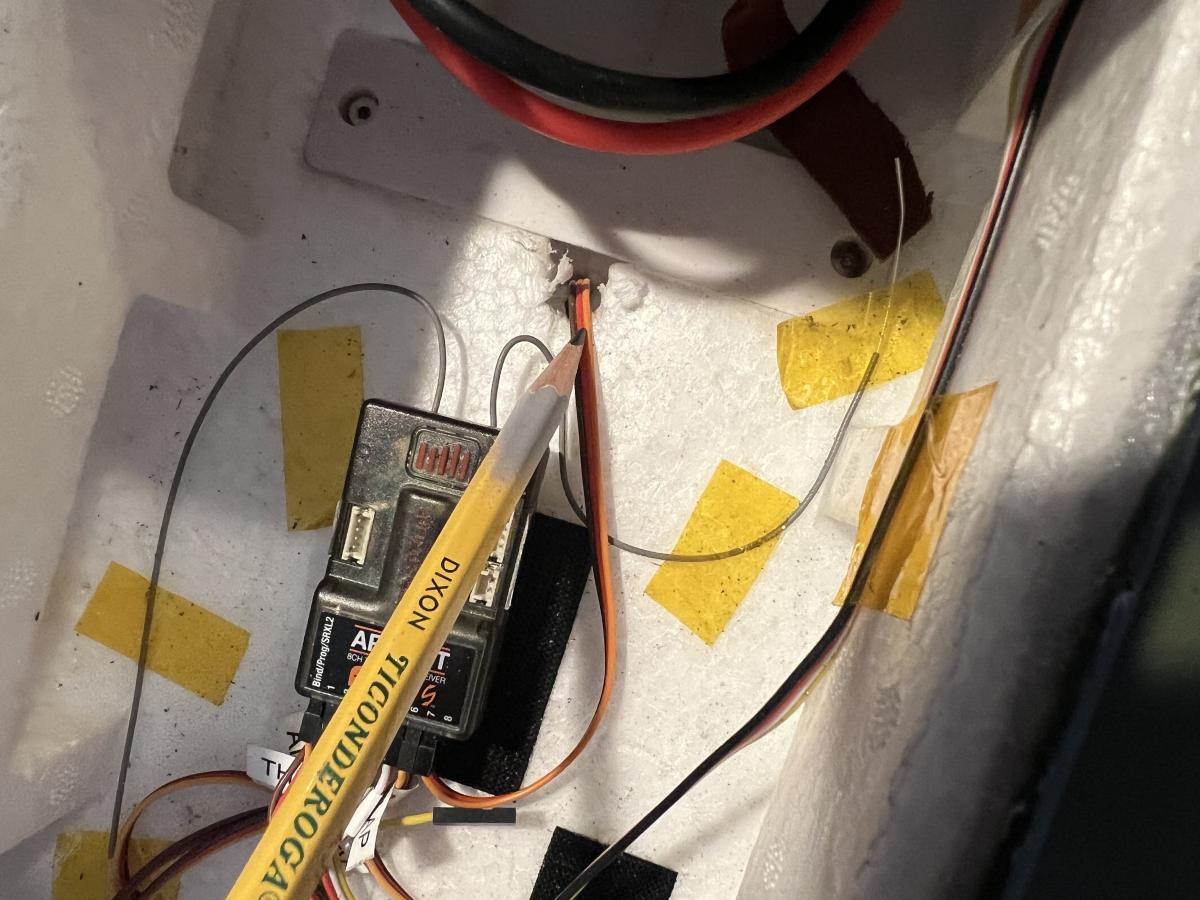

                                      I received my e-flite payload release today. If you could take some pictures of your installation, I will have a better idea how to install. how did you make clearance for the manual release or do you just use the radio to open/close.
                                      Best Regards, Rex
                                        • Nov 2013
                                        • 2776
                                        • Cody, WY
                                        #2300
                                        Originally posted by jetfool
                                        Davegee,
                                        Best Regards, Rex
                                        Hi Rex: It was pretty much straightforward process. I mounted the bomb drop in the area where the OEM drop tank holder was in place. Just carefully remove it and throw it away or whatever. Then, I carefully inserted an awl or some sharp instrument straight down (airplane upside down in cradle) until it pokes through the foam floor of the cockpit. Now you have a general area to where you want to dig into the model's fuselage and snake the wire into the cockpit and attach it to the receiver. On mine, I used channel 7 and assigned the pushbutton "I" also the bind button on the DX18. Carefully cut a rectangle through the foam that is just big enough to snugly fit the bomb drop mechanism. I don't remember how I fastened it in, I think it comes with a couple of wood screws, and maybe I glued a couple of wood pieces to screw into, whatever you want to do with that.
                                        There is a manual release/loading switch on the side of the mount. ( You can alternatively try pushing the drop switch and that will cycle the pin back and forth if you can get in there quick enough to put your bomb mount in. That's hard to do and I usually don't try it, just do it manually.)You can see I had to dig out a little more foam to be sure I could move that lever to open the alley to put your drop tank in. That is usually best using some sort of tool like a pen, or some long skinny piece of steel like a hex wrench to hold the spring loaded pin in the open position. While holding that open, you can carefully put your tank that you glued or screwed the holding mechanism for the tank and then you can release the slide switch and the pin should engage through the hole n your mount that is attached to your tank and keep it in place. Sometimes you have to fiddle with it a bit to get it to engage. Once that is done, you are ready to fly and your assigned switch whatever you chose, can be activated to release the tank and it will spin to the ground, probably undamaged since it is so light.
                                        I'll attach a few pics I just took for orientation. They are of my P-47 Hairless Joe. I have dropped a lot of tanks with it and it is always flawless. We also made a larger 150 gallon flat tank and it flies great with it and drops just as well, withou damage, although it is much heavier than the foam tanks..
                                        Let me know how it goes and if you have any questions.
                                        Have fun!!!
                                        Cheers
                                        Dave
