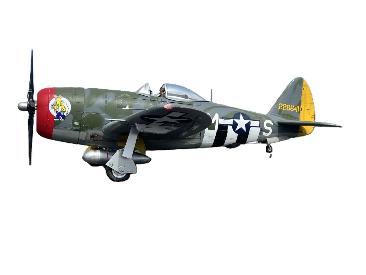

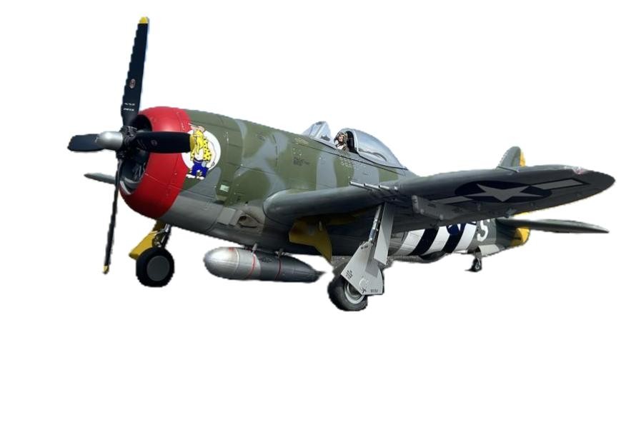

      I've eliminated the background, but darned if I can figure out how to layer it on a new background!
      Have a try!

        Very Cool! You're halfway there! The guy who I wrote about to you who did the Robert Redford photo in his 1920s flying togs and then transposed him to our picture of a rc model of his Jenny The Great Waldo Pepper looked totally believable. Unfortunately, he passed away years ago but I bet someone out there has done this kind of transposing before and we'll be able to figure it out.

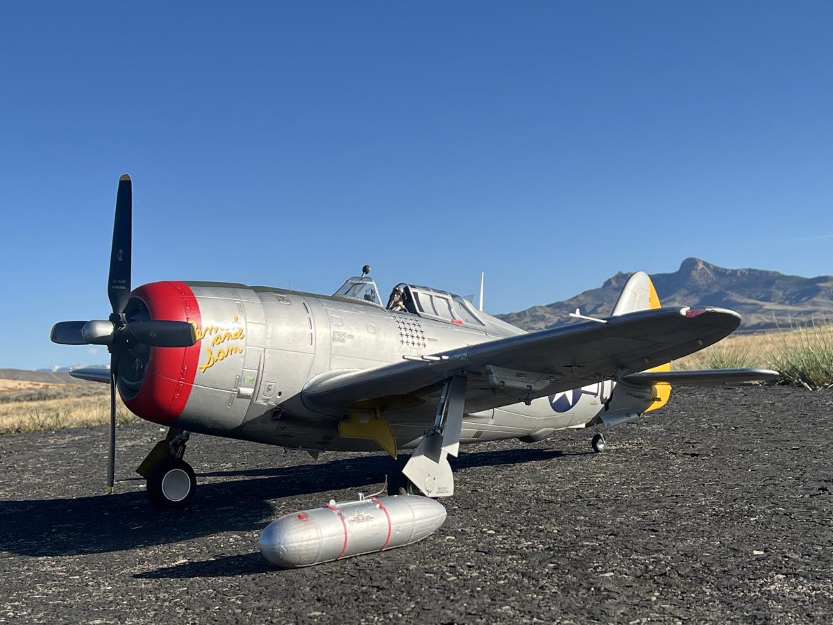

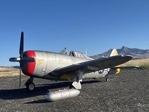

            Flew Penrod and Sam again this morning, got three flights on it to further test Expo and rates. I fly in mid-rates with 50% Expo, which works fine in light winds. Low rates is backed off a little from mid figures, I prefer flying mid rates for now. When I'm on the ground, I switch to high rates, especially for any sharp turns I need to do while taxiing. I'm going to stay with these rates for the moment. Next week. I'll fly my other two P-47s, Ol' Cock, and Hairless Joe.
            I also did a drop tank release, the 7th one to date on three different P-47s that I have. Flawless service, the E Flite release mechanism is great. Danger Dan and I are working on refining a 3D printed scratchbuilt scale rectangular 150 gallon drop tank and will have a company print it up. We did have a V1 version made as a basis to advance designs from. This one will be lighter weight and hopefully be ready to do test drops in the next several weeks. It would use the same drop mechanism that I am presently testing (E Flite) and should expect similar results, hopefully.
            A pic from today's flying. I have 78 flights on Penrod and Sam now.
            Cheers
            davegee
            Click image for larger version  Name:	IMG_3667.jpg Views:	0 Size:	141.9 KB ID:	448612

              Great News, Dave. Penrod & Sam looks great. Finally nice enough weather that we could fly. Today winds are back up. UGH!

                Thanks, Rex. I have been fighting winds all spring! Sometimes I just say, "to hell with it, I'll at least go out to the field and See if I can possibly fly, despite the discouraging wind reports". More often than not on those occasions, I get skunked. But the best chances for me is to get up very early, which isn't hard this time of year when the sun starts coming out before 6 am and the dogs are barking to get fed and out for their morning walks. I left before 7 am this morning and it worked out great. Would NOT have worked out if I had waited, as the winds did rise to unacceptable levels.

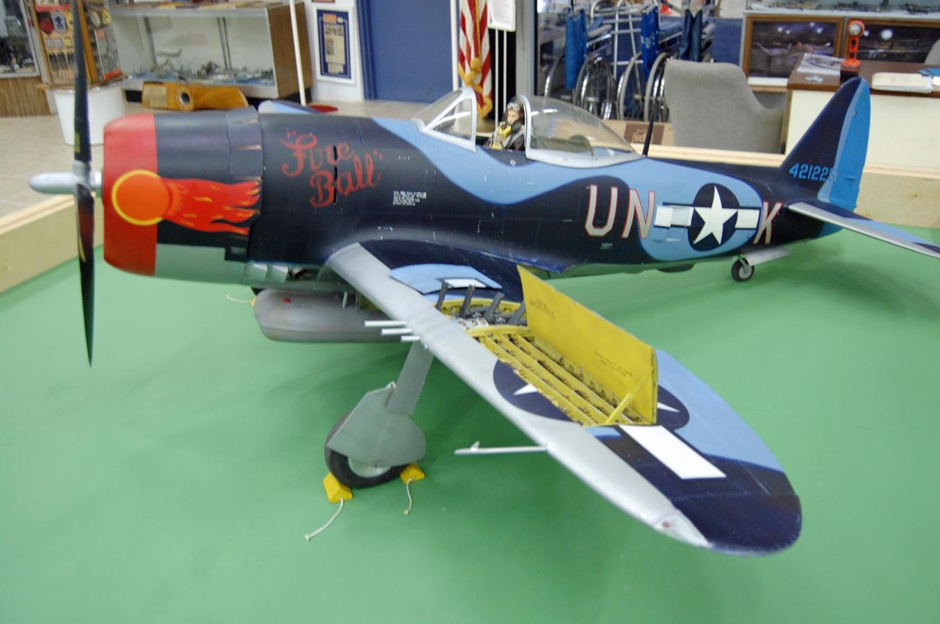

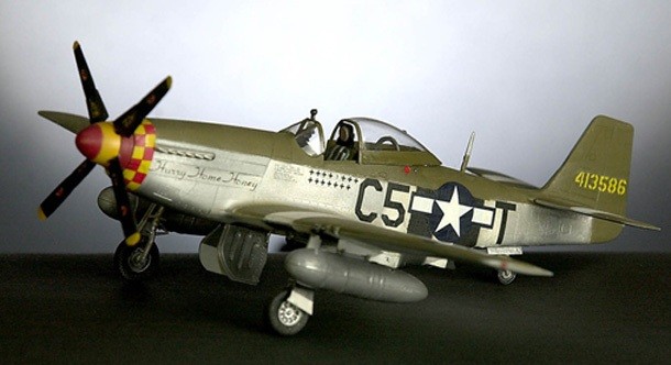

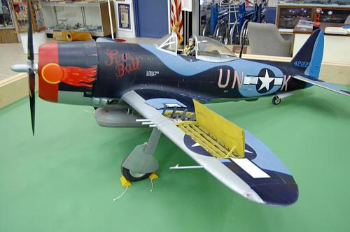

                    Thanks, Rex: Looking forward to finishing and flying the rectangular tank in the next several weeks. We built and competed using a scale rectangular tank with Fire Ball, the plane you have seen on display at the Warbirds Museum in Florida. This model was substantially bigger than the foamies I'm flying now but the tank drop was one of the features displayed during our competitions at Scale Masters and Top Gun many years ago. I hope we can get it light enough to fly from the original prototype printed out of PLA which is fairly heavy. But always an interesting challenge and learning experience doing new things.

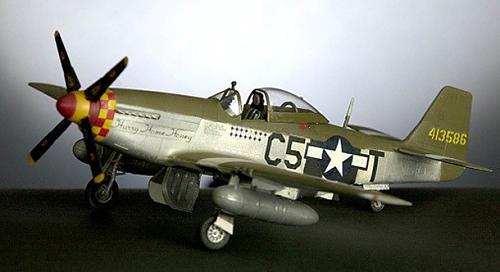

                    I'll attach a pic of Fire Ball at the museum in its case, and a plastic model of Hurry Home Honey,one of the iterations I might use for my new idea for the Flightline 1600mm P-51D. Getting some books on the 357th FG to get more ideas, especially if I pull the trigger and buy that new plane.

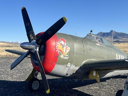

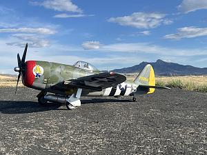

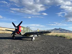

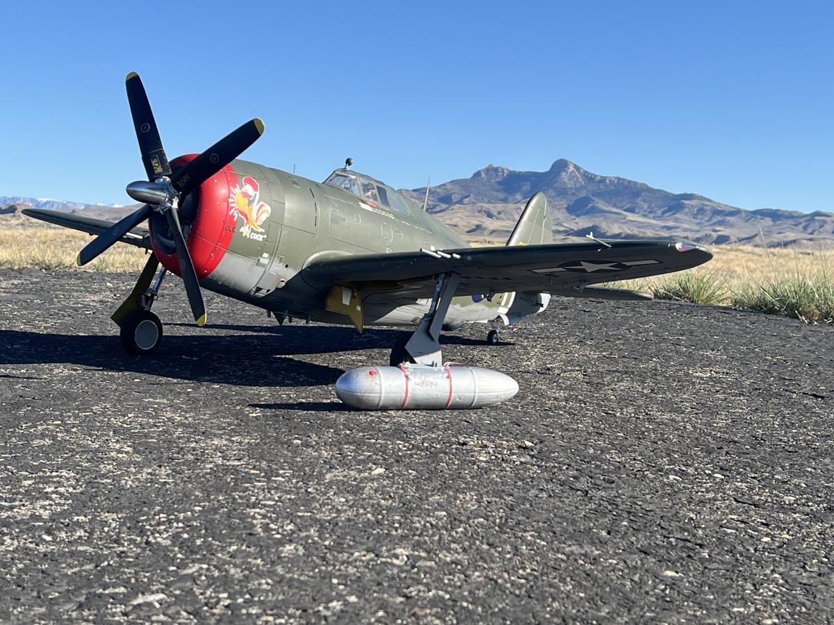

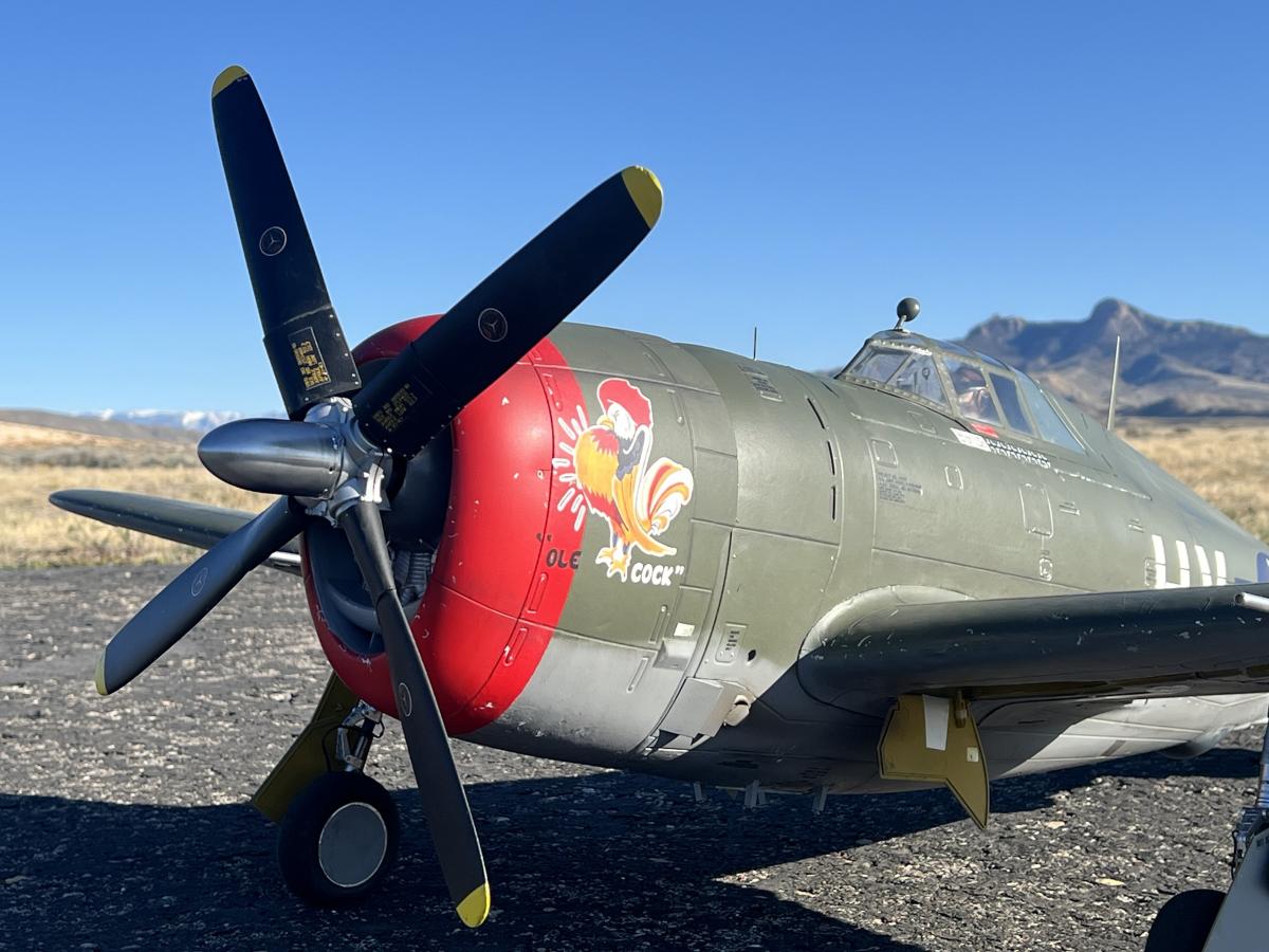

                          Got three flights on my FMS P-47D Ole' Cock this morning. Did a drop test of the foam drop tank on the centerline store, worked perfectly, as usual. That's now 8 different drop tests on 3 different P-47s, and am looking forward to getting the stl file for the rectangular drop tank printed by a company to test on Hairless Joe when it gets finished and sent back to me.
                          I'm getting a good test drive of some changed settings for flight controls and Expo, and I think they're coming along pretty well so far. More testing to go before I make decisions on final settings for these airplanes.
                          Got my Freewing F9F Cougar up for another flight, what a great airplane! Over 50 flights on that airplane now.
                          Attached are some pics of Ole' Cock after its flights this morning.
                          Click image for larger version  Name:	IMG_3677.jpg Views:	5 Size:	130.8 KB ID:	448751 Click image for larger version  Name:	IMG_3676.jpg Views:	5 Size:	215.5 KB ID:	448752

                            Fantastic photo's

                              Thanks, Rex. It's flying great! I hope to take Hairless Joe up for a couple flights tomorrow morning before a dreaded dentist appointment!

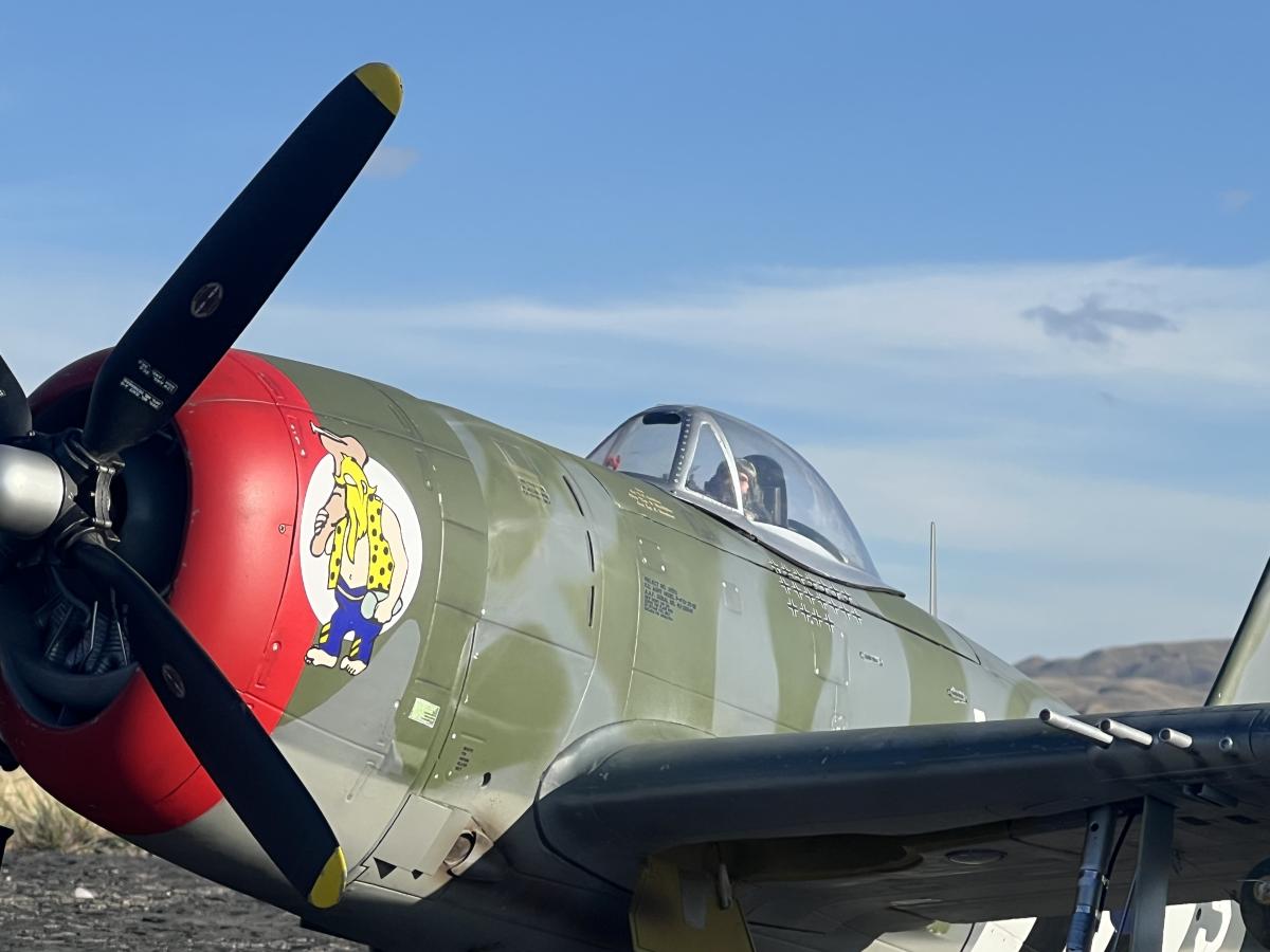

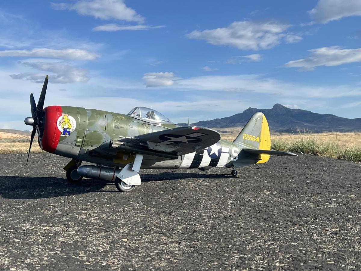

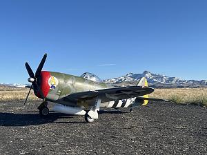

                                Took Hairless Joe out to the field again this morning before the winds picked up. Did testing of drop tank, flying with simulated bombs on the wings, M10 rocket launchers, etc. All went well. I'll post some pics below.
                                Cheers
                                Davegee
                                Click image for larger version  Name:	IMG_3686 (1).jpg Views:	0 Size:	85.6 KB ID:	448806 Click image for larger version  Name:	IMG_3685.jpg Views:	0 Size:	174.0 KB ID:	448807 Click image for larger version  Name:	IMG_3690.jpg Views:	0 Size:	191.0 KB ID:	448810

                                  Beautiful machine Dave, all that work had paid off in a wonderful model! I'm definitely tempted to do one of these conversions. I've got a spare fuselage from my old crashed Snafu, might be worth experimenting on. I just know that the second I start cutting, flightline will announce a new 1600mm version, lol.

                                    I know what you mean, F106DD! At the moment, I think this 1500mm Foamie is the only one of its kind existing as a converted bubbletop. These FMS 1.5m P-47s fly great, very solid performers. I bought my first one when they were new in 2016. Danger Dan and I will be working on the scale 150 gallon drop tank and hopefully fly it this summer in drop tests. I'm satisfied with the original goals i had for this plane to make a coverted bubbletop D-25 model of Col. Dave Schilling's Hairless Joe in WWII. The canopy turned out pretty well, although it could stand being a little thicker clear plastic for the canopy/windscreen. But it looks cool to be able to have a powered canopy like what the -25 models were equipped with coming off the assembly line in 1944. I found that converting to a bubbletop didn't hurt its flying performance at all from the original razorback.
                                    Always appreciate seeing your magnificent models. I think we are birds of a feather in that common interest of scale and detailing. I'm already looking at buying the 1.6M Flightline P-51D and doing a little outfitting of some scale details.

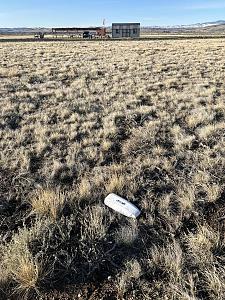

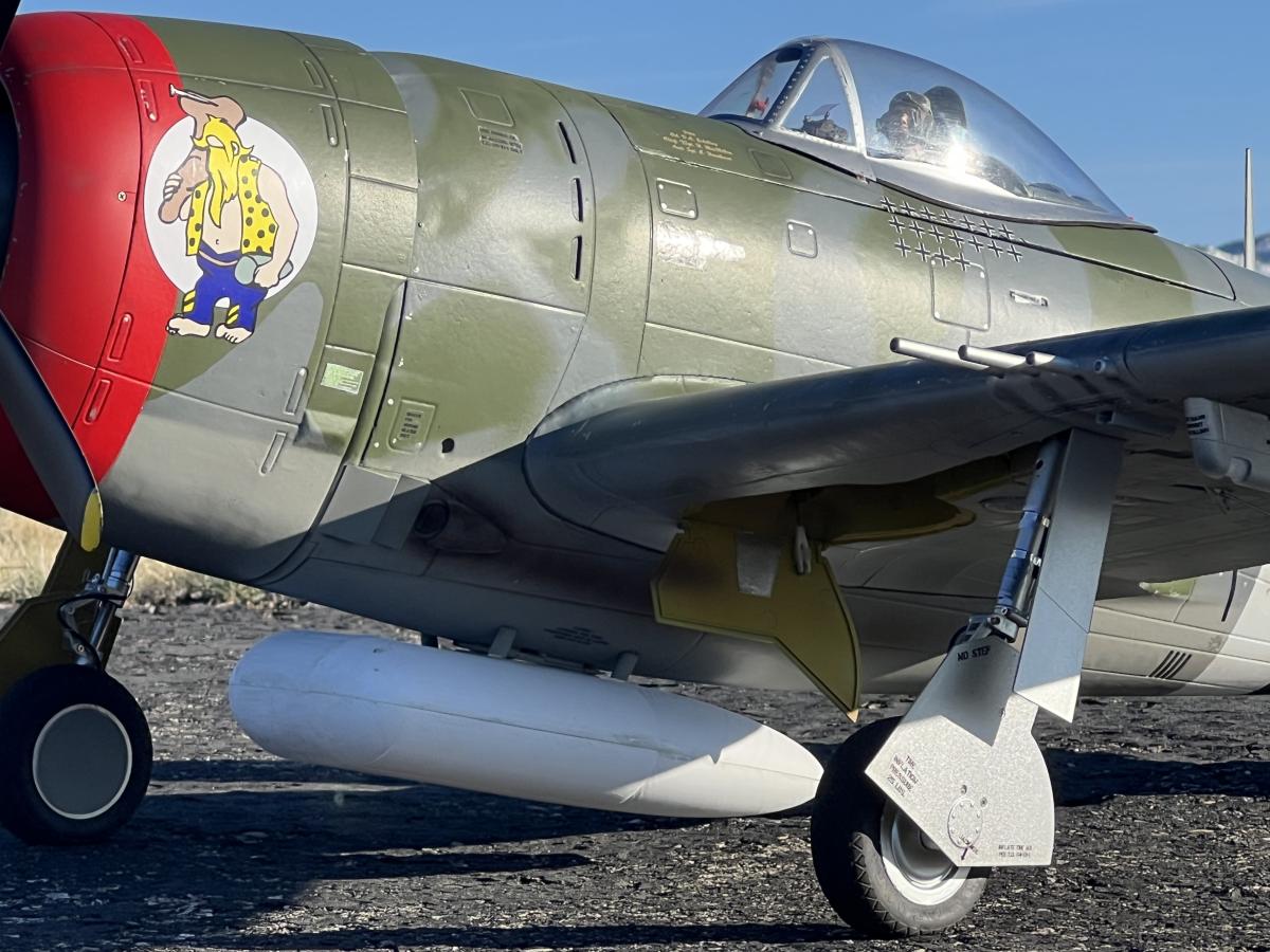

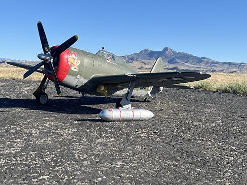

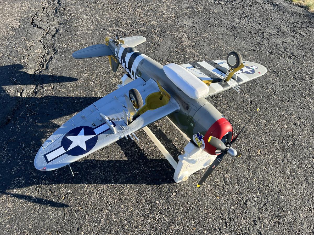

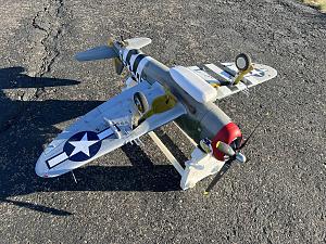

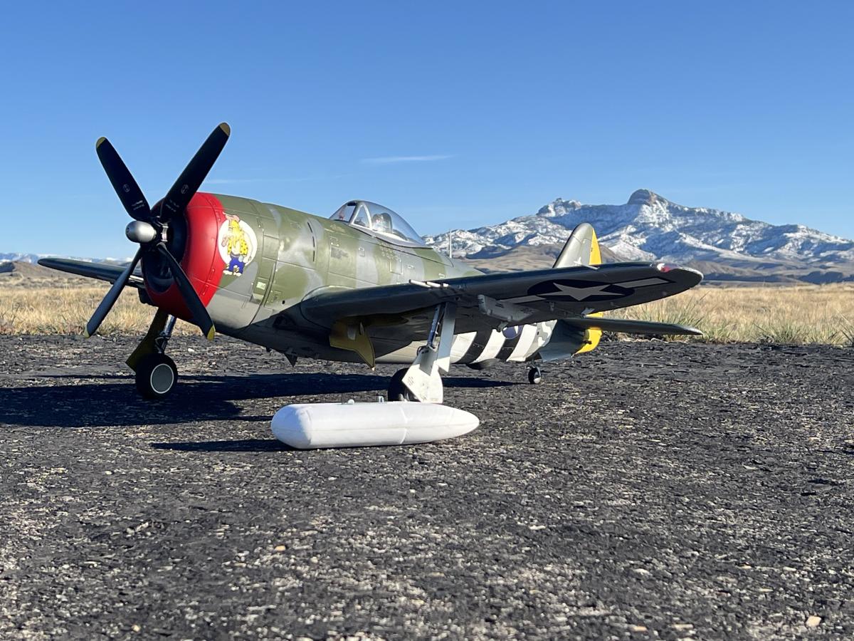

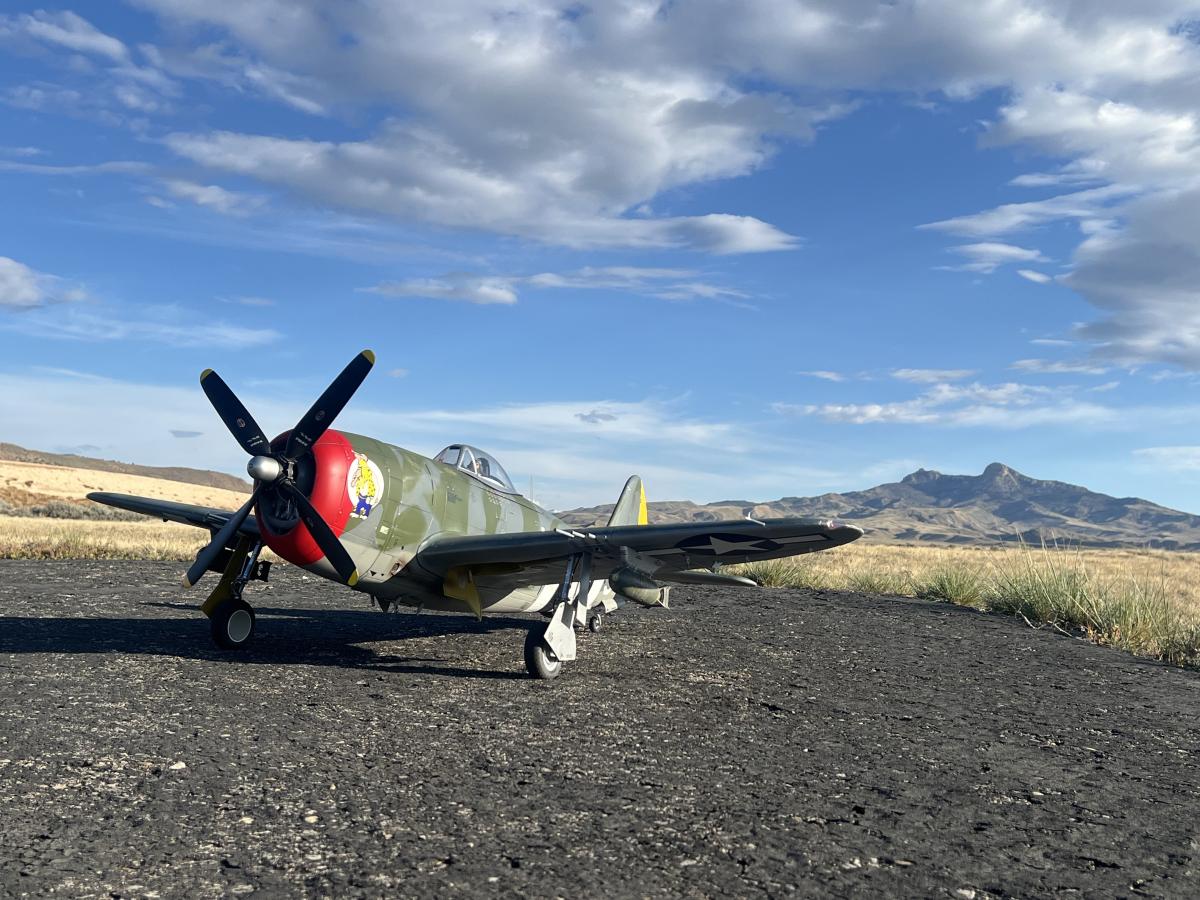

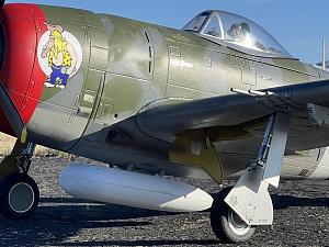

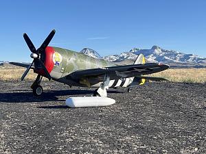

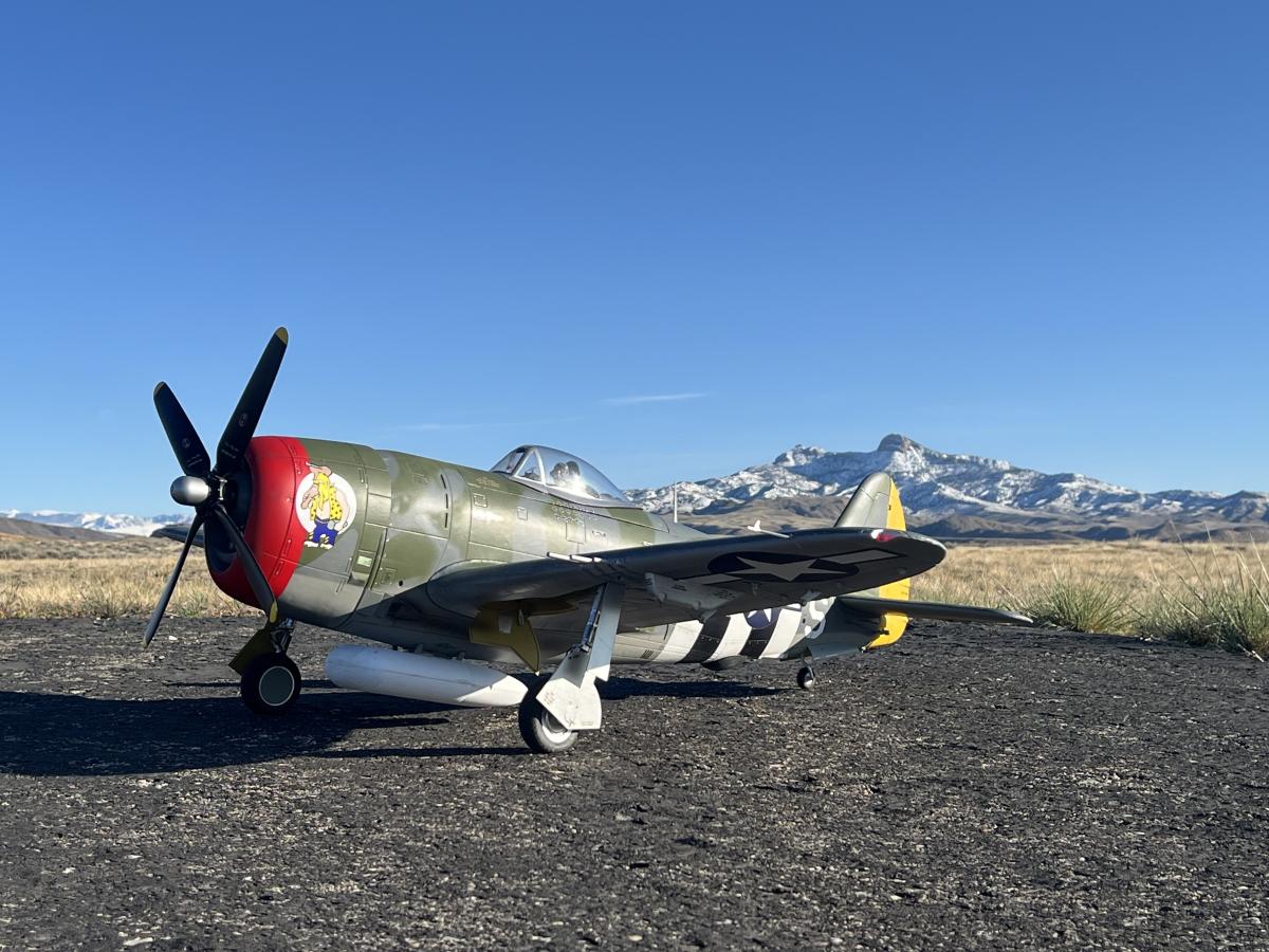

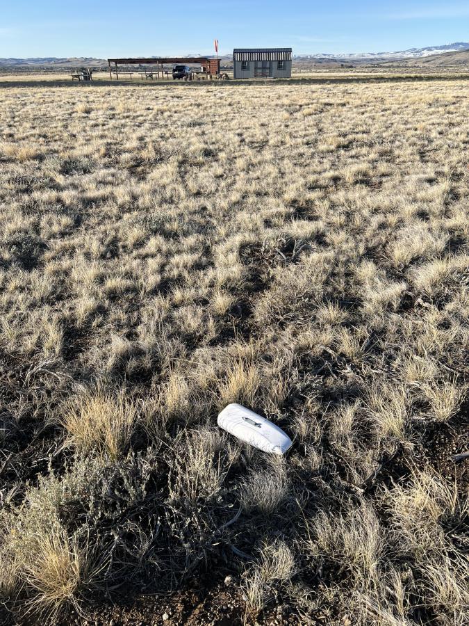

                                      I'm happy to report that the idea of a scratchbuilt large, scale 150 gallon drop tank was successfully flown this morning from my testbed Hairless Joe. This larger tank was crucial in allowing Thunderbolts to penetrate deeper into enemy territory on bomber escort and other interdiction of German fighters, railroads and trains, and other valuable targets. A big shout out to Danger Dan for designing the stl and making it something from being on a computer screen to the actual part on a model airplane. I do a little small project work on my Prusa Mini, but this was too large for my skills and printer, so we had a professional outfit make up the parts that Dan designed.
                                      I wasn't really planning on necessarily flying this first iteration of a drop tank, and it was pretty thick but hollow construction. The entire thing unpainted and unfinished like today's test flight, weighs close to 8 ounces, which concerned me. But the overall plane ready to fly without the tank weighs 10 pounds. so I figured it could probably take it ok. I put the E Flite attach bracket in a slot I cut at the CG of the tank. And then the tank attached to the E Flite release mechanism, which is also at the CG of the airplane. When I tested it with the tank attached, it was absolutely perfect on CG, so I figured I had that going for me.
                                      Took off this morning, I think I have the throws and Expo dialed in to my liking and it took off beautifully and very scale. Did about 3 passes to check for security of the tank, and then on the next pass dropped it as it passed me. As usual, it went unstable immediately and spun end over end until it hit the ground about 150 feet from my position. It did land with an audible "THUD!" which surprised me slightly but this drop tank is built like A Sherman Tank, and just had a bit of dirt on it.
                                      So, this completes the testing I wanted to do for this airplane model project. I think the scale 150 gallon tank is probably unique to my knowledge on a foamie fighter. I made a larger one for a 1/5 scale gasser P-47M about 20 years ago that the tank dropping was part of the routine we used in competitive flights.
                                      I'll give Hairless Joe the weekend off, now with 6 flights on it. I'll start working on the tank, doing more sanding, filling, and eventual painting to complete it in a Neutral Gray color.
                                      I"ll attach a few pics from this morning. The one of the tank in the field is where it landed and looking back at our clubhouse where I was standing about 150 feet away.

                                        Davegee,
                                        Great News! Tank looks great and painted will look just like the real ones.
                                        NO REST for the Wicked so on to your next project.
                                        Have a great summer you guys.
                                        Best Regards, Rex

                                          Thanks, Rex. I'm delighted I was able to fly this V1 version of the fuel tank this morning. I really had some trepidation as to how it would fly due to its weight, and I was ready to push the "pickle" button if I had any problems with it to save the airplane. But that wasn't necessary and it flew as if there was no extra weight on it at all. Once I finish the drop tank I'll continue to fly with it attached to the plane, but I probably won't fly this airplane all that many times; it's specical to me due to my flying a larger gasser Hairless Joe almost 25 years ago and also flying it on the same runway that the real one flew from in Boxted England in 1944.
