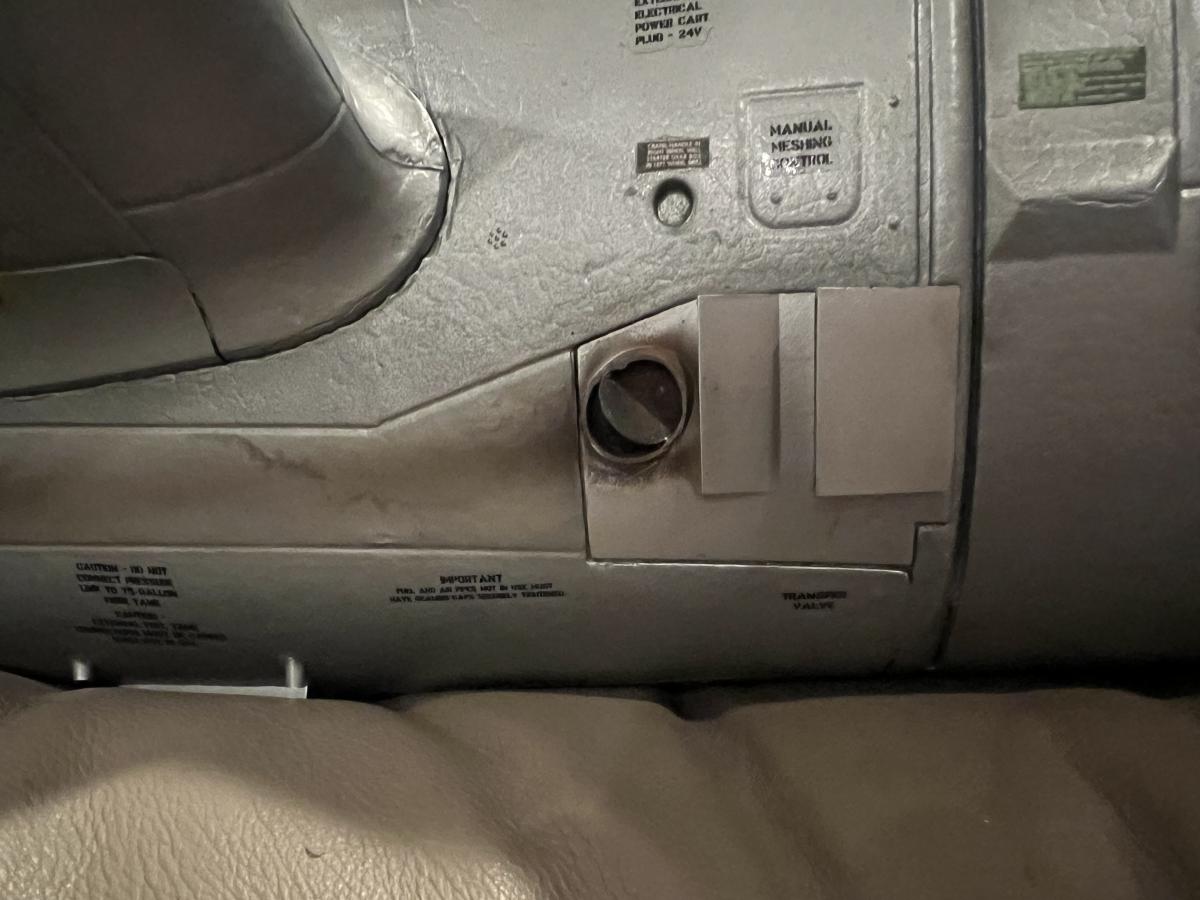

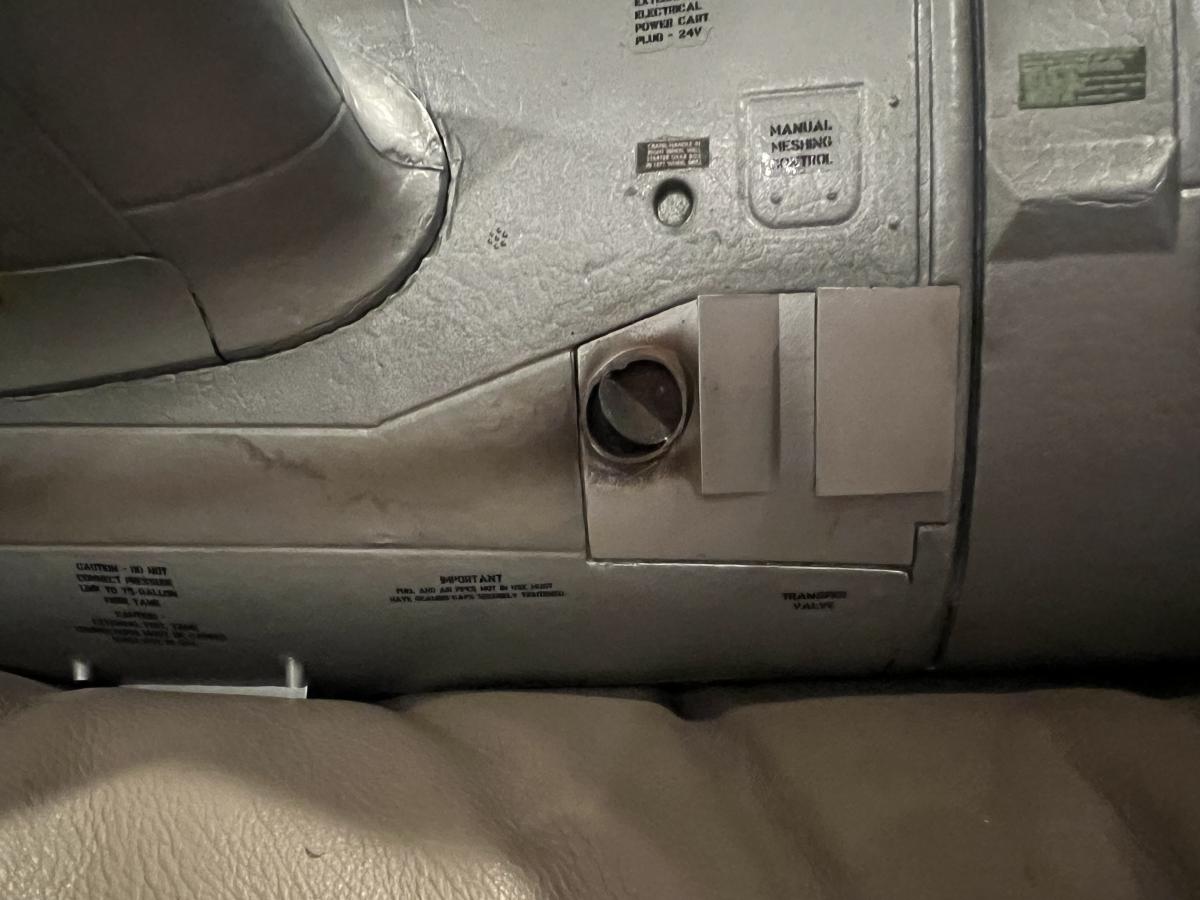

                              My wife paints all my pilots so you are in good company!
                              I think the model was designed by FMS like it would have had lengthened exhaust stacks if it didn't have a waste gate. I've seen this on some restorations where they didn't have the waste gates installed any more. Maybe that's where they got that idea. But for your plane, I cut it off short, pretty much where it starts coming out of the fuselage. Then I made a small round disc of plastic (waste gate), cut off about a third of it so it could fit at an angle inside the ring that you cut off nearly flush with the fuse. The waste gate would be open a ways (your choice of position) on the ground, and then would eventually fully close at altitude to force the exhaust air through the piping to spin the turbo charger about 3/4 back on the bottom of the fuse.
                              I just took a pic of my Penrod and Sam so you can see how I did it. This area would have a lot of brownish heat and exhaust stains on the waste gate and surrounding area, and a stream of exhaust, (probably best done with an airbrush) showing how it was blown back by the windstream on the fuse. It's not perfect but pretty close, I think.
                              You can pull off those plastic panels to better work on them and then reglue them on later. Might make it a bit easier to do.
