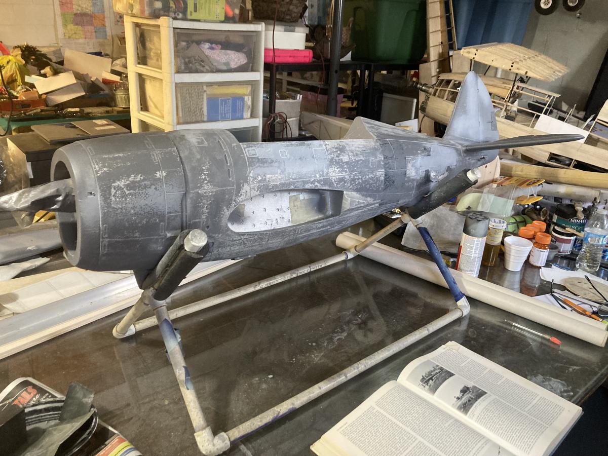

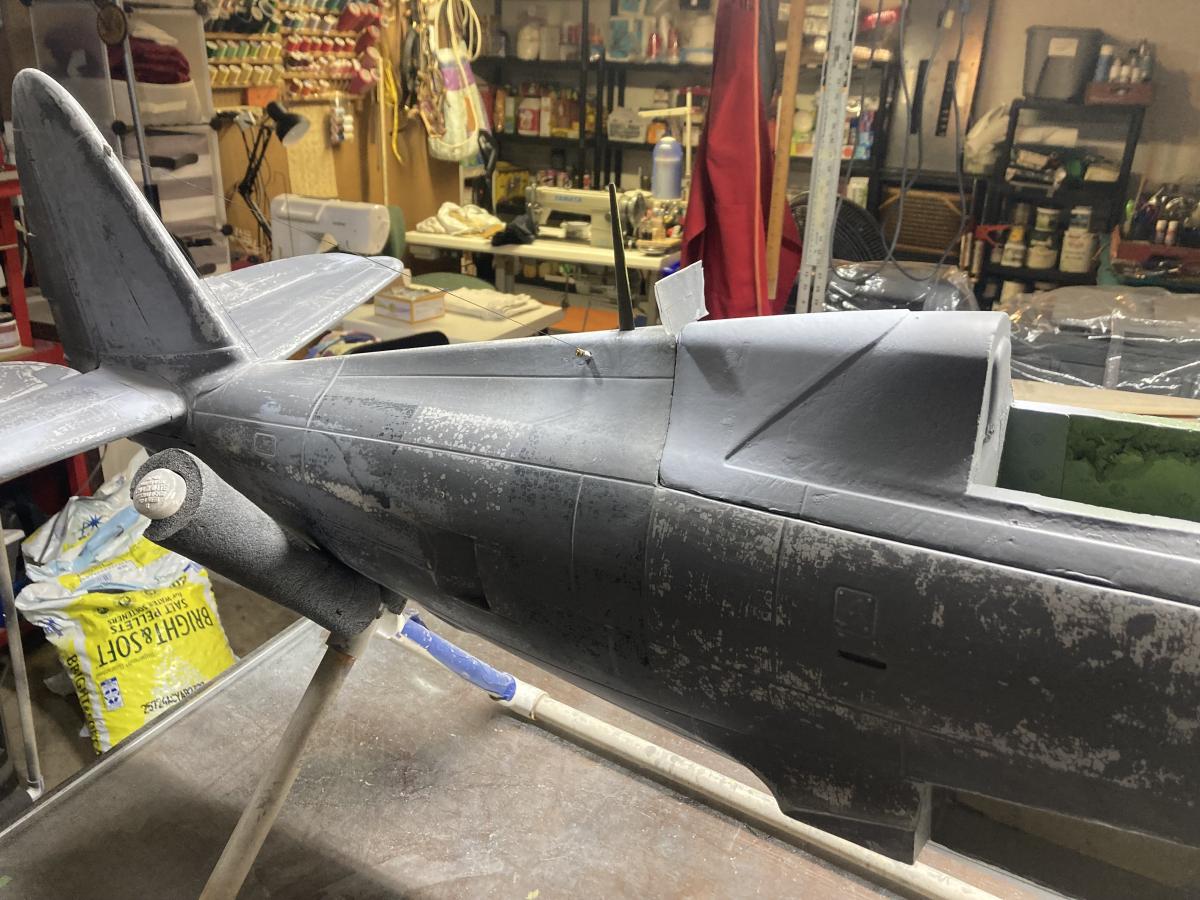

      Final wet sanding before last light primer coat then paint. Model is leveled, slick and smooth.
      A photo showing Lucky with the Curtiss propellor and prop spinner. Will make alum. spinner nut for my vs3 prop.

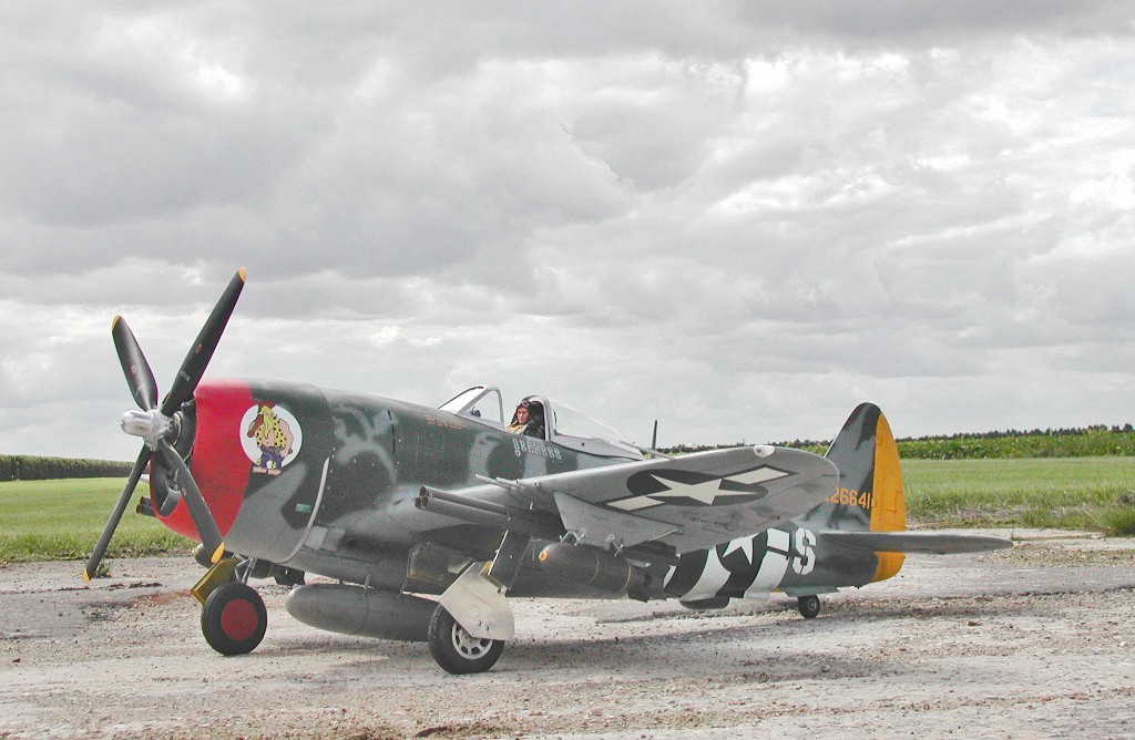

              I never had anything against the Bonnie paint scheme or Major Bill Dunham, one of the standout P-47 pilots in the Pacific theatre of war in WWII. I just had designs on my favorite paint schemes, mainly of the 56th Fighter Group that flew out of England during WWII. I'm happy to see others like Rex who appreciate the aces of this unit, and one of the very tops was Major Bob Johnson. It's fitting to salute him among the many others that people paint their airplanes for rc flying.
              I only wish they would come out with a good P-47D bubbletop version, too. If they do, I have several I'd like to get and complete my P-47 collection. First up would be one of my favorites, Hairless Joe, flown by Lt. Col. Dave Schilling. I had a gasser from a Aerotech kit that was all carbon fiber with a big 4.5 gas engine in it. It flew in a number of big contests and had a trip over to England where it flew from the same field at Boxted Air Base, England. Here it is on the end of the remains of the main runway 22 at Boxted. It has been on display at the Kalamazoo Air Zoo in Michigan since 2005. This plane was 1/6 scale with an 85 inch wingspan.

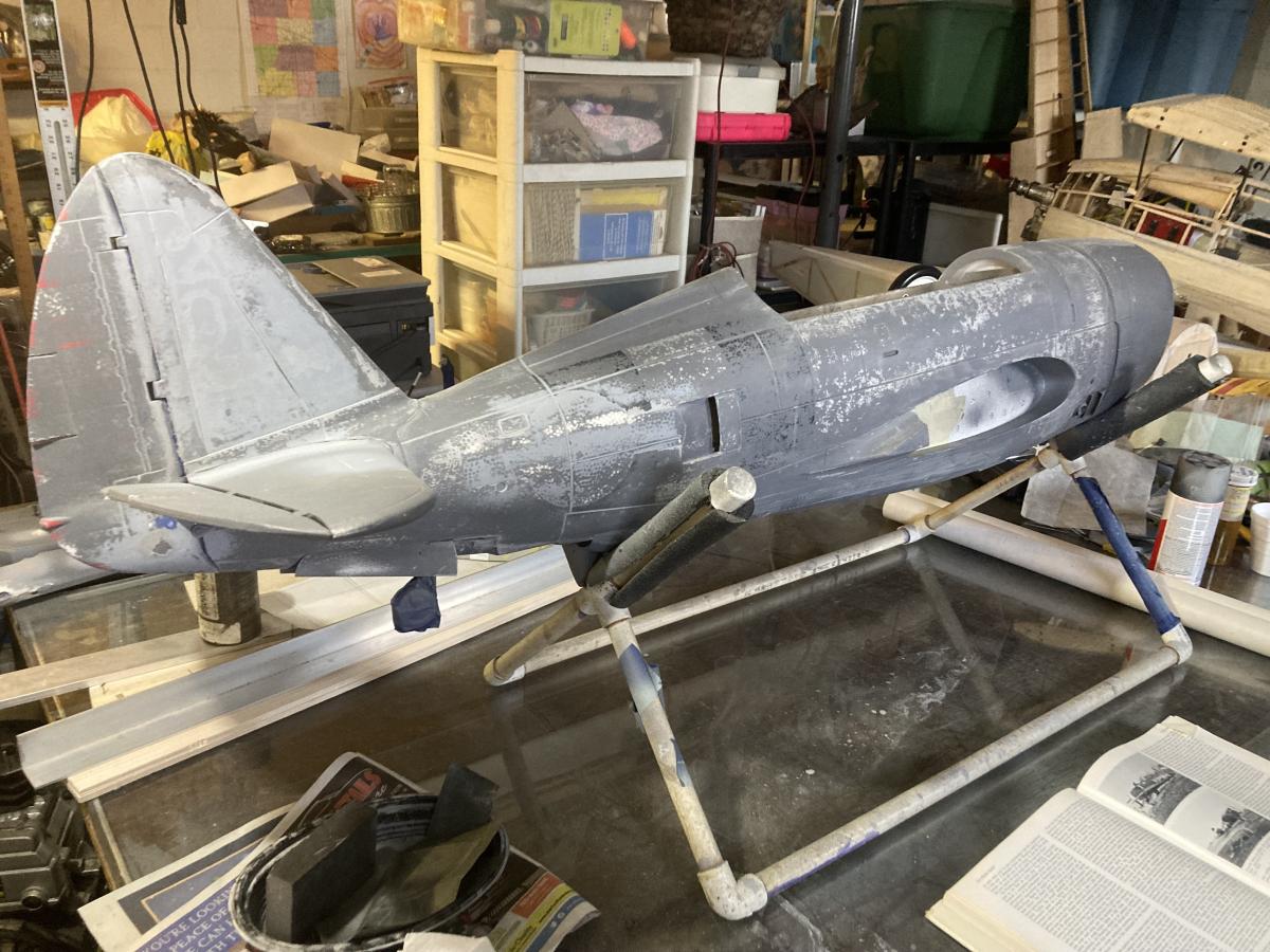

                    Do you guys ever plan to work on your models and then find 1-2 hours later you're just sitting there looking at it. It has been one of those days. Any whoo, this has been staring down on me

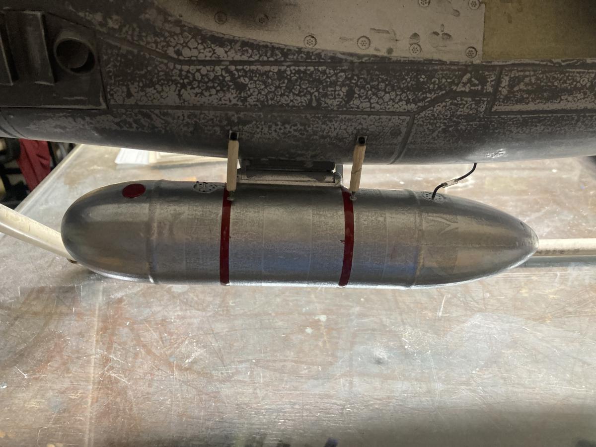

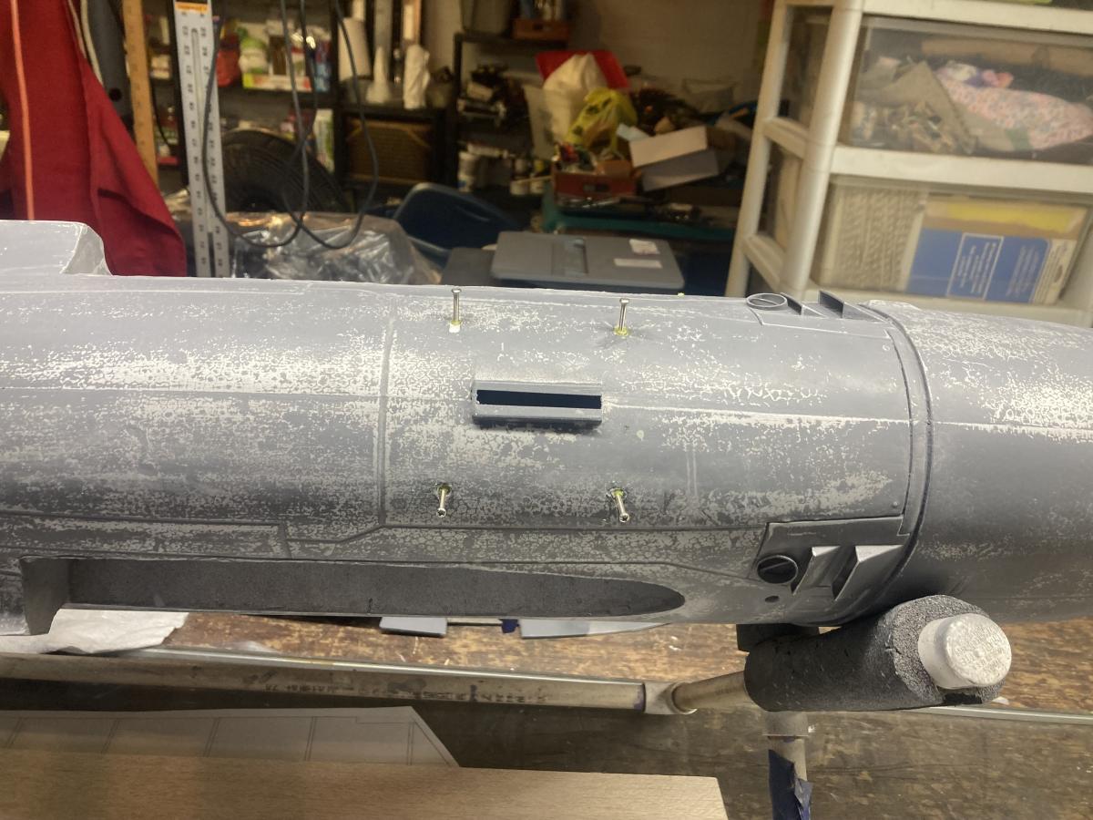

                          Today I'm working on the sway bars that hold the belly tank on. First, I measured and using a brass tube I cut 4 holes to glue some 1/2" long ny-rod for mounting the braces. I tapped them for 2-56 threads to make it easier to install small screws in. The bolts shown are just to set the ny-rod flush with the fuselage, removed after glue dries and shorter bolts will be used. Hope to have more to show later today. These little details takes as much time to do as assembling the whole aircraft.

                                  Looks good, Rex. My only question or concern is the bolts look to me to be angled out away from the centerline of the model. You probably know this but they need to be angled IN towards the centerline so that they can be adjusted to touch the bomb or drop tank so that it doesn't "sway" left and right. Am I missing something? I just wanted to be sure.
                                  I just grabbed my I Wanted Wings P-47 to demonstrate what I'm talking about. This is my oldest jug and is somewhat beat up over the years. The sway brackets have been ripped off a few times on belly landings or in the weeds. At any rate, I just wanted to try to point out to be sure we're on the same page to show that the sway brackets angle IN towards the bomb or tank, and the adjustbable nails or whatever (I used nails) then can be moved to touch the droppable slightly keeping it from sideways movement.
                                  Cheers

                                    Davegee,
                                    Hopefully these pictures answer your concerns. Please keep it up, keeps me on my toes.
                                    I used alum. flashing cut in 3/16" strip to make the base, 2-56 bolts for the stabilizing of the tank, then 1/8" balsa for depth. Sanded. Not perfect but think it looks ok.

                                        Ah, that looks great! I just wanted to be sure you were on the right track, and indeed you were! Carry on, my man!

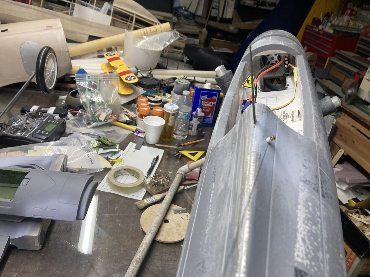

                                          I've slowly been working on some details. I made up the fuel line from fuselage to drop tank and made the antenna insulator that has a black thread to the tail ant. bracket, this thread will get replaced with some old small control line cable when finished. Still have cockpit and many other things to do before I start painting. Davegee, Dangerous Dan, Elbee, I keep looking at the thing's you guys are/have done and I keep adding details......... Madness!
