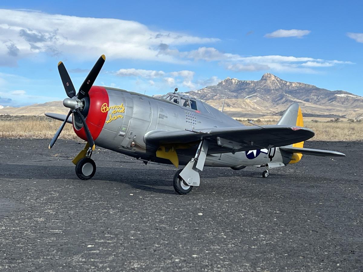

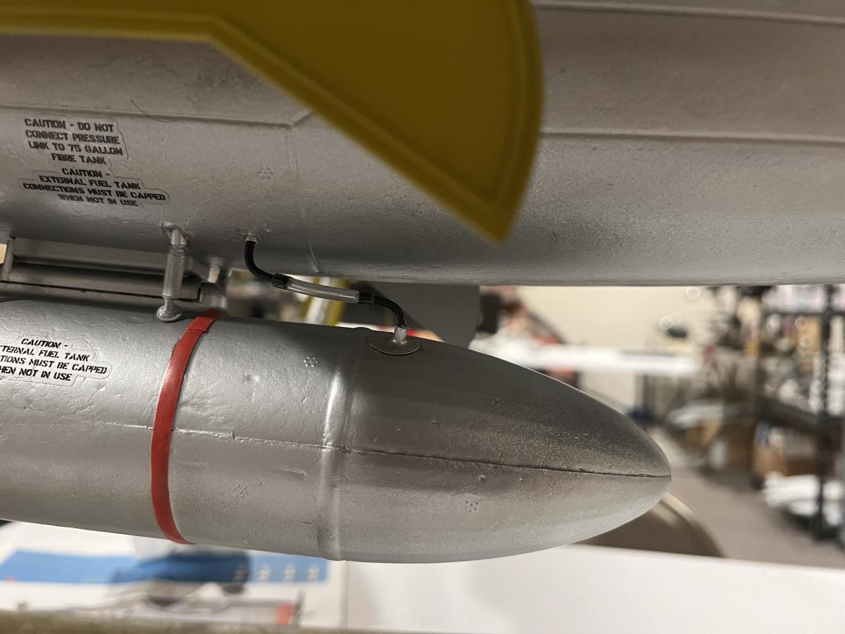

        I just found this one from my I phone. It was taken at the same time as those in the previous post. But I really liked the whole composition of the sky, mountain, and plane together in the photo, this one "clean" without any ordnance stores, unretouched or photoshopped.
        Click image for larger version  Name:	IMG_1741.jpg Views:	3 Size:	157.5 KB ID:	397809

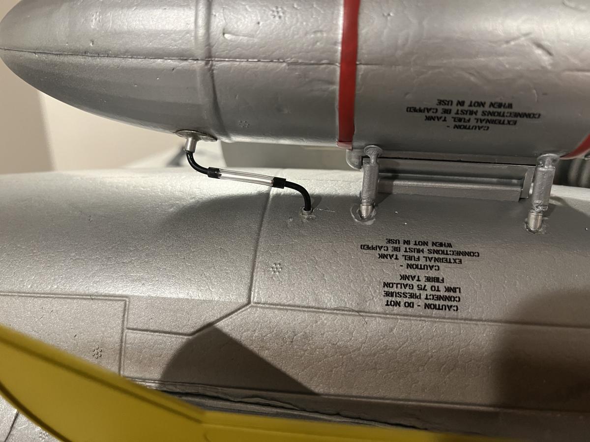

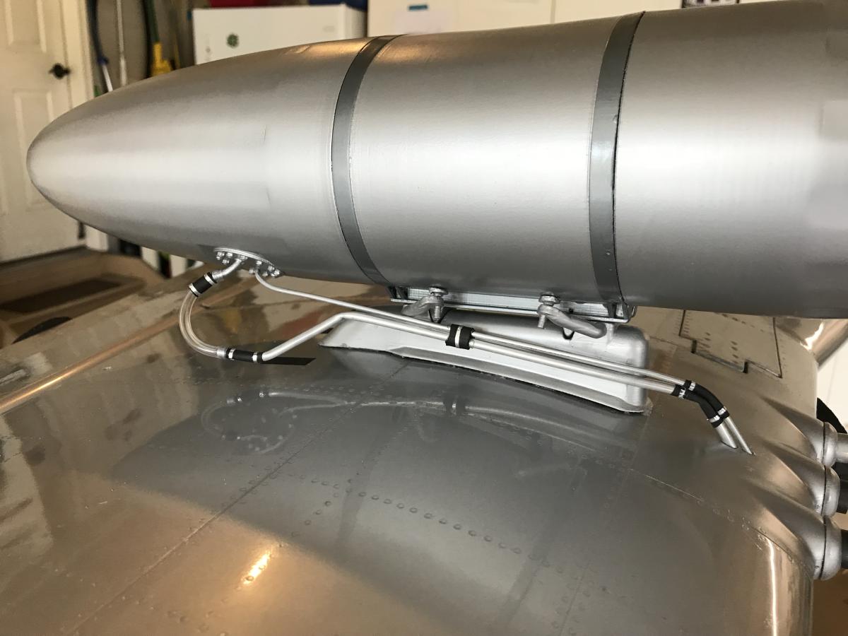

          Here is a little obscure detail that is probably over the top for most, but one I found interesting. For the drop tanks on these airplanes, many times they used connectors that had a section of glass tubing connected to the flexible tube that attached the drop tank to the aircraft wing or belly. The purpose of the glass tube was to give a clean breakaway of the tank when jettisoned, usually just prior to entering armed combat with the enemy. Wouldn't make for a very good look if the hose held onto the airplane with that tank banging against it while trying to engage an enemy fighter! This idea worked very well to preclude a problem getting rid of a drop tank when needed.
          I have two pics, one where the plane is upside down, and another where it is right-side up showing the clear tubing section. I used black electrical wire and the tube was 1/16" ID vinyl tubing bought on Amazon.
          Click image for larger version  Name:	IMG_1754 (1).jpg Views:	0 Size:	99.1 KB ID:	397817 Click image for larger version  Name:	IMG_1753 (1).jpg Views:	0 Size:	133.7 KB ID:	397818

            davegee, We Americans can be quite clever. Nice touch. Best, LB

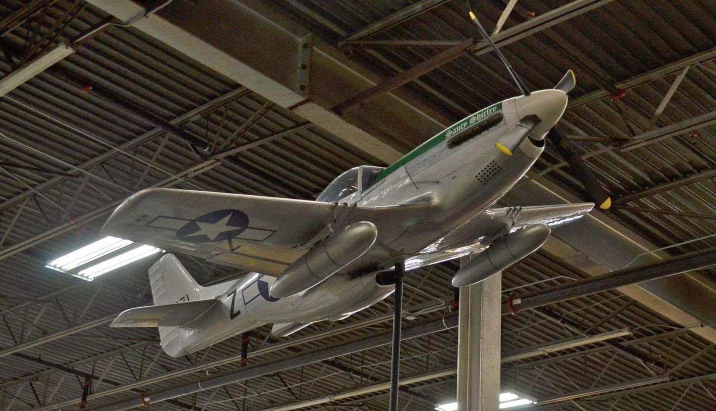

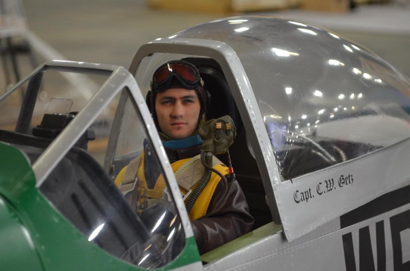

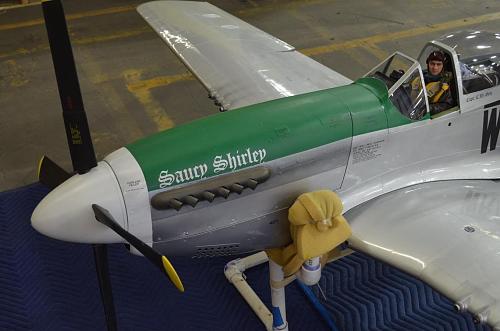

                Thanks, Elbee. I first added these to a CARF 1/4.5 scale model of a P-51D that was and is part of an exhibit on the Scouting Forces in WWII. The museum is the 8th Air Force Museum in Savanah, GA. The plane was painted up as "Saucy Shirley" which was a girlfriend of a good friend of mine who passed away recently at 99 years. They used 110 gallon wing tanks to make their Scouting missions all the way to Berlin and back with the bombers. I found some pictures of these breakable glass tubes used on the Mustangs, and other fighters. I agree, it was a very clever idea on ensuring clean separation of drop tanks when needed. Due to a shortage of resources back at base, pilots were requested to bring the empty tanks home if they didn't have to jettison them on their missions.
                I understand the clever Brits also used something like these on some of their RAF aircraft, too.
                I'm attaching a photo I found while building the CARF 1:4.5 scale P-51D Mustang Saucy Shirley that I mentioned above. You can see some detail of the (simulated) glass tube on the fuel feed line. The tank itself was 3D printed, back in 2018 by a friend of mine. I can't find any of the finished pics of the airplane on display in Savannah right now, but will look for some. It was and is a pretty cool interactive display showcasing the Scouting Forces in WWII of which my friend who flew this aircraft was the "last of the Mohicans, the last man standing of about 100 pilots who were in the group in WWII. He was pretty well off so he funded the display for the Savannah museum that we installed in 2018.
                Click image for larger version  Name:	IMG_2046.jpg Views:	0 Size:	88.4 KB ID:	397862

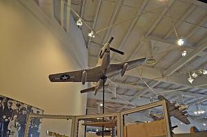

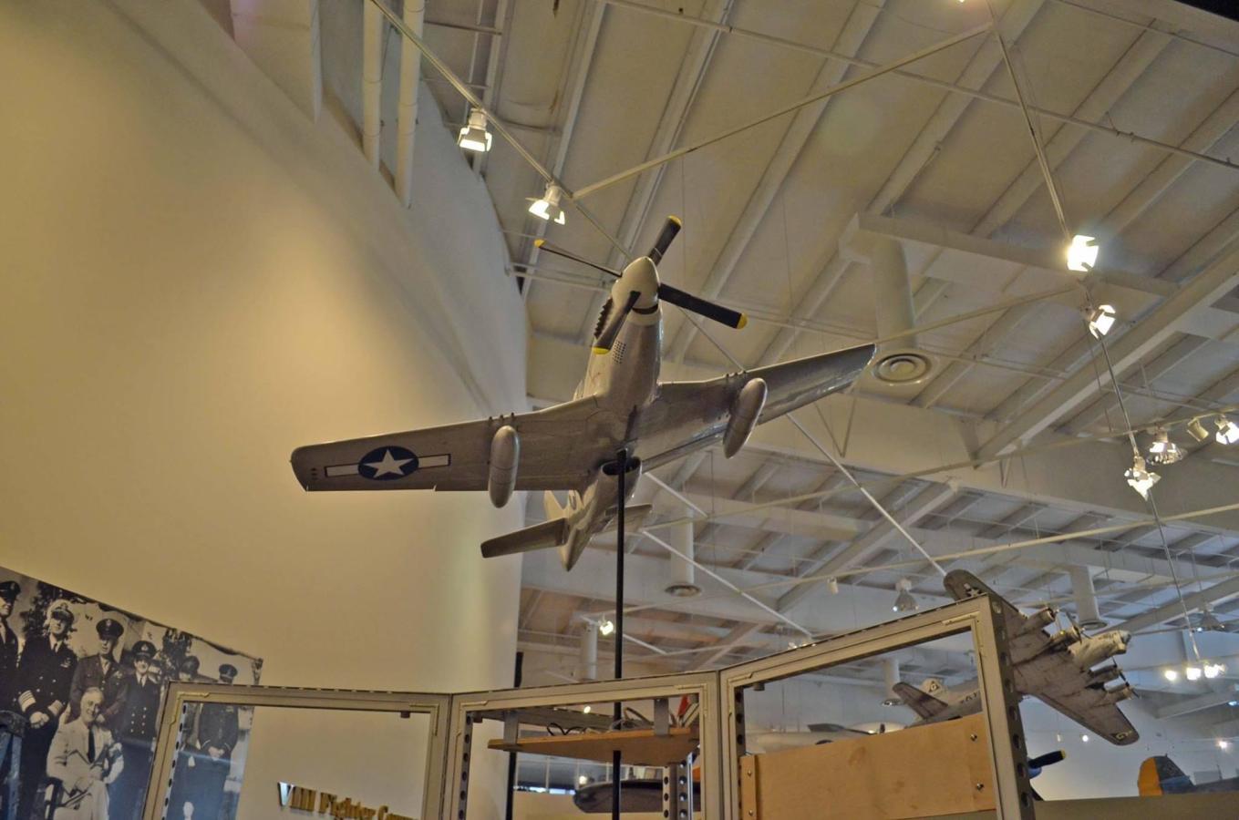

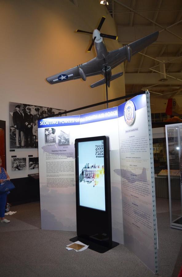

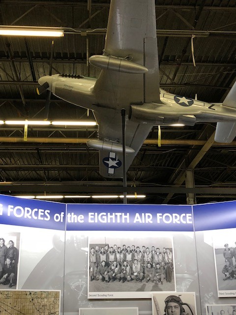

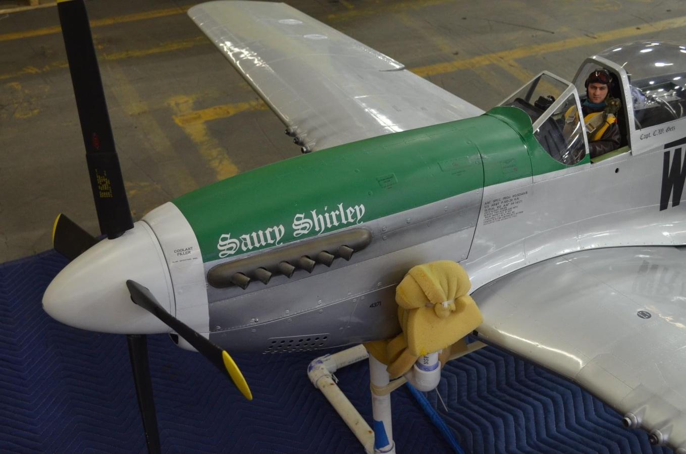

                      Hi f4u aussie: I know this is a little off topic for this thread, but since we got on the subject of Scouting Forces, I thought you and maybe some others might enjoy some pics I just found online from May 2018, when my wife and I drove a big U Haul truck from Denver to Savannah with the entire Scouting Forces display items. One of them was a CARF 1:4.5 (98 inch wingspan) fiberglass model of a P-51D that I repainted, and mounted on top of the display panels on a pole in a climbing, turning, attitude. All the markings on this airplane were painted on, no stickers. Even the small nomenclature were stencils and painted on. The pilot figure we got a photo of the pilot, Bill Getz, taken in 1944 in the cockpit of his plane. There was a service that could do a 3D print of the face and head if you had at least a frontal and side photo that they could use. It was almost eerie how close to the real person it was! I'll attach some pics here of the display which is still going on at the Mighty Eighth Air Museum in Savannah. It's a museum well worth taking in, if you are in the area.
                      Click image for larger version  Name:	IMG_2744.jpg Views:	0 Size:	109.0 KB ID:	397871 Click image for larger version  Name:	IMG_2749 (3).jpg Views:	0 Size:	58.4 KB ID:	397872 Click image for larger version  Name:	IMG_3455.jpg Views:	0 Size:	88.9 KB ID:	397873 Click image for larger version  Name:	IMG_2750.jpg Views:	0 Size:	99.0 KB ID:	397874 Click image for larger version  Name:	IMG_2752.jpg Views:	0 Size:	159.6 KB ID:	397875 Click image for larger version
