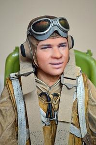

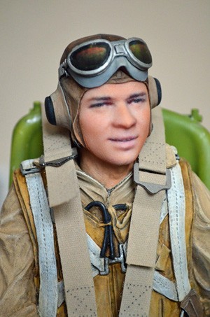

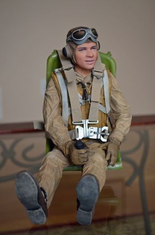

      Hi Rex: I don't plan on doing any more modifications to the prop other than what you saw. I know they went through several types of both Curtiss and Hamilton Standard props over the course of the war. There is one or two that are 'reasonably" close to this model's HS prop with the cuffs on it to mimic a CE prop, and that is probably close enough for me with this foamie project. The printed CE prop dome, however, is spot on and should really enhance the look of the plane. If it was for a museum piece, of course I would probably have 3D printed props for that. But I know that this is a proven propeller for this airplane even though it is designed for the V3 Corsair, and I have confidence that it will fly two of my P-47s well with it on. The third one I have had a HS prop, so I didn't have to do anything to it and have flown it already on the big prop several times.
      Good you're working on the cockpit. I ended up keeping the stock bust pilot on my Corsair, painted up his jacket with the Marine camo pattern that the real pilot Bob Hanson habitually wore on his missions. He'll do for this one, but I'm always searching for better pilots, like what LB did with his magnificent full figure printed marine pilot.
      The best one I ever did was for a ESM Corsair that went to a museum in the Denver area. I used one of the "Best Pilots" brand of pilots, and then had a scanned face put into the helmet from a photo of the real pilot, Major Bob Owens, who flew it in WWII. It was eerie, it looked so real!
      Look forward to updates to your birdcage Corsair!

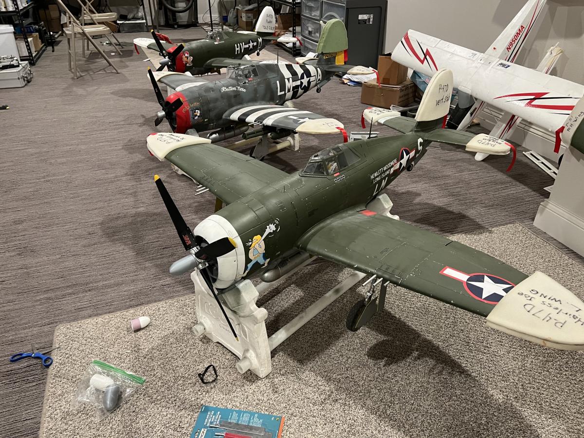

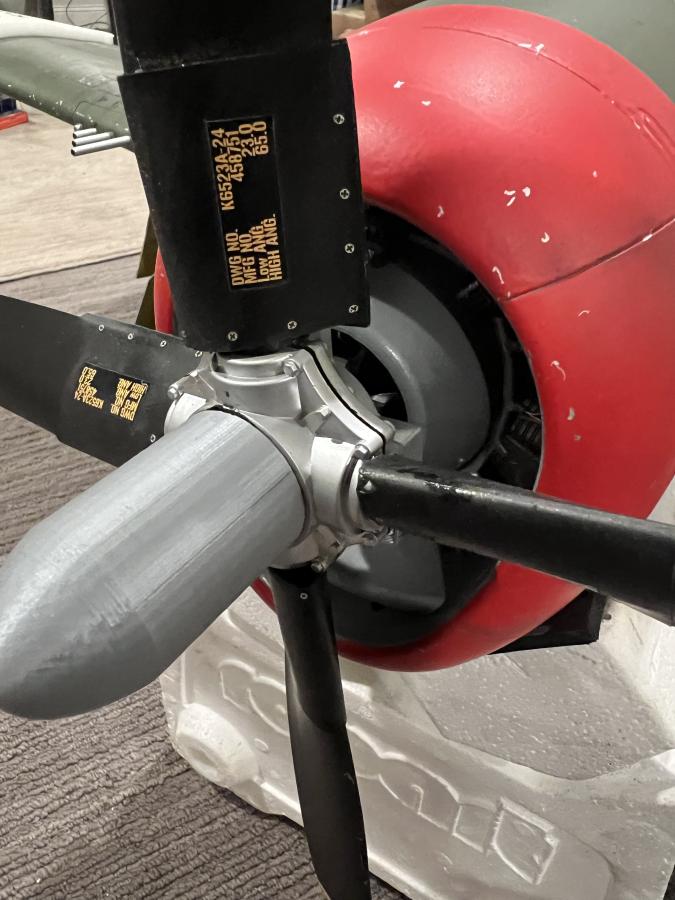

                Here is my first pic of all three airplanes with the big props, and two of them with the CE prop dome. Just arrived today in the mail. Weather permitting, I'll do full power runups on all three airplanes outside on the patio at home. Most of next week is forecast to be cold, snowy, and windy, so probably won't get out to fly next week, but we'll see.

                  davegee The planes look great but those wing mitts look fantastic!!! Now I'm kicking myself for all of the packing foam I've ever tossed. Great idea!

                    Nice airforce you have Davegee. Spinner and cuffs look great. Rex

                      Thanks, Rex. I am going to try and haul all three of them to our air field this spring on a nice morning to do a photoshoot, maybe even get a couple of them in formation for a flight or two. Not sure who would fly the other one, but would be neat to see two planes in formation.

                        Hi SanExup: For the wing and tail protectors, it's really easy. Places like Walmart sell rolls of foam about 1/2" thick and about 4-5 feet long. Just trace the shape of your part you want to protect, cut two out and glue together with a glue that works with foam. Then you are all set. They have prevented a lot of damage to/from the air field bumping into things, in and out of the truck, etc.
                        I ended up making these prop cuffs out of .010" thick styrene. Folded it carefully in two and used model airplane glue to cement the two ends together. Then painted and slid the cuffs on the base part of the prop and used some rubbery glue to keep them in place.
                        I've done a couple runups to about 1/2 power indoors but the acid test will be some full power tests I need to do, and of course flying it to see if there are any adverse effects using the cuffs. I suspect they won't be a problem, but we'll see. Probably a week away from flying if the weather reports are accurate for upcoming super cold temps and some snow off and on. But if I can sneak out in-between all that stuff, I might get a flight or two in! The plane with the Ham-Stan prop has already been flown several times with the big prop on it. I have a defective tailwheel that cycles about every third or fourth time you command the gear to go up or down. Don't want to fly until that servo is replaced.

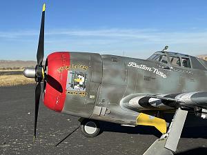

                                Everyone in this hobby or any hobby, have their reasons or things that motivate them to do what they do. No matter the motivations, I think it's all good.
                                I have done some airplanes that are models of a few of our top aces from WWII, like Dave Schilling and his series of Hairless Joe airplanes, named after a colorful character in a cartoon strip L'il Abner during that time. The foamie Hairless Joe, is modeled after one of his earlier planes (note the red surround on the stars and bars dating to 1943) earlier in his combat career in Europe. He got three kills in this plane before trading up for a newer plane. A pilot flying it afterwards ran out of gas coming back from a mission, belly landed it, and the plane was a write-off, although the pilot escaped without injury,
                                Another plane in my foamie jug group is I Wanted Wings/Button Nose, flown by a Lt. Albert Knafelz of Horseheads, NY. He got one aerial kill and a bunch of locomotives as operations switched in the summer of 1944 to killing trains, enemy infantry, airfields, everything that would bring the Germans to surrender. Knafelz did his tour, survived it, and came home to live a long and normal life afterwards. Nobody talks about him, other than people who knew him, but he contributed as much as anyone to winning the war in Europe, I think. I like recognizing people like this, too, who deserve a place at the table of Heroes.
                                I think it is great if you are moved to honor some heroes like Jesse Brown from the book Devotion, or Dale Snodgrass of F-14 and aviation fame before his untimely demise a few years ago. It helps keep their memories and accomplishments alive for all of us.

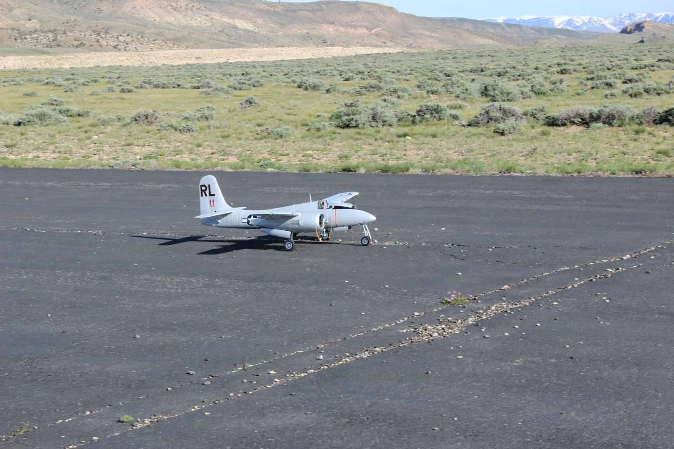

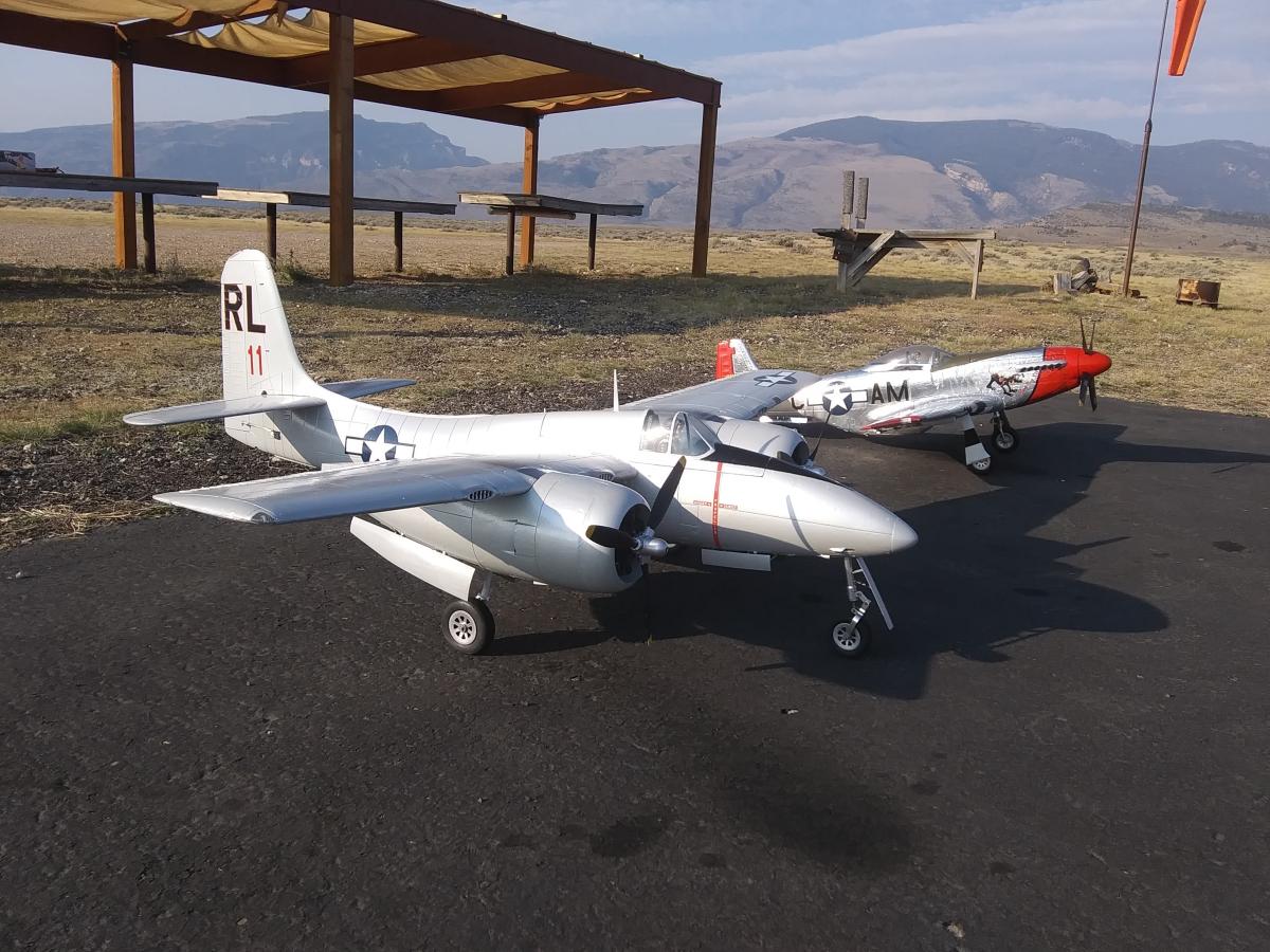

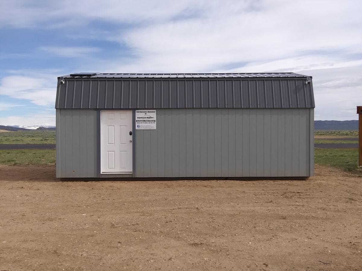

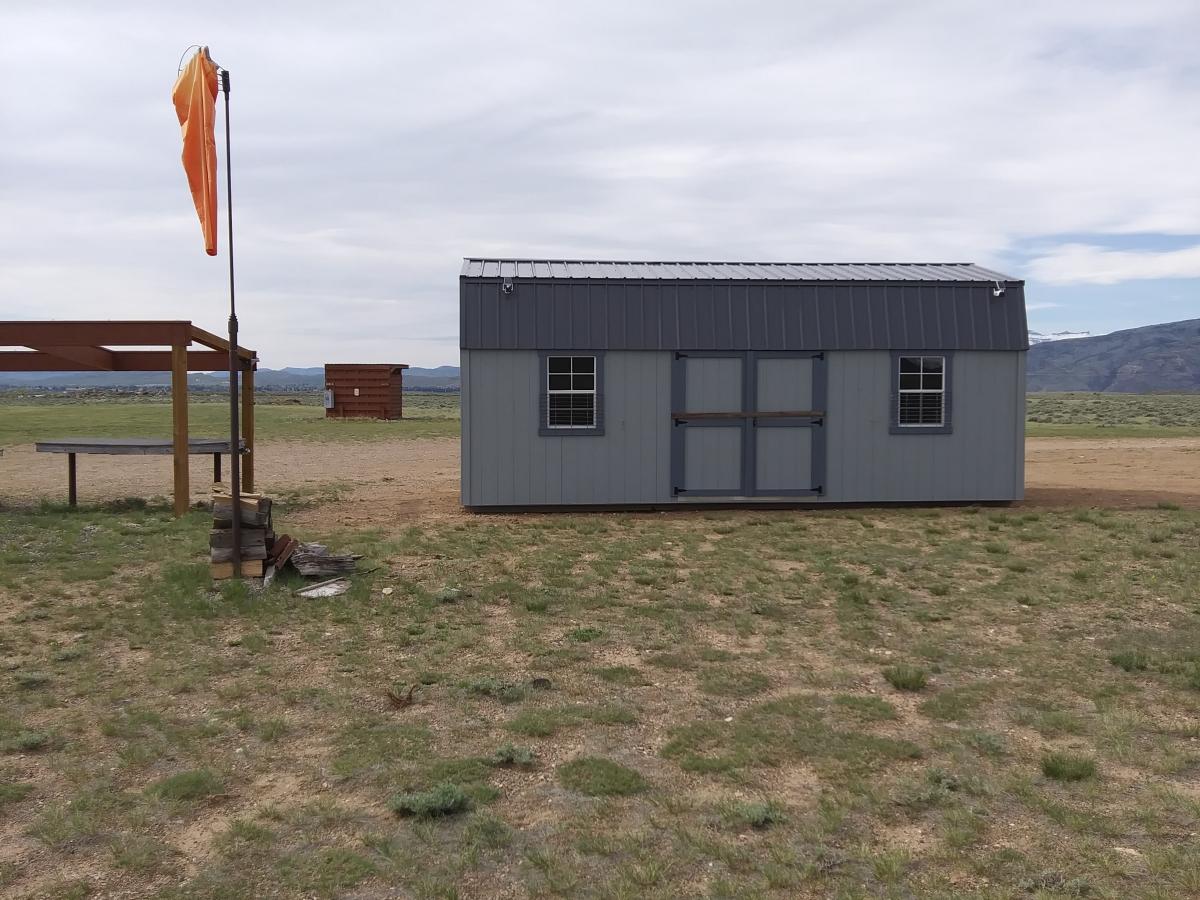

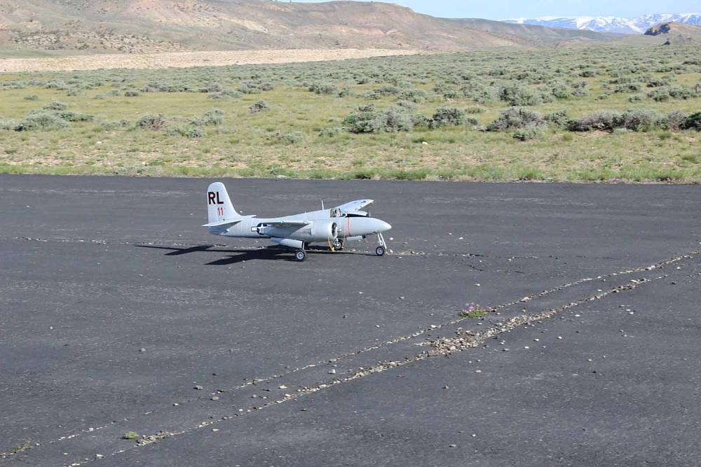

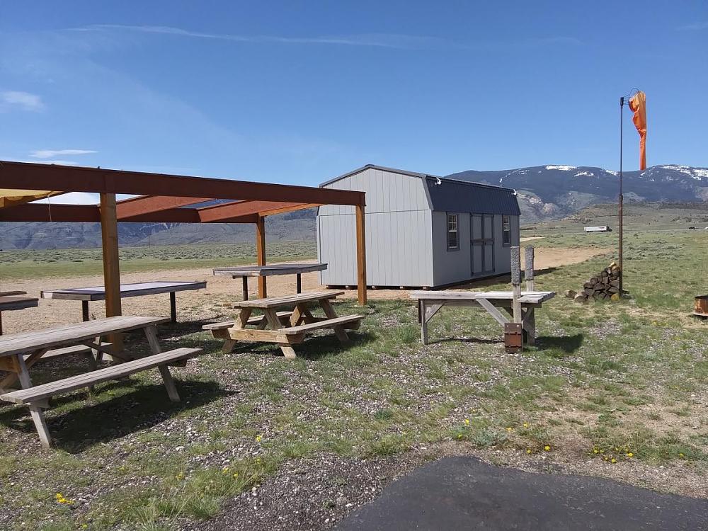

                                          Count me in, I'm back at work Tuesday through Saturday but Sundays and Mondays are still mine. Yeah, some of the fellows from our club went to this fly in at Thermop last year. Andy's turbine jet was in the Jan 2023 edition of Model Aviation. The event is called the Thermopolis Fun Fly and was held in Sept 2022. According to the article this was the second time they held the event. Couldn't ask for a better runway, a REAL runway. Speaking of runways, our is a runway in the broadest of terms as Dave can attest. To be kind, the old asphalt is lumpy and cracked.
                                          But its flyable and certainly better than nothing. Click image for larger version  Name:	IMG_9685.jpg Views:	0 Size:	164.0 KB ID:	371000
                                          Now, to be fair, the guys have put some work in on it and those pebbles (rocks to our airplanes) have disappeared and we actually have a building
                                          Click image for larger version  Name:	20220603_092504.jpg Views:	0 Size:	123.8 KB ID:	371002Click image for larger version  Name:	20220603_092540.jpg Views:	0 Size:	152.1 KB ID:	371003 and a cover over our tables when the wind hasn't ripped the tarps up. We should be getting new tarps this season I'd imagine.
                                          Click image for larger version  Name:	20210928_090625.jpg Views:	0 Size:	164.3 KB ID:	371001
                                          So we're making headway!
