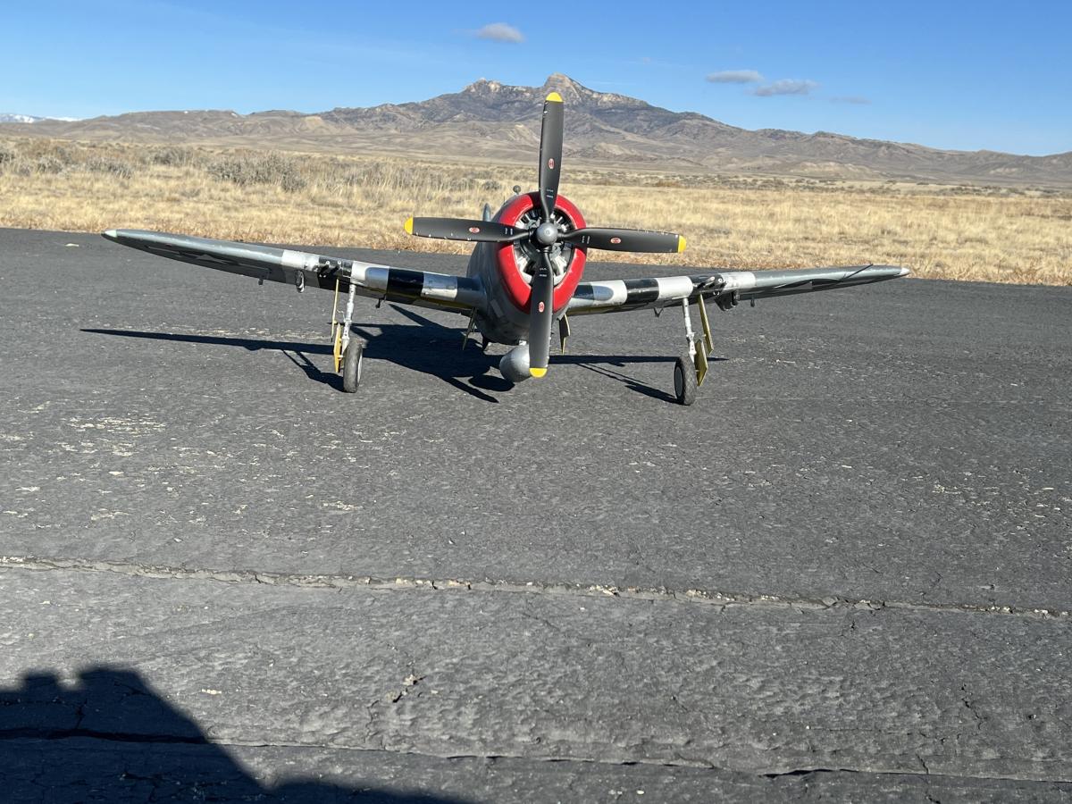

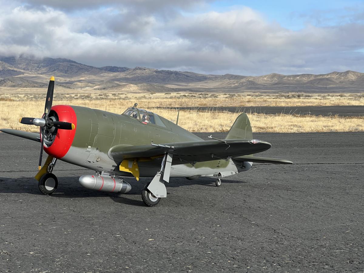

    Weather was acceptable to do a couple more test flights on my new 1500mm FMS P-47D, still under construction. I flew it twice, one without the drop tank, and one with the drop tank. Didn't see any appreciable difference in performance with the tank on or off. But it is fast, or wants to fly fast! Very much like a fighter, indeed. Landings are really a piece of cake when you fly at the right speed and do a two point landing, with some power.
    The only minor issue I have at this point is that the right inner gear door which is down whenever the gear is out, doesn't seem to be retracting when the gear comes up. Haven't seen that one before with these airplanes, and it works perfectly on the ground (of course!)
    Can't wait to get the graphics from Callie in a few weeks to finish off the look. I've been experimenting with the larger V3 FMS Corsair prop, and it flies very well with it, and of course looks better than the undersized stock prop that comes with the airplane. I have someone making me a 3D printed Curtiss Electric prop hub and I'll add some vinyl "boots" at the base of each prop to complete the look. Hopefully it will all work out ok.

      davegee Beautiful paint work, Dave. She's a looker even without Callie Graphics' magic. Best, LB

        Davegee.
        Glad you got a couple of flights in. Plane is looking great. Hopefully mailman will surprise you soon. The tank really sets it off. Rex

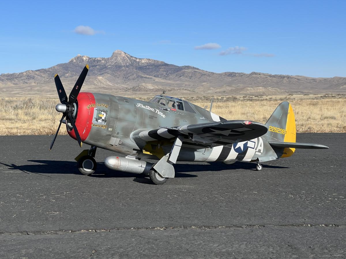

            Callie's magnificent work will be the crowning touch to this model. If I had a preference, it would be using paint masks and painting every decal and nomenclature onto the plane as was done on the real ones, and also on all my bigger gasser planes. It allowed all the rivet details to show though, just as would be when you painted over the surface of airplane skin. But since I haven't found a way yet to do that without the paint pulling off of the foam, the Callie decals do a very nice job.
            Incidentally, I used simple Tamiya rattle cans of AS-6 Olive Drab (USAAF) and Neutral Gray (USAAF). After filling dents, holes, etc., and spraying primer and additional sanding, these Tamiya paints were a breeze to apply. And of course I used the 3M foam masking tape that you are now familiar with. Good stuff!

            Hurrah! My number in line finally came up and Callie emailed me this morning that she is now working on my special markings set for "OLE COCK." I've cleared the deck for next week to put them on when they arrive. She wrote that they should ship on Friday, so I should have them next week, sometime.

            Oh my goodness! That is just gorgeous! Awesome work Dave!

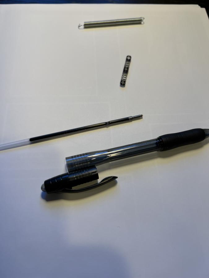

                  Last is a photo of how I circumvented the poorly designed tail wheel door retraction set up. On the real plane, these doors were mechanically retracted or splayed out as the gear went up and down. The model has the doors hanging down and attached with springs to the tailwheel strut. But this makes the gear doors sashay back and forth on the ground as the tailwheel is moved. I think FMS mostly did a super job in designing this P-47 model in almost all aspects. But the tailwheel door design I'd have to say "used poor headwork."
                  The fix, and I got this from someone many years ago when the model first came out, was to string a small spring across the gear doors. This does two things. First, it forces the gear doors to be splayed out more than the original FMS design, and allows for the gear doors to smartly be pulled closed after the gear strut pulls on the spring, forcing them closed. Works great, been using this for years. Also notice the scratchbuilt object at the bottom of the tailwheel area. This was a hardpoint to attach a jack to to safely raise the tail area.
                  Also, the plane comes with painted green zinc chromate gear wheel wells and other interior parts. They should actually be yellow zinc chromate, and I used an airbrush to paint them after I taped them off. I think some of the contractors sub-let from Republic like Curtiss might have used the green, but the vast majority were yellow.
                  Click image for larger version Name:	IMG-0381.jpg Views:	0 Size:	59.3 KB ID:	365768Click image for larger version Name:	IMG-0379.jpg Views:	0 Size:	52.4 KB ID:	365769Click image for larger version Name:	IMG-0380.jpg Views:	0 Size:	60.2 KB ID:	365770

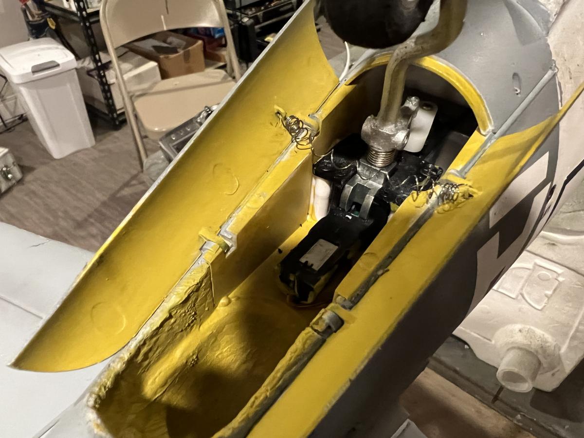

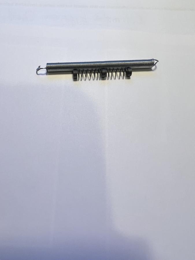

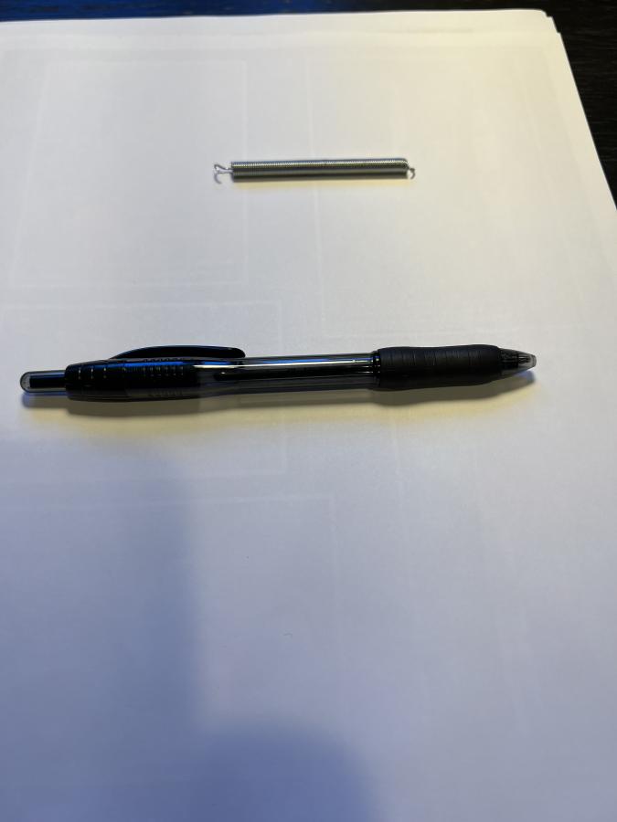

                  I'd like to make a correction to the idea of stringing a spring across the tail wheel doors to get them to open and close in a realistic manner. In 2016, I added a simple spring from ballpoint pen, and stretched it out to a width of about 2 1/2 inches. Then on each end, I took a needlenose pliers and bent the last coil on each end up 90 degrees so that it could be attached to the little brackets on each tailwheel door. It worked great!
                  Well, that plane eventually came back in a body bag, (not for anything associated with the tail wheel spring mod) and more recently I used a commercially available spring I got at the local hardware store for this use. It also worked fine, but I have come across a troubling random occurrence using these hardware store springs, which are more robust than a simple ballpoint pen spring. What I have found with the bigger hardware store springs is on occasion, when I command the gear to come down, the tail wheel stays retracted. It is random, and you can't predict when this might happen. On one occasion last year, it hung up and I had to land with the tail wheel retracted, causing minor damage to the tail area.
                  I think the hardware store springs occasionally put too much pressure on the tailwheel, when retracted, and somehow interfere with the gear coming out. By using the above mentioned ballpoint pen spring, I think these possible issues will be eliminated.
                  I just wanted to make anyone aware of using this system on the FMS 1500mm P-47D razorback model should use the ballpoint pen spring idea, instead of getting a bigger spring at the store that might cause headaches down the road. I still think the concept of this spring is good, much better than the FMS design that moves the tail wheel doors as it taxies on the ground. If you have any questions, I am more than happy to respond. I'll attach a few pics I just took of the two different types of springs I have been using.

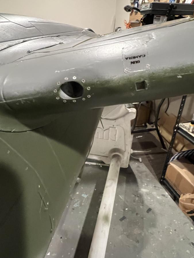

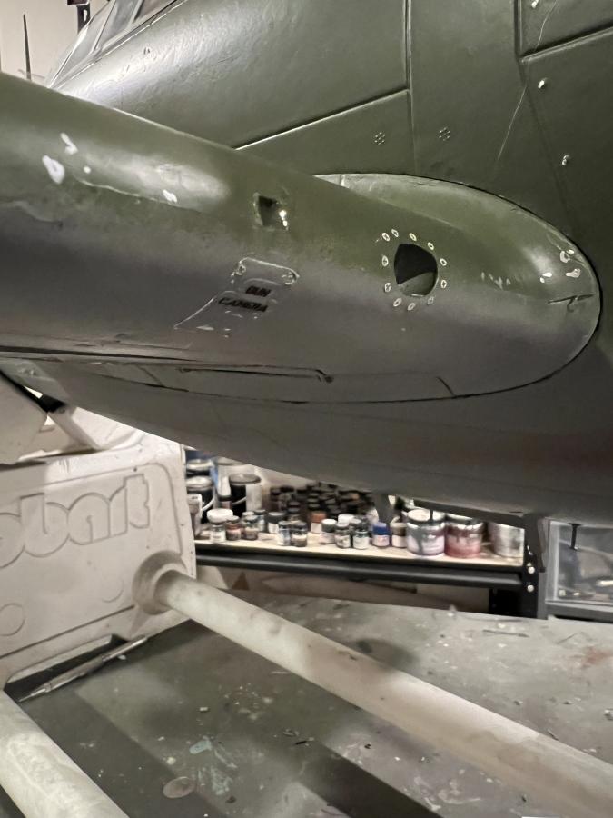

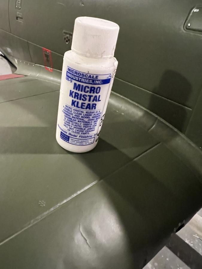

                          I bet many of you scale modelers are already familiar with Micro Kristal Clear liquiid by Microscale. One of the details I have done on my three FMS P-47 airplanes is adding the gun camera port at the base of the leading edge of the right wing. I used a 1/4" square brass tube cut to size and fit it in place and used putty and sanding to make it smooth. I also added a simulated panel below that where they would have installed or removed the 16mm gun camera before/after a mission.
                          The problem I had was trying to make a little glass looking cover that protected the camera and lens in the windstream in flight. I guess I probably have used this stuff before because I've had it a long time in my kit, but it was easy to take some drops of this white, thick fluid with a toothpice and apply it to the open area of the brass tube. It dries clear, and looks like glass.
                          I'll attach a couple of pics. You may not be able to see it in the picture, but with the naked eye it looks great.
                          The larger oval hole in the leading edge of the right wing is a circular brass tube that I flattened a bit in a vice to make it oval. This simulates the intake cabin air port for ventilation in the cockpit. If you need to make a small area to look like glass, this stuff seems to work well. Give it time to turn from white to clear, could take a few days to do so.

                            Great idea Davegee. Should work well for the Corsair landing and identication lenses. Nice detail on wing too. Rex

                              I've had this stuff for years, not even sure I've ever used it, but it works great for small areas, they recommend about 1/4" size, maybe works on larger areas too.

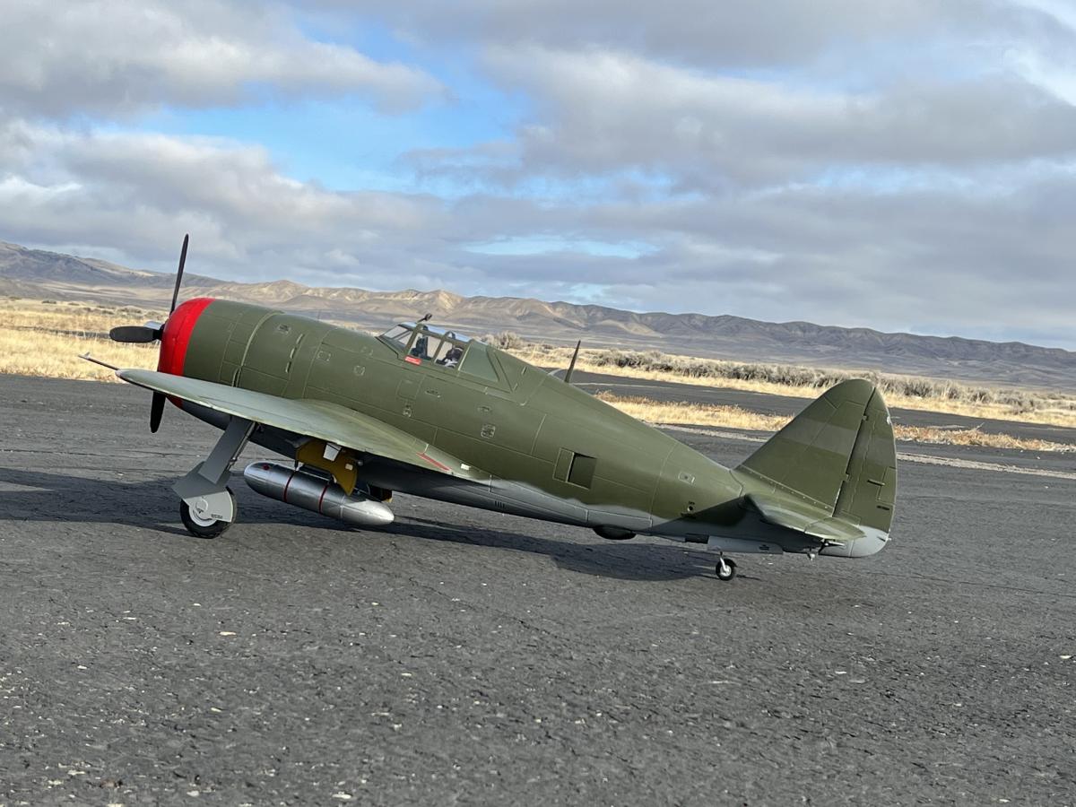

                                    Got a good flight on my FMS P-47D today using the larger V3 Corsair prop. I have three of these airplanes, I Wanted Wings/Button Nose was the testbed today. Weather was crisp at about 28 degrees F. very light right crosswind, and brilliant sunshine on this January day.
                                    This is the second flight with this airplane using this larger, more scale prop. I think for me, the added power given using this larger prop is noticeable. In fact, I kept the power back at about 1/2 throttle when it flew past me each lap, and the airplane seemed to be (without a speed gun to confirm) faster at a reduced throttle setting than using the stock prop.
                                    Setting up for landing, I did a low altitude run over the runway at about 3/4 power, did a fairly aggressive pitchout to the left and climbed to the normal altitude for a downwind leg, while extending the gear and flaps. The thing that surprised me a little was that once it got close to the ground for landing, it was zipping along faster than I've been used to, for the power setting I normally use. I got a nice touchdown on the mains but used a lot of the runway to get to a stop due to the higher speed.
                                    So, I think the V3 prop tests will definitely continue, and I hope to fully replace the smaller stock props with these more scale looking Corsair V3 props. I'm encouraged, so far.
                                    I'll attach a few pics after the flight today. I added a centerline drop tank, as this will be the configuration I'll use on the other two planes I'm currently working on. If you're familiar with this model, you'll immediately see that this propeller is much more scale (larger) than the stock issue.
