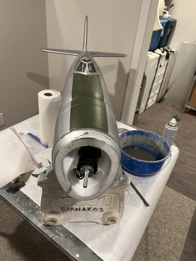

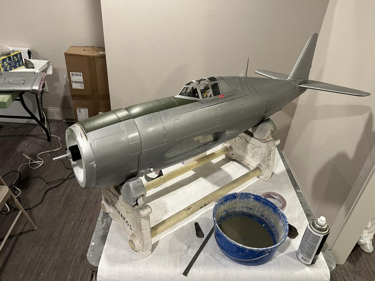

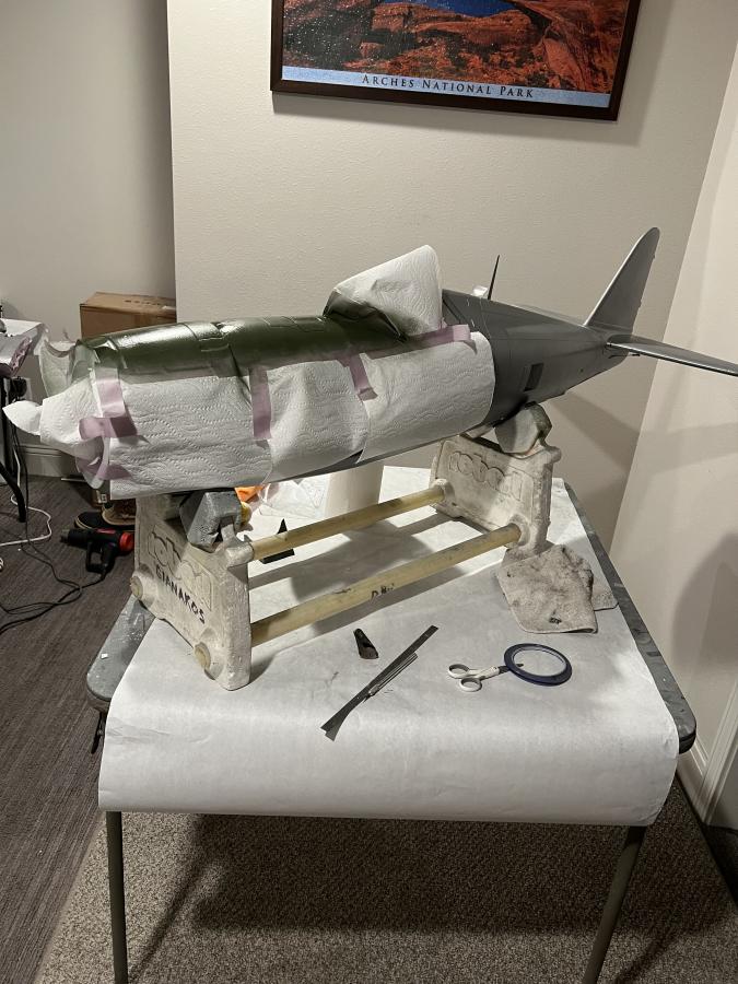

    • Work continues on my repaint of my FMS P-47D razorback. In the past several days, I completed all the patching and sanding I needed to do on the fuselage and wings. They were all painted with Minwax Polycrylic clear matte top coat. I went over everything between coats with #000 and #0000 steel wool to even things out and take any dust off. I then primed everything in Rustoleum 2X Flat Gray Primer and rubbed it down some more with the steel wool, in between coats. I painted the elevators/stabilizers with Krylon Fusion metallic aluminum spray. I'll send more pics of these parts as they are being painted.
      My attitude in all this is to make some nice scale enhancements to the model, maybe ones a lot of people wouldn't bother to do. But I like detail work on some parts,and still have a reliable good looking flying model for fun. For instance, on these razorbacks, one of the things they added was a trapezoid-shaped frame with armored glass in it 1 inch thick that was mounted at a diagonal in the windscreen in front of the pilot to give him some added protection. I designed a frame on paper, cut out plastic sprue, and then cut a piece of clear acrylic to fit the glass inside the frame with canopy glue. Then I glued the edges of the frame with canopy glue to the inside frame of the windscreen.

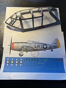

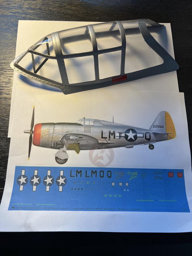

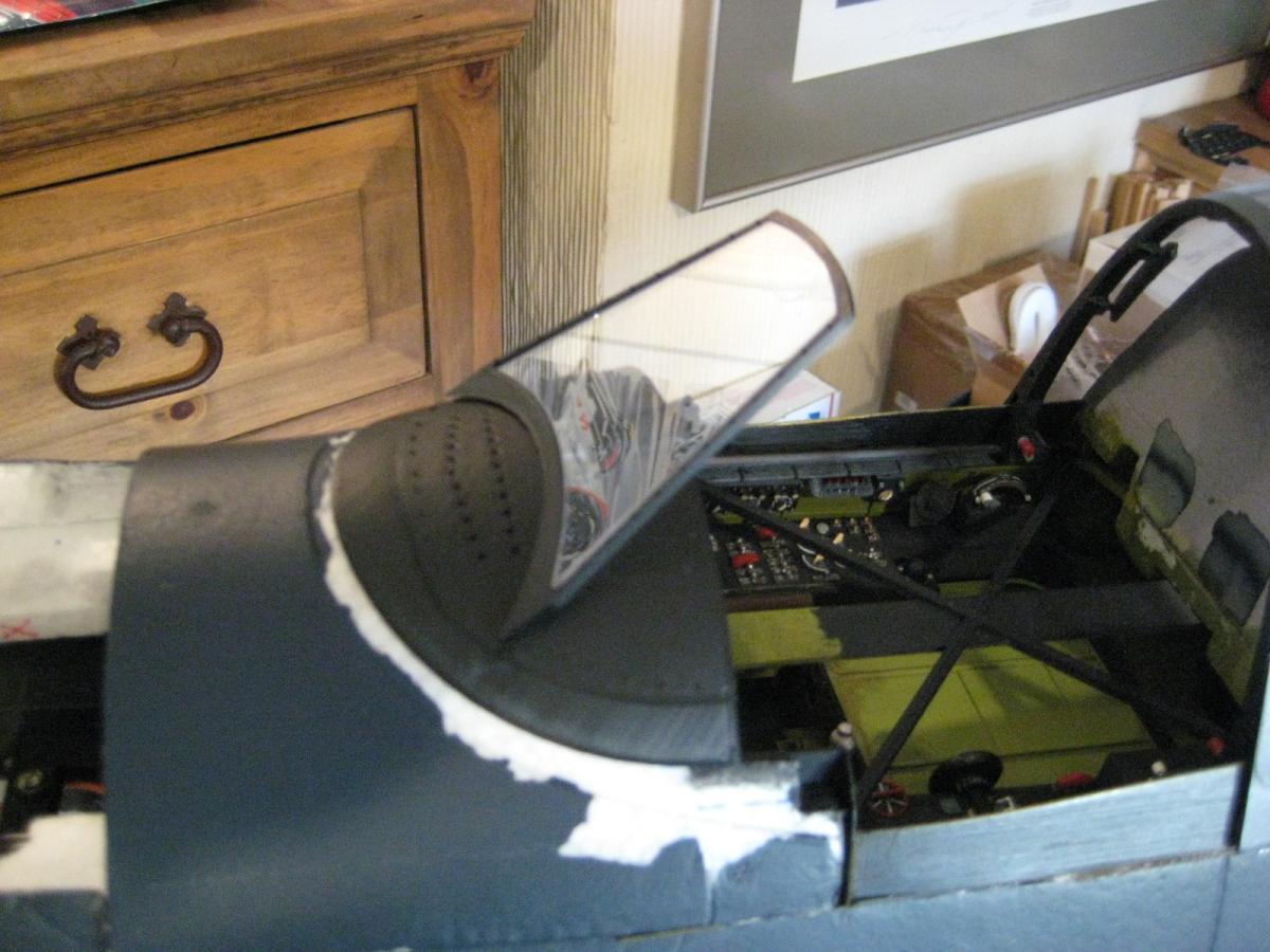

      I'll attach a pic of the canopy that I had to mask off each window section and paint silver. A bit of a pain, but I've done this a lot so not that bad. I like to use the Scotch lavender delicate colored masking tape to do this.Of course, curved window areas take longer to do with the compound curves, but if you take your time, you can get it done pretty well with hopefully no major goof-ups with paint on the window panes. Mine came out pretty well this time.
      More pics to come.

        • Exactly! As you know, the later versions of the Corsair adopted a windscreen design more aligned with the bubbletop P-47s and others, with a flat plate glass in the front that became the new protective armored glass to protect the pilot in that area. I'm glad you added this feature to your fabulous Corsair. Even if others miss spotting this detail, you and I both know we did it right!
            In my case, it was like a 'happy accident'.
            During my research, I saw this in some Corsair cockpits and not others. Now you've given me the explanation.
            Once I saw it, I couldn't "un-see" it and the cockpit just looked empty without it.
            Like you wrote, we know it is there, but not everyone sees it.
            Great work, as your usual, Dave.
            Best and have a relaxed Sunday afternoon.

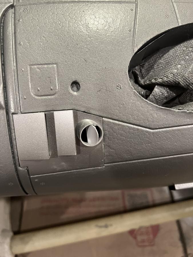

              • Here's a few more detail items on the P-47 today. The first two shots are me working on the ram air ventilation intake on the leading edge of the right wing. The smaller square hole is where the gun camera is housed. These are not finished yet but sorta "roughed in" for now in primer. The third photo you can see a rectangular white strip on the trailing edge of the right aileron. This was a fixed tab at the factory after they test flew each plane. Only on the left aileron of most US WWII aircraft was a trim tab that could be adjusted from the cockpit. I will be cutting that in later today with a razor saw and bending it to look like it has been purposely set for flying conditions. I do that for all my warbird planes was well as the rudder trim tab and the elevator trim tabs, one on each elevator. They worked together in tandem. I carefully score or cut through the molded marks of the foam tabs and then gently bend them up or down slightly for effect. They are so tiny that I don't think they affect the flying of the airplane one iota, but it makes them look a bit more realistic, to me, anyway!
                Click image for larger version  Name:	IMG_1693.jpg Views:	2 Size:	58.8 KB ID:	396916 Click image for larger version  Name:	IMG_1694.jpg Views:	2 Size:	89.0 KB ID:	396917 Click image for larger version  Name:	IMG_1692.jpg Views:	2 Size:	80.3 KB ID:	396918

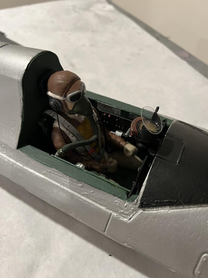

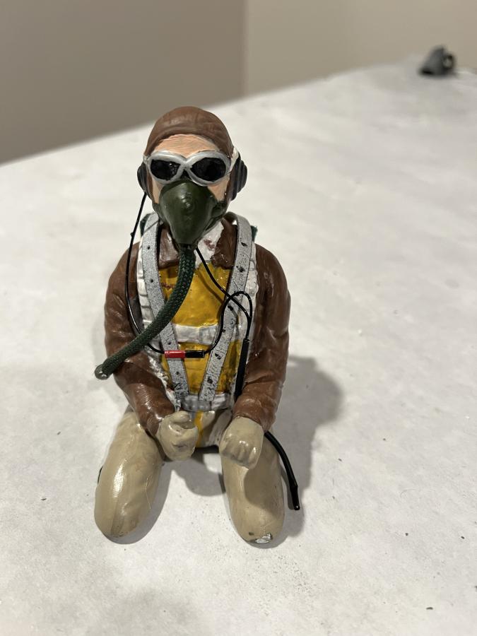

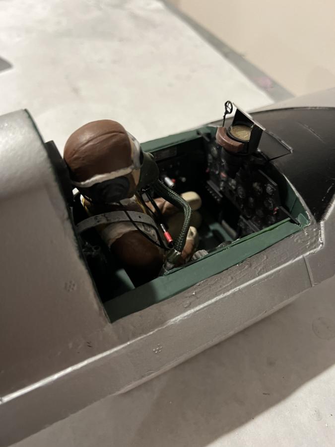

                              Here are some pics of the temporary pilot I am installing in the new plane until I can get a suitable printed pilot. Once I do that, I can replace all the pilots in the four Jugs that I have. This guy isn't awful, but my wife painted him up properly, and I just installed the scale headset wiring cables that they used. I got it from a photo in a museum with a mannequin. It is very accurate, and I have two of my four pilots set up this way right now.
                              Click image for larger version  Name:	IMG_1696.jpg Views:	0 Size:	56.6 KB ID:	396941 Click image for larger version  Name:	IMG_1697.jpg Views:	0 Size:	46.1 KB ID:	396942 Click image for larger version

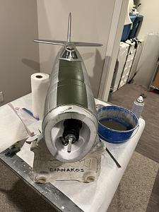

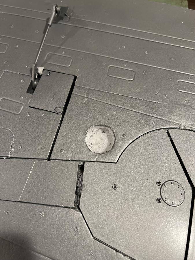

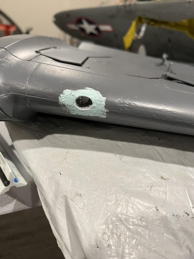

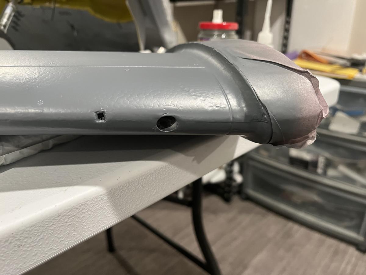

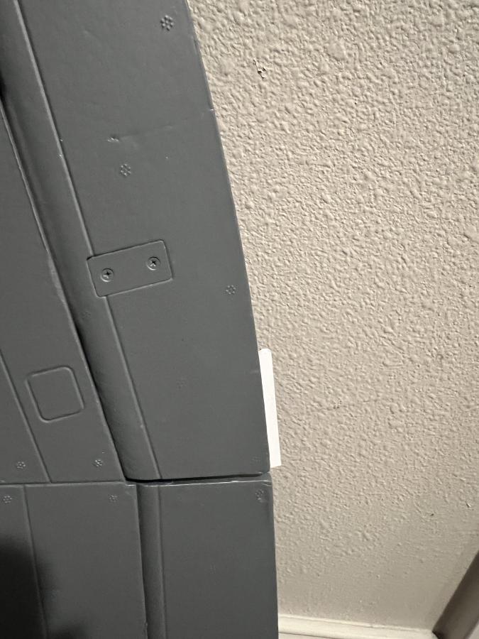

                              • I've been working on some detail items on the plane. I'll attach a few pics. One is a circular cut out in the foam wing behind the left main gear that will fit a somewhat scale looking landing light. On later airplanes they relocated this light to the left outer wingtip area. I took a 1 inch aluminum flashlight that I got online for 4 bucks, cut it down into a cylinder to fit in the hole I made in the wing and it will look like a retracted landing light.
                                Also, I cut down the engine exhaust stacks on the cowl and inserted a plastic disc to look like the open wastegate on each side. These wastegates normally closed as they gained altitude and forced the engine exhaust to go through the menagerie of turbo compressors, intercoolers, and intake air that delivered sea level compressed air up to 30,000 feet or more. This gave the Thunderbolt a decided advantage in dogfights at altitude. My late good friend Russ Kyler who ended up the war flying the M series P-47 told me their attitude was: "If the Germans came up to fight us above 25,000 feet, they were DEAD MEAT!"
                                Also, painted on the OD anti-glare panel on the top of the fuselage in front of the windscreen. Right now, I'm painting first in white and later in red, the cowl ring in the front of the fuselage. Finished the detailing of the cowling fake engine adding some paper pictures of the cylinders to make it look like there are two stacks of cylinders (for a total of 18).
                                Still lots more to do, but it is coming along.

                                • Just finished painting the cowl and some detailing of the engine section. The 56th Fighter Group, the highest scoring USAAF unit operating in the European Theater in WWII, after several color iterations settled on red cowls for all three squadrons. The markings for the 61st FS adopted Red rudders, the 62nd FS which this is one had Yellow rudders, and the 63rd FS painted their rudders blue. This plane I am replicating flew in the 62nd FS with Robert S. Johnson briefly making his final two kills before rotating back home from a very eventful tour of duty in England.
                                  Vinyl transfers markings should be coming shortly from Callie, and I think in a couple of weeks I'll be ready to resume test flying this airplane. I have 7 good flights on it so far. I'll probably continue to use the stock shorty prop on it for a few flights before converting it to the larger V3 1700 mm Corsair prop that I have on my other jugs.
                                  • davegee, Looking exceptional. Diggin' the high-end detail. It is those subtle little things that set some models apart. Best, LB
                                    • Originally posted by Elbee View Post
                                      Thanks, Elbee! I guess we all have our own little "signature" additions or embellishments to our models to personalize them a bit. I think this one is coming along nicely and I look forward to taking pics and flying it at the field sometime soon. Doing a subject in NMF is a fun diversion from my usual camo airplanes.
                                      Will post more as I proceed towards completion.
                                      • Davegee,
                                        Gonna be a stunning model. Little details really add character. Not a bad way to spend in February.
                                        • You bet, Rex. This is really the fun part, detailing and accessorizing the model. I see a light at the end of the tunnel, and it is Not an incoming train, so far!
                                          cheers
