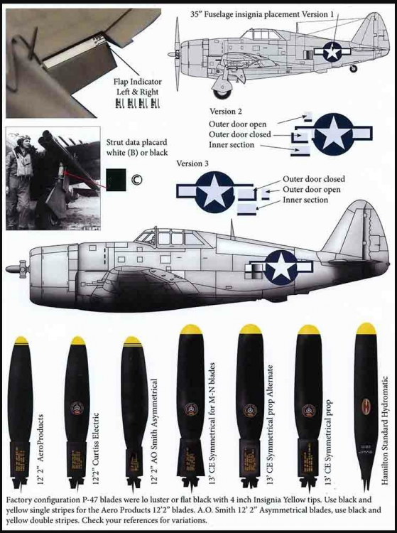

    Hi Rex: I pulled up this fact sheet that I found online regarding Curtiss Electric props. As you can see, during the war they continually modified them from the early "toothpick" to ones that had a pretty wide chord that seemed to help performance quite a bit. There are two Curtiss props that are near the right edge of the lineup that I used as a pattern, knowing that there is really no way they could be absolutely right on without casting all these parts yourself. I wasn't going to get into that level of detail (and brain damage!), so I settled with a simpler making of cuffs from styrene, instead.
    I'll still have to see how full power runups and actual flying tests go before I can know this idea is workable. I think it should work, but that's why I'll do the tests to see how it goes. Will let you know, but it will probably be a little while as we have a major weather alert for most of next week for snow, wind, and even some rain!

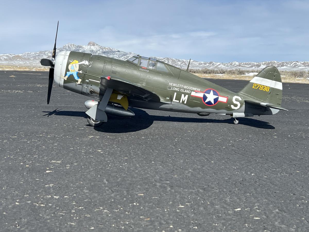

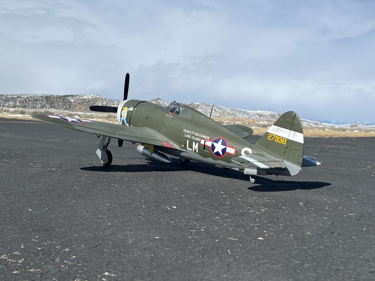

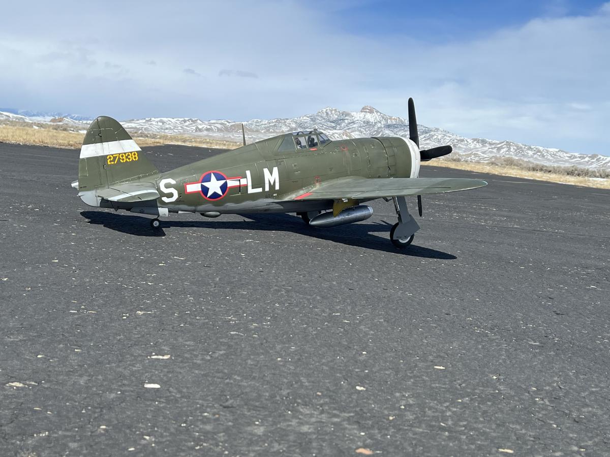

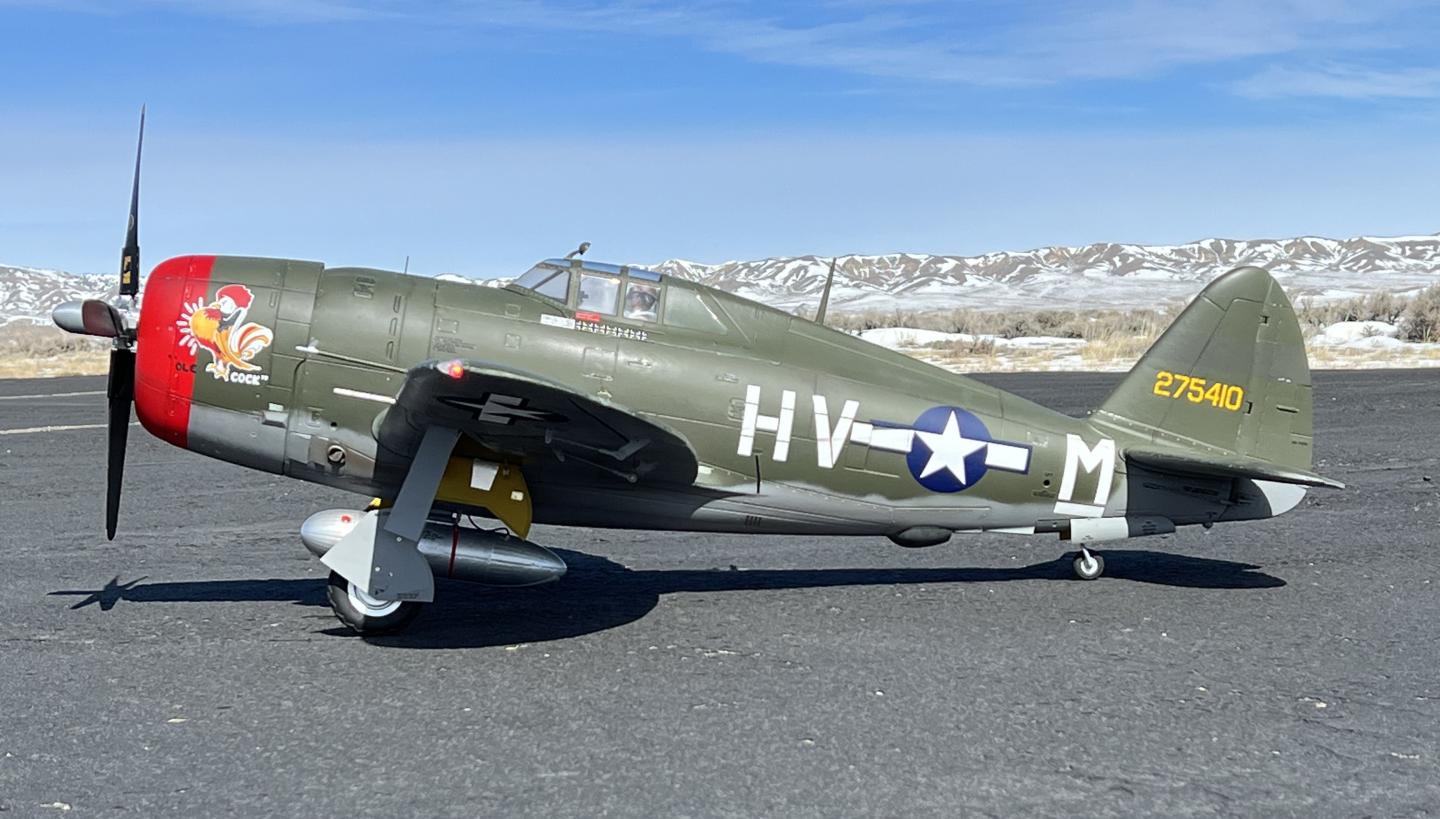

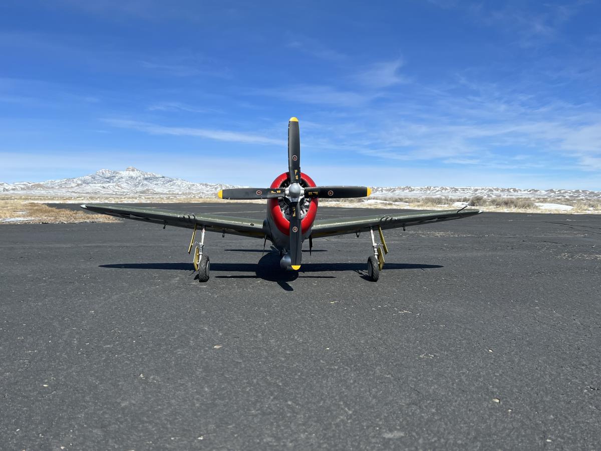

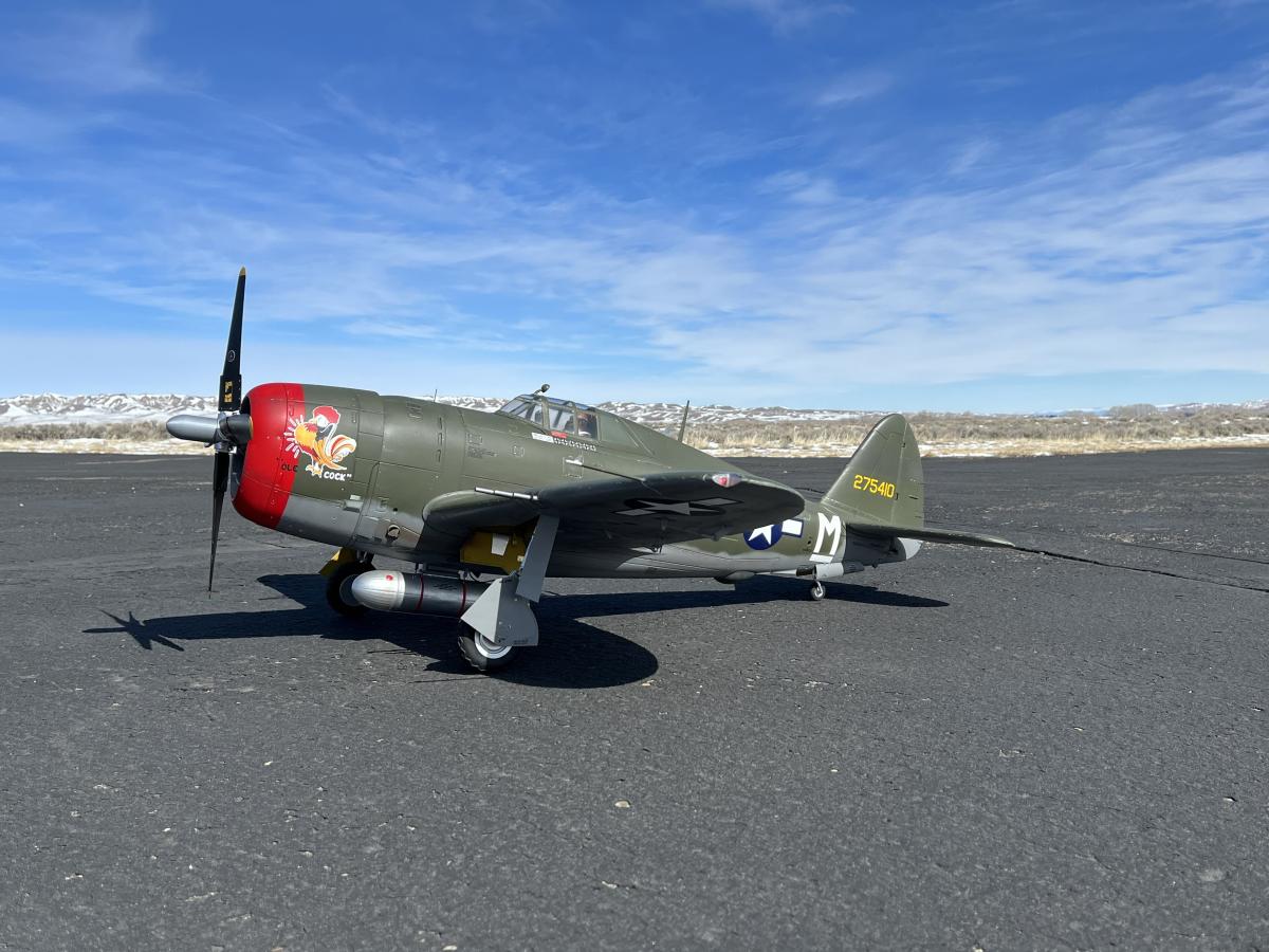

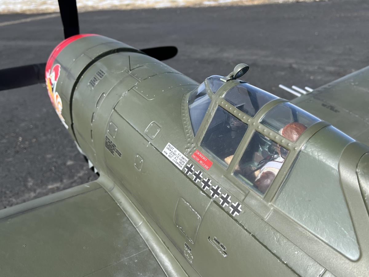

ID:	372976 I was able to get out to do my test flight on the OLE COCK P-47D with the new cuffs on the props and a new 3D printed Curtiss Electric prop dome. After the usual preflighting of another range chack, taxi checks, and full power static runup tests, I was ready to take it up for a flight. I have at least half a dozen flights on this airplane already, but this was the first with the new prop and prop dome arrangement that is scale for the majority of P-47s produced during WWII.
                    Takeoff was great, slowly advancing the throttle while applying increasing right rudder to keep it straight on the runway. Took off easily with about 3/4 throttle, and then I increased it some to do some maneuvers after I retracted the gear. I took off with the flaps up which was pretty standard with most P-47 takeoffs back in the day.
                    I was waiting to see if the plastic cuffs that I had made would come apart and fly off, but they stayed in there great. The sound was a bit different, but it had plenty of power, in fact I think more power per throttle position than I had with the smaller, stock prop. Did a few military maneuvers like barrel rolls and steep climbs, and then came in with a low pass, and pitchout to the left as I set up in a downwind leg and dropping the gear and going to full flaps. Plane came in fine, although I kept a little more power than I should have, but what had been normal setting with the smaller prop. Had a bit of a headwind, the airplane ballooned a bit but I decided to salvage the landing instead of going around for another try.
                    Touched down fine although at taxi speed it went off the side of the runway slightly into the dirt but no damage at all. I'll work on my landings. Been a while!
                    So, next time I'll take my other Jug Hairless Joe with the modified V3 Corsair prop and printed prop dome like this one has, and give it a go. At this point, I am encouraged that doing scale mods like this larger prop with the cuffs and 3D prop will definitely work for this airplane.
                    Attached are some pics after the flight today.

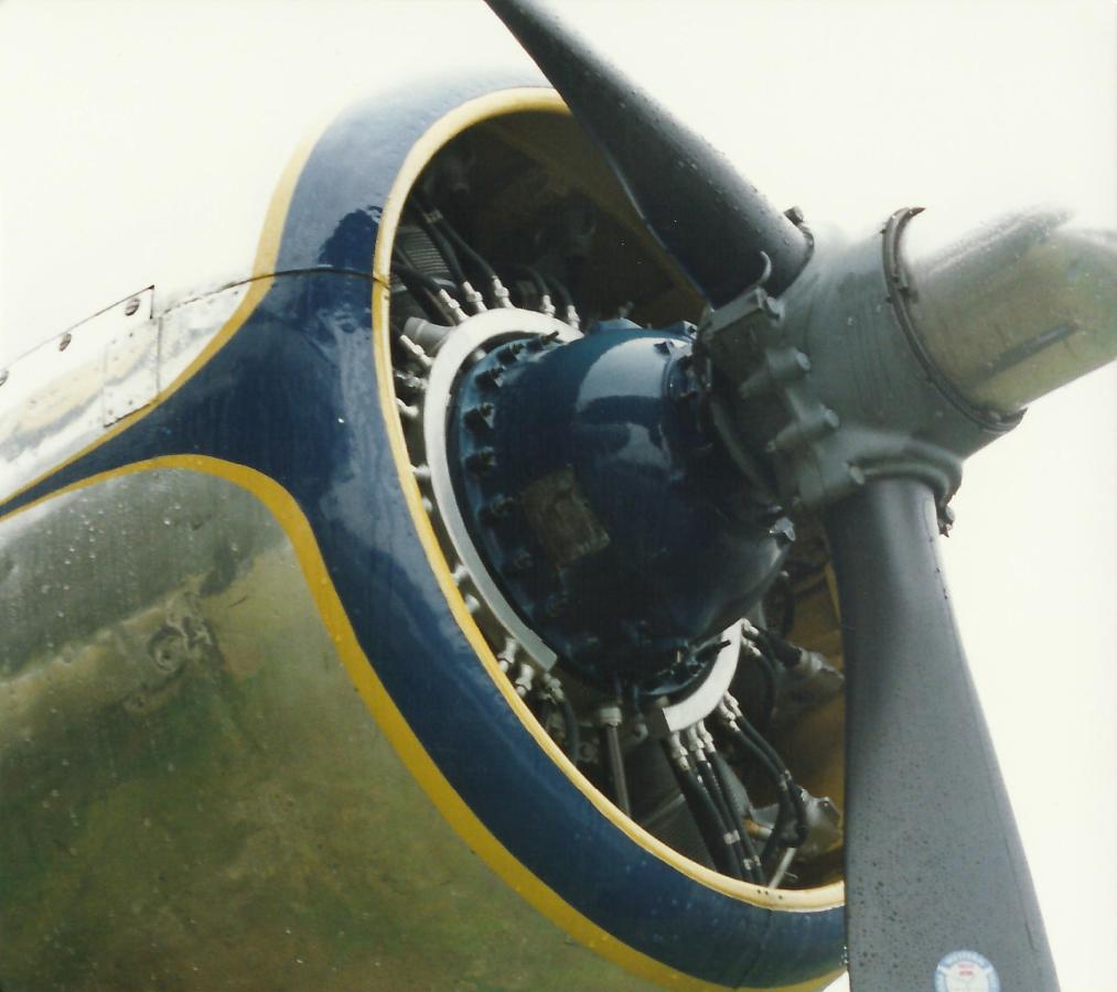

                              Hey Dave, way back in post 911, you have a picture of your P 47's motor, what did you use as the electrical collar that feeds the wires to the cylinders? I was trying to think of something that would work on the F7F motors. I thought of using wire from packing slips for the leads, but still haven't come up with something for the collar.
                              Here's a pic from my DC-3.
                              Any suggestions?

                                Hi Dan: your picture shows the wiring harness for an R1830 14 cylinder engine, and has a flat curved wiring harness. Both this engine and the R2800 that was in the P-47, Corsair, Hellcat, and F7F Tigercat had the R2800 and I think almost all of them had a round cylinder versus this flat curved harness.
                                What I did was find some flexible solid tubing that was about the correct diameter as seen with pictures of the real thing. I cut it to length and bent it around something that was about the same diameter as the crank case of your airplane. You should be able to find something you can buy at Ace Hardware that will work. Once you have the shape, no matter what material you use, you can add little cylindrical nubs onto the outside of the curved piece you fabricated, and then run two wires out of each one to the cylinders. If you have a tube bender, you can use aluminum tubing, I'm guessing about 1/8 inch diameter or so, that could be curved and cut to fit around the crankcase of your Tigercat's engines. You can make a very believable looking motor if you have some good pics of the real ones and mimic as much as you want to how the full size one looks. Very doable.
                                Let me know how it goes.

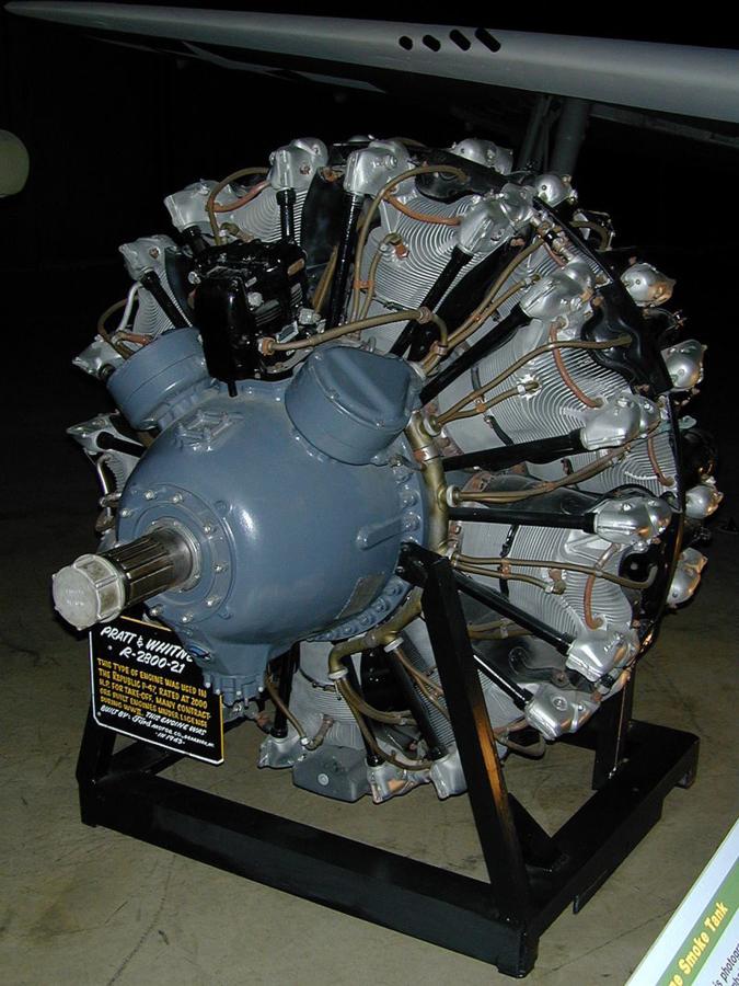

                                  Thanks Dave, I have this pic and it's pretty good. Interesting that the R2800 harness was round where the 1839 was 'flat'

                                    That's a good picture to go from, I'm familiar with it. The colors of the wiring to the sparkplugs varies quite a bit. I've seen them in this gold or brass color, black, silver, maybe other colors, too. You can imagine with so many thousands of engines being built by P&W and probably several other manufacturers under license to P&W, other materials would be approved that would vary the colors a bit.
                                    I saw a B-17, can't remember which one now, but when it was parked a the ramp for the day, I looked at the R1820 engines. on the wings. The placard said "Studebaker" which I researched did a lot of the building of these engines under license to Wright-Cyclone corporation during the war.
                                    Let me know what you come up with.
                                    I've seen some flat harnesses but I don't recall any on the R2800, but it is possible one of the suppliers had a flat harness approved for installation on this engine. But every one that I've seen has been tubular, like what you show in your photo.

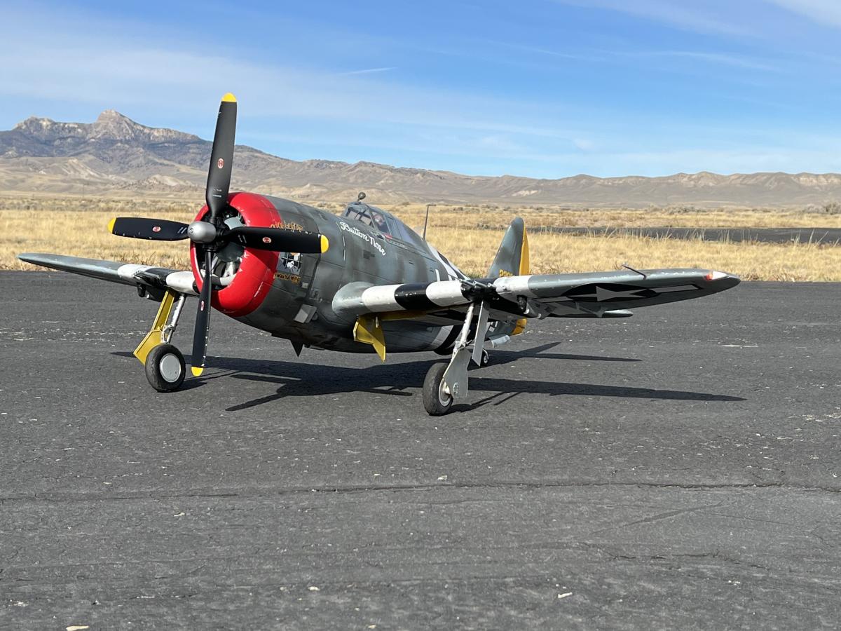

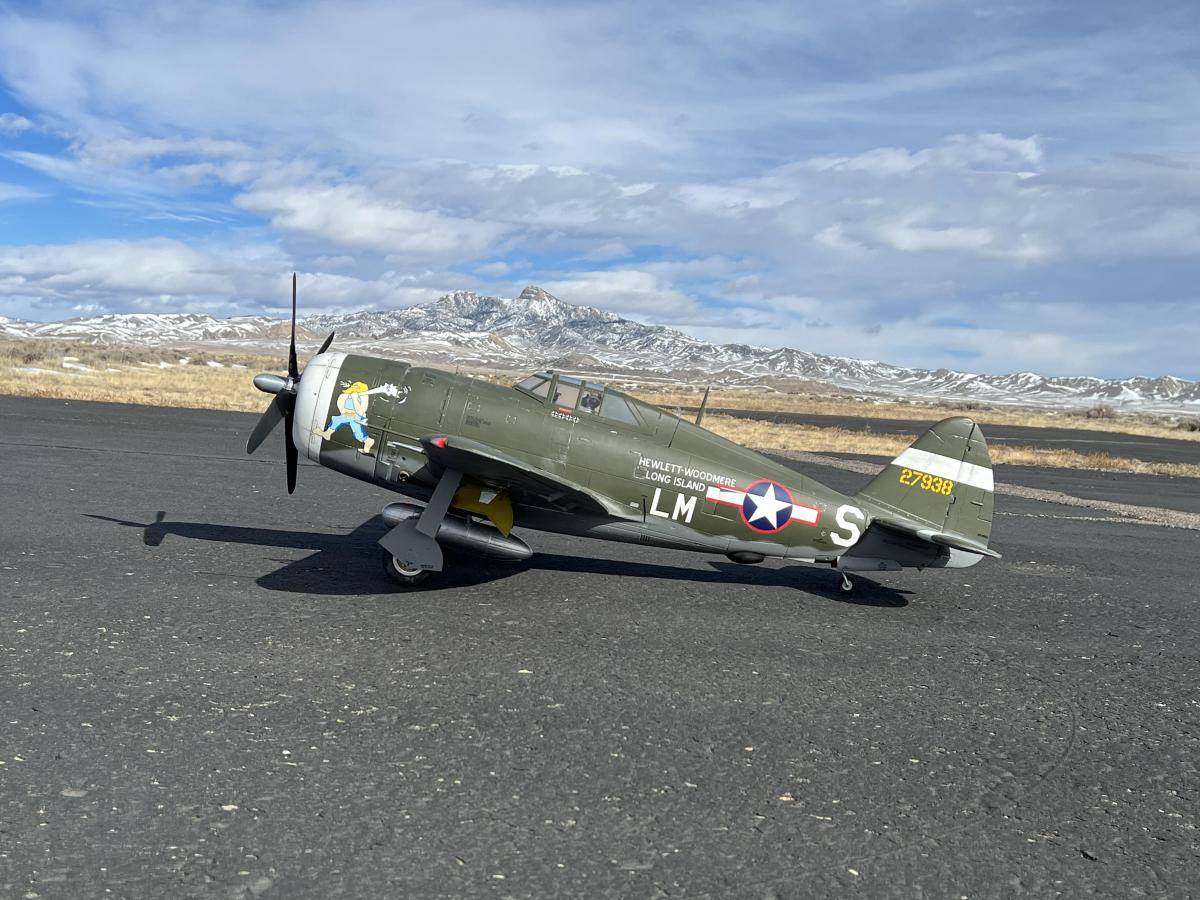

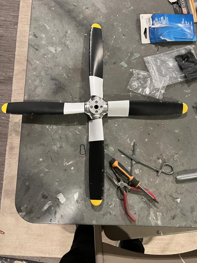

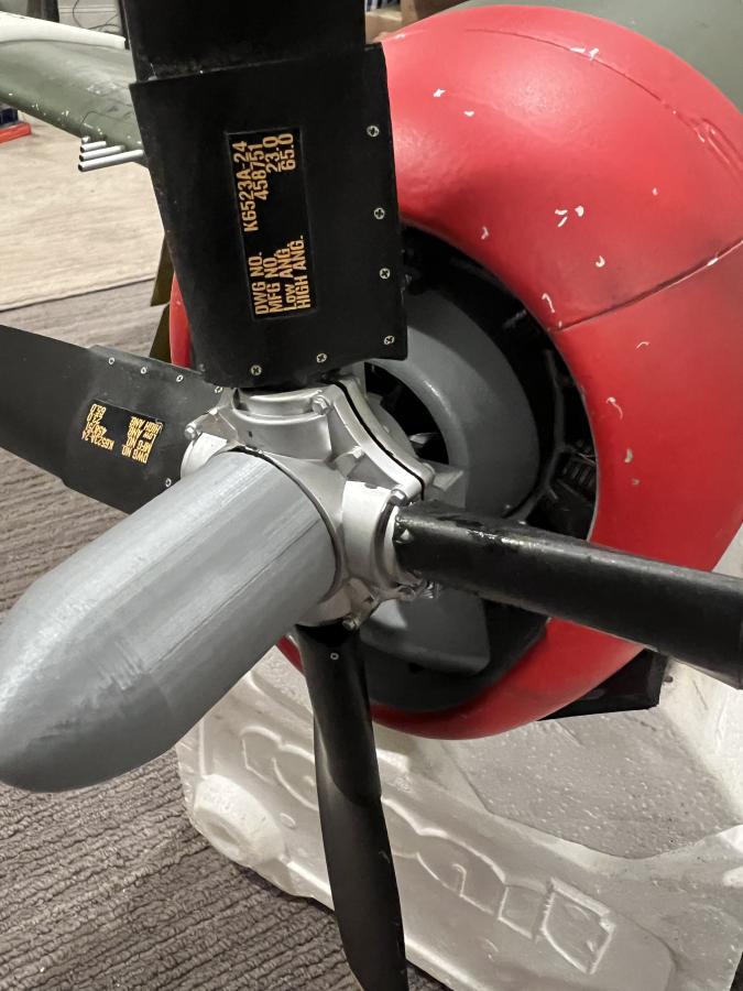

                                      Did get to fly the Hairless Joe P-47D with the longer prop, cuffs, and Curtiss prop hub that was 3D printed. Got a good test on the ground with a couple full power runups and it was ready to go. However, after a normal and good takeoff, when I was climbing and turned on a downwind leg in the pattern, I heard a sudden "POP!", pretty quiet, but one I had never heard before. I suspected that one of the cuffs might have departed the airplane, but it was flying normally and I continued my test flight. When I landed, I got a pretty good landing, two-point, tail low, as I try to do with all these warbirds, and as it rolled out for landing, it suddenly made a sudden right 90 degree turn and I had no control over it. One of the few weak points of this airplane is the little plastic pin that fits in the tail wheel steering bracket when the gear is down, and allows the tailwheel to steer. I figured the pin must have brroken somehow, but it happened when the plane was going slowly and went off the runway into the mud. No damage, but I'll replace that pin with a metal screw that seems to do the job.
                                      I wish they made that whole part out of metal, maybe I'll fabricate one someday, that won't break.
                                      Regarding the cuff, that is easily replaced making another thin .005-.010" thick plastic sleeve and gluing it back on where the other one departed today. The final fix would be to have a cuff 3D printed that I will probably eventually go to. This is all test stuff right now, so there is a lot of learning involved, which is a good thing. Attached are a few pics of Hairless Joe after today's test flight.
