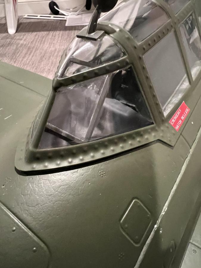

            I added a little detail to my new P-47 model, this being a simulated bulletproof glass shield that was mounted in front of the pilot on the windscreen. It is sorta trapezoid shaped, to fit in the shape of the windshield frames, but was yet another piece of protection for the pilot in combat. I've attached a pic of it for those interested. The frame is plastic sprue, and I used a piece of plexiglas cut to fit inside the frame. It was then glued in place. I also "borrowed" a rear view mirror from my parts pile for the Flightline Spitfire Mk. IX and glued it on, too. The real plane that I am modeling had one, so I put this one on to match it.

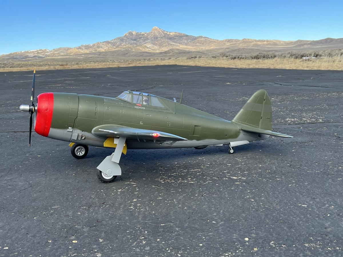

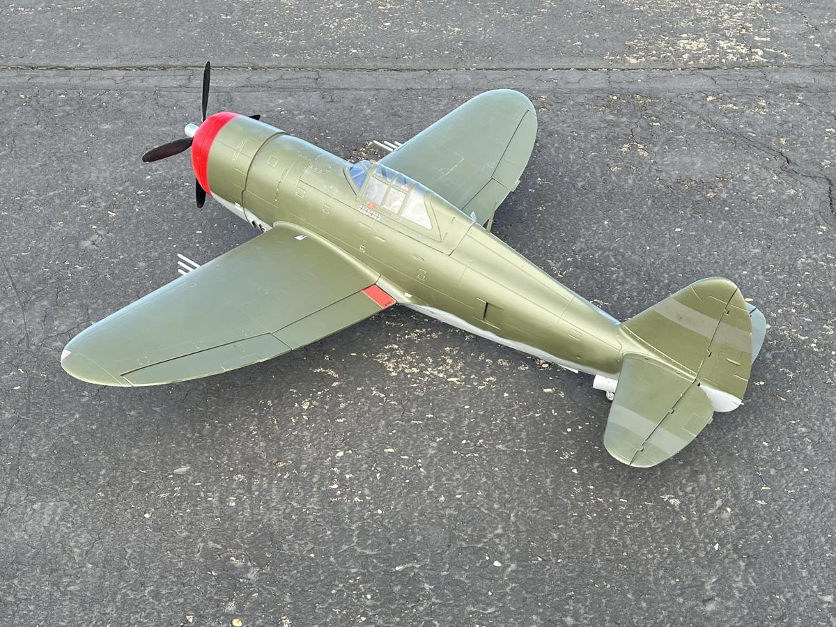

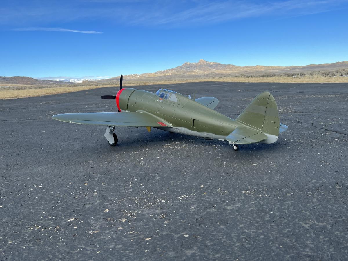

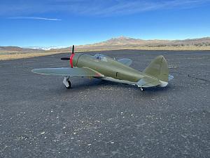

                  SUCCESSFUL MAIDEN TODAY!!
                  Even though this newest jug model is still a work in progress, it was pretty much ready for the "moment of truth" to see how well it flies before I proceed further on the details. We've had some pretty tough winter weather for the past month or so on and off. Winds, snow, super cold temps sometimes, and just weather not suitable for flying all that much, especially doing a maiden on a fairly high performance airplane, even if it is a foamie.
                  There's just so much checking and rechecking of control throws, CG, etc., but at some point, you've got to put it on the runway and let 'er rip! This maiden started off very well after doing range checks, taxi tests, and full power static runups. It came through all of those just fine with just a very few squawks like a very slight turn to the right when the airplane is pushed forward by hand, which is easily correctable by retrimming the tailwheel slightly. Everything else checked out ok.
                  Since I have a couple other of these FMS 1500mm P-47 models, I am fairly used to how they fly. LOTS of right rudder on takeoff runs, and land with power in a two-point, tail low attitude, and just "hunt" for the ground to get that nice soft touchdown on the mains.
                  Takeoff was normal, but I did add a few clicks of down elevator as it wanted to climb some when I was trying to fly level with the gear and flaps up. It likes to fly fast, and is very nimble making maneuvers that the real plane would make. It was about 28 degrees out, a right crosswind, and although sunny, pretty darned cold, so I got several passes over the field, a few barrel rolls, and then set up for a landing. Even though I had not ever flown this particular plane before, it acted just as I expected it should with one of my better touchdowns and rollouts to a normal stop on the runway.
                  I'll attach a few pics of the plane after the maiden. You'll see there are no real markings on it yet, those will be coming from Callie in due time. But I just HAD to get this maiden under my belt!
                  For those interested, early P-47s flying in the ETO were outfitted with a white noseband, and white stripes on the upper surfaces of the horizontal stabs/elevators, and one across the vertical fin/rudder to help friendly gunners (especially in bombers) from mistaking them for FW-190s as they had some resemblance, especially when flying past the bombers at 400 mph!
                  In time, this unit (56th Fighter Group with the moniker in Latin "Cave Tonitrum," "Beware the Thunderbolt!") started making changes to the identification of their aircraft. They later settled on red nose bands on every plane in all the three squadrons, painted out the white bands on the tail with darker olive drab paint, and is how the airplanes looked in early 1944, with more changes coming. In the photos, you can probably see the dark OD stripes painting out the white stripes that go with this time of the war.
                  This particular plane was named "OLE COCK" by its pilot, Lt. Donavan Smith, 61st Fighter Squadron of the 56th Fighter group. Before your mind starts wandering on the meaning of that name, it was simply a greeting or salutation the Brits made when meeting other men, even spreading out to greeting the Americans who lived among them. Smith painted a rooster (cockerel) on the nose of the plane, one of Callie's embellishments I'll add when I get the package from her.
                  Smith distinguished himself as an ace, squadron commander of the 61st Fighter Squadron, and eventually attained the rank of Lieutenant General (three stars) in the USAF before sadly passing away early due to brain cancer at the age of 51.
                  I'm proud to paint up and fly this airplane in his honor.

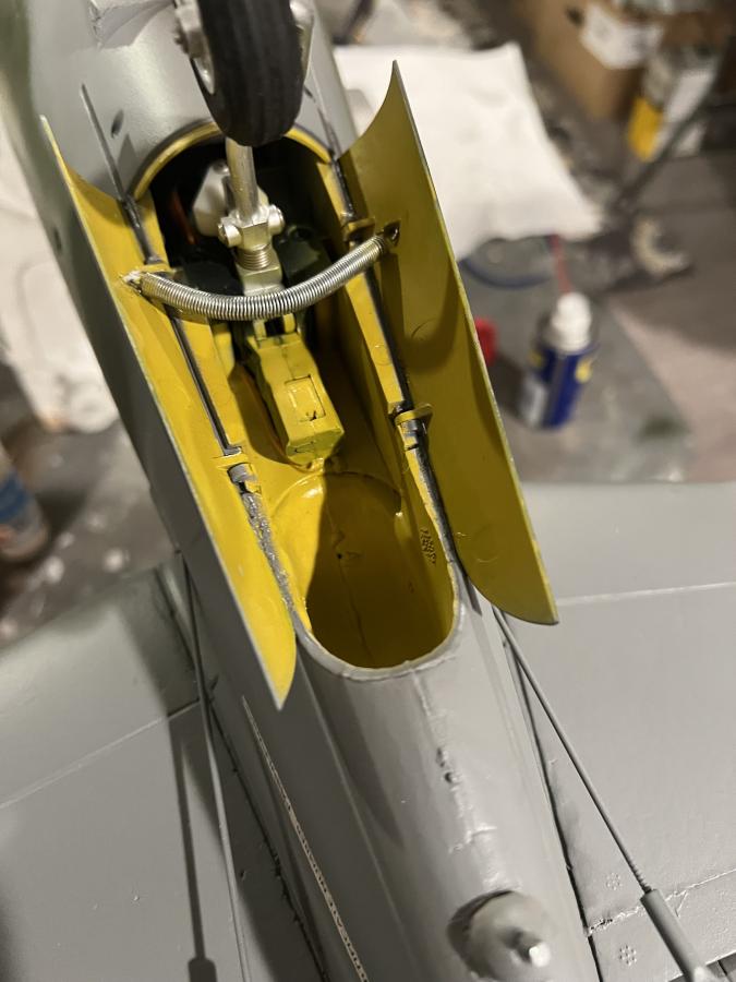

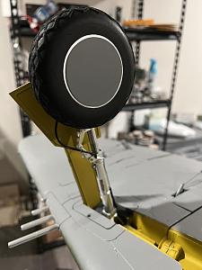

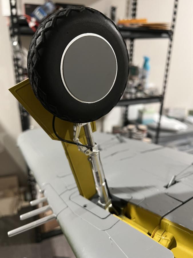

                            Just completed a few minor additions to the plane this afternoon after the maiden. One picture shows the retracted landing light. I used a "mini mag" light reflector, bulb and cover that was approximately the correct size and cut a hole out on the left wing behind the landing gear. Early jugs had the landing light here, later ones they moved it to the left wingtip. This light is non functional, just for looks as it would be retracted for almost all flight operations.
                            Also, attached is a photo of the wheel and one of the scratchbuilt wheel covers for the earlier model jugs. Later models they did away with these and just showed spoked wheels.
                            Last is a photo of how I circumvented the poorly designed tail wheel door retraction set up. On the real plane, these doors were mechanically retracted or splayed out as the gear went up and down. The model has the doors hanging down and attached with springs to the tailwheel strut. But this makes the gear doors sashay back and forth on the ground as the tailwheel is moved. I think FMS mostly did a super job in designing this P-47 model in almost all aspects. But the tailwheel door design I'd have to say "used poor headwork."
                            The fix, and I got this from someone many years ago when the model first came out, was to string a small spring across the gear doors. This does two things. First, it forces the gear doors to be splayed out more than the original FMS design, and allows for the gear doors to smartly be pulled closed after the gear strut pulls on the spring, forcing them closed. Works great, been using this for years. Also notice the scratchbuilt object at the bottom of the tailwheel area. This was a hardpoint to attach a jack to to safely raise the tail area.
                            Also, the plane comes with painted green zinc chromate gear wheel wells and other interior parts. They should actually be yellow zinc chromate, and I used an airbrush to paint them after I taped them off. I think some of the contractors sub-let from Republic like Curtiss might have used the green, but the vast majority were yellow.

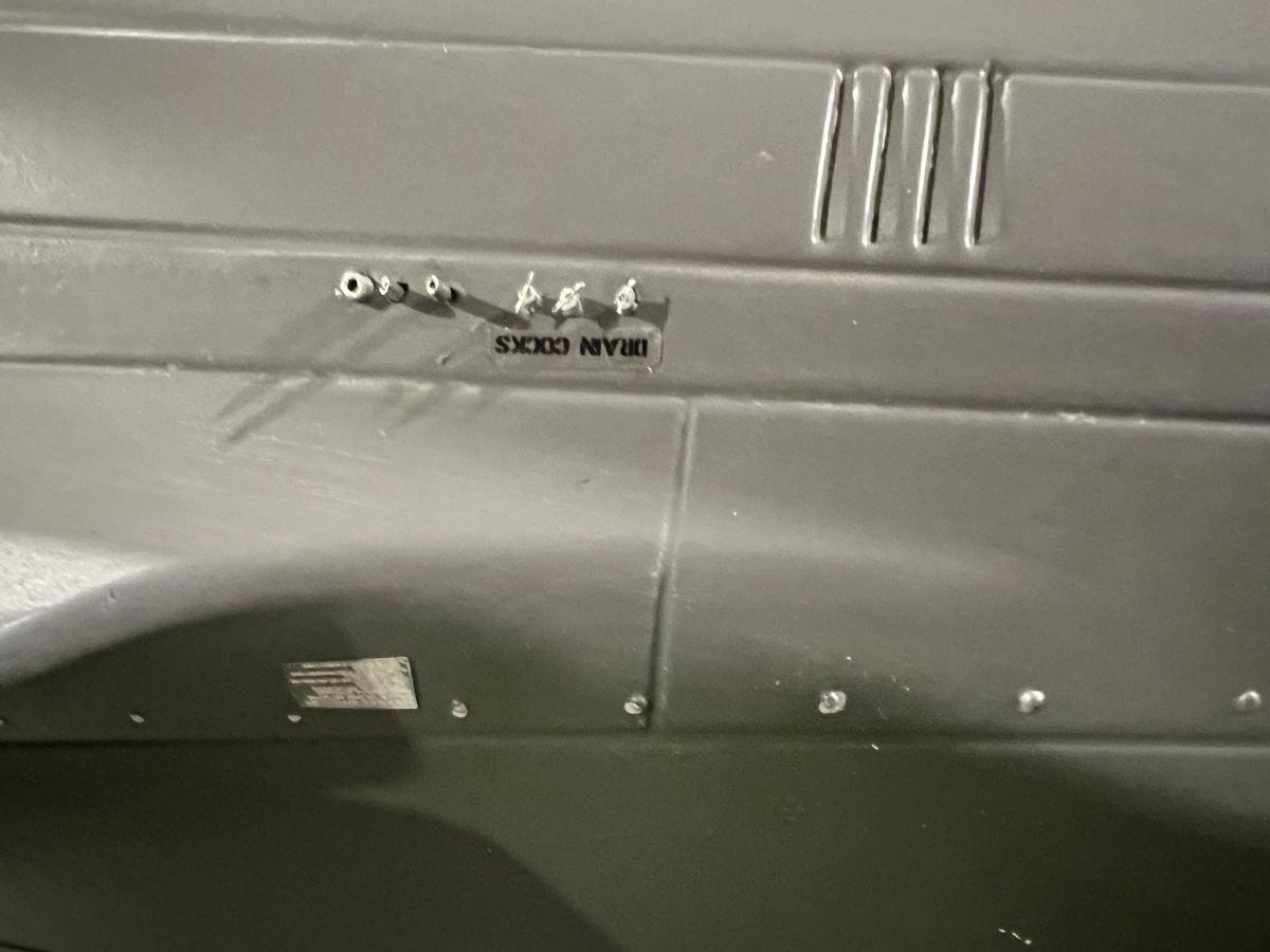

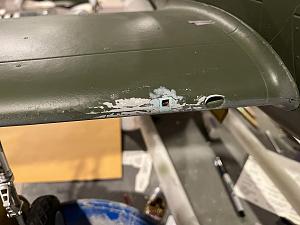

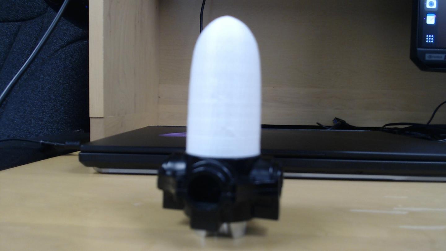

                                      I'm adding little details now as I wait for a Warbirds pilot in the mail to see if that will work for my cockpit or not, and Callie's decals which might not be here for another month. I'm glad I got the maiden out of the way, so now I'll continue to work the myriad details that I want to add to the model. I'll include some photos of what I have been doing the past couple of days.
                                      Non-functional but I think cool details I've been fabricating and installing on the jug yesterday and today. For the main gear, I have simulated brake lines in both aluminum and flexible rubber tubing for this. Still some more details like connectors and such to do.
                                      Installed the oval fresh ram air cabin intake on the leading edge of the right wing, and the square gun camera port nearby. Still work to do on that, and eventually painting it. Used brass tube and square tube for this. Flattened the round brass tube to an oval to approximate the shape of the air vent. Will eventually add a clear plastic cover for the gun camera port.
                                      A series of vents and drains were along just below the trailing edge of the right wing. There were three fuel cocks to drain any water in the fuel at the low point, and several other vents and drains, all in a row. I made all of these out of aluminum tubing.
                                      Also, I have been working with someone on the East coast to fabricate a scale Curtiss Electric prop dome on his 3D printer. I drew up the plans, and he sent me a test view of what he has come up with so far. I think we're very close, and he's going to print it on a resin printer to get it as smooth as possible and make my finishing work easier and less time consuming. I have made up some sleeves to put over the base of the propeller blades to simulate the look of the Curtiss electric props.
