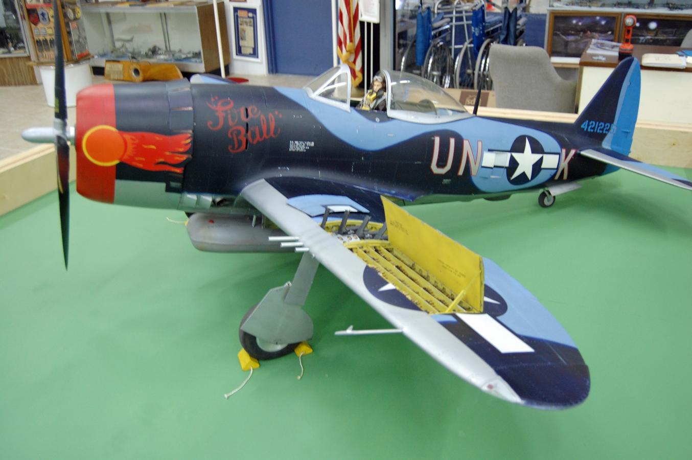

I have made a number of jugs in the past, some big gassers for RC meets on a national level, and now doing foamies these past several years. One of the gassers I made up in the original early paint scheme with the white nose and tail bands (to try and keep "friendly" but nervous gunners on bombers from shooting at them, thinking they were FW190s!!.
The other planes, almost all from my favorite unit, the 56th Fighter Group, had varying paint schemes, some pretty wild, near the end of the war. For this project, I've returned to the more subtle paint scheme used earlier in the war, about 1943 time frame.

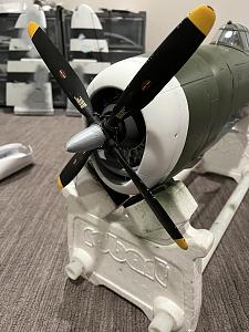

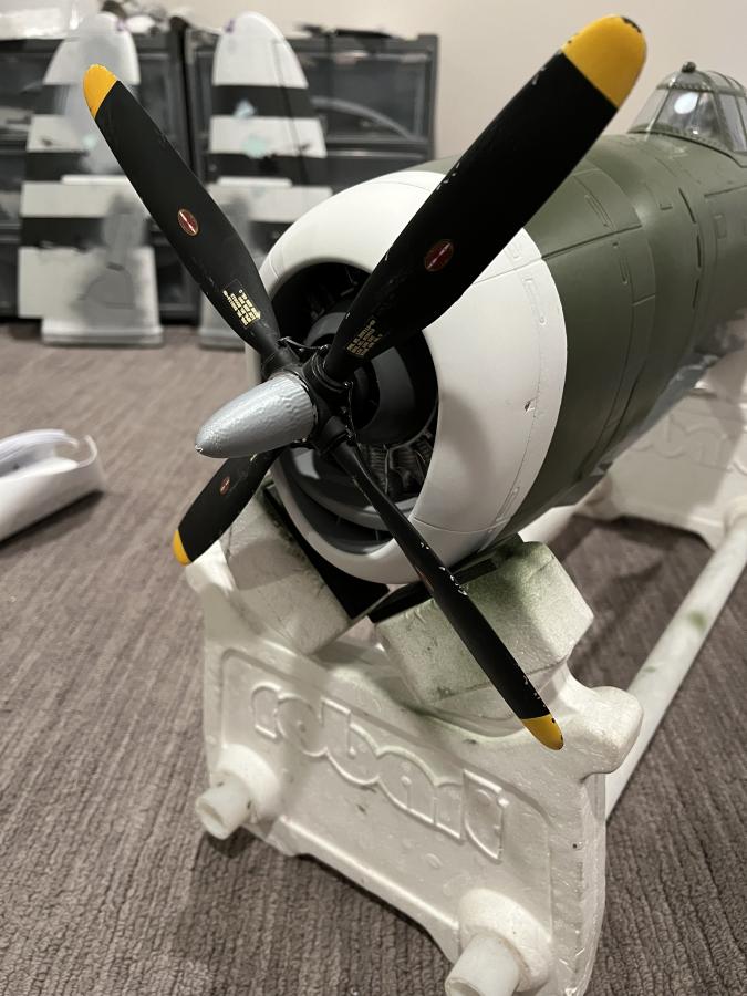

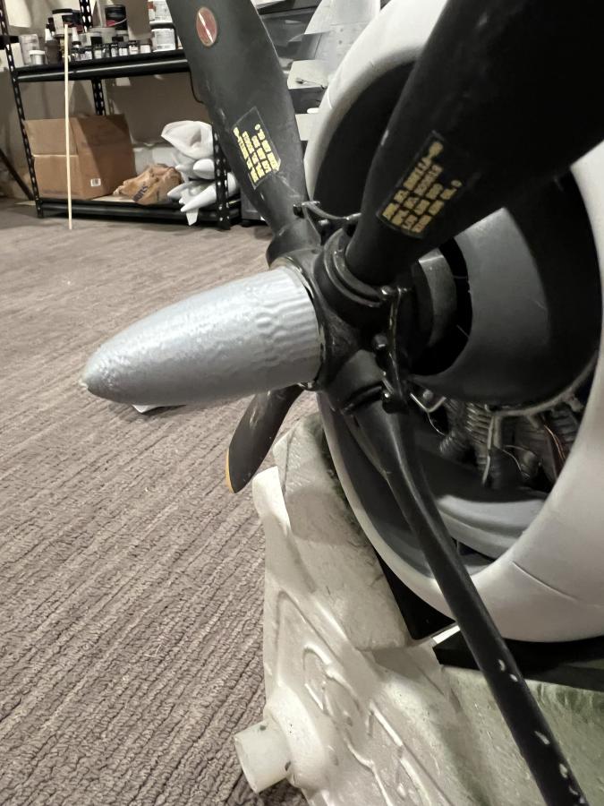

Another thing I am doing to make the model look a little more accurate is to put a Curtiss Electric Prop hub on it. Many, maybe most, had this more slender, bullet shaped dome on their propellers. The other kind, that comes with the FMS kit, is the rounder, squatter, Hamilton Standard prop dome, which is fine, too.
I scaled up some drawings of the real airplane with the Curtiss prop dome, and then sent them to someone who made the 3D prints for me. He made several of them. They are a bit rough on the outside, but very sturdy. I hope to use putty to make them smooth looking, and then paint them silver. These you get the basic idea in the photos. I have another FMS P-47 that I will do tests on to be sure they are safe and suitable to use for flying. I don't expect any problems.
I really like the look of these scale prop domes for my P-47 that I am making over for a specific paint scheme. I may have one made up out of aluminum to avoid having to smooth out the skin of the dome.

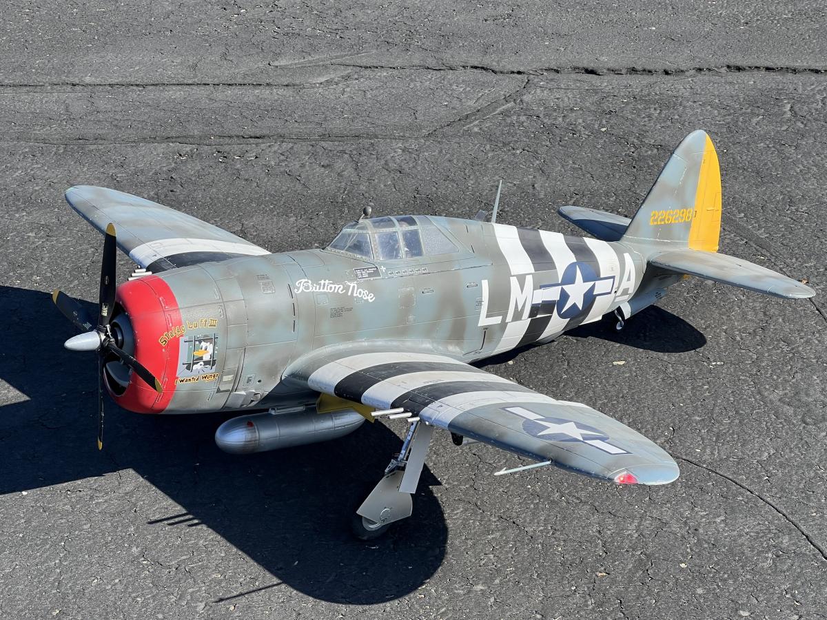

Here's a couple of pics on my P-47 now in paint and later detailing to finish it up.

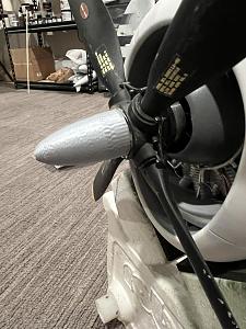

Success!! Did an operational test of the new printed Curtiss Electric prop hubs today. Started by putting one on my other P-47 that normally has the rounder, blunter (FMS kit supplied) Ham Stand prop dome. I had pretty high confidence in this new part, but if it were to come loose or shatter under the stresses of flight, the prop would probably spin off and the airplane might be lost, or at least damaged.
So, I did a couple of full power static runups, it was staying on very well, and then took it up for two flights. Ran it through all the power settings, and it is solid as a rock. So, I think I'll be good to go smoothing out the skin of the prop hub to make it glass smooth, and plan on using it on my under construction P-47. Very pleased with today's results. Plans are to eventually have this part fabricated out of aluminum.
Attached are some photos. In one photo I placed the Ham Stand FMS supplied prop dome for comparison.

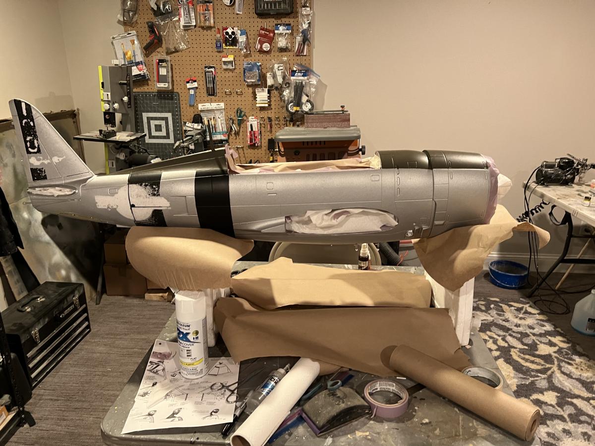

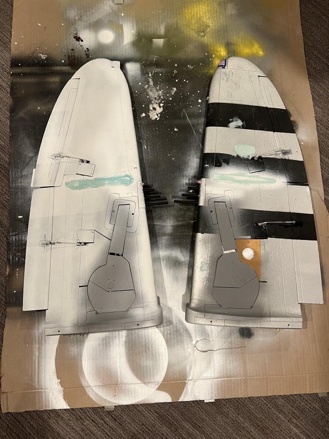

I've set the fuselage/tailfeathers aside for the moment, and am heavy in-work on the wings. Lots of stuff to do: fill in areas where the pylons and mount for the rockets would go, make a scratchbuilt removable scale pitot tube, install a scale (simulated) landing light in the "up" position, add some details to the wheel wells with scale looking hydraulic tubing, and many more. This work will probably go on through most of next week. Once I get it ready for paint, I'll spray them and continue on with other details. Included is a top view on a cardboard painting mat of the underneath sides of the wings. The orange area on the left wing with the hole in it is .010" plastic where the landing light will go.
Things progressing fairly well with the Jug. I did put on a few of Callie's decals that I ordered, however, one of the stars and bars didn't go on well (my bad!) and when I pulled it off I took some of the paint off, too. Typical. So, I spent some time doing the paint repairs and ordered a replacement from Callie. I like the red surround on the stars and bars; I hadn't done a plane with those markings before. I know they were only used on USA aircraft for a few months in 1943 during WWII.

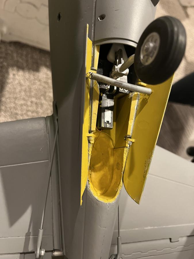

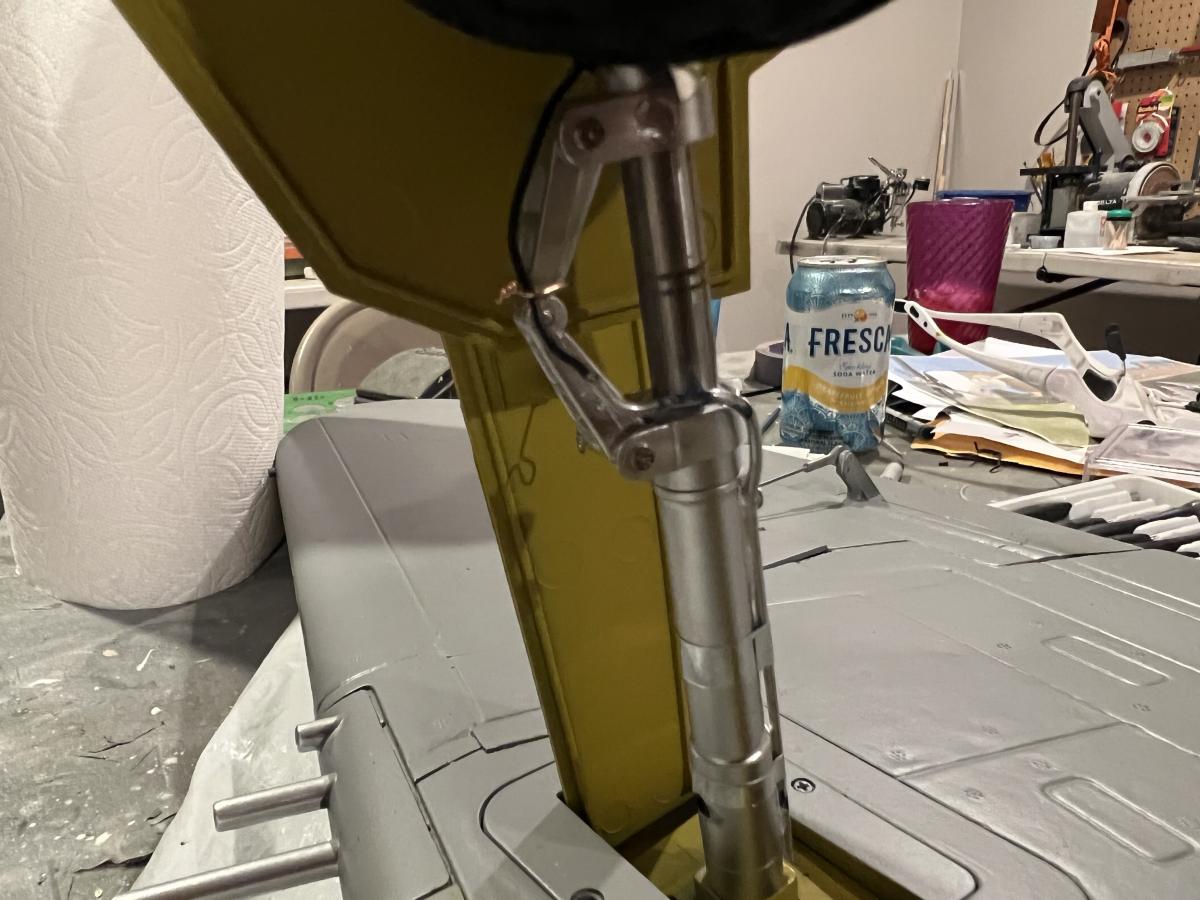

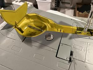

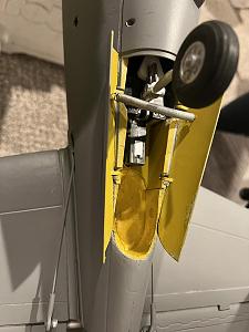

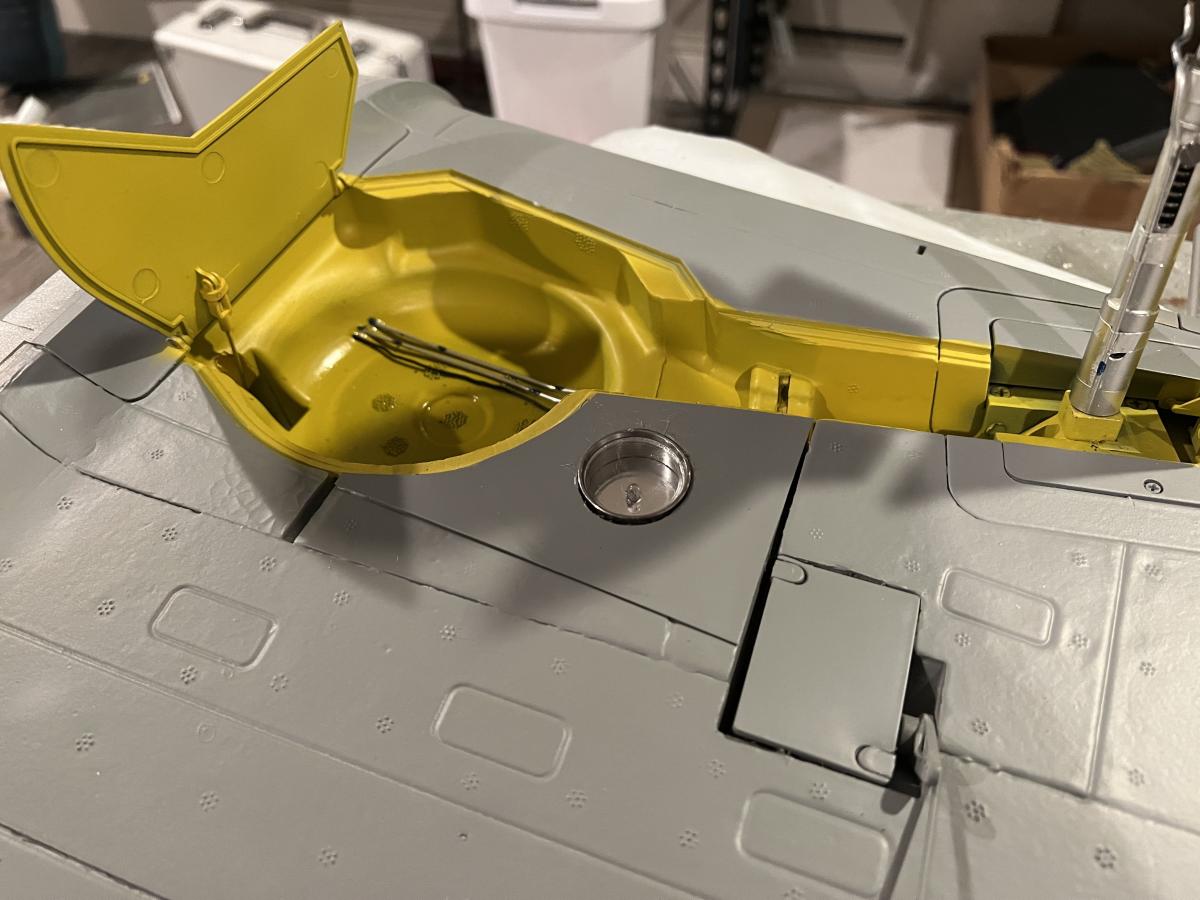

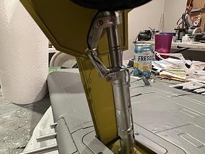

I'm posting a few pics of some embellishments I am doing on the wings as I continue to work on the plane. One photo is a closeup of some scale looking brake lines on the two main wheels. Another one shows some hydraulic line detail in the wheel wells and a landing light that I added from a small flashlight I had lying around. And a third photo is how I solved the stock tailwheel door issue I've described before, by stringing a small extension spring across the gear doors to do the retraction/extension of the doors. Works great!
Fms did great job on this plane,, with the wheel well paint,, looks greener in some pics i believe its zinc chromate primer salmon pink,, or green.... i beleive it was a great anti corrosian..on the original planes,,, daveegee the brake line add looks really good .. simple to do, with no dissrespect,,, i hate politically correctness,,..... and i think the tail wheel spring mod they used on the p51... so great job .. iv done enuf painting on foam planes to apprecciate what the likes of u and lb etc do.. im an auto painter... and every time i unmask ,, and pull paint... off my plane,,, a reedoo,,, i cuss..... paitence is a virtue.. but i hav none so great job.. i now have 2 warbirds to do brake lines on
Thanks, F4U Aussie. The brake lines are pretty simple to do. Most don't bother, and for foamies, I generally don't bother with such details, but in this case decided to add a few. Still, it dresses them up a bit. The ones on this plane are pretty rudimentary compared to some larger contest birds I did in the past.Originally posted by f4u ausie View PostFms did great job on this plane,, with the wheel well paint,, looks greener in some pics i believe its zinc chromate primer salmon pink,, or green.... i beleive it was a great anti corrosian..on the original planes,,, daveegee the brake line add looks really good .. simple to do, with no dissrespect,,, i hate politically correctness,,..... and i think the tail wheel spring mod they used on the p51... so great job .. iv done enuf painting on foam planes to apprecciate what the likes of u and lb etc do.. im an auto painter... and every time i unmask ,, and pull paint... off my plane,,, a reedoo,,, i cuss..... paitence is a virtue.. but i hav none so great job.. i now have 2 warbirds to do brake lines on
Regarding the tail spring, at the time I did this, in about 2016, I don't think it was widely used yet. I don't recall any other planes using this technique back then, but there might have been, I don't remember. It was new to me, anyway! And, I have several planes created later like the Tigercat that do use this very reliable, inexpensive way to open and close the gear doors.
I repainted the wheel wells and inner gear doors yellow zinc chromate, as that was the color that came out of the factory. Most jugs were built on Long Island, NY, but were also assembled at two more plants, one being in Evanston, IL and another in upstate NY. All the Farmingdale, NY jugs had yellow zinc chromate paint, although some might have had green zinc chromate at the other factories. Since mine was a P-47D-1-RE (Long Island, NY) I repainted those areas with the yellow zinc chromate. A minor point, but I try to be accurate where I can, even with foamies!

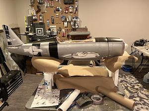

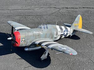

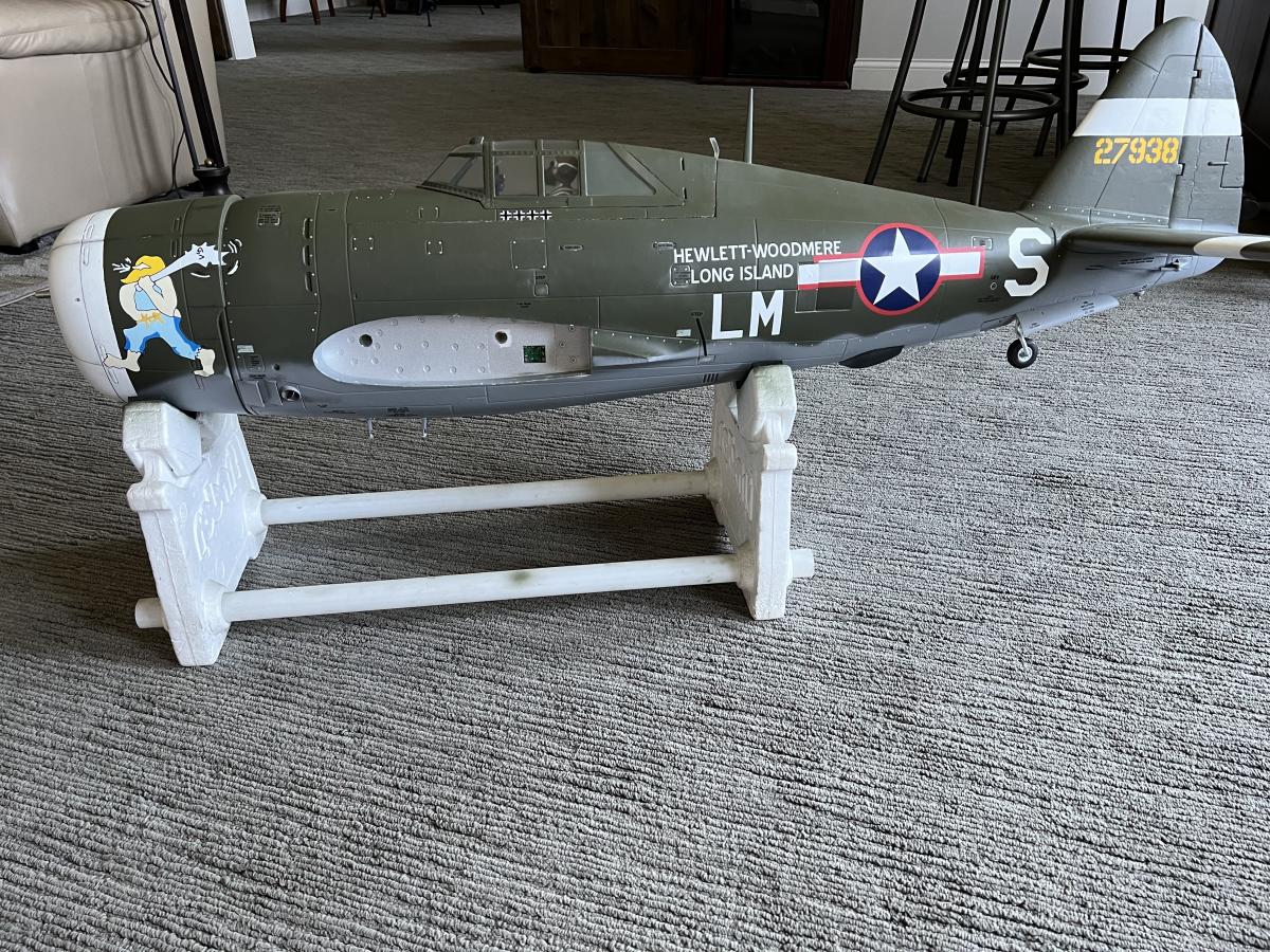

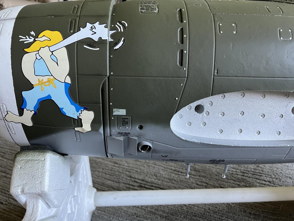

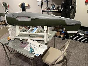

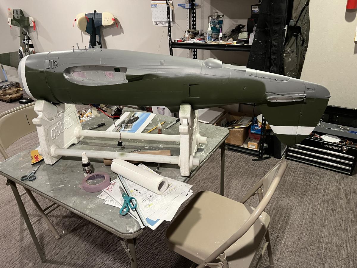

Making steady progress on the painting and detailing of the Jug, with just a few setbacks. First, I screwed up one of Callie's star and bar vinyl transfers trying to get it around the fairly complicated intercooler doors area. Other side went on fine, waiting for Callie to send me a replacement. Had some paint issues on a few parts, mainly plastic parts that had been painted silver at the factory. Caused my spray paint (Tamiya) to not hold and had to be redone in those areas. I think all is well now on the paint side.

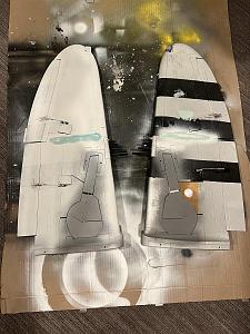

I'll attach a few pics of the fuse. Wings still in-work, but do have them painted. Later this week, some special weathering colors for my airbrush I'll use on various parts of the plane. I also like to use chalks, as needed in certain areas.

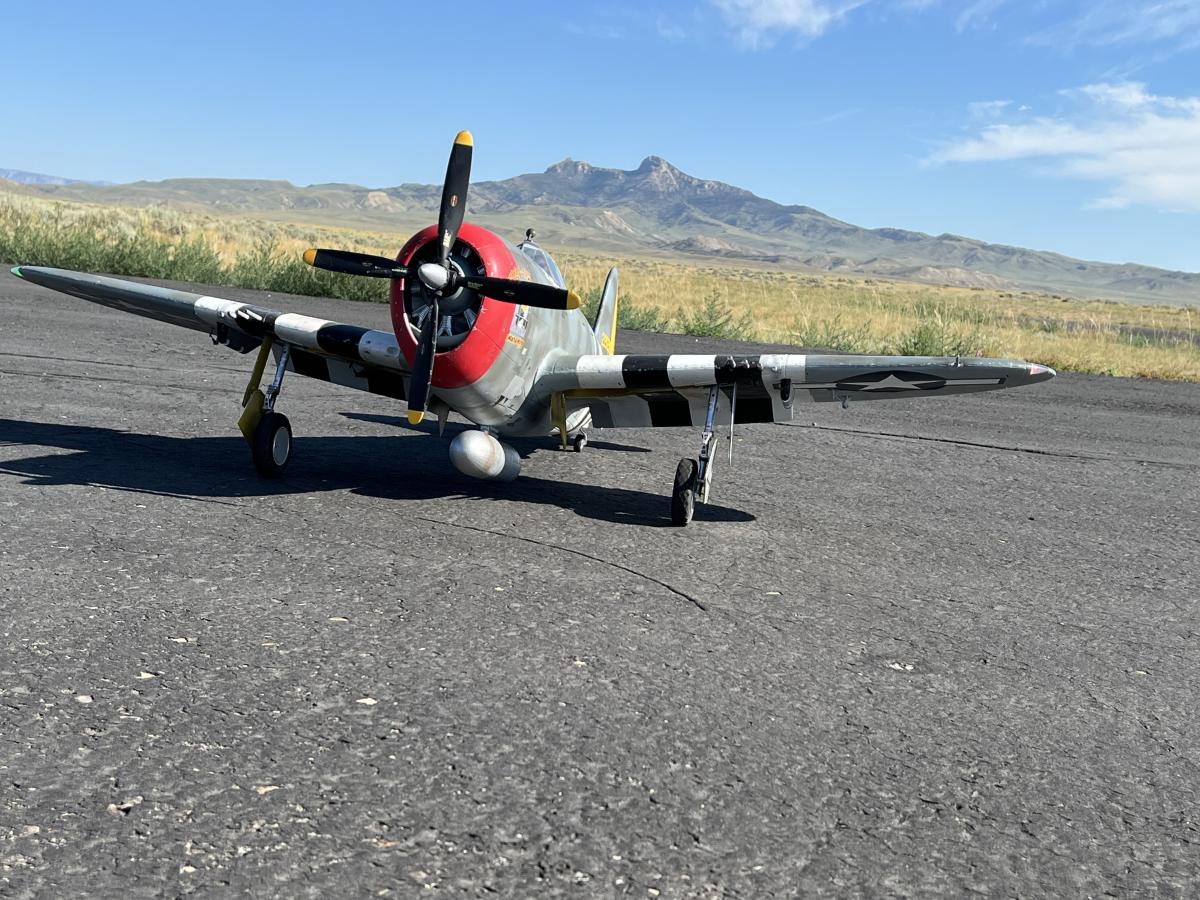

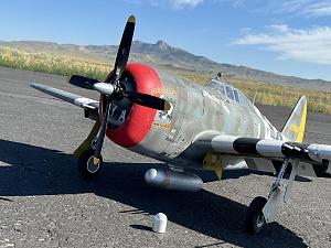

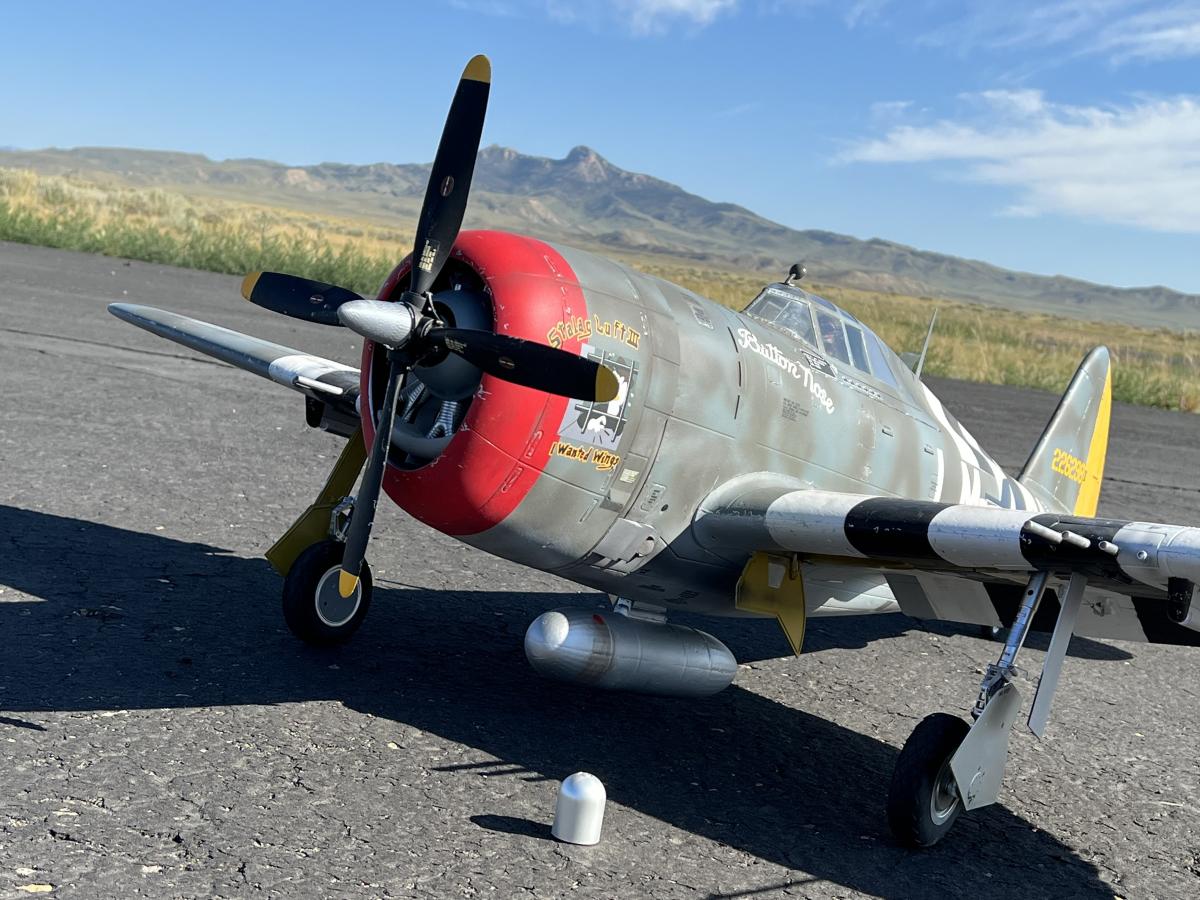

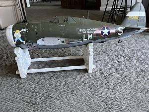

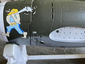

On the fuse, there is an unusual marking on the left side: Hewlett-Woodmere Long Island. For those not familiar, back during those days, they initiated drives to have cities or other groups of people to "sponsor" an airplane. In this case, it was a town in New York that helped out the war effort and was recognized by this marking on the aircraft.
In WWII, there was a popular comic strip, Li'l Abner, by cartoonist Al Capp. Besides Daisy Mae, Li'l Abner and the rest of the gang, another one was Hairless Joe, who carried a big club. His likeness is featured on this aircraft, flown by Col. (then Maj.) David Schilling, of the 56th Fighter Group in England.
