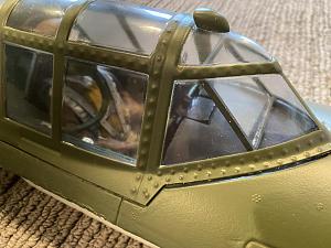

            Redo on FMS 1500mm P-47D project:
            I have been trying for about a year now to obtain a new FMS P-47D razorback model. Even got ripped off trying to buy a NIB one by scammers a few weeks ago. After about a year of fruitless search worldwide, I finally came across a model company or distributor in Austria. It wasn't cheap, especially shipping, but it arrived at my house yesterday.
            I have another one I redid shown in this thread, actually two of them because one crashed, but I wanted to try a different paint scheme and some extra details on one before I close this chapter on P-47 foamie redos.
            I started with customizing the exhaust stacks near the cowl, cutting them down some and adding a scale wastegate for realism. This morning, I gently pulled all the decal stickers off, and will start working on priming and eventually painting the plane. Hope to have it done in a few months. I'll attach a drawing how it will look when done.

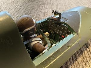

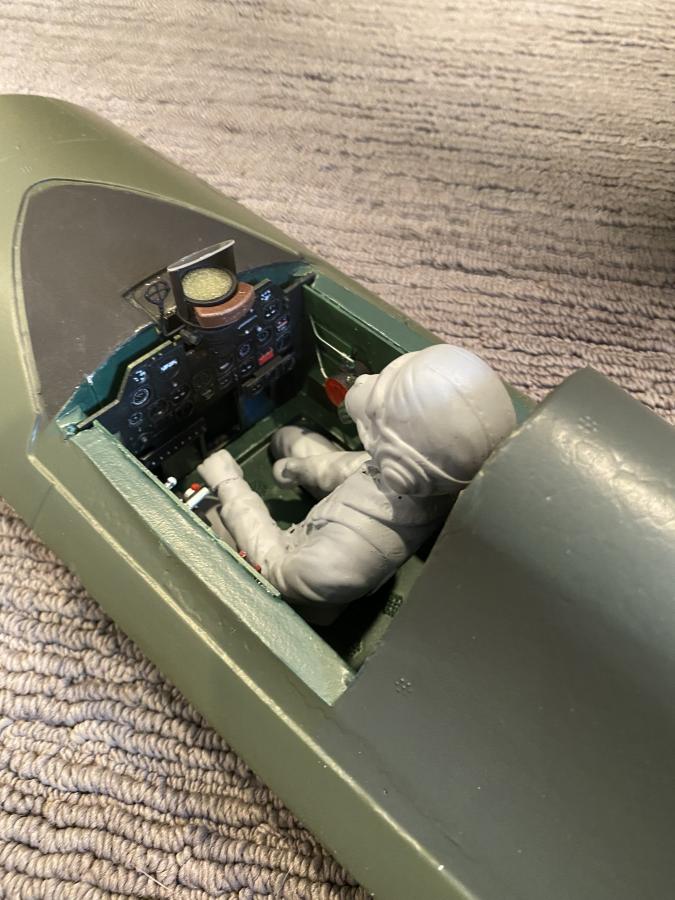

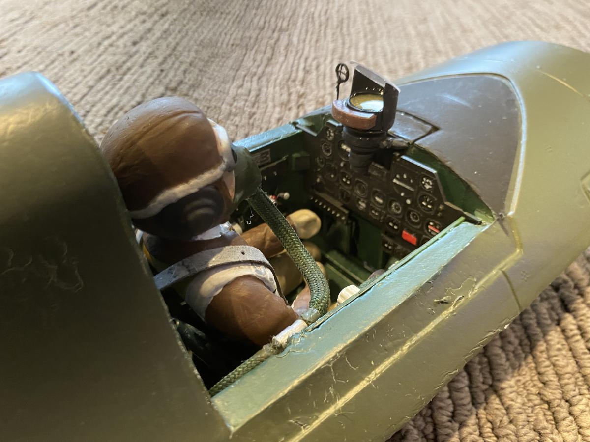

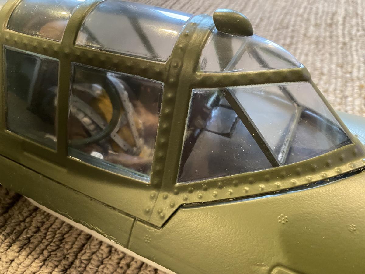

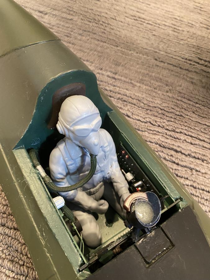

                      Just started working on some details for the cockpit. Pulled it all apart and am redoing it, starting with a more scale interior coloring, dull dark green. I'll keep that goofy looking pilot, but repositioned the hands a bit, and he is now in primer coat for sizing. Made a scale looking oxygen tube and connector per the real airplane. Gunsight is a combination 3D print/scratchbuilt of an earlier type used in this airplane at the time. Even added a little crosshairs gunsight that was used if the main gun sight was unusable.
                      I'll try to finish the cockpit in the next few days, and then will start working on the rest of the airplane. Since the canopy will be closed, I won't worry about all the details I could put in there, been there, done that with large gasser models that I competed with around the country years ago.
                      Davegee

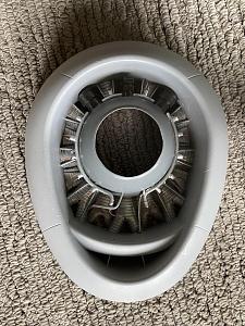

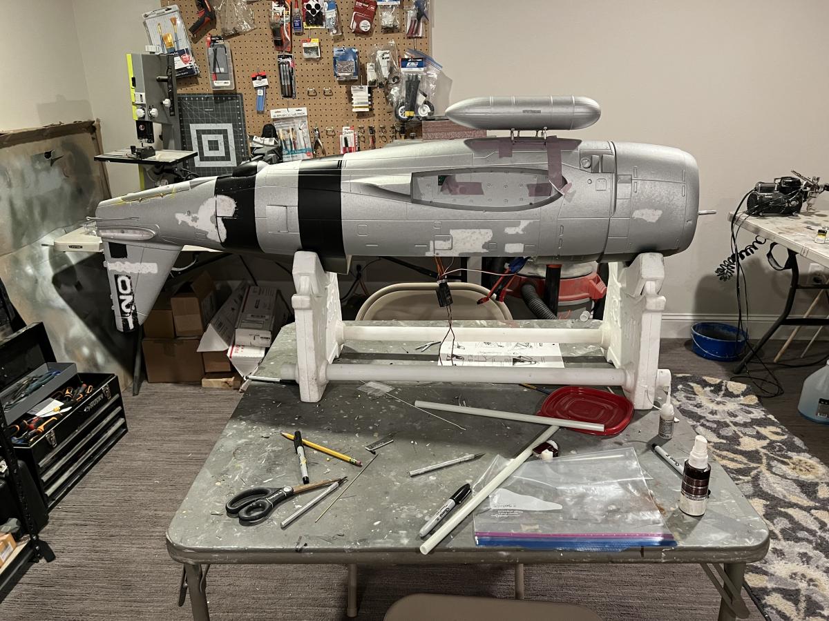

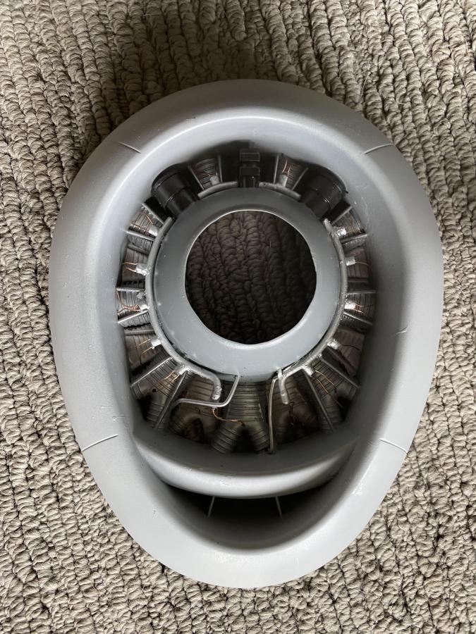

                        did some additional detailing on the R2800 "fake" engine molded in the cowl over the weekend. Nothing spectacular, just to add some extra scale look to the plane when it gets done. My wife is going to paint up the pilot today, and then I'll start moving onto the main body of the aircraft for redo and eventually repainting.
                        Hope everyone had a great Independence Day weekend.

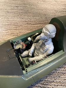

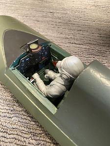

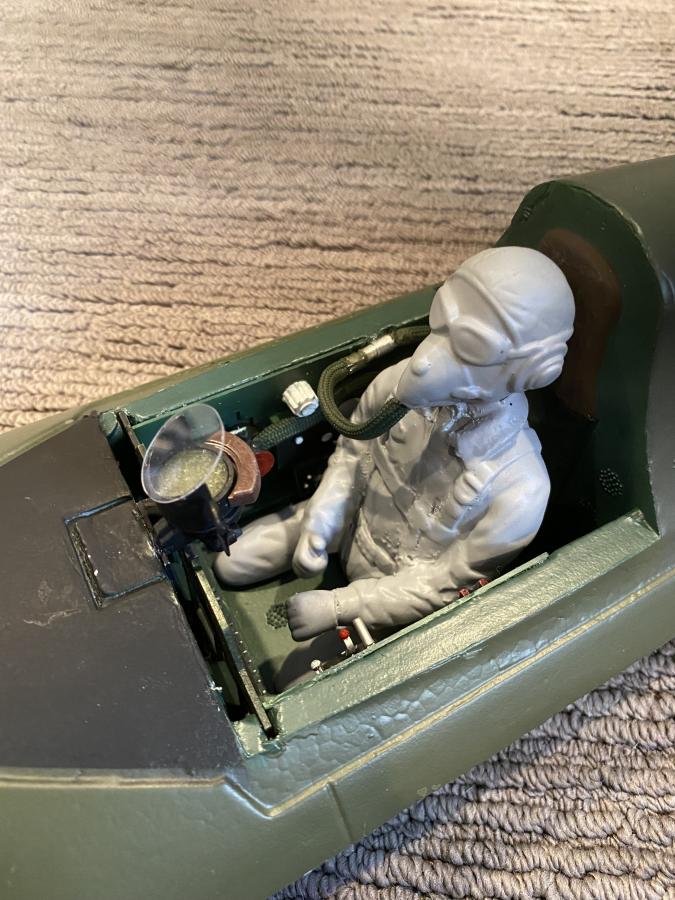

                          My wife graciously finished painting the pilot for me, and I installed him in place and hooked up his oxygen hose that I had made from scratch. I also made a rear view mirror on top of the canopy in a style used on this plane that I am portraying as well as a scale armored glass plate put in front of the pilot on the razorback P-47s. The cockpit is more or less complete, and I am proceeding to the next part of the airplane to be reworked, the tail gear door retraction modification from the stock version, and on to many other embellishments for this plane. I hope to have it ready for a maiden later this summer.
                          davegee

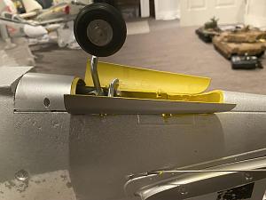

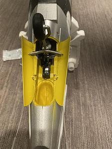

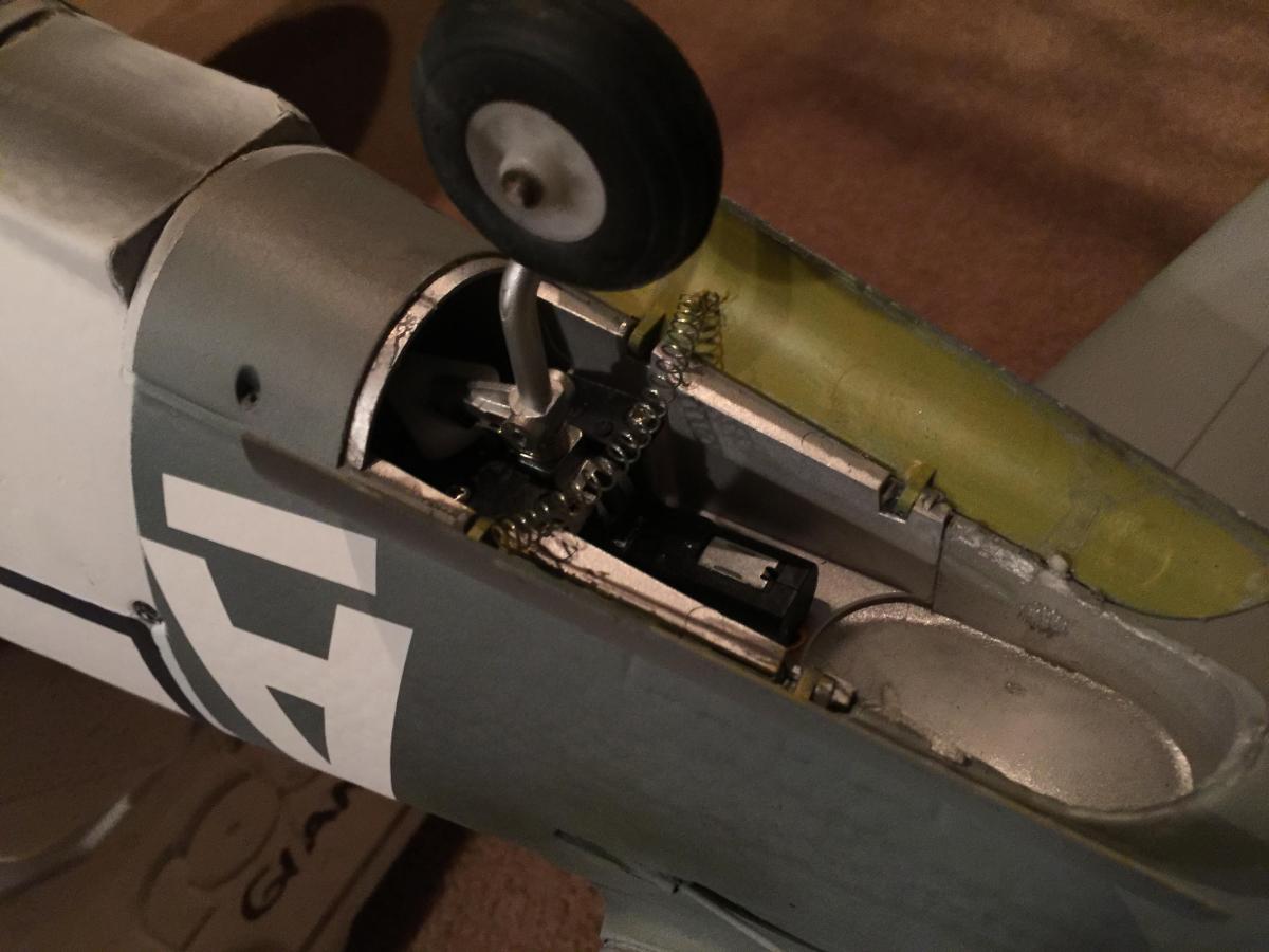

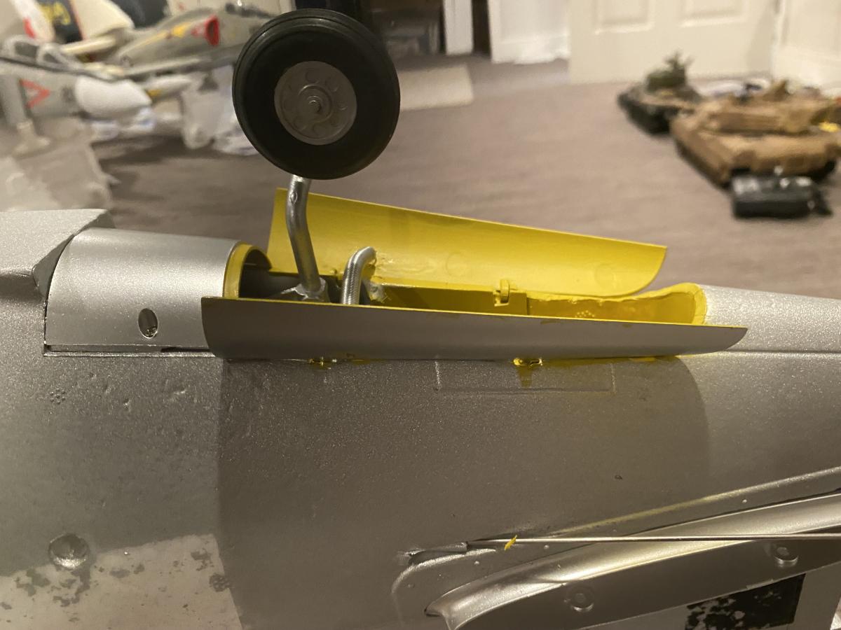

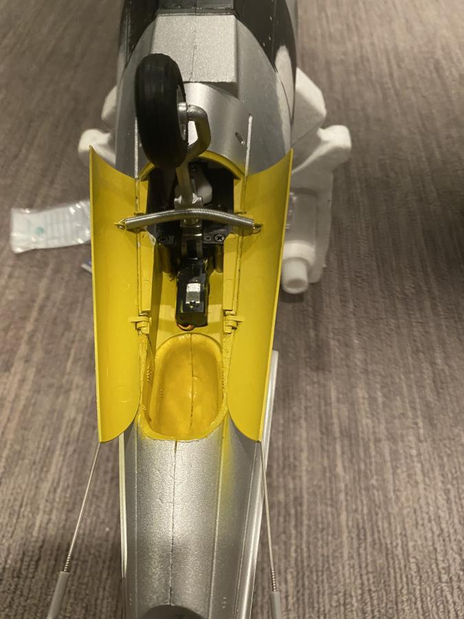

                                Just finished the redo on the FMS tailwheel gear doors. I hated the way that they designed these in the first place, hanging down almost vertically, and then when the tailwheel moved, because the retraction springs were attached to the gear strut, when the plane turned on the ground, the tailwheel doors sashayed to and fro, too. As we used to say in the aviation biz, "the designers used poor headwork." Keeping them as is was a bridge too far, for this old scale geek!
                                A very simple fix that I found was to remove those little springs on the tailwheel doors, throw them away or keep them for future projects. What I did was take a simple compression or extension spring, both work, and run it crosswise above the gear wheel well opening, and attach each end to one of the little holes provided on each gear door. This does a couple of things: 1) it forces the gear doors to be splayed out in a more realistic manner to the real airplane, and 2) when the gear is retracted, the tailwheel strut catches the spring as it comes into the well, and pulls the doors shut. When the gear is extended, the strut's movement releases the spring and in turn the spring forces the tailwheel doors back open again.
                                I first used this on my first P-47 airplane in 2016. It later crashed, but that system worked perfectly. Sorta like the Tigercat, and a couple other warbirds that I cannot recall right now.
                                For this FMS plane, though, I recommend it. I am attaching three pics. The old one shows the plane in 2016 with a compression spring strung across the gear bay. You can see an "A" marking on the fuselage and it is already painted. The other two were taken tonight after I set up the extension spring across the gear bay.
                                How long a spring, you may ask? In either case of using springs, I found using one about 2 1/4" long, and less than 1/4" diameter worked well. What is important is that the spring has plenty of flexibility so that it won't fight the gear strut to close the doors properly. You may have to fiddle with the springs, possibly cutting them down a bit, but that's part of modeling.
                                Click image for larger version  Name:	unnamed (1).jpg2.jpg Views:	0 Size:	87.0 KB ID:	349842Click image for larger version  Name:	IMG-1185.jpg Views:	0 Size:	102.4 KB ID:	349843Click image for larger version  Name:	IMG-1184.jpg Views:	0 Size:	75.9 KB ID:	349844

                                  My silver P40 has the same problem. I think, because of those springs, the retract doesn't fully function. Something that I have to get on and convert. The Flying Tiger P40 already has the conversion and it works great.
                                    • Nov 2013
                                    • 2776
                                    • Cody, WY
                                    #617
                                    I'm pretty confident in this system, as I have used it on two airplanes now, and this is the third. Plus, it also pulls the tailwheel doors to a more scale position when the gear is down.

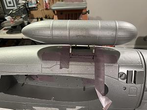

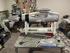

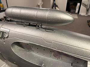

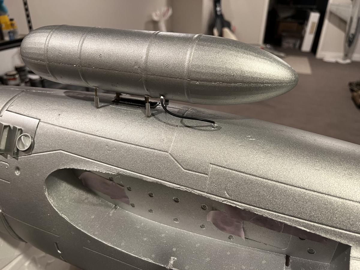

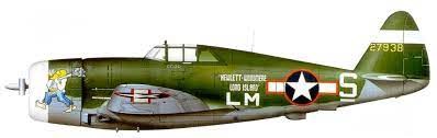

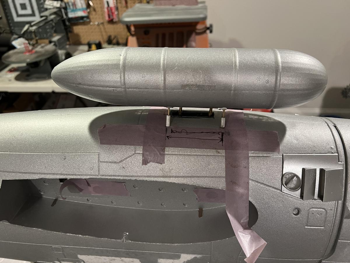

                                      Doing some work on detailing the centerline drop tank of the type was used on this airplane early in the war in Europe. This includes scratchbuilt sway braces on the fuselage to keep the tank from movement while attached to the airplane.
                                      My plane will reflect how they were configured early in the war in Europe. They didn't have any wing stores yet (drop tanks, rockets, bombs, etc.,) so they flew various missions with code names like: Rodeo, Circus, Rhubarb, and Ramrod. They all had special meanings. For instance, a Rodeo was a fighter sweep, without bombers, and they would search out and destroy enemy aircraft and/or ground targets. Conversely, a Ramrod was heavy bomber support to destroy a target on the ground.
                                      Davegee

                                          Thanks, LB. Adding some details to make it a better looking, more accurate flyer for my field. Still fun tinkering with how to do these embellishments mostly with stuff around the house. I'll probably use the 3M foam masking that we have been discussing for the fairly simple paint scheme of OD/Neutral gray on this one.
