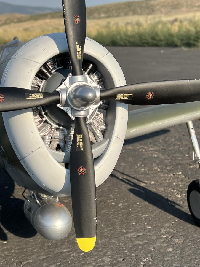

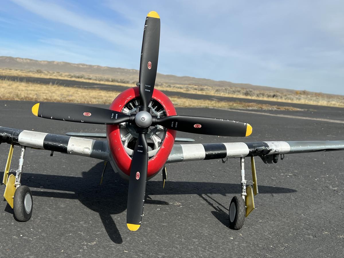

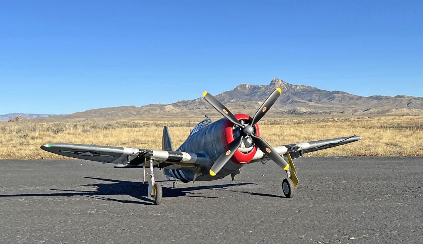

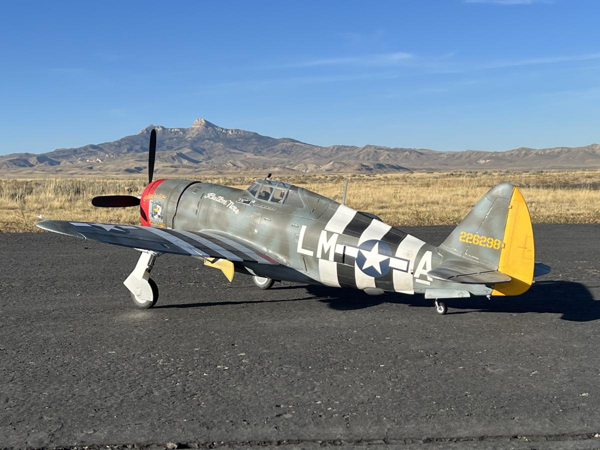

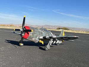

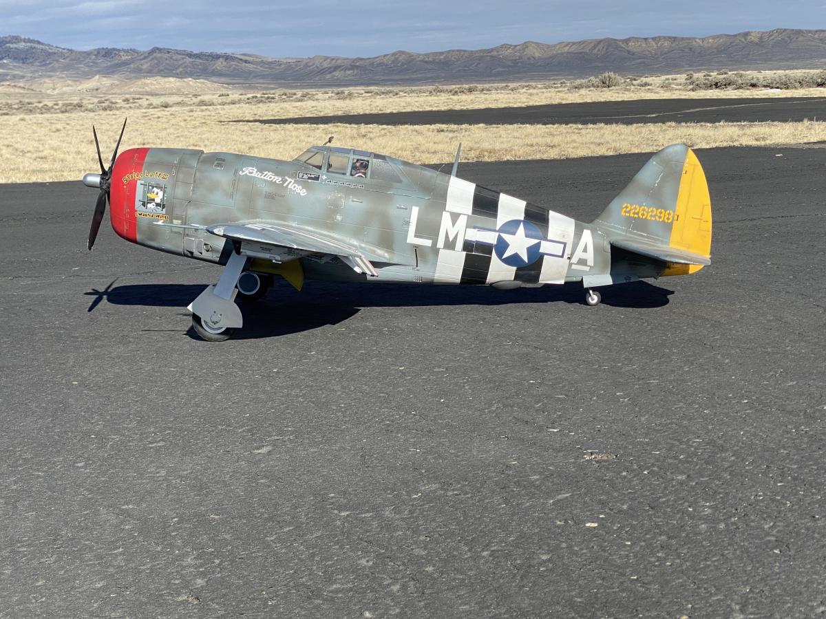

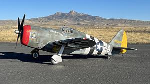

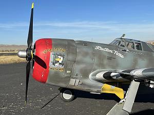

            Well, I got all the new parts for the 1700mm Corsair prop in the mail in the past few days, and added it onto the FMS 1.5 M P-47D razorback, per the inspiration from Spanner 76 who has successfully done this already.
            I used as my testbed my earlier P-47D painted in the colors of a plane named I Wanted Wings/Button Nose, by its pilot who flew with the 56th Fighter Group out of England in WWII.
            I had some concerns how well this would fly at 5,000' MSL versus where Spanner 76 did his tests at a field at near sea level. But today that was not a factor at all. I did several full power static runups this morning at my house, and again before I took it up for a flight. It was rock solid all the way. When I took off I didn't use enough right rudder and the plane veered off a bit to the left of the runway, but safe takeoff, nonetheless. Did several circuits at high speed and others at a midrange speed, using about 1/2 throttle. Did a couple of rolls, very realistic looking as the real airplane looks in the air.
            Coming in for landing, I did my usual WWII break and pitchout from a low altitude over the runway. Once on a downwind, I dropped the gear and flaps and brought it in for a smooth two-point, tail low landing, using some power. It rolled out nicely but near the end of the rollout I think the steering pin broke on the tail wheel and it did a quick groundloop. That pin is just molded plastic on that part and I'll replace the pin with brass rod tonight.
            This plane has done great for me and I've had it about two years now and a lot of flights. Although not a perfect match, the larger prop from the 1700mm Corsair is a nice scale addition that actually works!

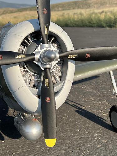

            I'll attach some pics from this afternoon, including one from a while back with the stock prop on it that you can get a comparison of the two. I'm now working on repainting the big prop and having Callie add some scale nomenclature transfers to complete the project.
            Cheers
            davegee

                        I just sanded and repainted the props black. The yellow tips were way too large, and once the black paint is dry, I'll use some masking tape to spray the tips yellow. Regarding markings, I sent an inquiry to Callie Graphics about making the nomenclature markings in white, versus the orangey color that comes with her P-47 nomenclature and decal packages. Instead of running lengthwise down the prop, I want them to go crosswise, as was the practice for many Ham Stan props back then. I'll attach a photo of a real one, a restoration and it is in yellow, but I want to go with white, if possible.

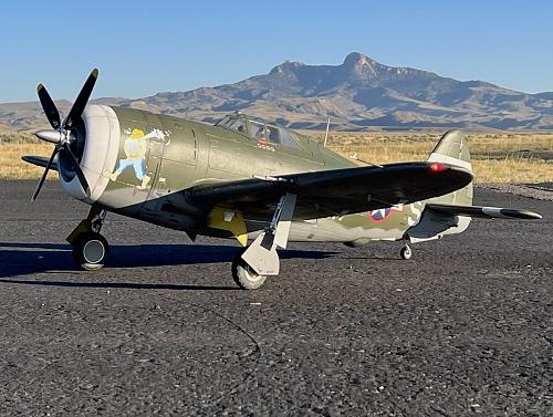

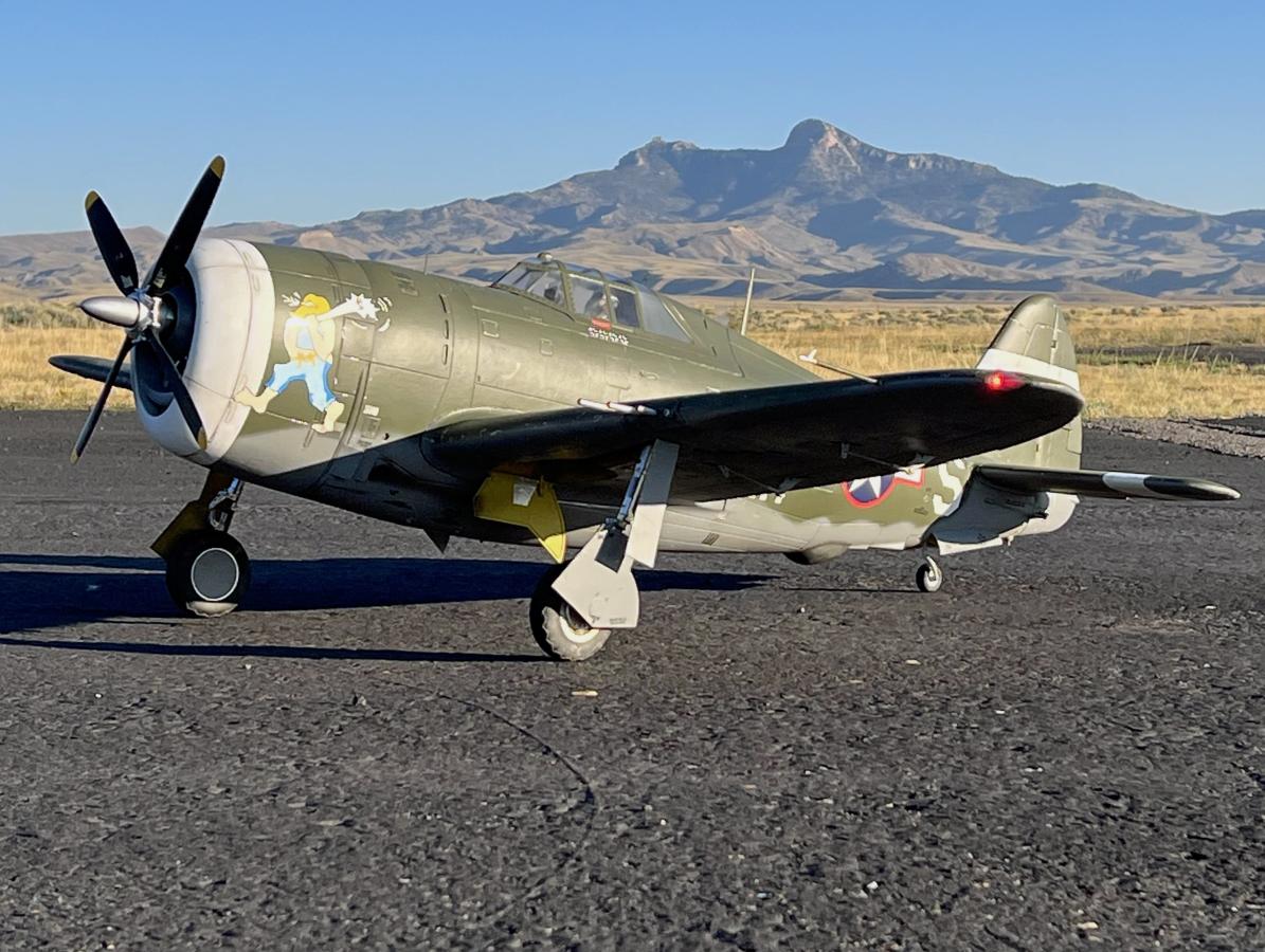

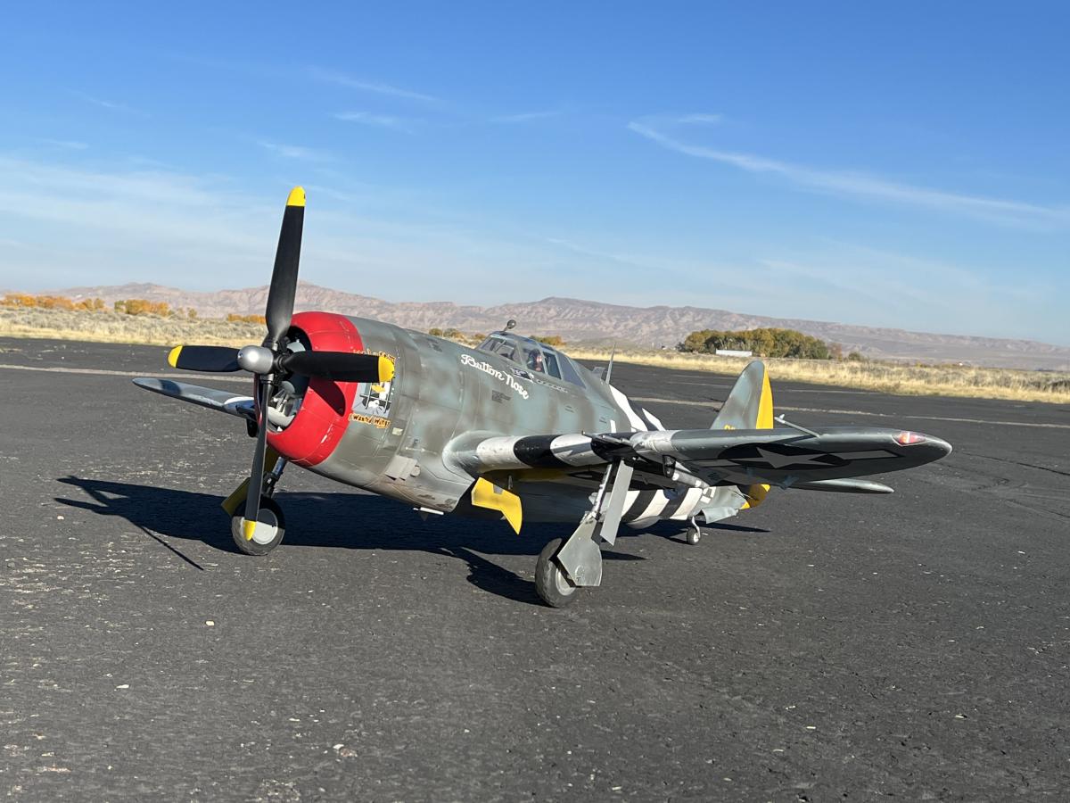

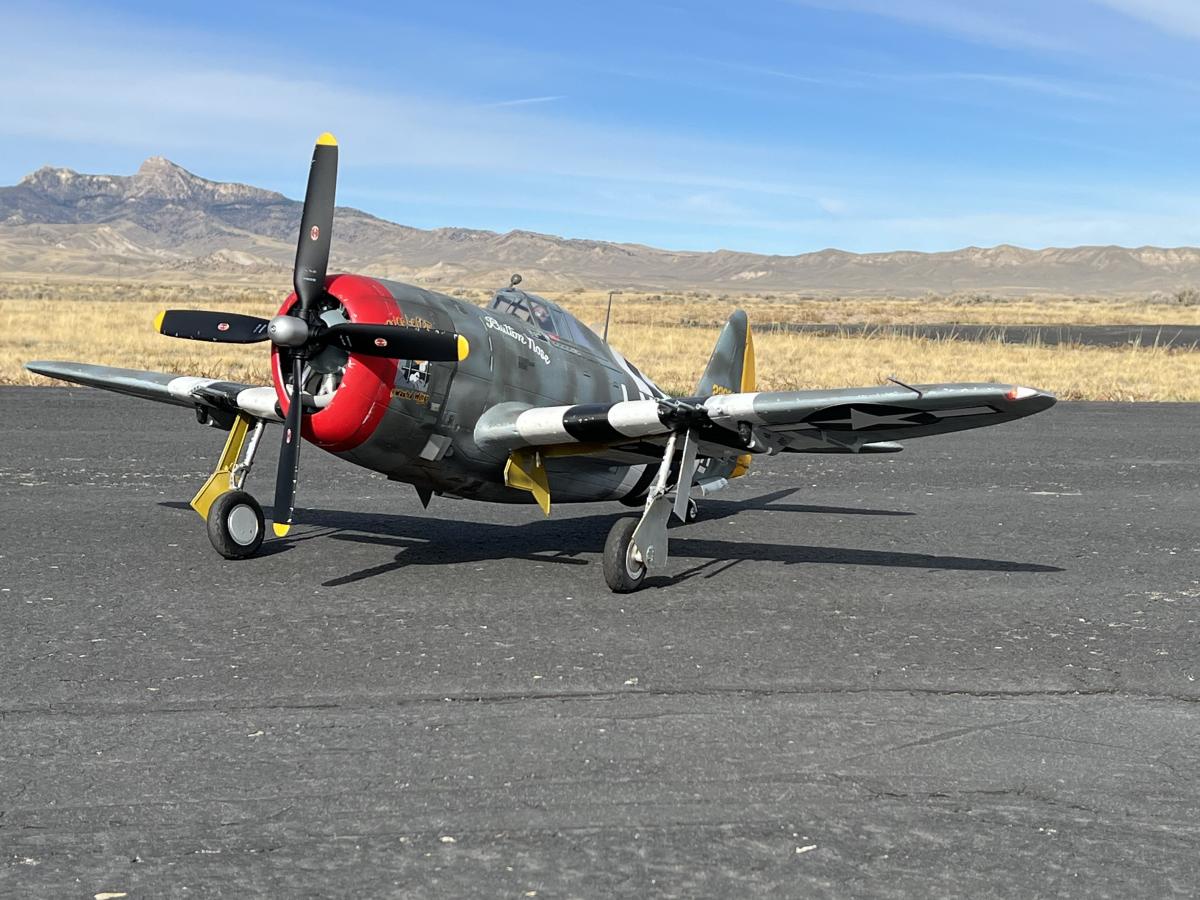

                            As an update to my previous post above of flight with the new prop and hub assembly from the V3 FMS 1700mm Corsair adapted as a trial run to my 1.5M P-47D, I actually did get flight number 3 in this morning. I spent several hours yesterday making repairs after the gear up landing, and replacing the right main gear retract as well as doing several cosmetic repairs to the belly pan area where it skidded to a stop on the runway. Also, I was able to use all four propeller blades as the tips were not that seriously damaged and I was able to file and round off and repaint the damaged areas.
                            Today's test flight was as good as yesterday's, with the notable exception that the gear actually came down for landing this time! I still want to take the retract apart to see why it malfunctioned yesterday. But as for today's flight, it was done in almost absolutely perfect weather conditions with virtually no wind. I didn't have a gun to compare speeds from the stock prop to the larger Corsair prop, but it did SEEM to me to fly faster with more authority with the big prop on it. All the maneuvers I did, just basic military maneuvers that a real P-47 could do, went very well. Takeoff and landing was as expected. Landing was typical of flying one of these warbirds with a little power right to landing, touching down with the mains and then lowering the tail to the ground as speed bled off.
                            I think I'll keep this big prop on this plane for the time being, if not permanently. I might add one onto my other FMS P-47D that is in a straight OD/Neutral Grey camo pattern of earlier in the war. Very happy with the results and looks of this plane with the more scale looking prop on it. Even this one is slightly underscaled compared to the real thing, but definitely close enough for this application.
                            I'll attach a couple of pics of the plane after the test flight under beautiful Wyoming skies this morning. One of the pics shows the propeller straight on. I am detailing it a bit, have repainted it and the tips to a more scale look. and am waiting on an order from Callie to make some of the propeller nomenclature transfers that were used on this plane.
                            Cheers
                            davegee

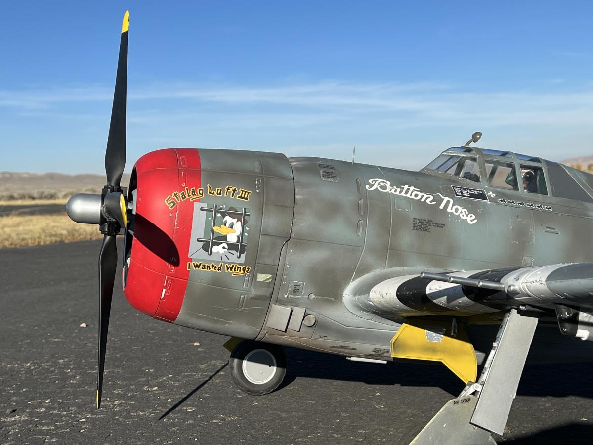

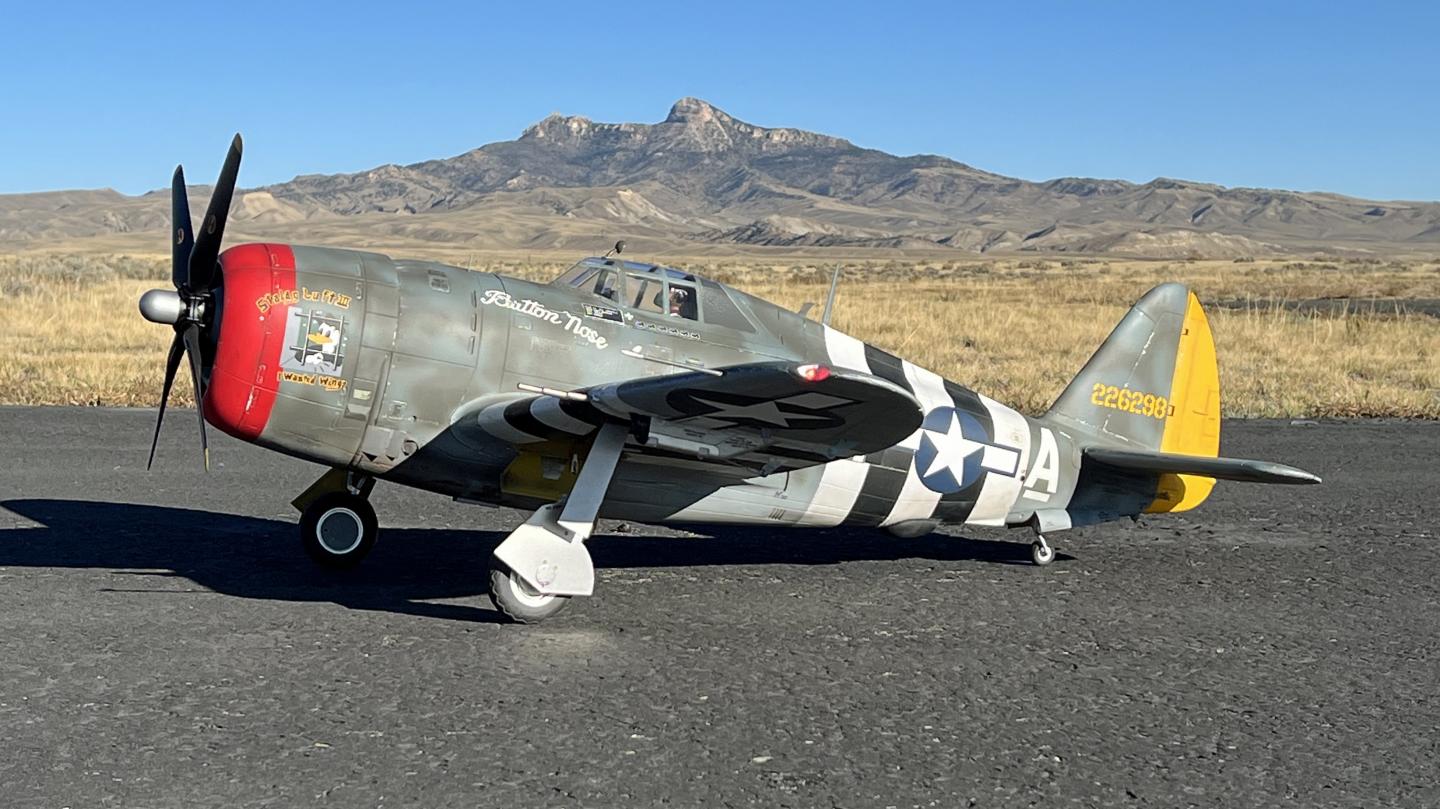

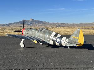

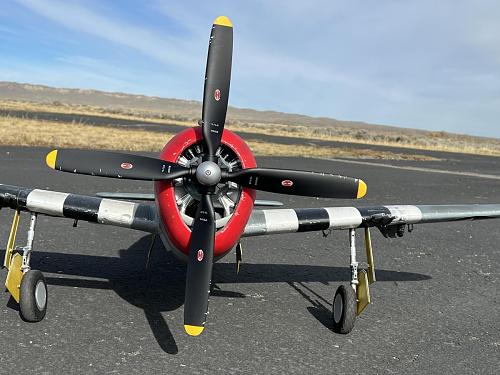

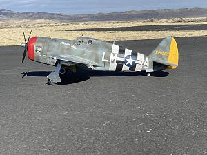

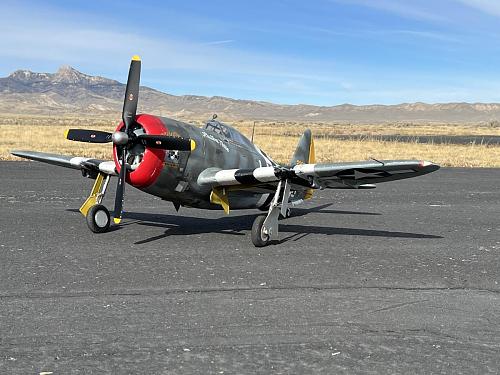

                                        Did one more test flight on my I Wanted Wings camo P-47 today. Went very well with the new prop, so that is four consecutive successful flights on it during this test program. I am pressing ahead with the Curtiss Electric prop mod for my Hairless Joe airplane. Sent the prop hub parts to my friend for him to make a 3D printed bullet shaped Curtiss Electric prop dome. I'm hoping in the next 2-3 weeks I'll be ready for test flights using that prop set up. This prop (taken from 1700mm V3 Corsair kit) is much more scale size to the real airplane.
                                        Attached are a couple pics of the I Wanted Wings camo plane after its 4th flight on this prop. I added scale markings on the prop from Callie, and it flies great!
