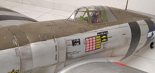

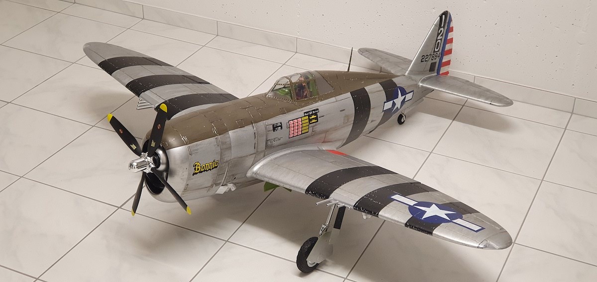

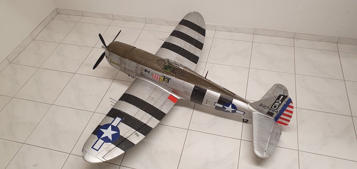

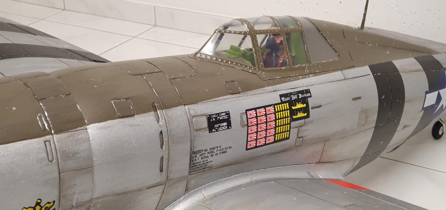

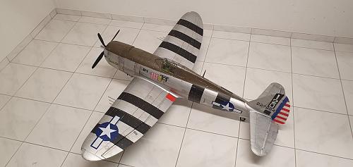

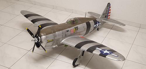

      Currently working on my black Friday project, while a friend is doing the Flightline Spitfire. Will be fun to fly side by side.
      Still some airbrush and detailing to do. Gun and exhaust is not yet ready.
      Thank you all for your tips and tricks in this thread. Helping a lot.

        Wobisch Your subtle weathering looks quite realistic, very nicely done! Have you maidened it already, or will both of you be going up for the first time at the same time?

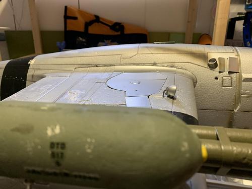

          the weathering was done with the "washing" method. No airbrush yet. I used some paint from vallejo called "Model Wash". Grey, light grey and terra. Applied several layers.
          I think I'm waiting for a double maiden. Currently it's a bit cold here anyway. Meanwhile I'm going to finish the Tomcat.

            Wobisch Even more impressive that it's a wash, not an airbrush! I usually don't have good experiences with washes on foam because they tend to accentuate the foam cells, but you've obviously mastered this technique, regardless.

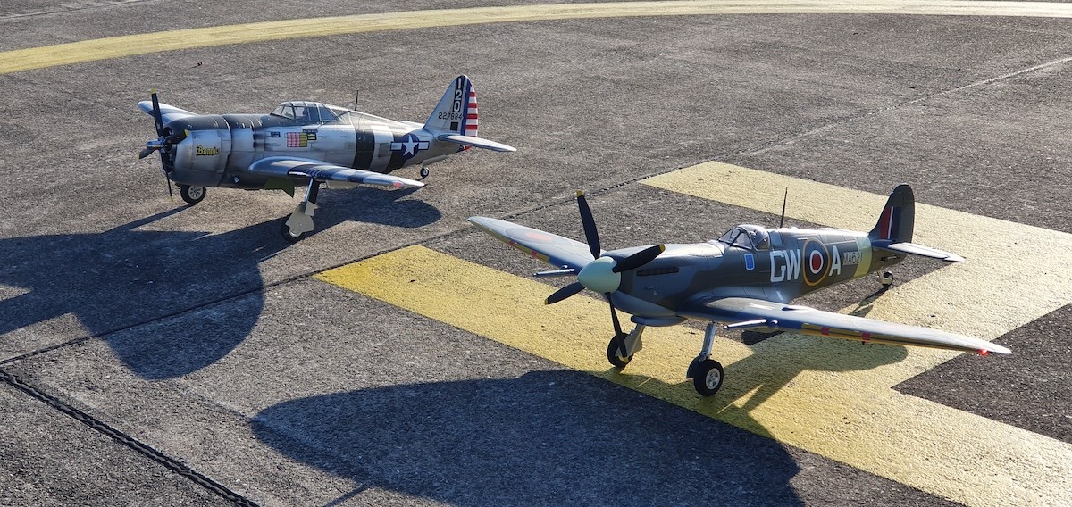

              My buddy and I. Ready for new year.
              Both maiden went well.

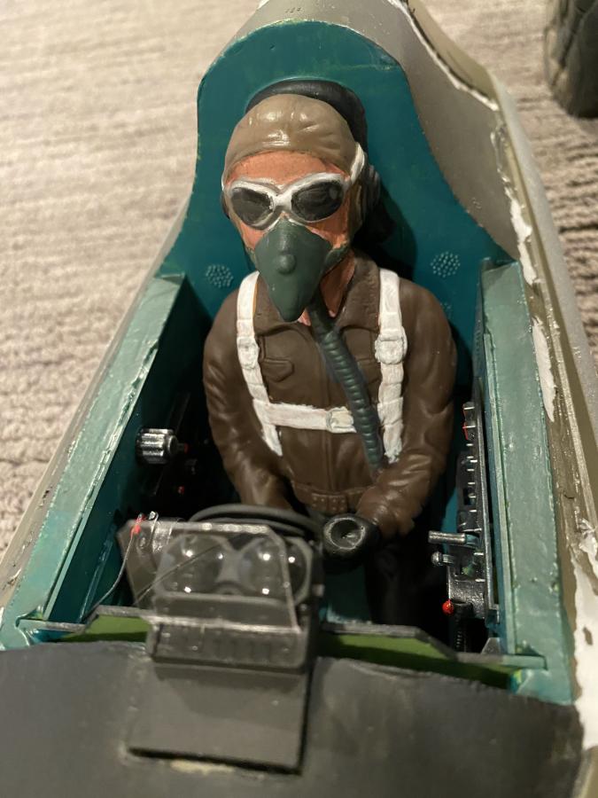

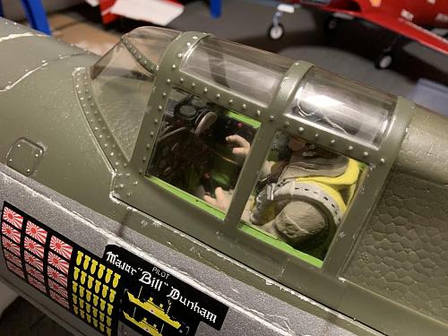

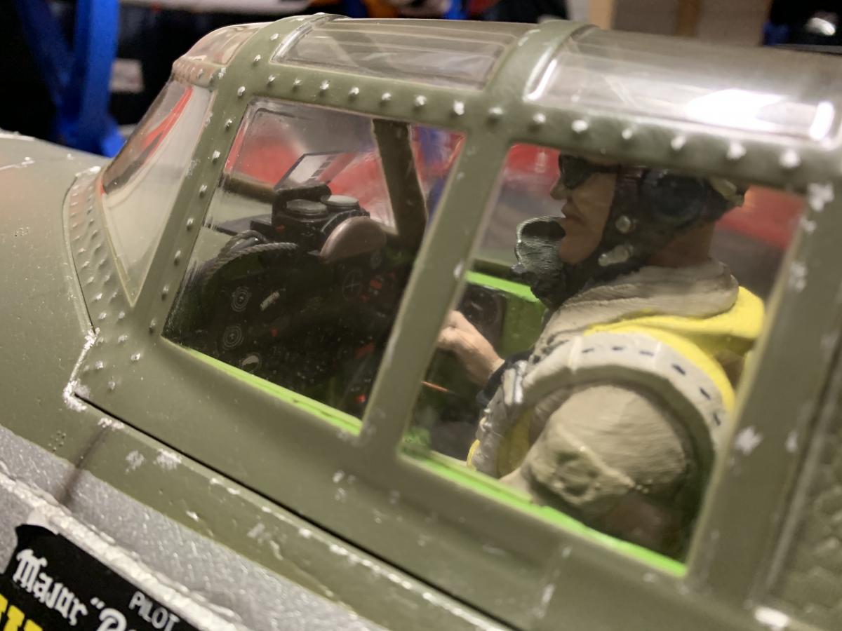

ID:	248840Click image for larger version
ID:	248839Click image for larger version
ID:	248838Click image for larger version
ID:	248837Click image for larger version
ID:	248836Click image for larger version
ID:	248835Click image for larger version

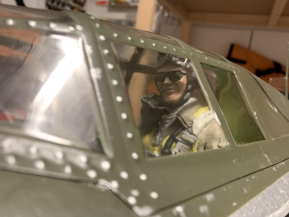

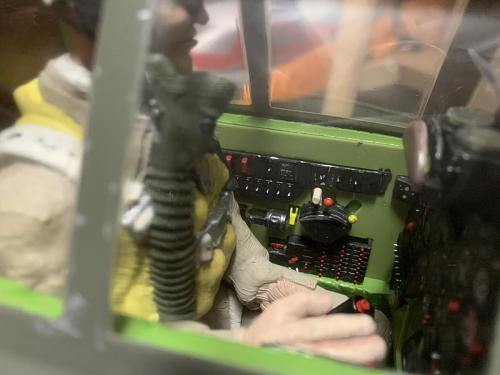

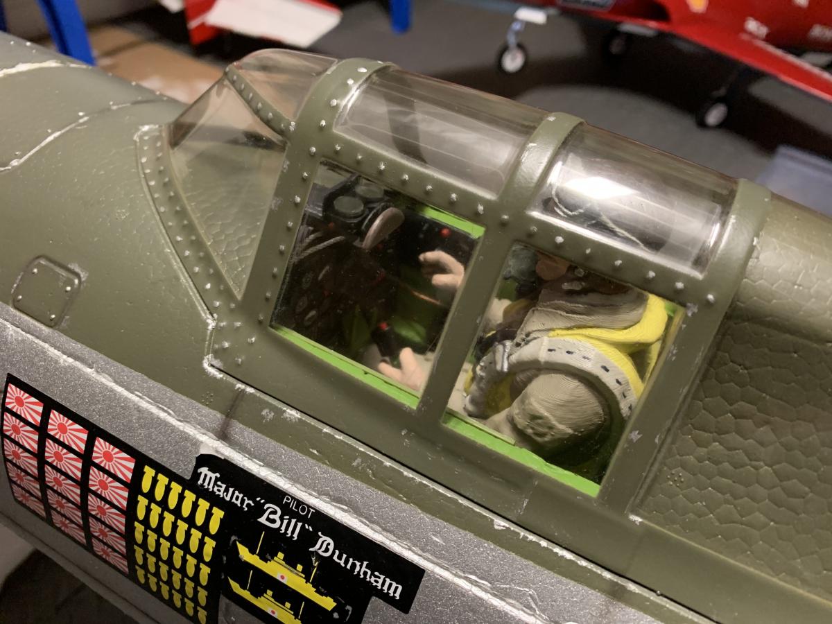

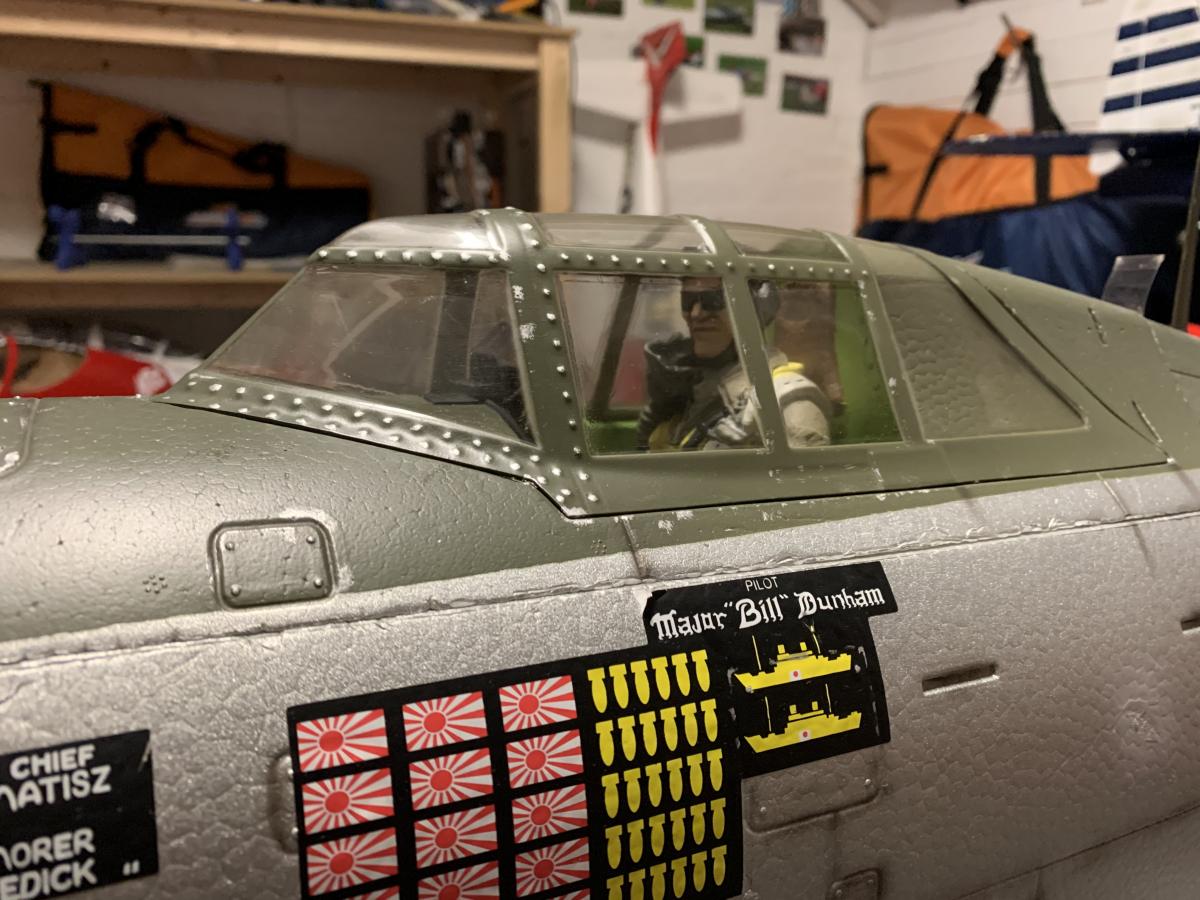

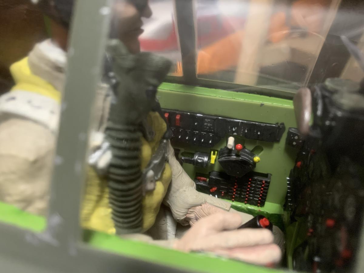

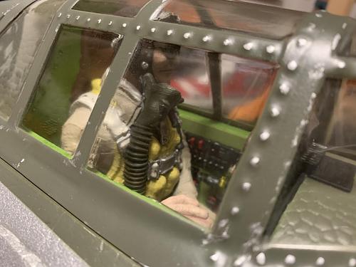

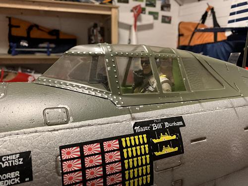

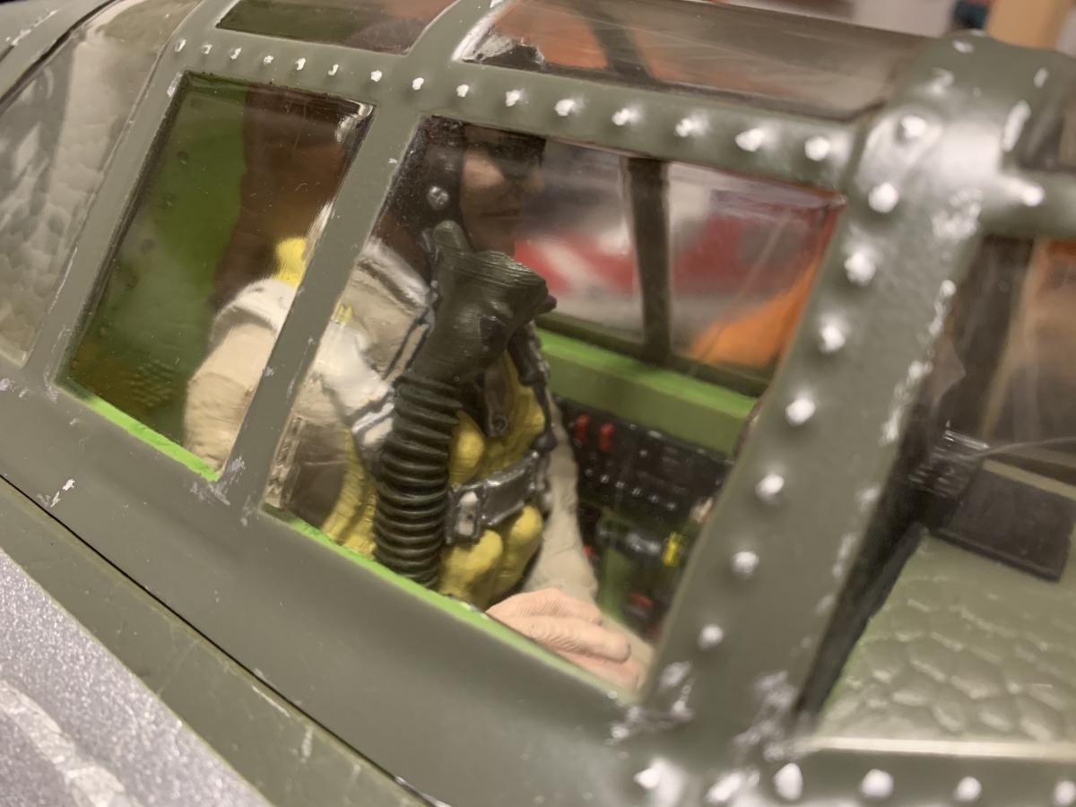

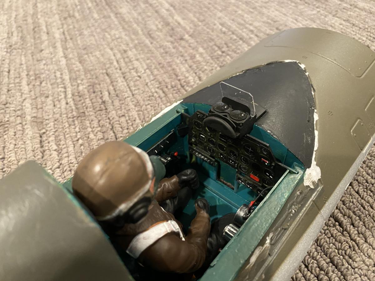

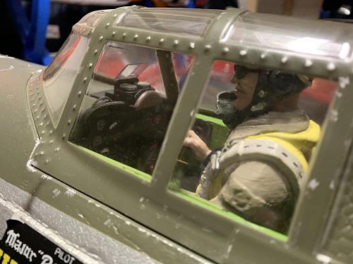

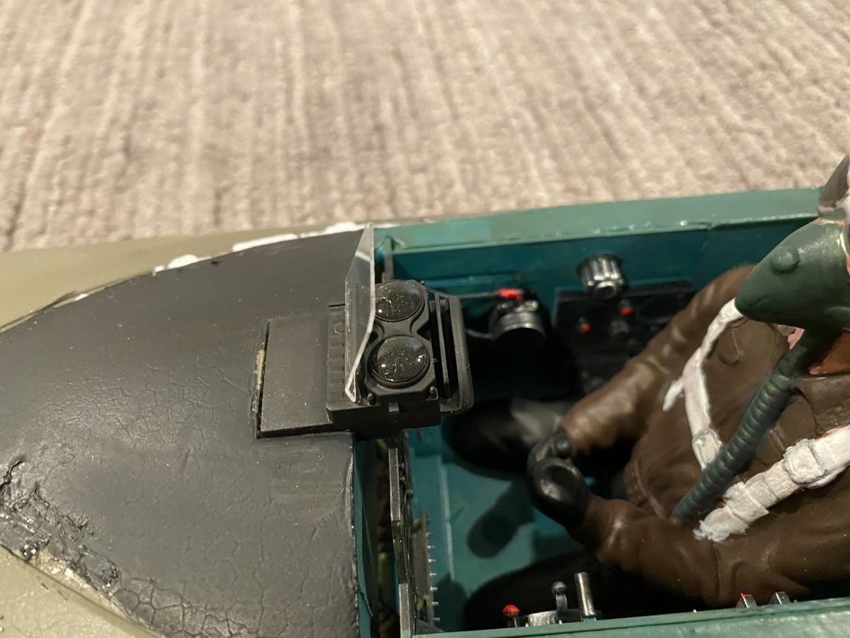

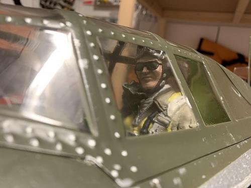

ID:	248834 Cockpit upgrade is complete!

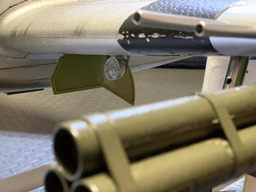

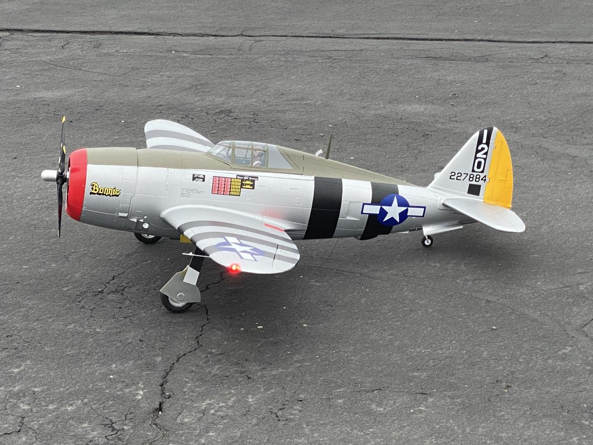

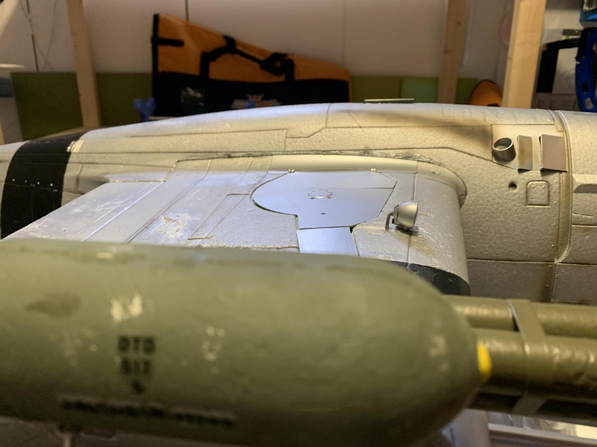

ID:	250504 Landing light added. Regrettably it is not retractable.

                          t01ga If your landing light is regrettably non retractable maybe take a step back and redo it
                          Did you know that the Freewing 1410mm Mustang has retractable landing lights and that you can get them as spare parts

                            OV10 No I wouldn’t know that as I don’t care much about P-51s. Never had one and I doubt I ever will. However I appreciate the tip as those lights are cool. I might do that on my spare one in the box.

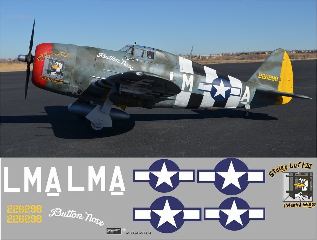

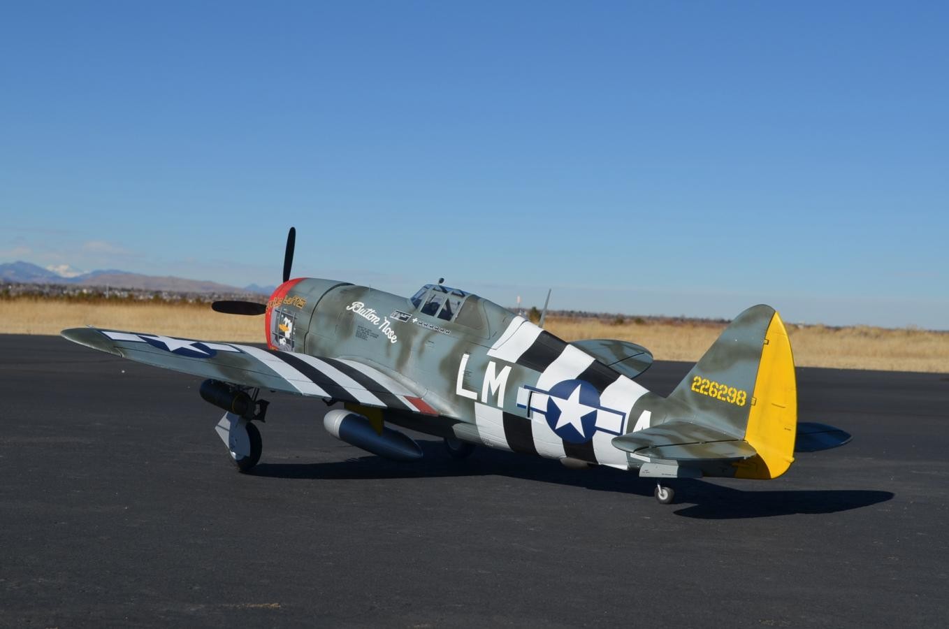

                                  I used to have a 1500mm P-47D razorback from FMS that I really enjoyed flying. I repainted it to a plane called "I Wanted Wings/Button Nose" that flew with the 56th Fighter Group out of England in WWII. Unfortunately, it went in a long time ago, and I recently got the urge to buy a new one to replace that one, and in the same colors. I've started in with the cockpit, just some minor changes like updating to a scale color for the cockpit, enhancing the K-14 gunsight a little, just basically cleaning up the cockpit some for a better look. Also added a armored glass representation that goes in the front of the windscreen on the razorbacks. I'll probably maiden it in present form, and then go to work on repainting it to the desired livery that I'm doing. I'll attach a few pics I just took of the cockpit area.

                                    Neat looking plane and like the added landing light. For what it's worth, if you're looking for true scale appearance, the landing light would be just behind the main landing gear door on the left wing, not in front of it. But then, I guess you wouldn't be able to see it as well as where you placed it. Still looks cool, even if it doesn't retract/deploy.

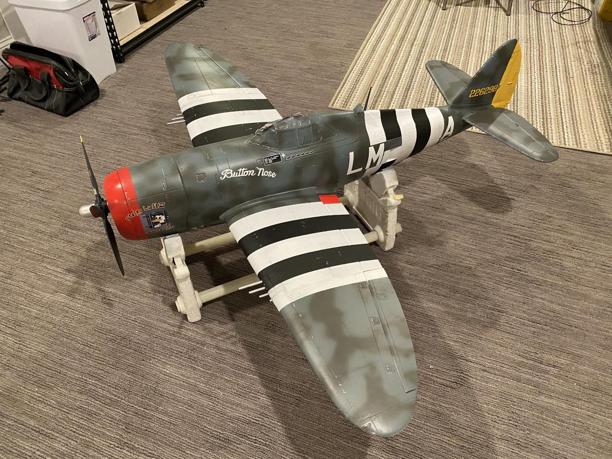

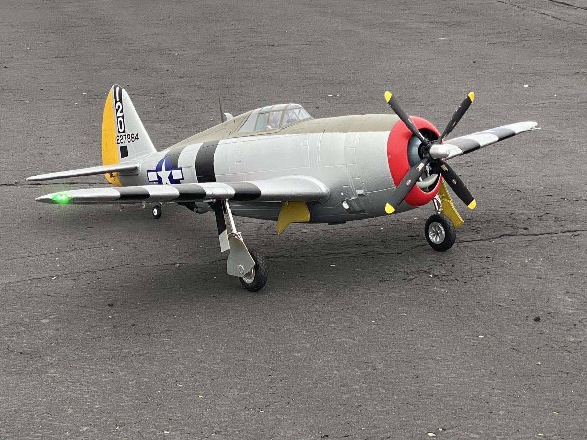

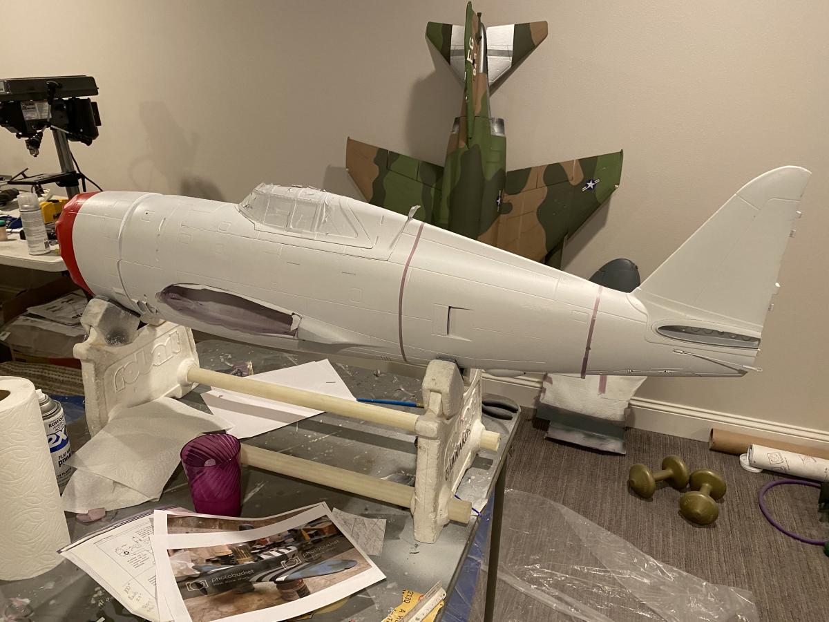

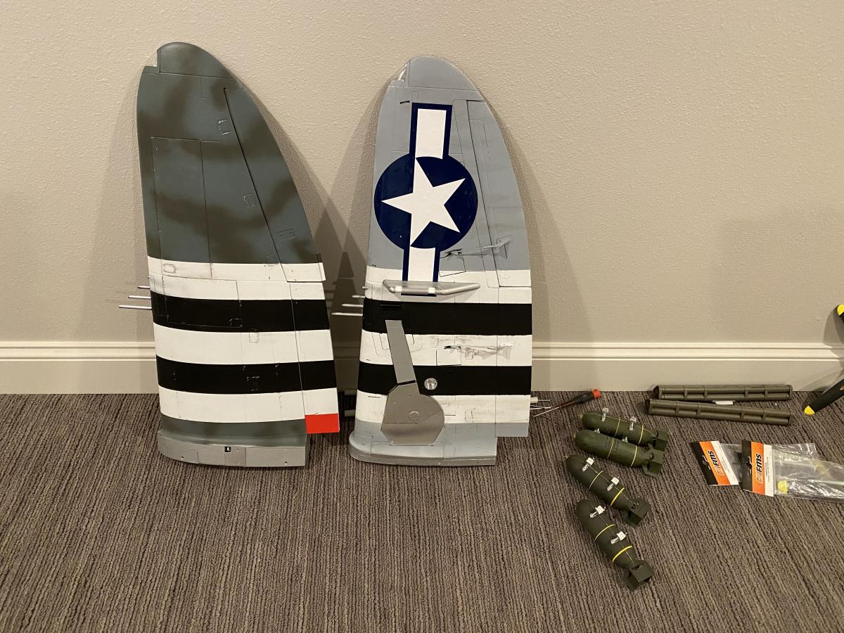

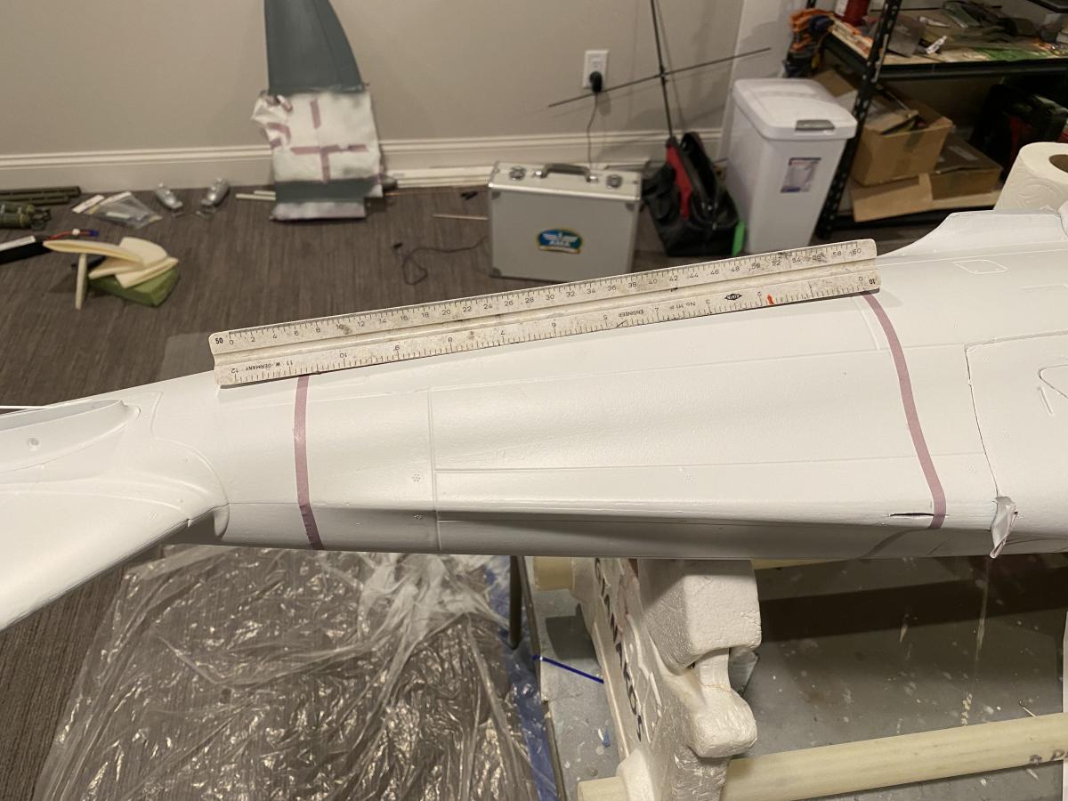

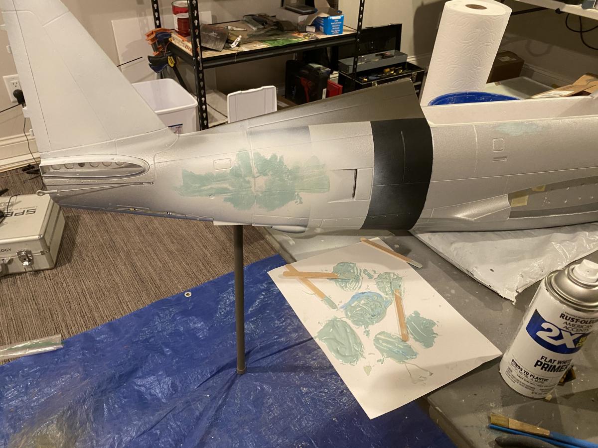

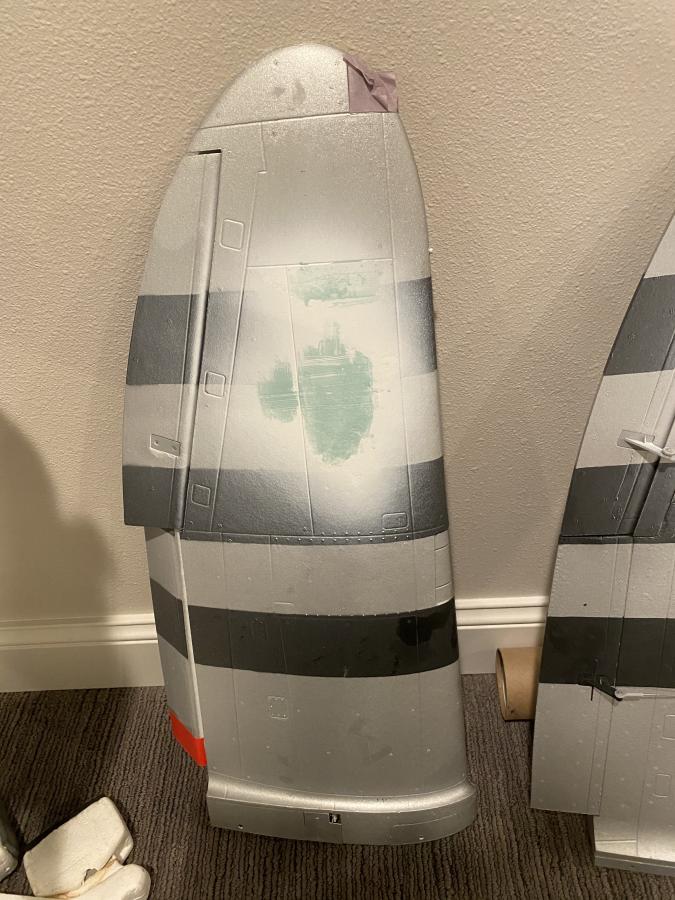

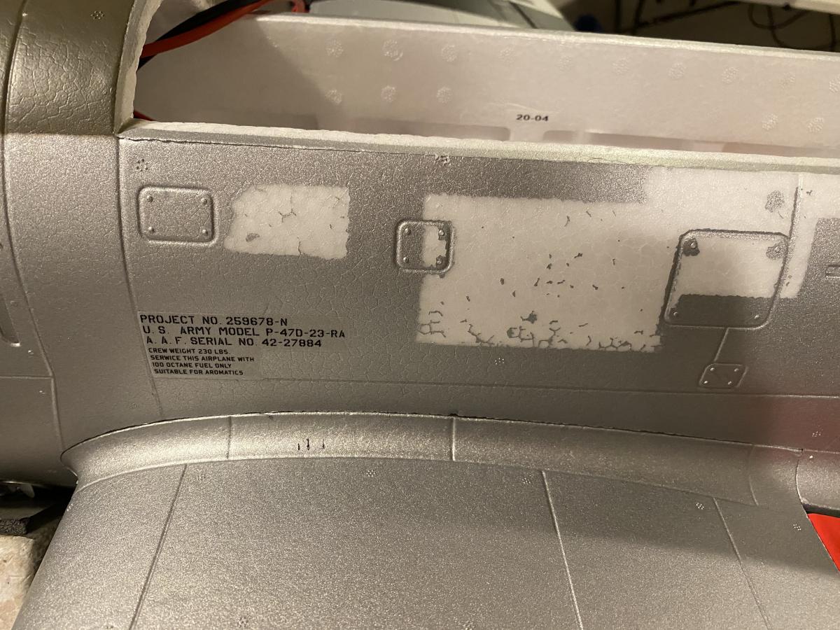

                                        I'm still working on the repaint of my FMS 1500mm P-47. This thread has been around for a long time, not sure if there is any interest, but I'll post some in-progress pics in case that might help anyone who is thinking of doing their own paint scheme change to an airplane that they have.
                                        I stripped off all the stickers from the original stock airplane. Of course, it took the paint with it, so I did some light sanding prep, then covered with a thin layer of Evercoat Metal Glaze putty, bought at a automobile paint shop. I like using this stuff, it goes on thin, sands well, and is pretty light. This took any scars from the paint pull off with the stickers to a minimum.
                                        I then sprayed the entire model with Rustoleum 2X white primer from Home Depot. This was a good base coat, and also would be the surface for the large invasion stripes on the wings and fuselage. After taping off the areas to remain white, I sprayed the upper parts of the fuse and wings with Tamiya Ocean Grey rattlecan paints. The green camo areas on the fuse and wings were airbrushed on using a match with the RAF Dark Green from my Spitfire. The undersides were painted Medium Sea Grey that I had matched from my Flightline Spitfire. The black stripes were taped off and sprayed again with Flat Black Rustoleum 2X spray from HD.
                                        I've started to add decals, made up from Callie. I'm still waiting on nomenclature decals and a couple of stars and bars for the fuselage sides. Once I get those, I should have it completed after a day or so of work.
                                        I have flown it a couple extra times now in its uncompleted form. I really love how it flies, pretty much typical P-47 characteristics and nice wide stance for runway tracking.
