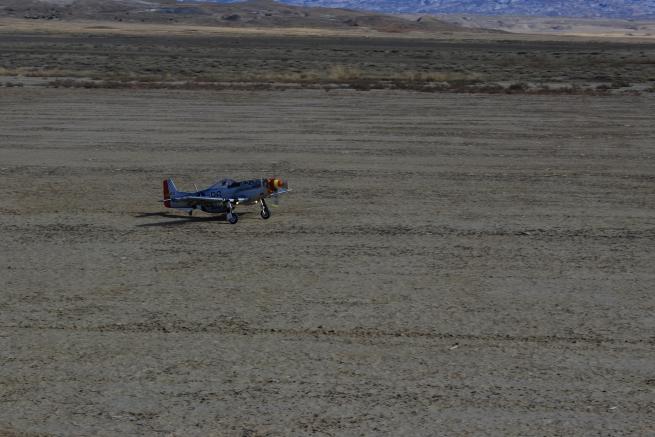

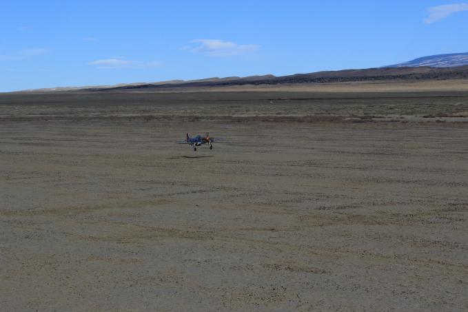

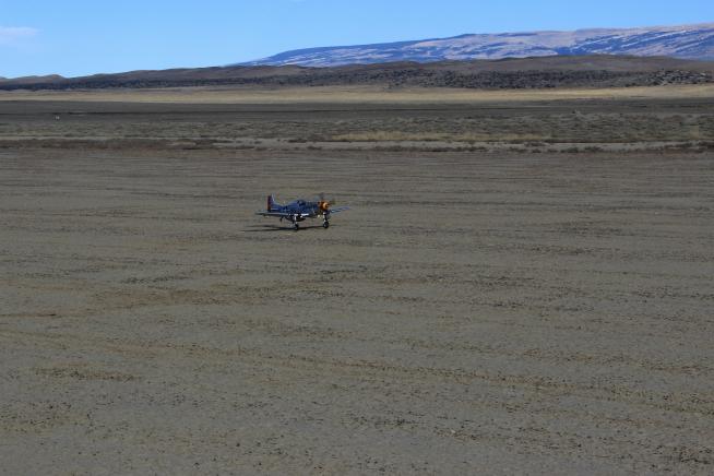

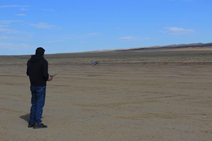

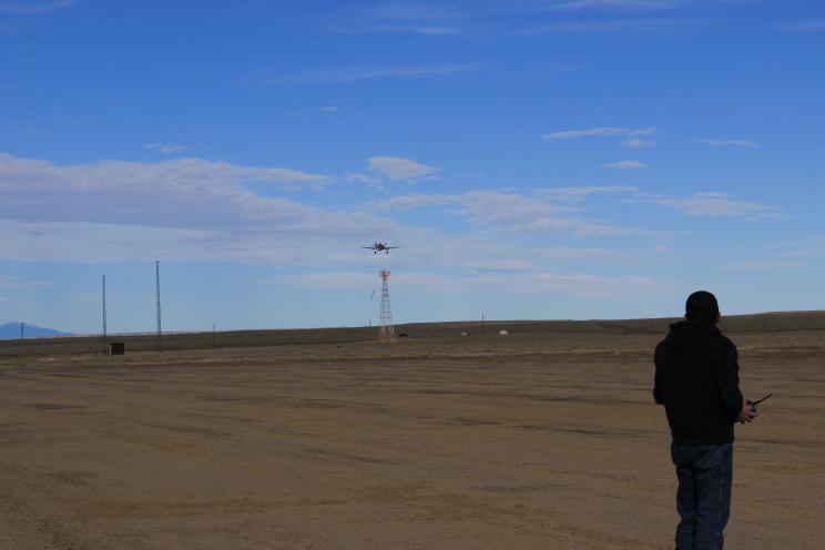

            Went digging' into the Grossman56 archives for you Way Bad. The wife was hot on the camera that day and I manged to nail one of the prettiest landings with Old Crow. Check the fuse position in each frame, it's textbook!! Click image for larger version
