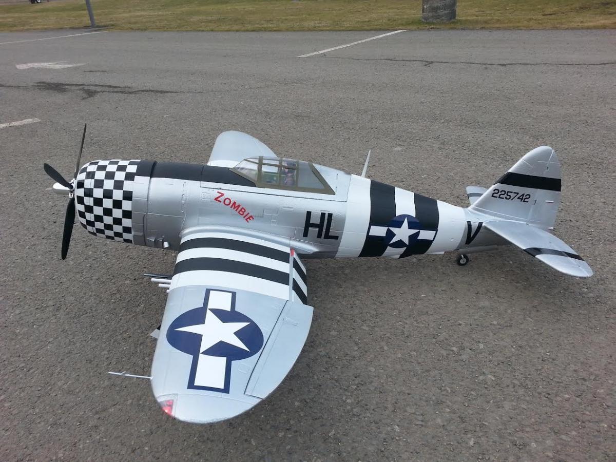

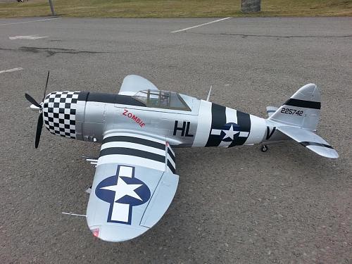

              I have about 20 flights on my FMS 1500 mm P-47D now. Besides the total repaint of the aircraft, I did put the tailwheel on a separate channel, and it is slaved to the rudder in a mix so I am able to use a reduced throw on the tailwheel movement. It was too much before being on the same channel as the rudder, now it is ok. The plane flies beautifully, It tracks well on takeoff and landing, and seems to have plenty of power for scale performance even at Denver's altitude (5,900+ feet MSL). I don't really care for the stubby prop, and perhaps I will make a mod with a larger propeller, motor, and ESC in the future. I really love the plug in wings, and so far have not had any issues of them trying to disconnect due to wing slop, no issues there at all. I highly recommend this fun airplane! I added some new photos.
                #267
                In a flexible assembly, floating the electrical connection is safer. There's a reason why hard connections aren't widely used even in much more rigid high performance turbine jets that are large and require disassembling the wing on every trip to and from the airfield. While hard connections are very convenient, and one would think they'd be in wide use on these large aircraft, there's a reason why flexible connections remain the norm.
                Davegee, I've said it before but that's a really beautiful paintjob on your aircraft, and is a depiction that I'm sure the pilot and his ground crew would be proud of if they could see it today! This FMS 1500mm P-47 does have satisfyingly good power, and I'm glad to hear it's doing well for you at your high altitude!
                  #268
                  davegee what a great paint job! I would love to see our birds together for some photo ops and flight video! Great idea about putting your tailwheel on its own channel then slaving to the rudder. I might have to try that out.

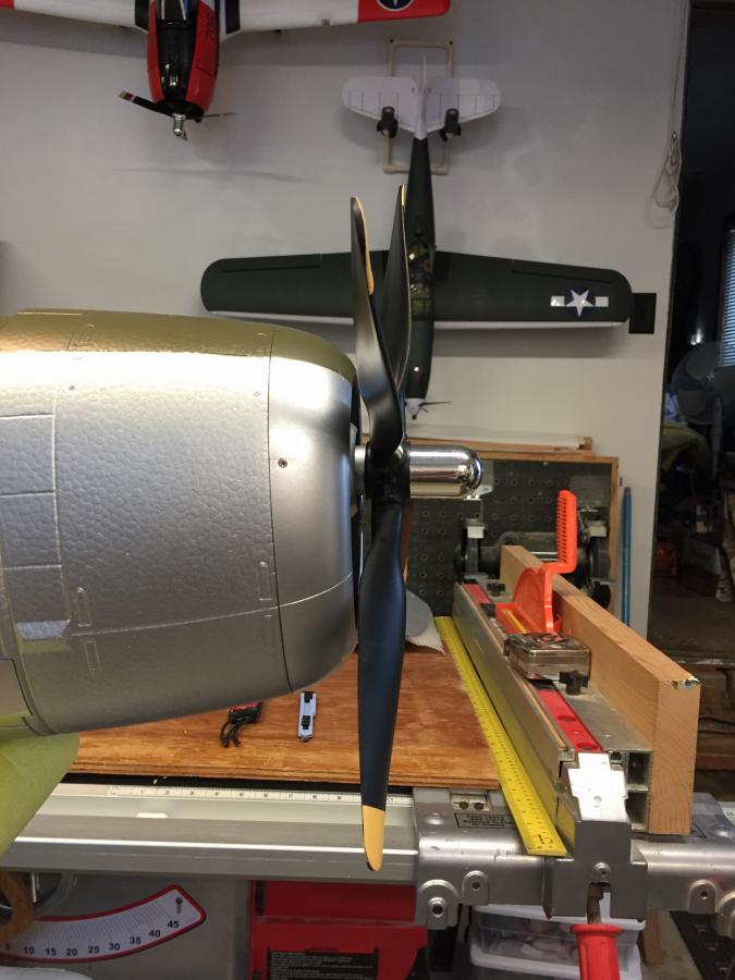

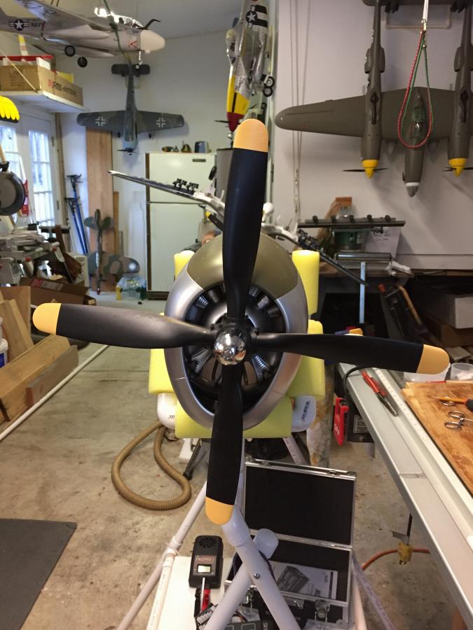

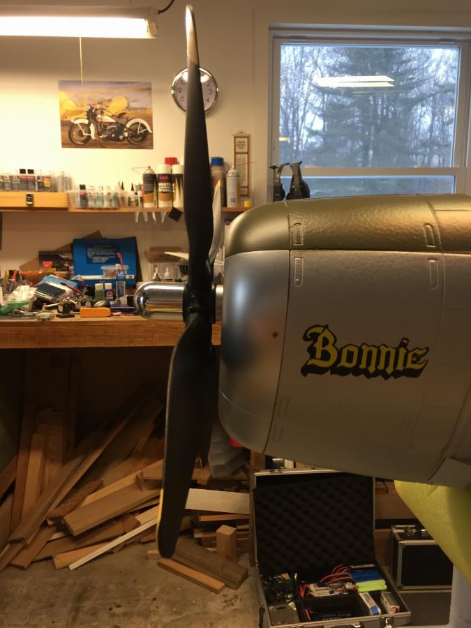

                                      Delta..........that power climb was awesome and makes me want to install my spare 5060 but I just can't get past the observations I made of that mod on post 237 :rolleyes:.
                                      So besides having the collection sickness that a lot others have, the mad modder in me is even worse.
                                      I took the stock 4258-460 out of the Razor and stuck it in the P-40B because it can handle the 6S battery size.
                                      Took the 4258-650 from the Warhawk and put it in the F4U-4 and the 4250-580 that I had transplanted into the Corsair last year is now going into my Dauntless to replace it's 4250-540.
                                      The 540 will go into the Bearcat using the Corsair 14" prop when I get some more buying beans collected.
                                      I now need to order that 4258-550 motor to try with the 16" prop on the Razor so that measurements can be done and posted and so that Aros doesn't get bloated from eating too much corn.;)
                                      OK Pilots...........the results are in for the 550 motor with the 16" Raider prop and a ZTW 85A Gecko ESC on default settings in a static test.
                                      I did a 100% throttle for 15 seconds using an Admiral 2200 4S 45C fully charged to 100%. Results are:
                                      10% used with 90% remaining capacity on battery. Temps on motor and ESC were insignificant(read warm)
                                      Vm = 12.43 ; Ah = .164 ; Ap = 88.85 ; Wp = 1142.3 ; Wh = 2.1
                                      Next was 75% throttle for 30 seconds which used another 30% with 60% capacity remaining. Temps cool
                                      Vm = 13.04 ; Ah = .329 ; Ap = 45.52 ; Wp = 618.1 ; Wh = 4.3
                                      Last was 50% throttle for 30 seconds which used another 10% with 50% capacity remaining. Temps, didn't even bother to check
                                      Vm = 14.66 ; Ah = .213 ; Ap = 28.64 ; Wp = 433.6 ; Wh = 3.1
                                      So based on the above readings I can expect about 6-8 minutes on a 4000mAh 40C Admiral with mixed throttle management and I also have a couple 6000 which would add another couple minutes to the total.
                                      At full throttle with 1100+ watts I should have no issue going vertical past the FAA ceiling(or my eyesight :p ) within the 5-15 sec burst.
                                      So now I just need for this upstate NY crap weather to go away to maiden the Razor, Tiger and a handful of others.
                                      The prop shaft that comes on the 550 is the thinner base adapter so I swapped it with the 650 P-40 motor that I put in the F4U and now both aircraft props look appropriately spaced.
                                      Here's how the prop and motor look on the Razor.
