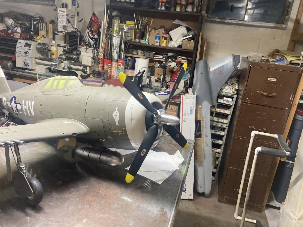

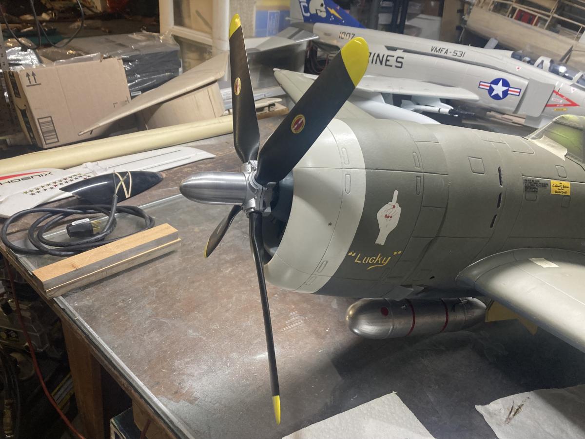

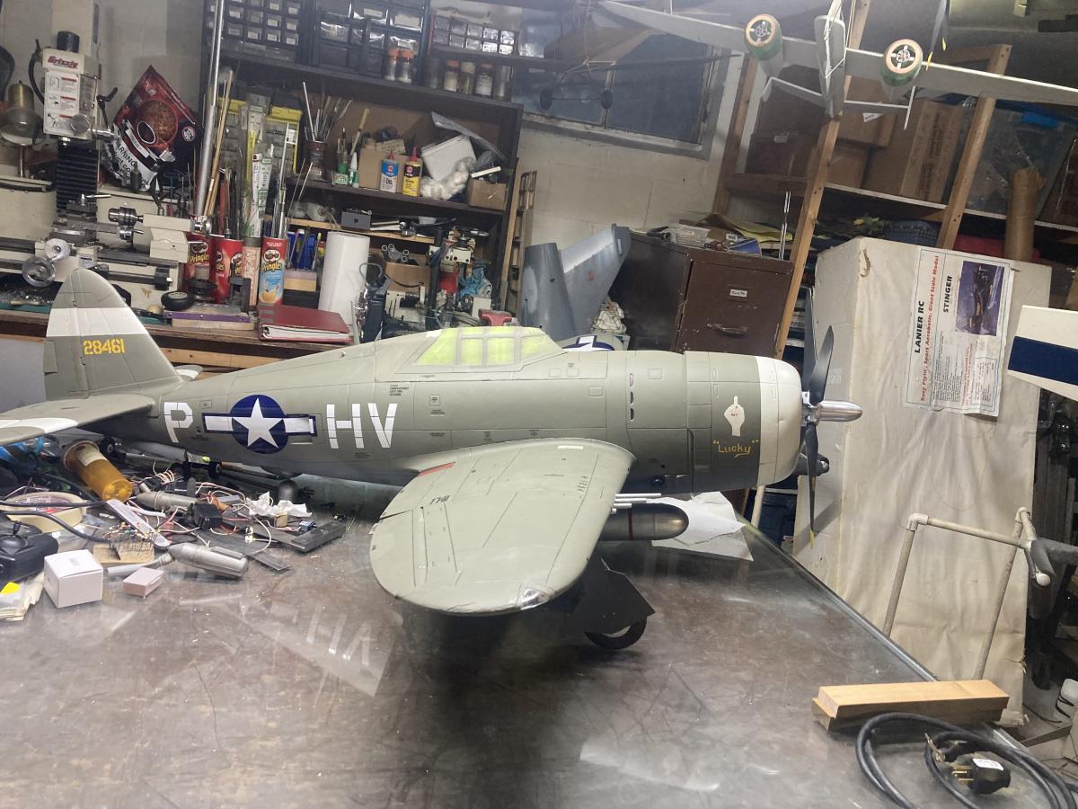

                        Guys I have installed the alum. spinner on my P-47. It really adds the scale appearance to the V2 FMS Corsair prop. I'm thinking to lighten it I will make a lighter outside spinner and make a stud that screws into the nose of the spinner and would then screw to the motor shaft. It would be 2 pieces but look like one piece when assembled. Davegee what are your thoughts? I might need to move the battery back a little on the battery tray to balance the C/G. Some pictures of my original alum. spinner.
                        Best Regards, Rex
                          Best Regards, Rex

                          Hi Rex: I'm really liking that spinner! My only concern is the weight, but if you can reduce it somewhat, hopefully we can use it. Because the battery bay is slanted down in the nose on that plastic strip where it locks in place, I don't know how you would move the battery back any if you had to compensate for the weight of the spinner. On a flat floor it would be easy to do that, but I'm hoping that you can reduce the weight of the spinner with your plan to make it in two parts that might do the trick and not mess with the CG too much.
                          Please keep us informed on this. I would definitely be interested in one of these for my "Ol' Cock" P-47 that had the Curtiss Electric prop!

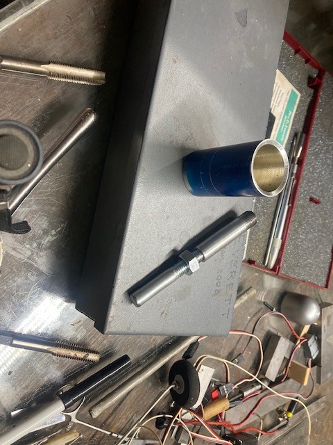

                            I turned a center stud tonight, 10mm internal threads for the motor side and 1/2" external threads to screw inside the front of the spinner. Bored this stud out to keep it as lite as possible but enough strength to support the spinner. Going to turn another spinner and drill the inside out with 5/8-3/4" remaining in the nose. Thinking a 1/16" spinner wall thickness down to the solid nose will work. Fingers crossed.
                            If you're ok on waiting on returning your parts I will send a prototype spinner along with them for you to try out. The stud only weighs a few oz. so we might get lucky on total weight.

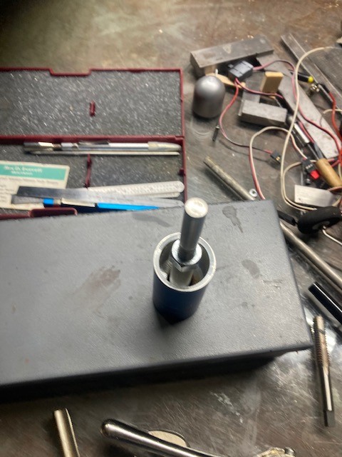

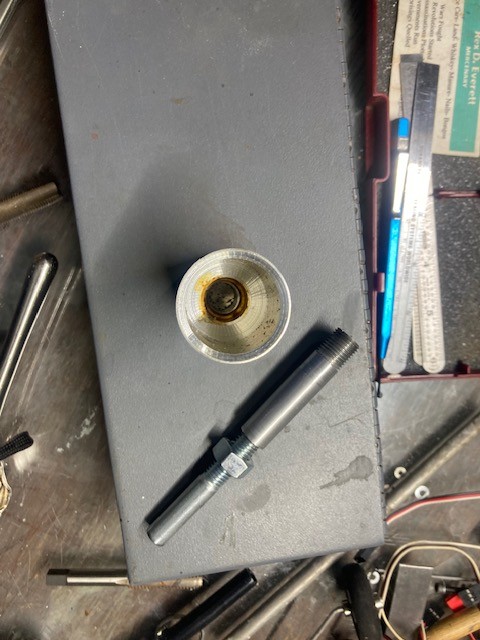

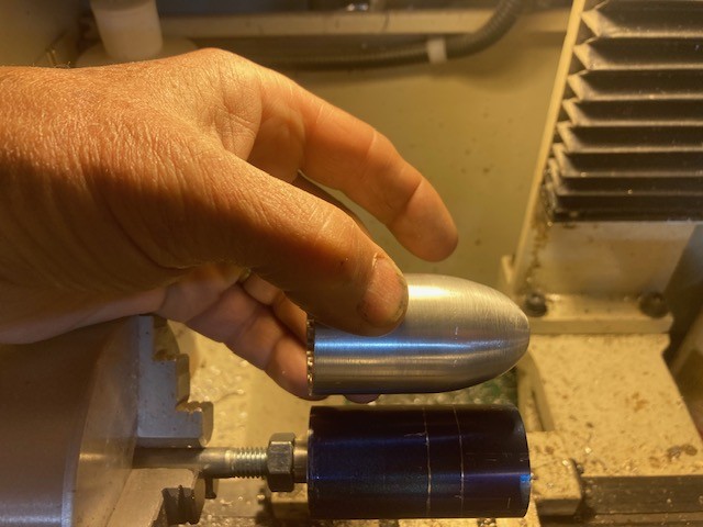

                                Hope everyone doesn't mind seeing me trying to make a scale spinner. Trying to make it as lite-weight as possible. I can turn and bore on my lathe but the radius of the spinner I'll do with a file while turning in the lathe, a long tedious process. Some friends think I'm nuts for doing these things. Probably am! I have already lost 1 oz. of weight from my original alum. spinner. As you'll see in the pictures, I have a lot more metal to remove. I made a mandrel to match the motor threads and I can hold in the lathe to do finial shaping.
                                Please let me know if you want to see this or not.
                                Best Regards, Rex

                                  All good workmanship needs to b. Seen

                                    Thank you F4Uausie. I have always been interested in seeing how scale modelers-built things when I started modeling and just thought it might be interesting. A 3D printer is on my wish list but now I still do things the OLD fashion way. Keeps the ole' brain waves working
                                    Best Regards, Rex
                                      Best Regards, Rex
                                      Rex,
                                      I applaud you, Sir.
                                      You want a 3DP printer and I want a lathe.
                                      You are correct when you say all this modelling keeps the brainwaves humming.
                                      Best, LB
