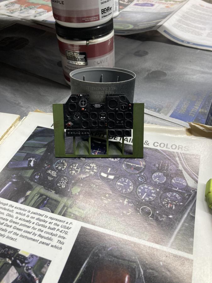

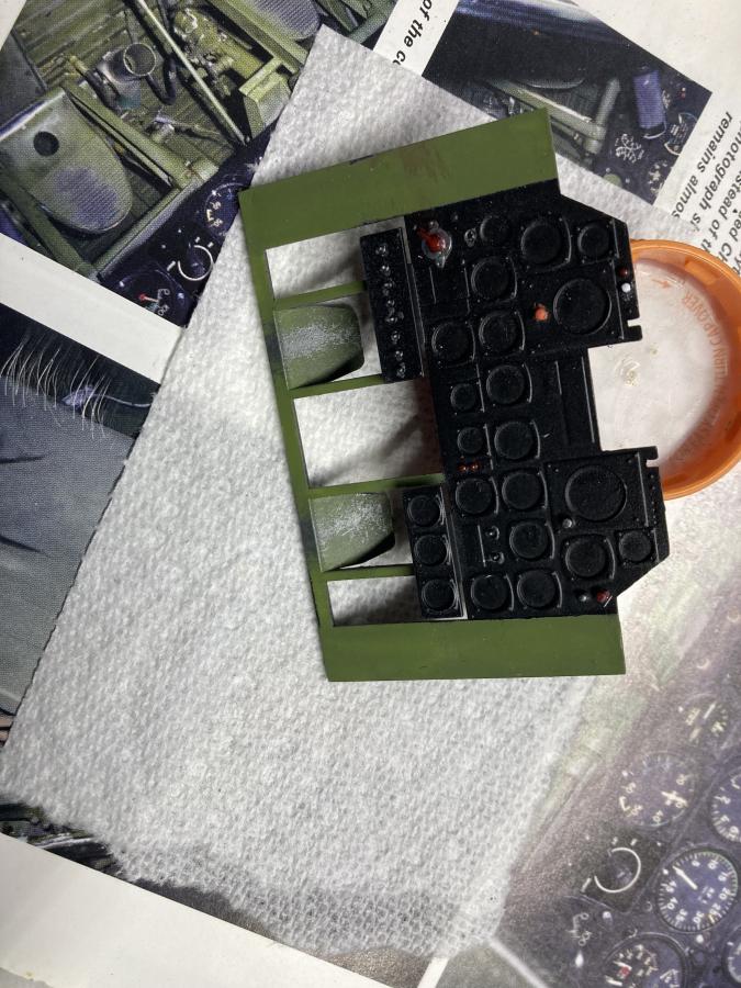

        While the primer dries, I moved on to working on the cockpit inst. panel. I removed the inst. (they used several of the same inst. 4-5 times), painted with inst. black then detailed some of the switches. Took the liberty of using some brighter colors on the dials to stand out against a black panel. I will install some instruments from my pile of stash.

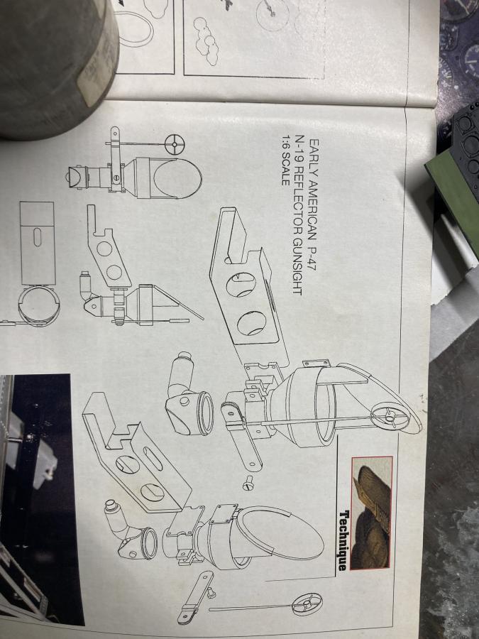

        From an old Scale r/c International mag. I will make the early gunsight used on the P-47.

            Looking good, Rex! You can do what you wish on the gunsight of course, it is the basic type used on the P-47s at that point in the war. For what it’s worth, that’s the type used by the Navy and Marine Corps. The only change for the P-47s is that they didn’t have the curved piece on the front of the gunsight and an oval reflector glass on top of it. Instead, that was removed and a square or slightly rectangular glass is mounted on top of the round gunsight glass at an angle and attached with a couple of small connectors to keep it in place.
            A small detail, take it for what it’s worth.
            Here's a link to what the actual gunsights in Europe witth the USAAF on the early P-47s looked like: https://images.app.goo.gl/Y5XNn7X6yFEtZX4GA
            They are very similar to the Navy one that you showed in a previous update.
            The "ring and bead" was installed as a back up as seen in your photo. If you can make a small crosshairs ring and attach it to the left of the other gunsight, then ou would add a small piece of metal rod that sticks out in line with that crosshairs forward of the windscreen several inches ahead on the cowling of your model. That way, if the advanced gunsight craps out, they can still try for an old fashioned sight to shoot the enemy!
            cheers

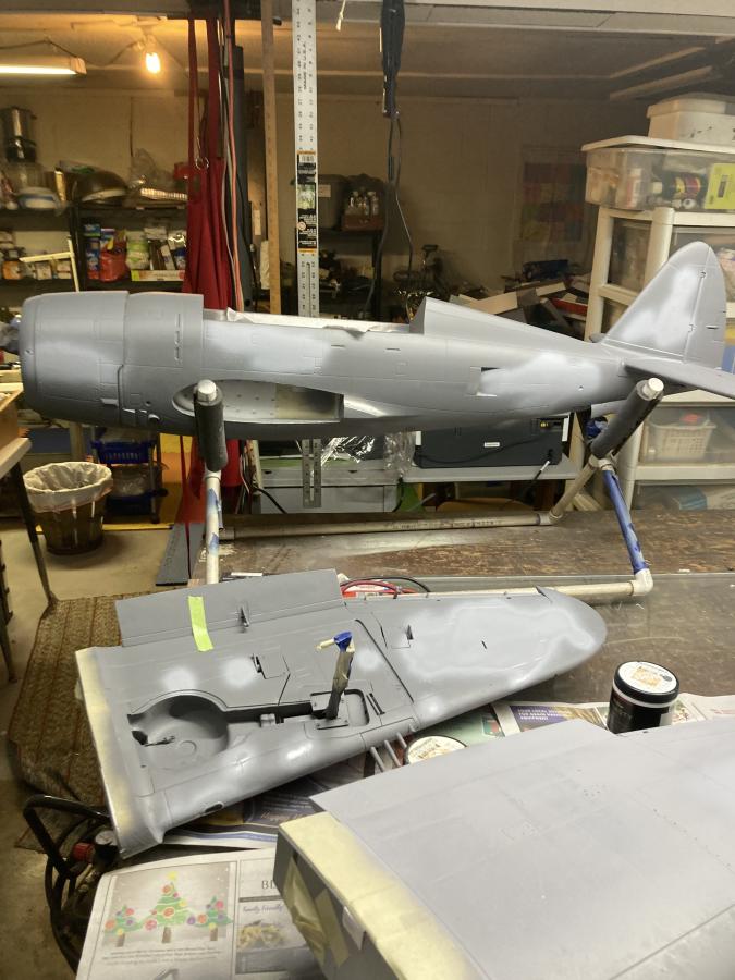

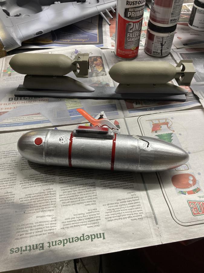

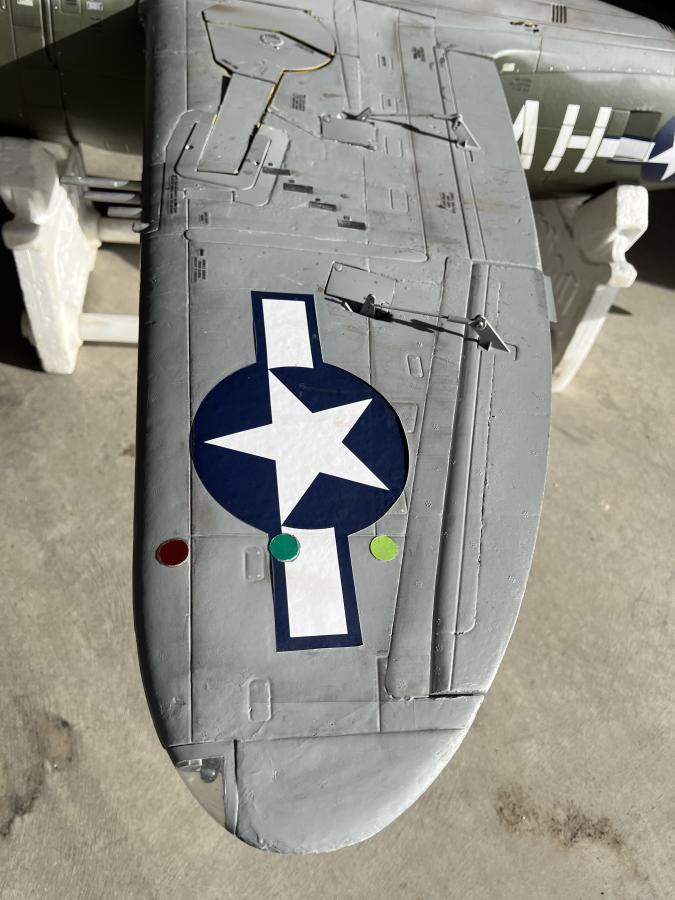

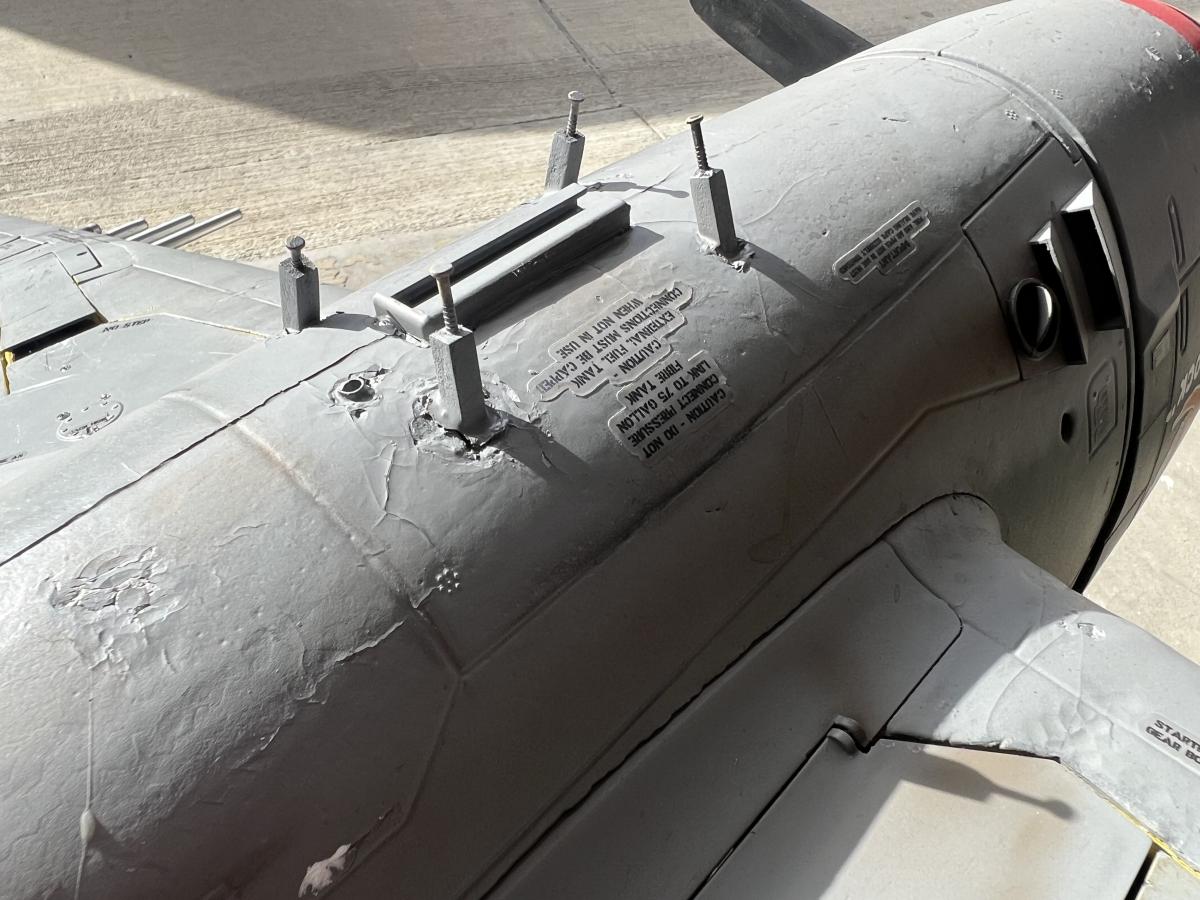

              Sprayed some filler primer where stencils were removed and filler on mold cavities. Will sand tomorrow then re prime.
              Worked on a few things while waiting on primer to dry

                  The drop tank came out very well! You can take that black feed line and attach it to the plane loosely if you wish. What I did was figure out where the line would attach to the fuselage and glued a small aluminun tube into the fuse so I could just shove the line into the tube a bit. Looks realistic and believable.

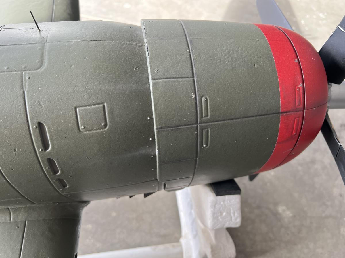

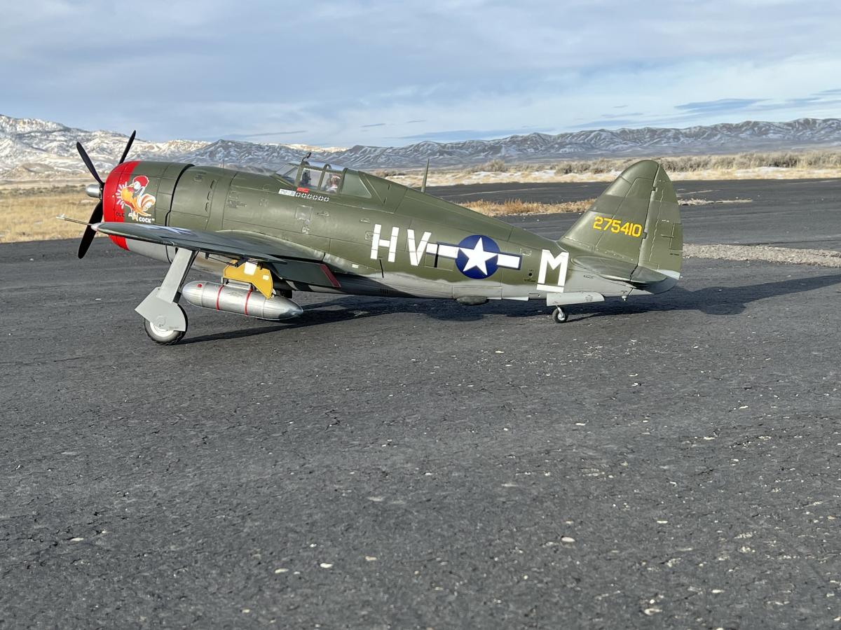

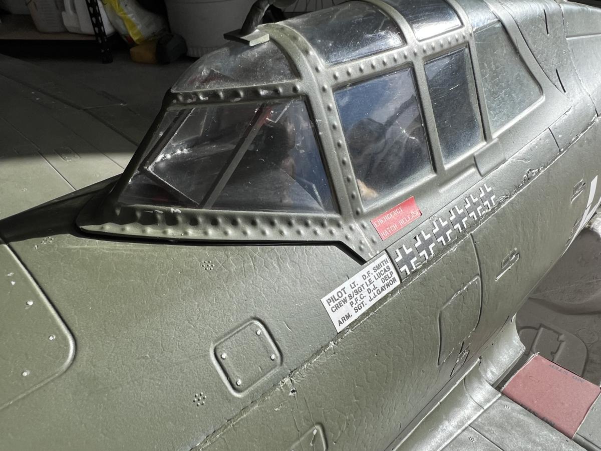

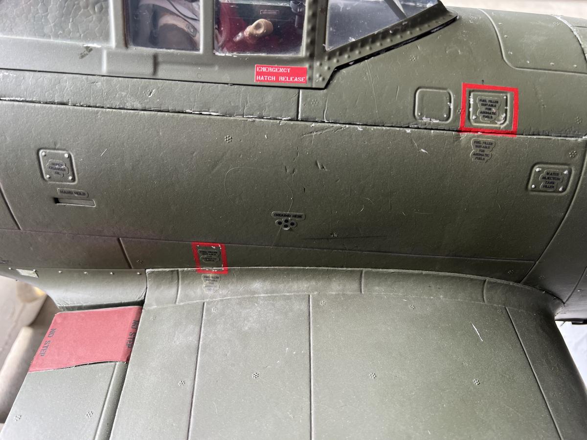

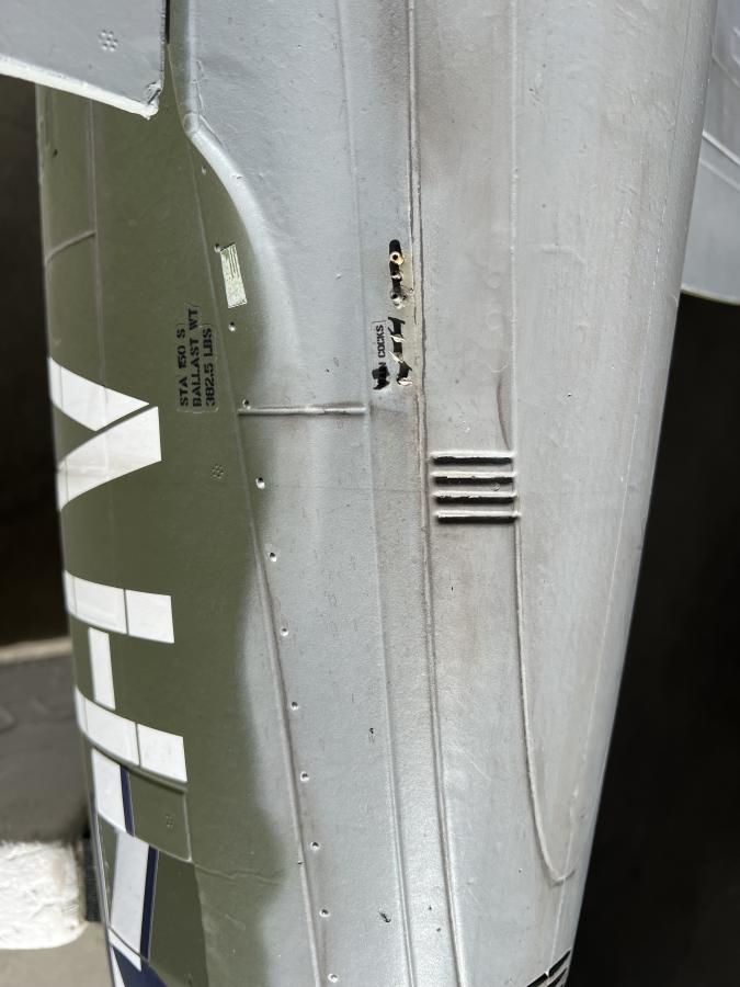

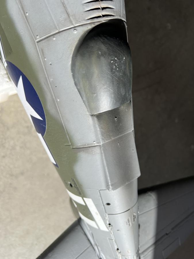

                    Hi Rex: I tried taking some pics of Ole Cock P-47. Unfortunately, a lot of the weathering details that you can see clearly with are lost with my I Phone camera. For what it's worth, I'll post as many as I can as they take up a lot of file space.
                    We can talk about details that you might want to add for realistic weathering. Unlike the birds in the Pacific Theater, these in England were well taken care of, within reason. The other thing is they were still pretty new so most of them were cleaned up by the ground crew as much as possible for their pilots.
                    Hope this helps some. Too bad we couldn't be in the same room or field to see them better with the naked eye. I have 30 lfights on this one so far, so some parts have been "dinged" up a bit.

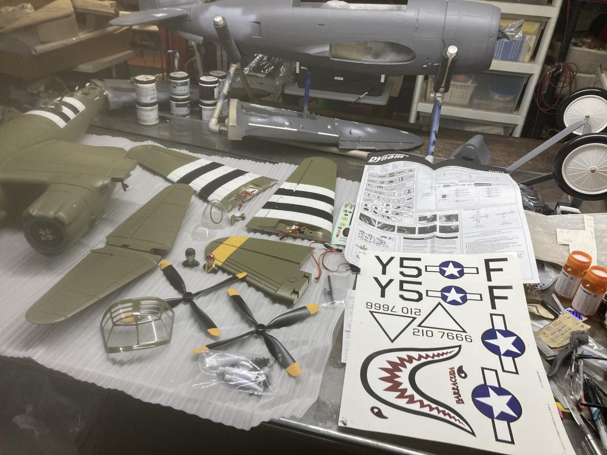

                        Today before sanding I spackled some aera's that needed more filler. While waiting for this to dry my wife called me to the door. A large box was on the doorstep. Noticed she was smiling and taking photos. This is what she surprised me with.

                        This was a big surprise to me. Overall, the plane is in very good shape. There are a few foam issues but planning on adding new paint and details so these will be taken care of. tested the electronics and everything works. I have read on many of the modifications to make this fly well. There are many STL for cockpit, nose gunner, bomb bay etc. Enough things after the P-47 is finished to keep me busy until spring. Going to keep the HS class 3-d printing all semester.

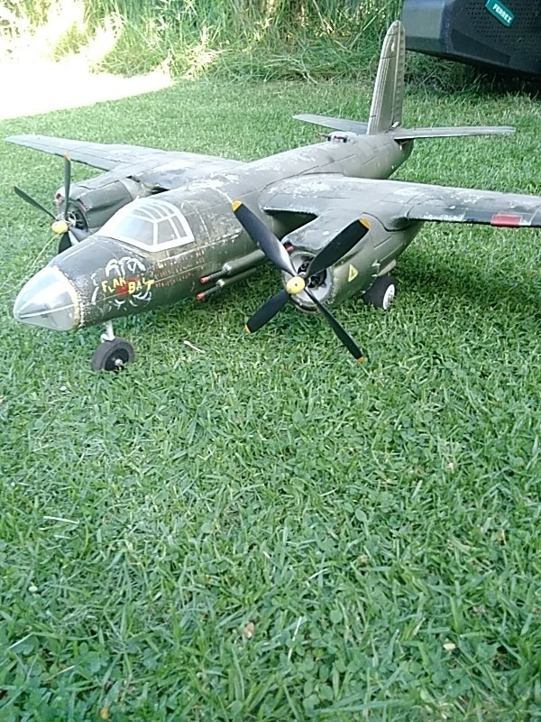

                                Happy new year all rex i had the dynam b26 early in the peice,, dynam got me into it all(good 4 entry level) it flew very well , had great presence,, put around 70 flights b4 it went to foam heavan,,, anyway i painted as flack bait ,, luved it,,hand painted nose art.. it was an early silver color,, looks like yours is an upgrade,,, so with the silver base, a bunch of rock salt , and green paint job done,, u goina b busy... have fun b safe,,, oh p47 lookin awsome Click image for larger version
ID:	417111 only trouble i had on grass ,, breaking props on landing

                                  Happy New Year, f4u Ausie! In the USA we’re still a few hours away from ringing in the new year 2025!
                                  I like your B-26 Flak Bait and how you painted it up. Too bad it went to foamie heaven, but you still had some good times with it. The real Flak Bait is being restored at the Smithsonian’s Udvar-Hazy center in the Washington DC area. I got to see it with the wings in storage cradles years ago. It Still had mud and grime on the underneath of the wings decades later!
