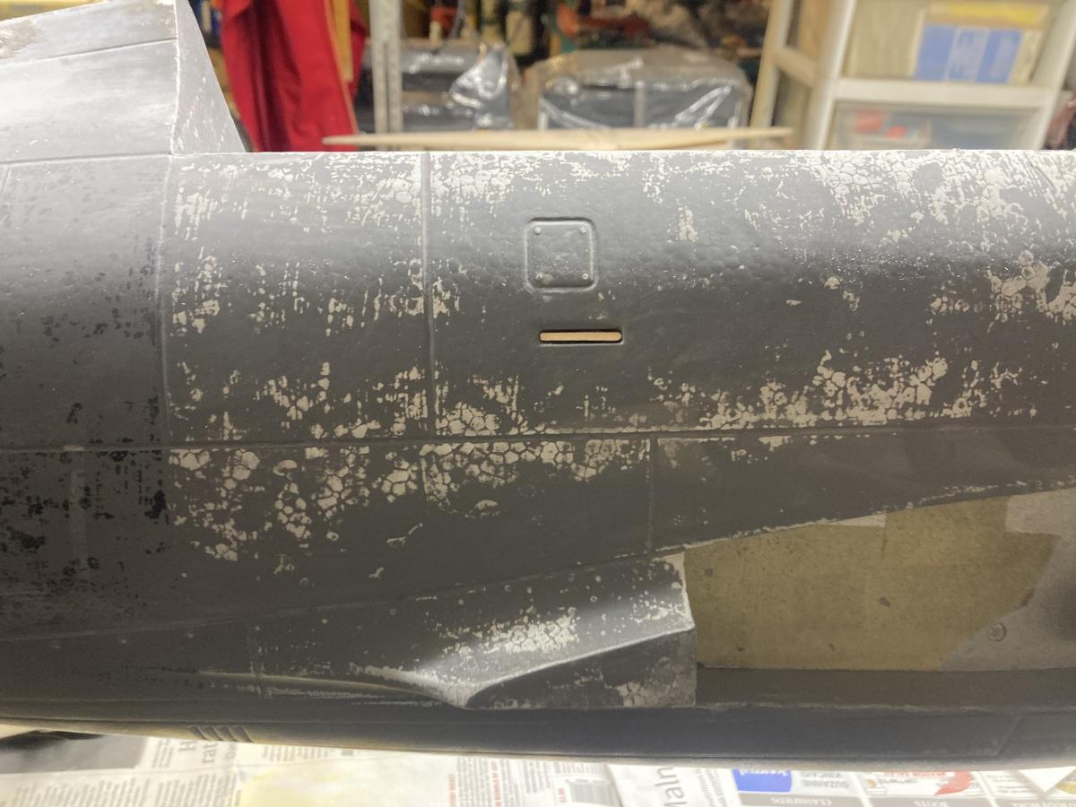

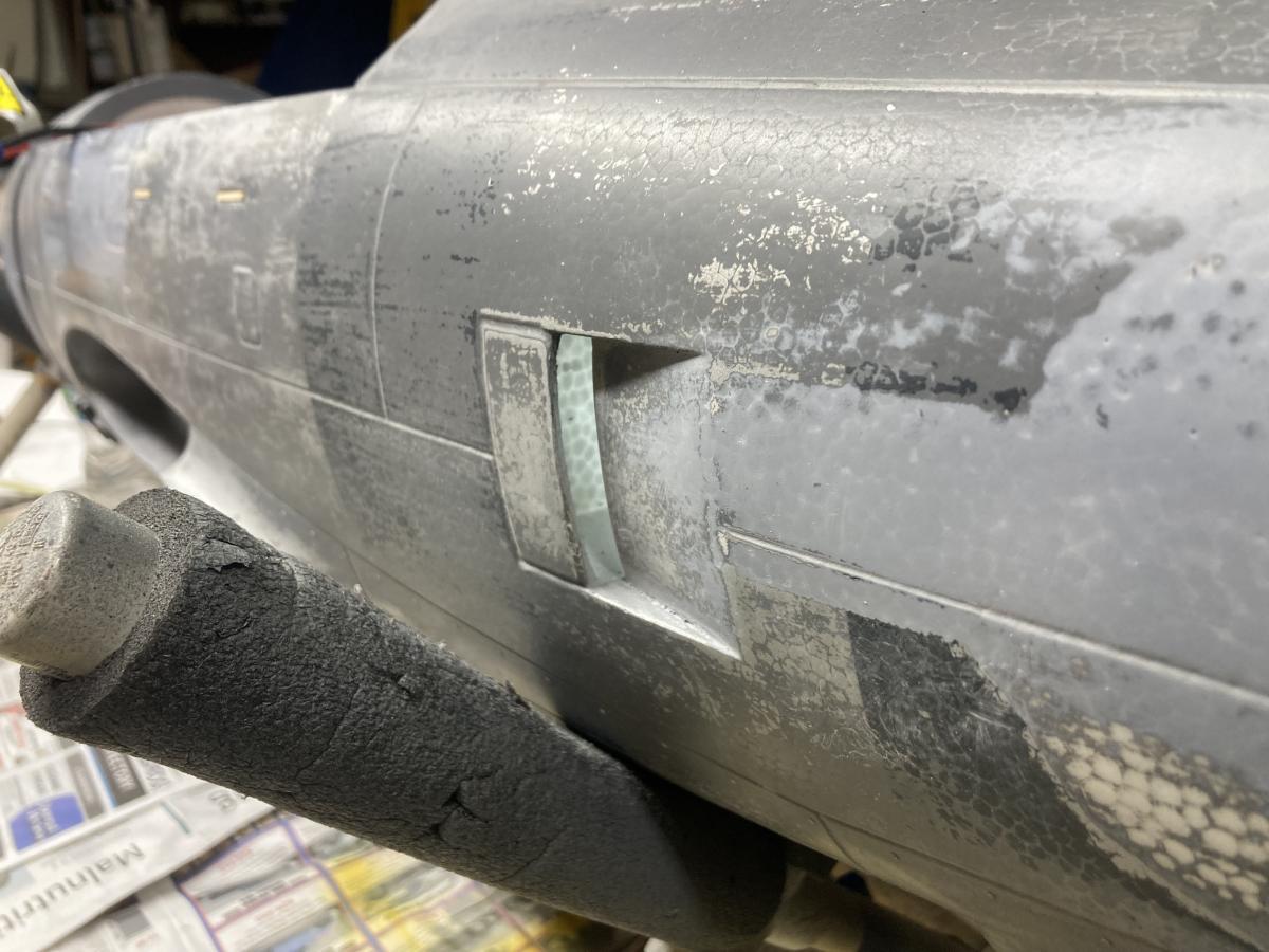

          THAT'S Enough!
          Added the tail bumper jack and I think that's all the mods on the fuselage and wings. I still need to detail the cockpit but after an Alcohol rub down (maybe a beer also) I will start painting the grey paint on the undersides.

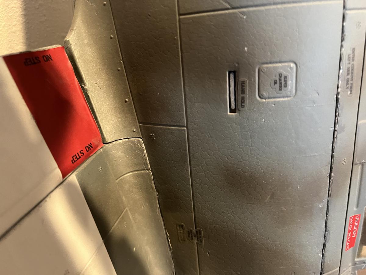

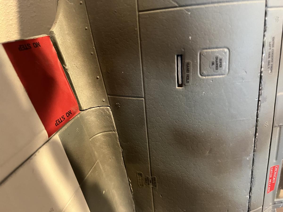

            Hi Rex: sounds like things are really coming alonig. I have one more minor suggestion, totally up to you if you want to do it or not, but the FMS P-47 has three small (3) rectangular depressions in the foam, two on the left side of the fuse between the cockpit and the wing, and one on the right side of the fuse, again between the cockpit and the wing.
            These were pull out spring-loaded handles to get up to the cockpit from the wing. The usual way of getting up to the cockpit was to get behind the flap, pull on the closest of the two handles that are flush to the fuselage, and both come out around 90 degrees. You use this as a hand hold then once you are up on the wing, grab onto the next one and you are near the cockpit. Although not used nearly as much, there is one pull out handle on the right fuse if you wanted to get up to the plane that way. I would guess maintenance personnel used the right side handle, but the pilots used the left side, maybe alluding to how people mount a horse to ride.
            I used a little piece of wood like a toothpick or somehing, cut it so it fit flush to the depression in the foam, glue it in, and you're done. I bet few rc builders do that. On my larger models for competition. I had these handles springloaded so that when you pulled on them, they came out just like the real thing. I didn't bother with a foamie,but it looks more finished or complete that way, IMHO.
            I'll attach a couple pics on my I Wanted Wings P-47 for demonstration. Just thought I'd bring that up for consideration before you start priming and painting.
            I did not paint my struts steel color, I just left them the silver color that they came installed on the airplane. I found a few decals from books to copy, cut out, and print. Not the best, but they are what was on the plane. I don't know if Callie has any or she could certainly make some if you have a decal from a book or plastic model sheet that she could blow up and you could stick them on your gear strut.

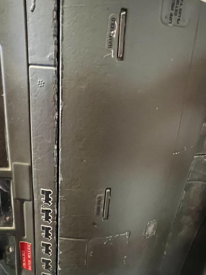

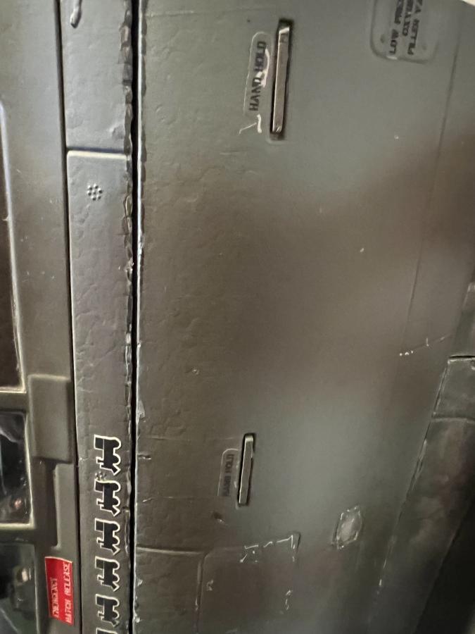

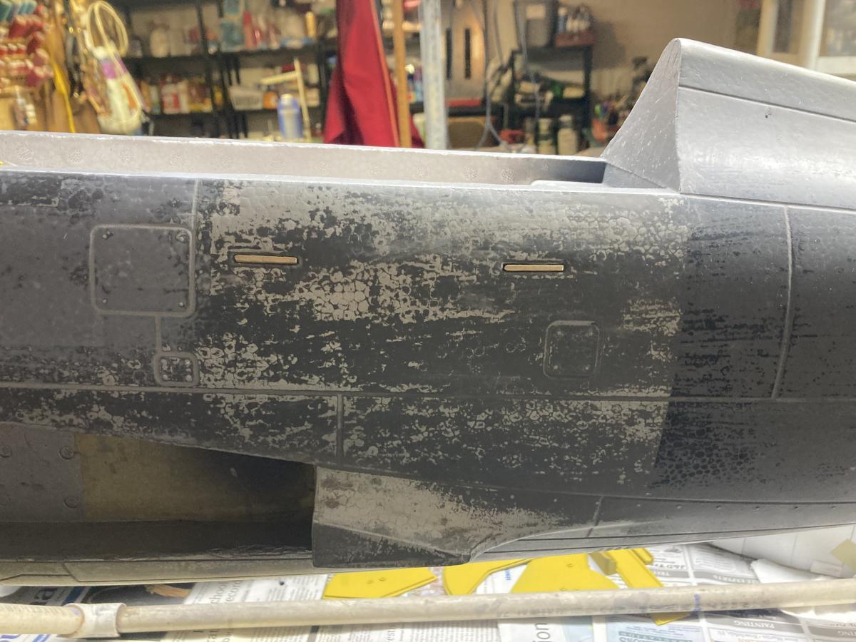

                  Ran down to my man cave and added the handles. I added the tail jack support yesterday and then I decided to spray the wheel wells and strut covers yellow chromate. Just adding the toothpicks (flat) really stands out for the handles. I beveled the inside of the turbo charger doors to look thinner from the outside. Just looks better to me

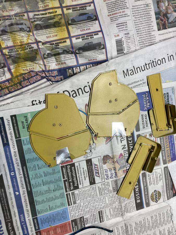

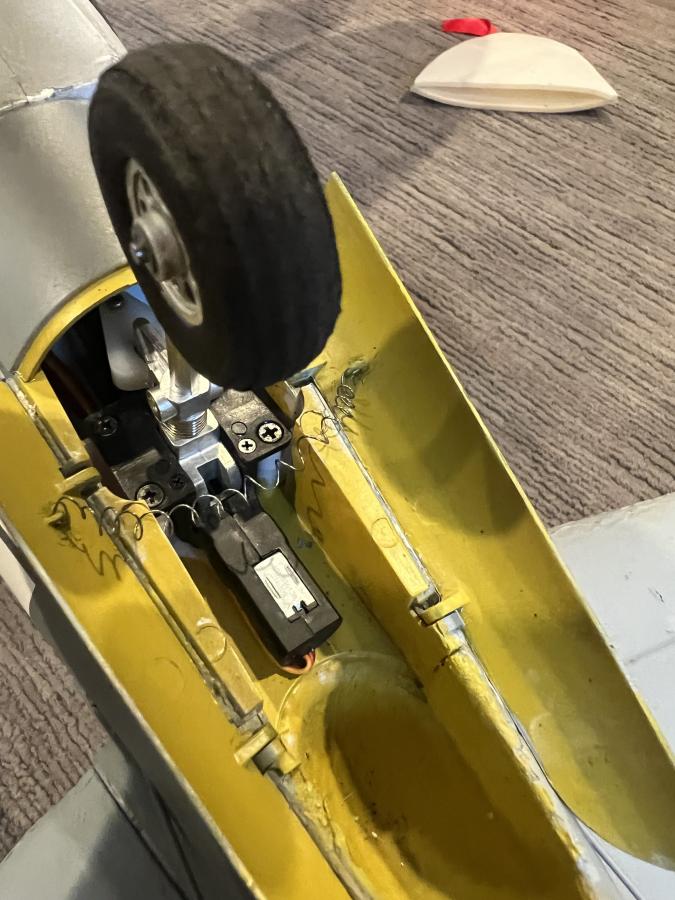

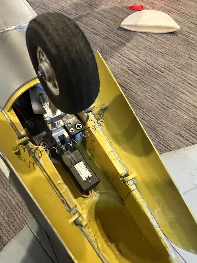

                    Looks great, Rex. The yellow zinc chromate for the wheel wells and inner gear doors is correct. I don't know why FMS had them green zinc chromate, but that is incorrect.
                    The intercooler doors on the sides of the fuselage that modulate open and closed during flight, depending on cooling needs for the compressed intake air back to the carburetor were air-to-air heat exchangers that normally would not have any exhaust streaks coming out from them. I've seen modelers incorrectly have streaks coming out of them like gun exhaust or the waste gates behind the cowl of the airplane. I'd recommend not trying to "embellish" them in any way with exhaust streaks coming out of the intercooler doors.
                    Do you have a plan worked out for more correctly making the tail wheel doors so that they aren't set up per the incorrect way FMS designed and made the retraction/extension mechanism? There is an easy fix; let me know what your plans are and if you have any questions.
                    Keep up the great work!

                        Hi Rex: there are a variety of things that could work. In most cases for me, I used ballpoint pen springs and gently stretched them out to the proper length. You can bend the ends of the spring with a needlenose pliars so that it will hook onto the small stanchions on each door on the inside.Ideally, when open the doors should splay out pretty far like the real ones do. It will take some trial and error, and adjustment from time to time. But I have found that they work pretty well, certainly more scale movement than the ridiculous arrangement FMS came up with where the tail wheel doors sashay back and forth on the groud when it is taxiing and turning. I guess it works, but not satisfactory look to me.

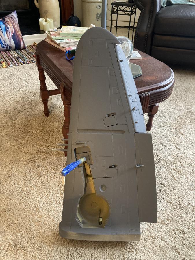

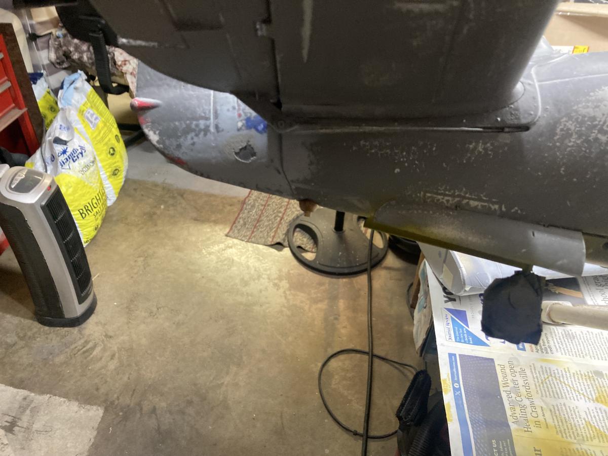

                                Sprayed the grey paint on the lower fuselage and wings last night. This morning it looks beautiful. Very little Latex paint was used for a good covering.

                                    I took a short video and a still of my tail wheel setup. It takes so much memory to post any video, I couldn't send the video. But this is what I have so far. Let me know if you need more. One reason for the ballpoint pen spring idea, is that the tailwheel servo can't handle much resistance from the spring when it closes. It very easily can get bound up and maybe the tail wheel won't even come out, which is a bummer for landing. Not a terrible amount of damage to the closed tail wheel doors, but some sanding and a repaint.
                                    Get a spring from wherever that is pretty loose and does the job. Will take some experimentation, but you'll be happy you did, over the OEM FMS setup, which is laughable, IMHO. Notice how the gear doors are splayed out properly, maybe not as much as the real thing, but definitely better than just hanging straight down.
