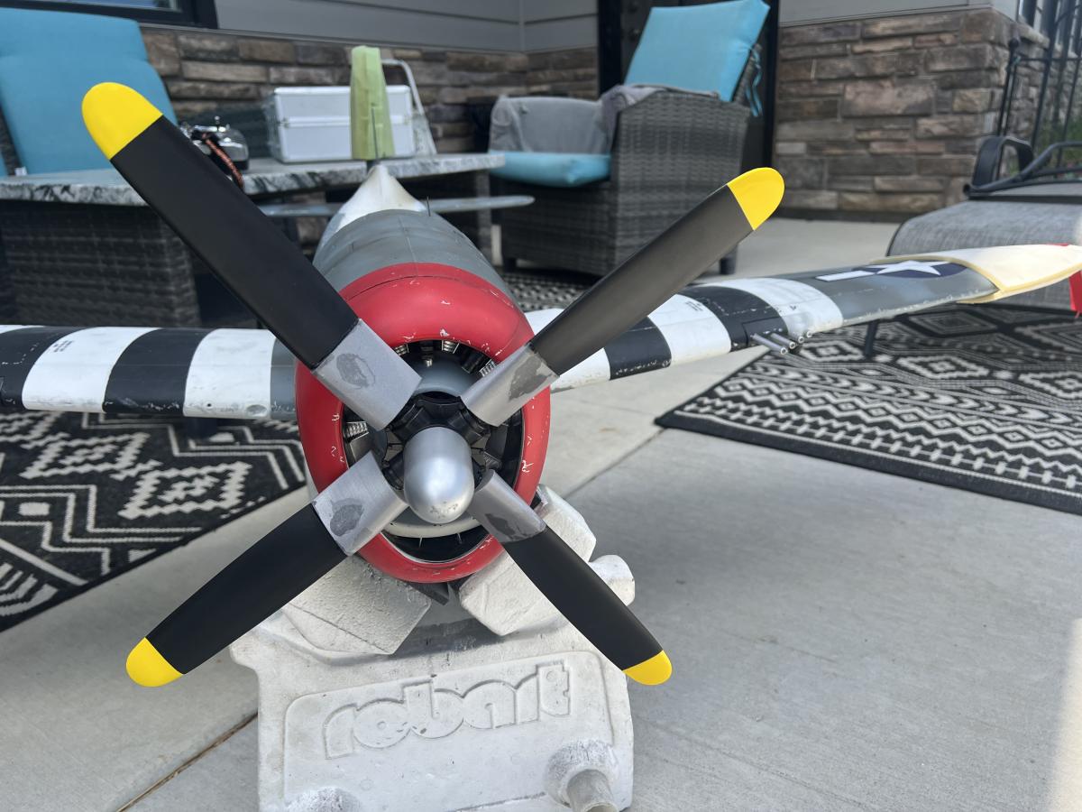

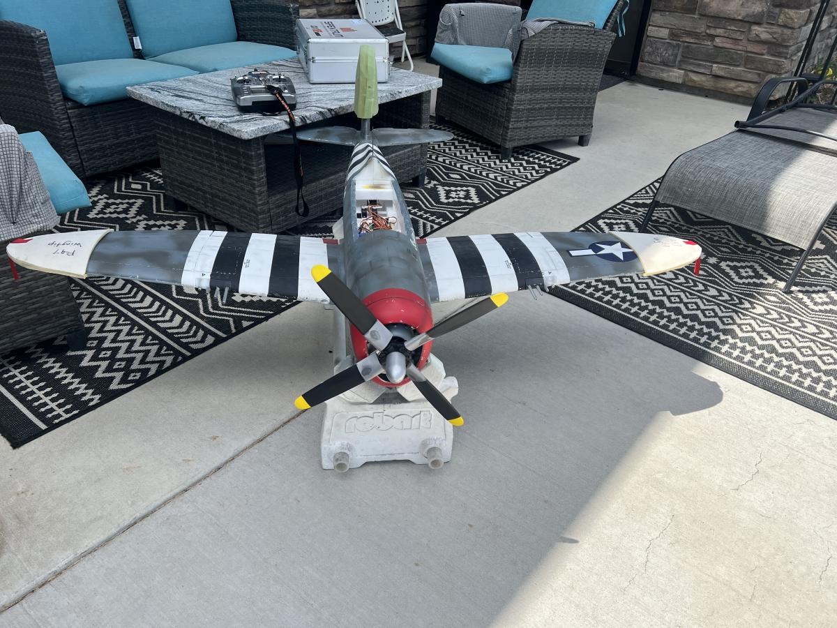

                I just completed a static test of a new prop with the reprinted Elbee V2 improved Curtiss propeller cuffs. This time I used a lot of E6000 flexible glue and later sealed the two ends of the cuff with super glue to help keep them in place and not want to depart the airplane. They look to be on there very solid now. I ran the prop through the wringer, full power for about 30 seconds about 4 times. and then simulated rapid power changes between idle and full power and all in between as might be encountered on a flight.
                So, thiis test prop (all parts unpainted until I give them the "thumbs up" after some test flights tomorrow morning) will hopefully pass with flying colors and then I'lll do more test flights with the Elbee final version Curtiss prop dome on the intended airplane "Ole Cock." For tomorrow, I'll be using my oldest surviving P-47, I Wanted Wings.
                Will report back after tomorrow's test flights!

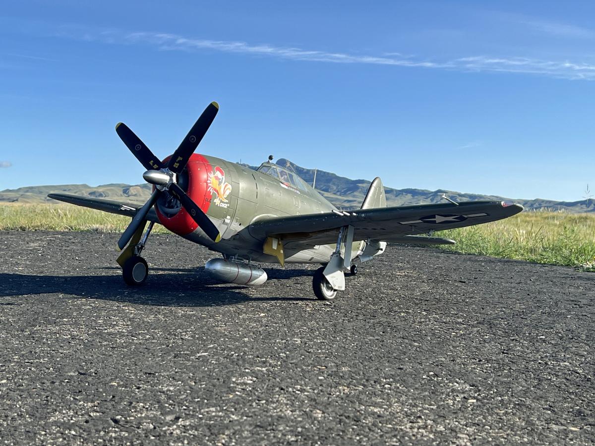

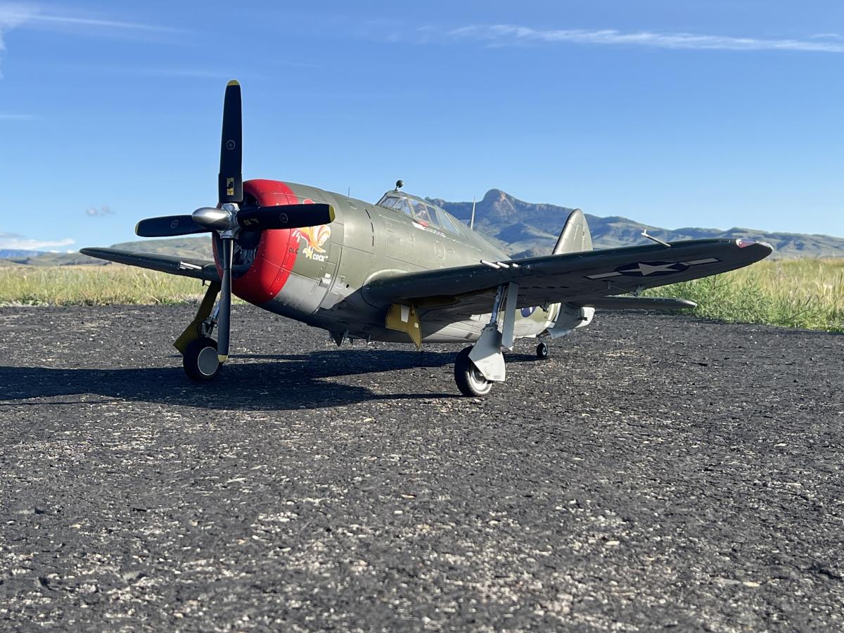

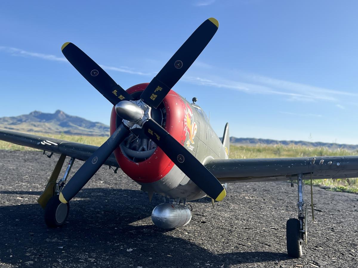

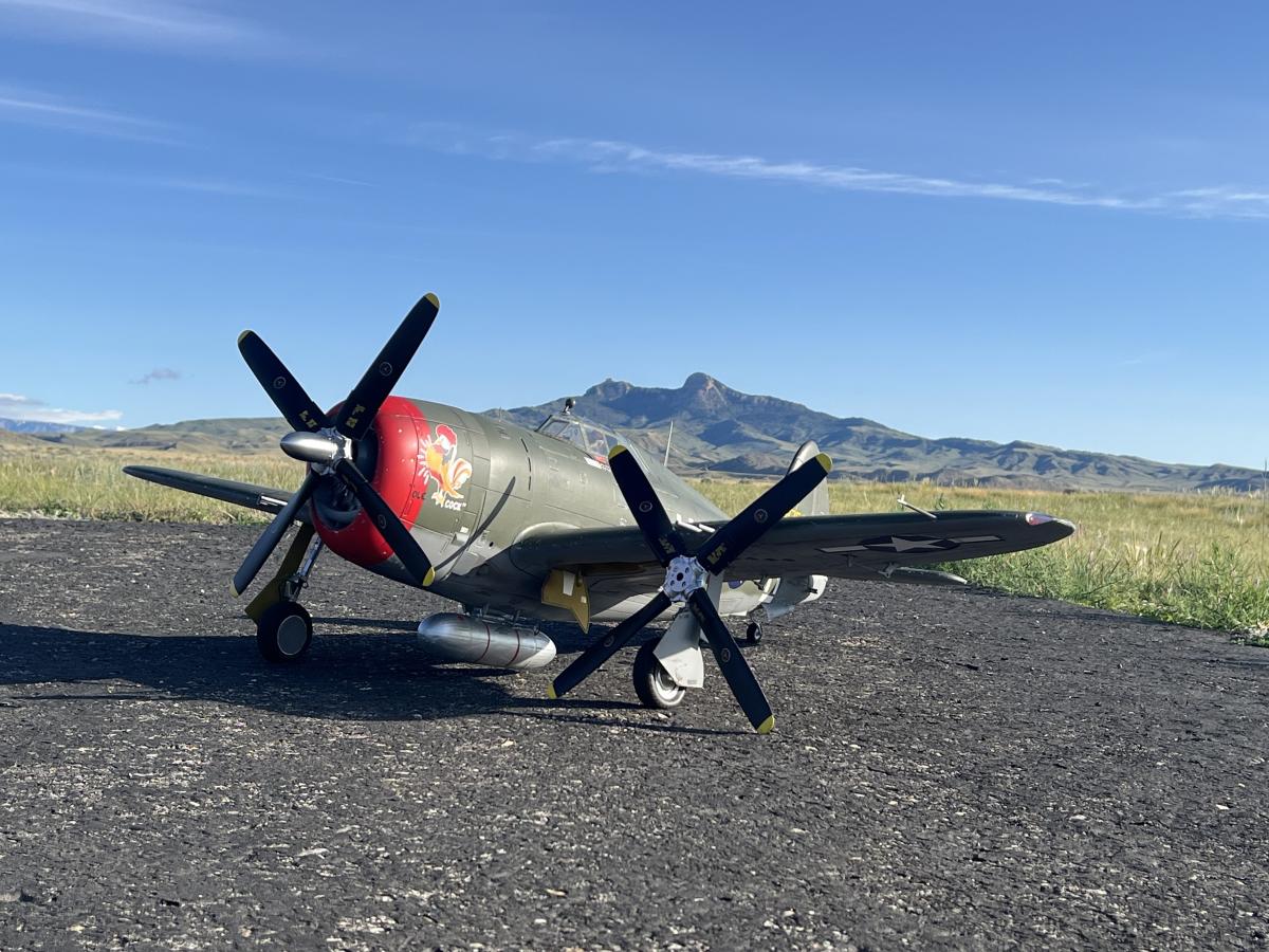

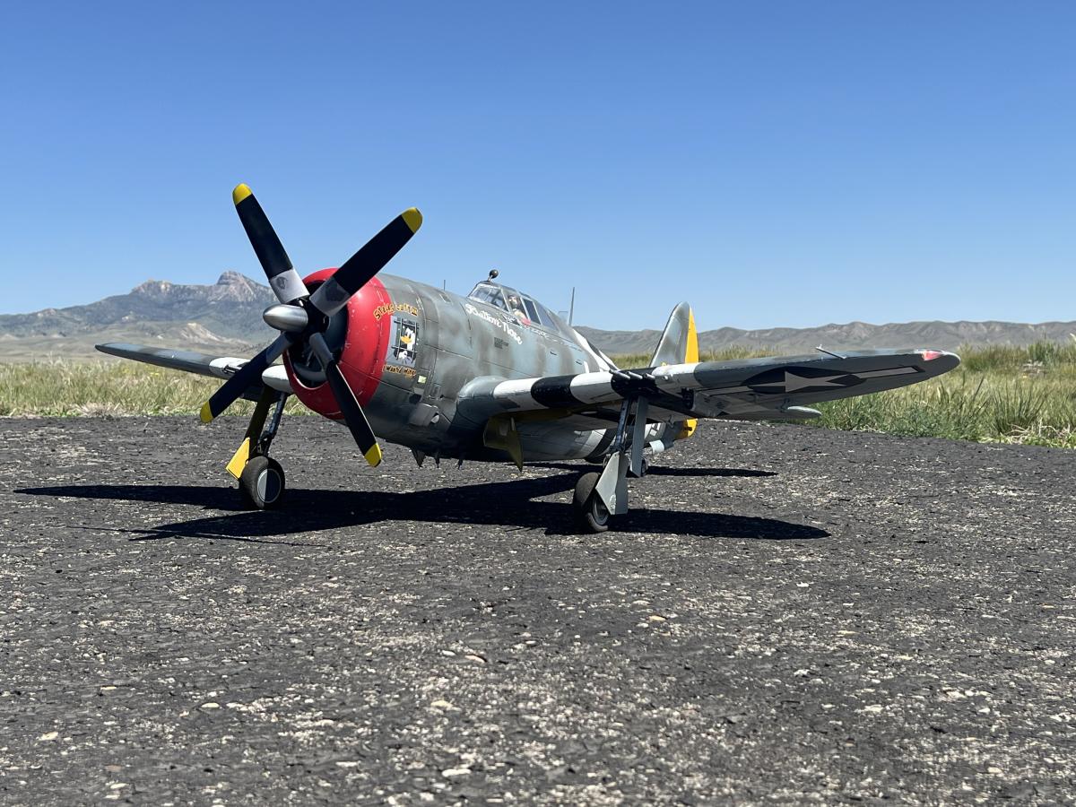

                            So, the winds and rainshowers abated for a while, leaving us with gorgeous blue skies and light winds this morning. Had to take advantage of that! Today's flights I got three flights on my intended final airplane for the CE prop and dome, "Ole Cock". I have almost 50 flights on this airplane now, a lot more on the other two that I have. I made up a duplicate CE prop to try on this airplane to see how different the two of them were (they should be identical, in theory) but I wanted to see if there were any big differences between the two that I made up.
                            The first flight I got in carried no drop tank, a clean configuration, and flew it around the patch several times before bringing it in for a normal, routine landing. I then switched to the identical other prop and added the foam centerline drop tank. It flew about the same. Did one more flight for good measure, and called it a day.
                            How did they do? Both props acted as I expected them to, little to no difference between them. With the Elbee printed cuffs and my using better gluing technique as well as sealing the ends of each cuff, with CA, they were more aerodynnamic that my earlier versions, and throughout all the tests so far, they have hung in there rigidly with no damage, slippage, or anything I could find how they might have degraded any on the test flights so far.
                            My next tests will use the CE prop for some flights, and the stock (meaning the V3 FMS 1700mm Corsair prop) with no cuffs on it. I want to see if one is a bit "draggier" than the other, although I don't expect to see much difference.
                            I'll post some pics from this morning. On one photo, I placed the extra prop that was also flown this morning along with the mounted one. Both have the CE cuffs on them.

                              Great lookin' pics and super-dooper mod.

                                Fantastic photos. I think you have a real P-47 stationed on your runway that you're just teasing us with. You have really made this model realistic. Congrats.

                                  Thanks again for your help, LB. You nailed the shape and size of the CE prop dome, and the revised printed and strengthened prop cuffs after gluing in properly work like a champ! 😁😁😁

                                    Hi Rex: if only it was a full size P-47!!! Thanks for the comments. If you want me to send you some printed V2 prop cuffs For Lucky, let me know. Also, if you want a printed Elbee prop dome I can throw one of those in, too. They print up easily and fit very well on the V3 FMS Corsair prop bases.
                                    If you want them, I can send it to your snail mail address. Maybe PM me the address and I'll send you at least 5 of them (four plus a spare.) with the tests last week and today, I think they will work ok.
