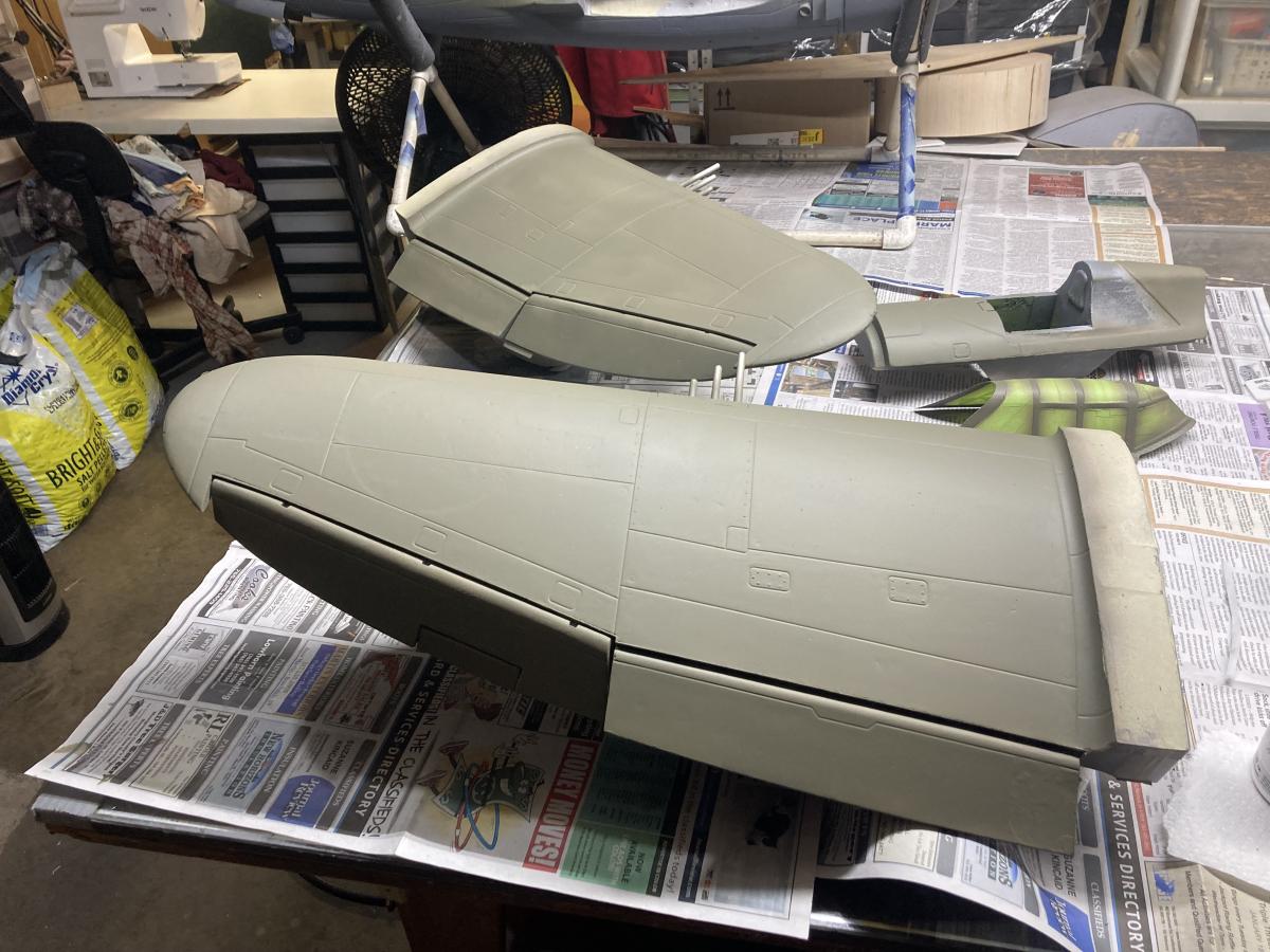

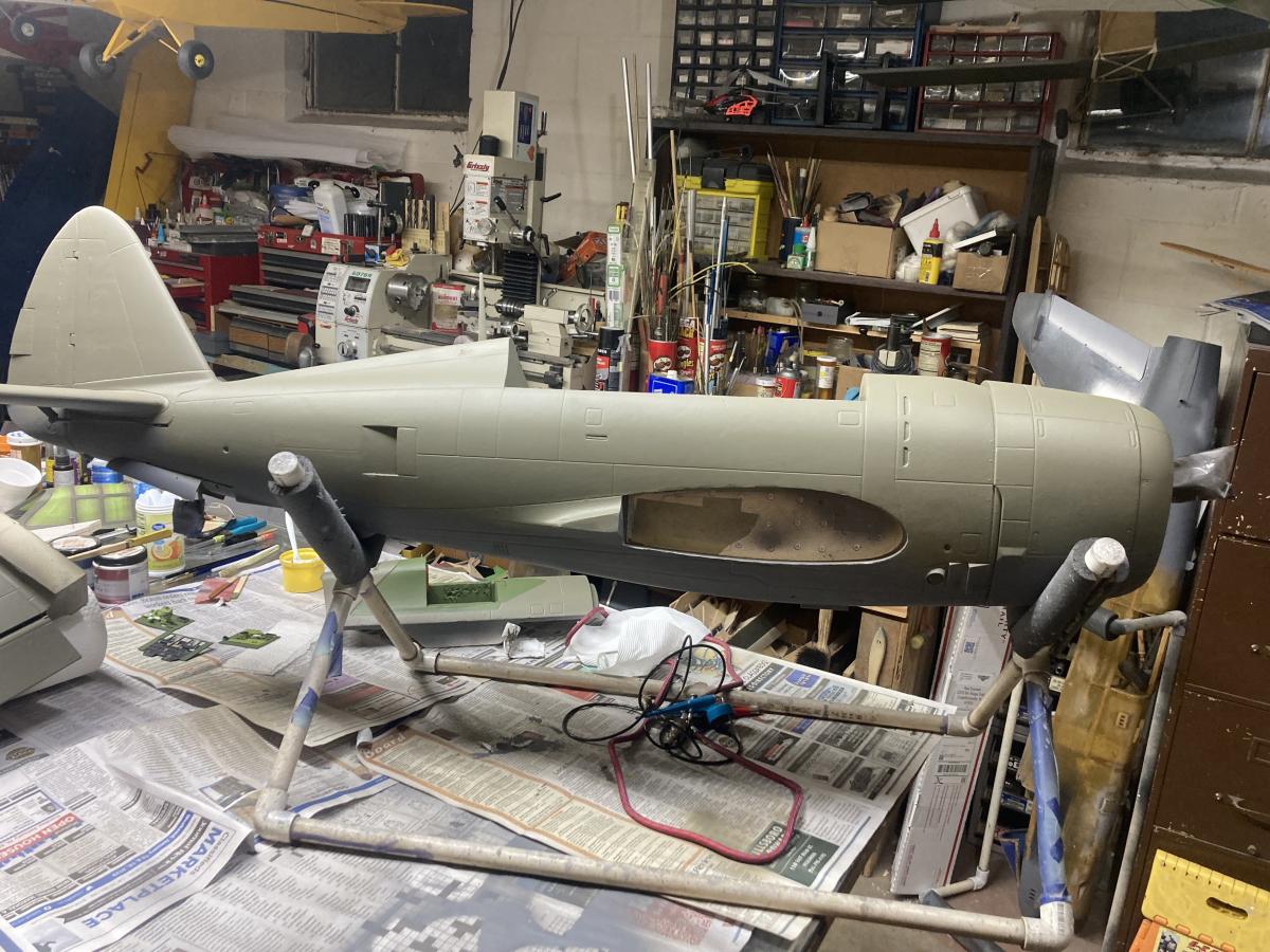

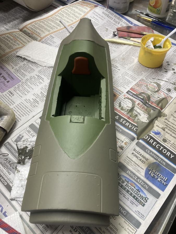

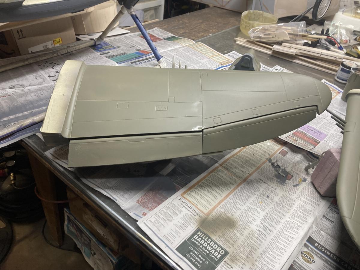

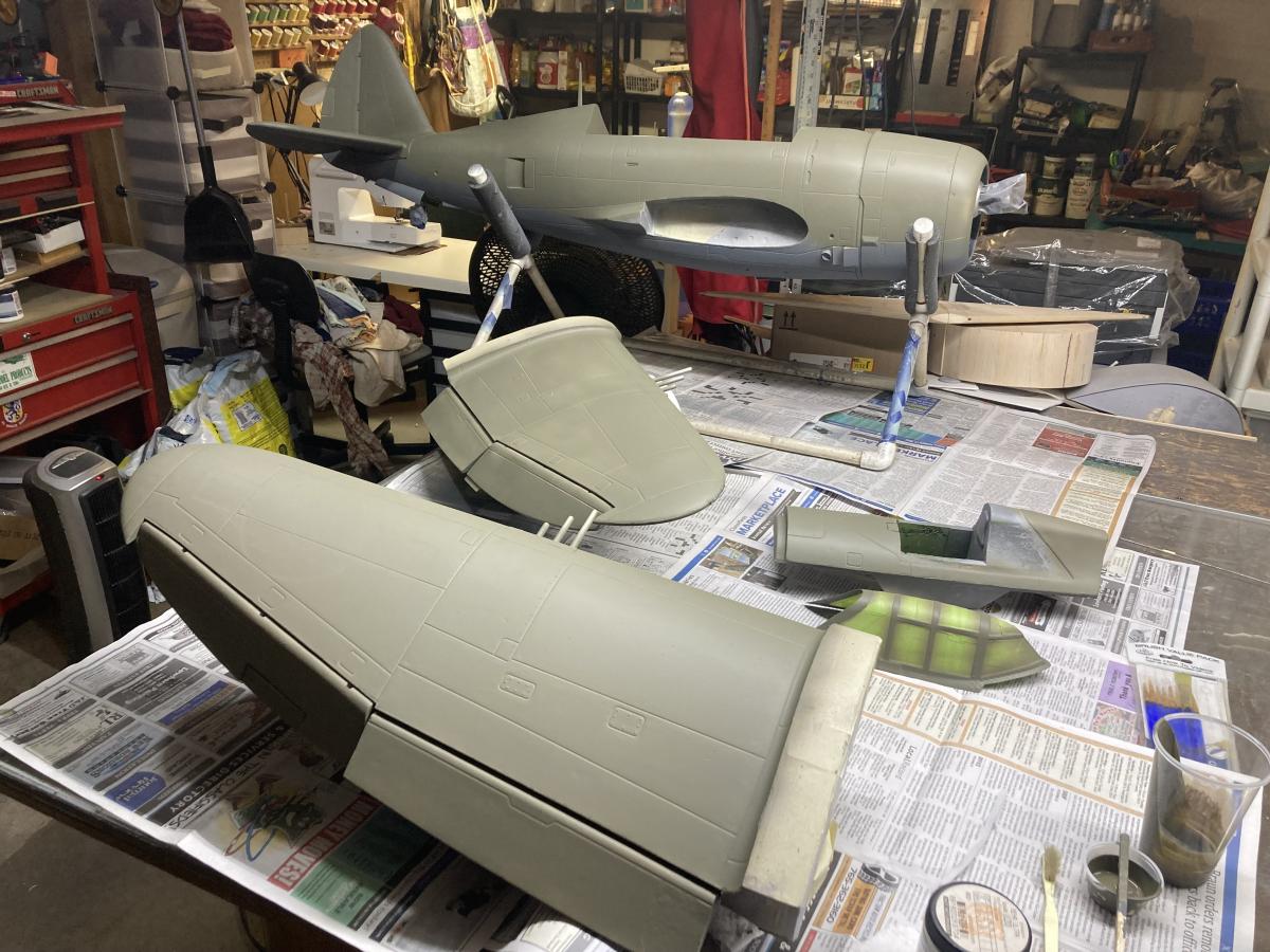

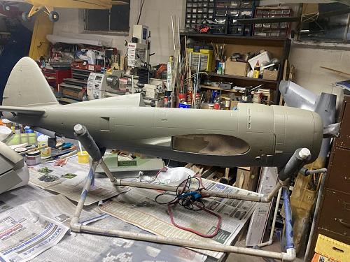

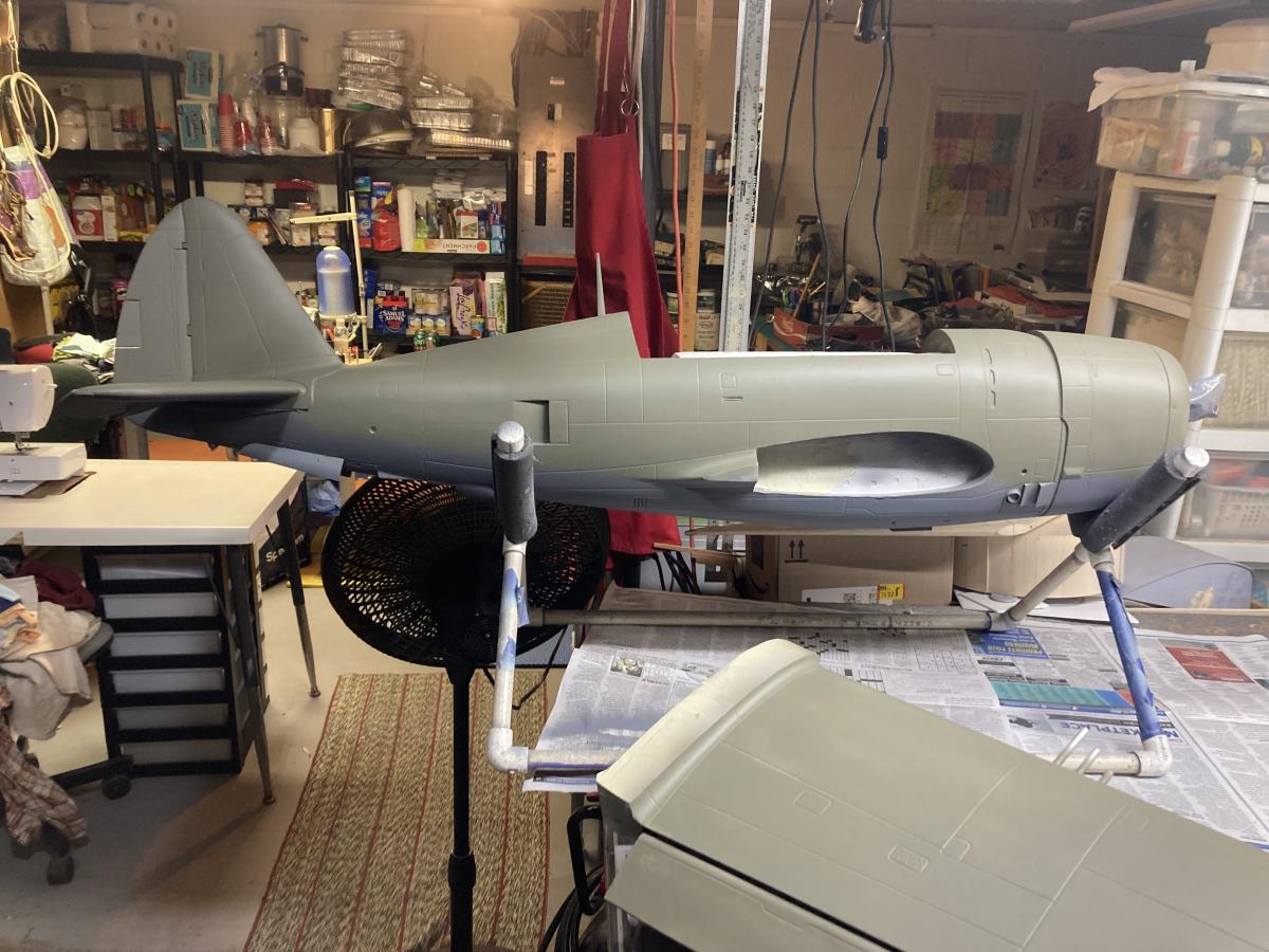

        I have finally sprayed the OD and now I'll check tomorrow to see if any touchup is needed. Less than a month to get to this point, seems longer. May need to spray some grey to blend in the wavey camouflage on Lucky from my pictures. After a day or two I will spray the white stripes on nose and tail.
        Hope some of you are enjoying seeing this. Rex

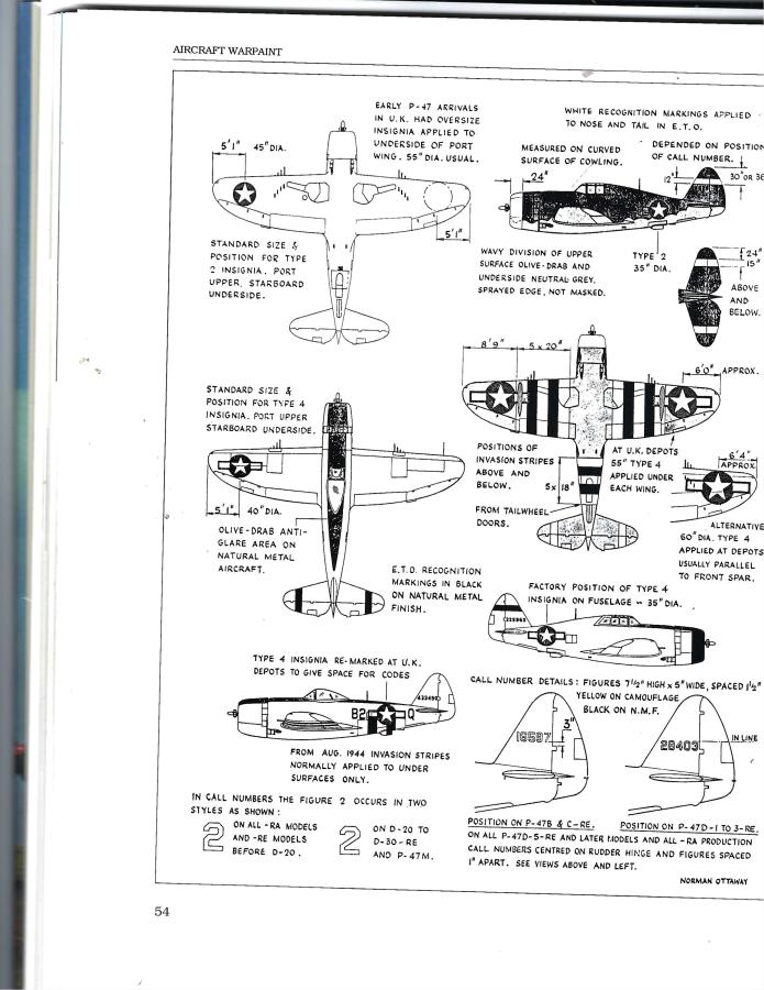

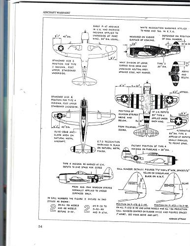

                          Hi Rex: I think I'll retract the idea of "waxing" the Lucky aircraft to make it shinier. I had read somewhere where Johnson talked about his crew chief waxing his aircraft for less drag, but in the pictures I've seen of Lucky while he was still flying it, it looks pretty much like most of the others. Compare that to some photos I've seen and am looking at of Bud Mahurin's and a few others' planes that did get the wax job, they look pretty darned shiny, especially when seen looking down the fuselage.
                          Regarding the scale of the aircraft, the real P-47Ds had a wingspan of approximately 40' 9" or about 489 inches. The scale of this airplane model, when you take the wingspan of 59 inches and divide that into 489 inches of the real thing, gives you a scale for the model of 1:8.28, or rounded off to 1:8.3. That should be pretty close, knowing that the designers of the model planes have to make some compromises from the real things to make a model airplane fly properly.
                          We are in the middle of a prolonged windstorm the past couple of days, so I don't have access to my plane "Ole Cock" tp measure the white stripes. I can do that once the storm abates enough to safely take it down in the garage.
                          I'll attach a copy of a page out of a book by Roger Freeman that I would take to the bank. He shows the white vertical tail stripe to be 12 inches wide, and varied between 30 inches to 36 inches below the top of the vertical stabilizer to the bottom of the white stripe. You's have to have a picture of Lucky showing that to guess how they did it. I think you posted a pic of Lucky earlier up the conversations on HS, so I'll look at that, too.
                          The horizontal tail stripes were 15 inches wide, and 24 inches from the outer tip of the horizontal tail to the outer edge of the white stripe on the tail.
                          See what you think from the attached page out of Freeman's book and let me know if you have any questions. Click image for larger version  Name:	2025-01-21_141615.jpg Views:	0 Size:	105.5 KB ID:	418500

                            The picture will work great. Gives me the dimensions I need. I'll order the 1/8 scale from Callie today, going to order the nomenclature sheet also.
                            Thanks again, Rex

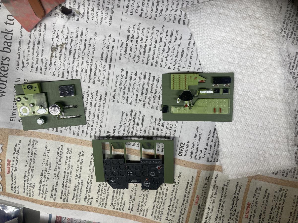

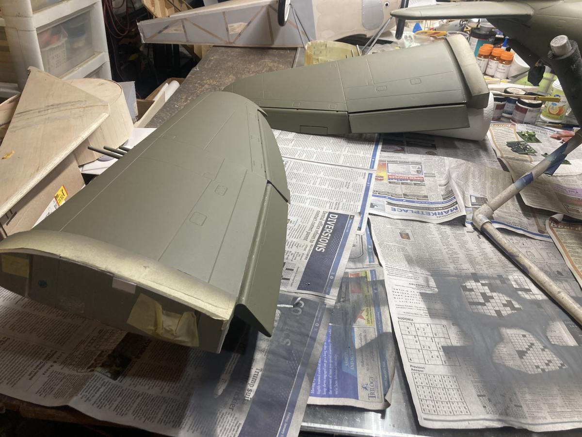

                                  Put my last spray coat of OD on today and mixed some darker int green paint. Painted the cockpit aera and inst. panels. Hope this looks more like the Republic green used at their factory.

                                    Hi Rex: I think those colors are fine, especially for earlier D model P-47s. They produced over 15,000 P-47s from three factories over the course of WWII, and there were no doubt some minor variations in the colors of the interiors. I think the later bubbletop jugs were a dull dark green, which has a blue tint mixed in there. Yours will look great the way you have it set up.
                                    Cheers
