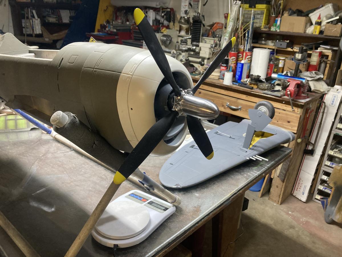

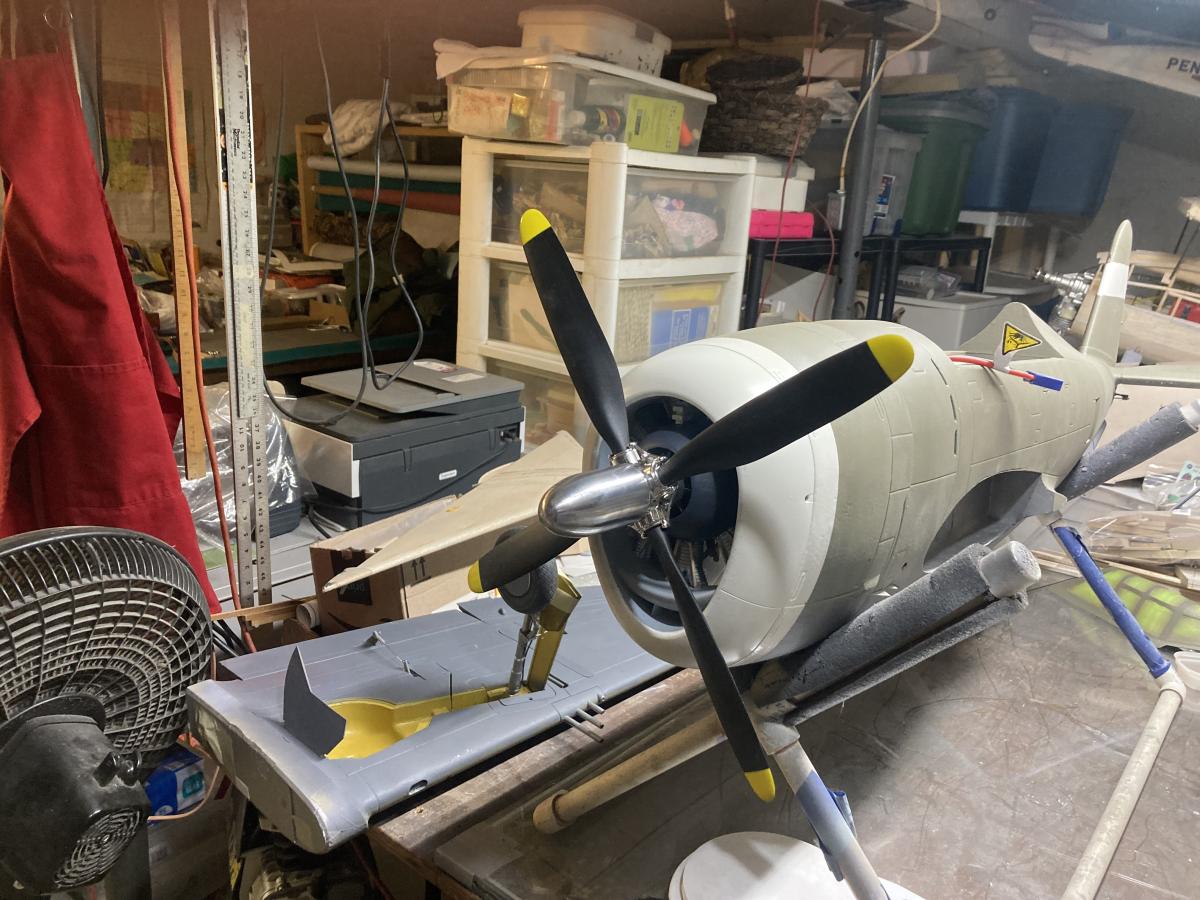

Rex,
The simple answer is no......but.....
The centrifugal forces are fierce at the prop hub under load.
That on record, nothing beats a failure than a try.
Print wise, I think it can be done as long as the hub is simply eye candy and the mechanical structure (for lack of a better term) is solid.
I thought about trying something similar with the Corsair as the prop is rather large.
The loads even in twist would be great as the prop bites under force.
Your machining skills could come into play here, you could design a four way with center hub to fit the shaft.
The hub shape would be a 'skin' the looked correct but carried no real loads.
That was my approach only I was thinking about printing something in nylon instead of machining an aluminum part.
I do not have a lathe, but wish I did.
Using a combo of nylon print and fine machine screws, I might still give it a go one day.
The other issue would be the total mass of the hub, but it is close to the center of motion, hey I am not an engineer and cannot play one here.
