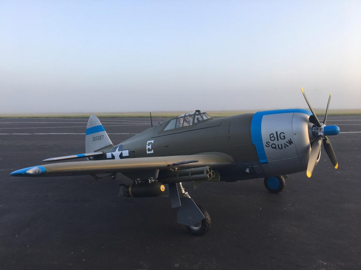

ID:	161009 Kind of realized that I have never posted any pics on HS (usually post on RCG). Here's my recent repaint and detailing of my Razorback. Flew her again twice this morning. I have to admit that I'm intrigued with the idea of going to a larger prop as others have done. I think it would make an already impressive model that much more. This was my first attempt at a total repaint using latex house paint. I do my own graphics files, and Callie prints them out for me.
                                    #497
                                    I really like those markings, MrSmoothie! Every part of the model is finished well, from the overall surfaces to the pilot, markings, and ordnance. I love how the stock FMS P-47 flies, but given all that you've already done to it, you might as well mod it for the larger prop, also.
