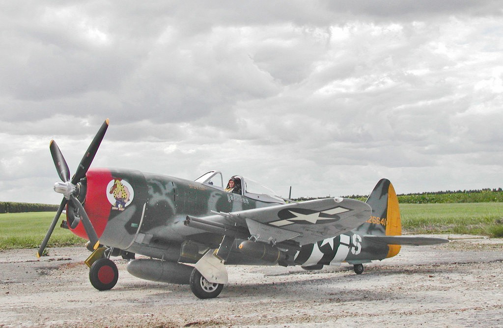

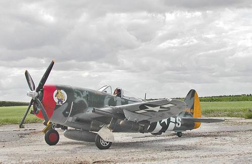

          #1784
          Yeah, the real Hairless Joe saw action over northern France on many occasions, so I guess it’s sorta fitting that I ended up buying the kit that comes out of that area.
          In 2004, my wife and I flew to England along with my Aerotech 1/6 scale P-47 Hairless Joe in the cargo hold. We rented a large station wagon in London to drive up to Boxted, Essex for a big air show at the same field the original plane flew from in WWII. This foamie replica won’t do anything like that one, but I hope to fly it quite a bit later this year and beyond. Should be a fun project.

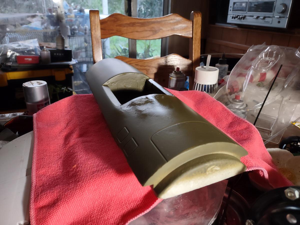

            #1785

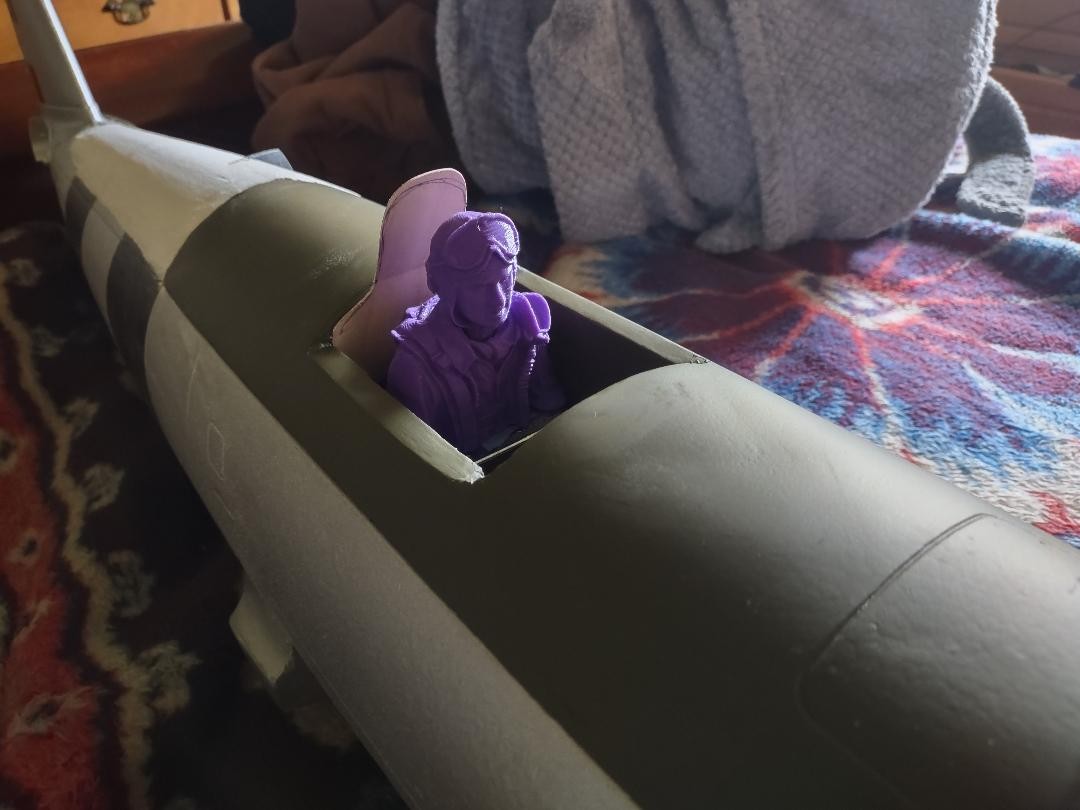

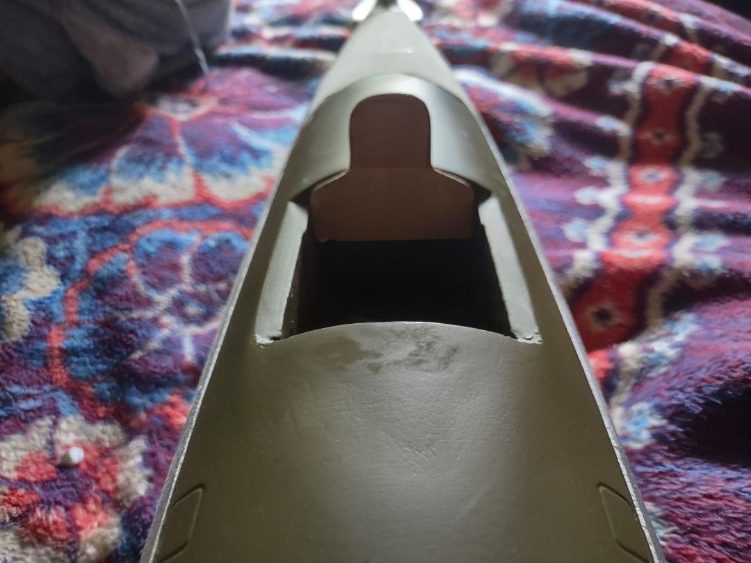

            way more work than i planed on but looks very clean , the back fuse next . canopy plug print this weekend V1
              • 4812
              #1786
              That is some great work, Sir.
              Bravo Zulu.
              Best, LB

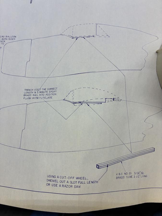

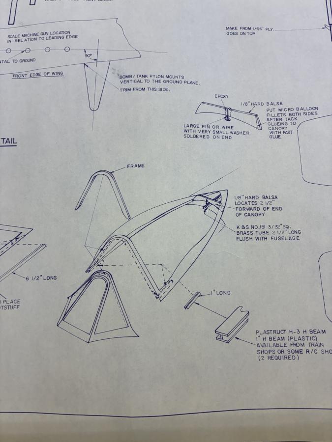

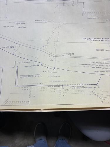

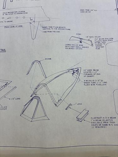

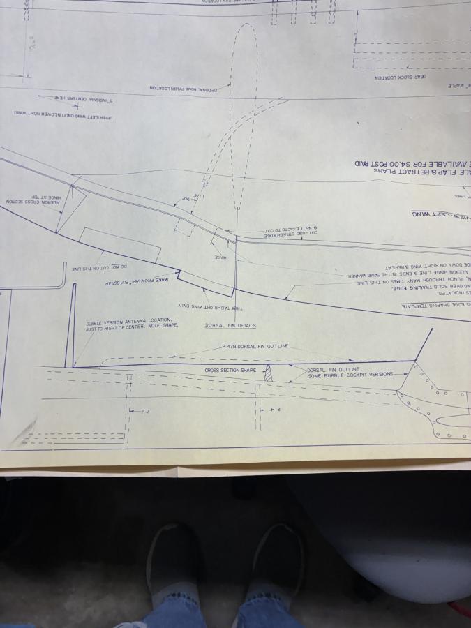

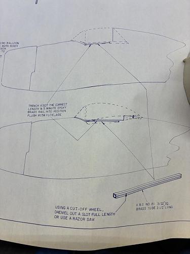

                            #1793
                            Davegee,
                            A couple of pics of my Jemco P-47 plans. And the dorsal fin Rex

                              Hi Rex: thanks for that info. That will be helpful to craft a plan for a sliding canopy. I did this on the Aerotech jugs and I think we had a servo-operated sliding canopy on the M model you saw in the VAC museum in Titusville. Don’t know if I need or want the motorized canopy, but will consider it.

                                #1795
                                Davegee,
                                Your P-47 in Florida is beautiful. Not much room for an actuator in the fus. with full cockpit and electronics. Might be able to get one in if you cut into the forward hatch underneath for room, Ahla Elbee mod. Just have to sleep on the idea.
                                Lucky is already except for the graphics from Callie. Wife is allowing me to park it on the dining room table until Toledo.
                                Best Regards, Rex

                                    #1797
                                    Originally posted by davegee
                                    No sweat, James. I have some ideas in my head so I think I can make it work. When you get to final sizing, can you make me a couple of the clear canopies/windscreens? I might need one as a spare and to do my canopy opening work it might take another one to get it right. I can certainly pay you for extra canopies when you get that far. Just let me know.
                                    Thanks
                                    davegee
                                    Sure . Mark is working on the making the frame outline completely scale first prior to printing the plug i hope by tomorrow

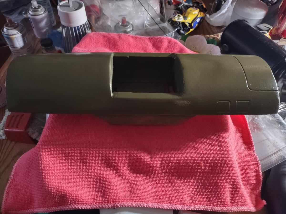

                                          #1800
                                          pattern headrest to start
