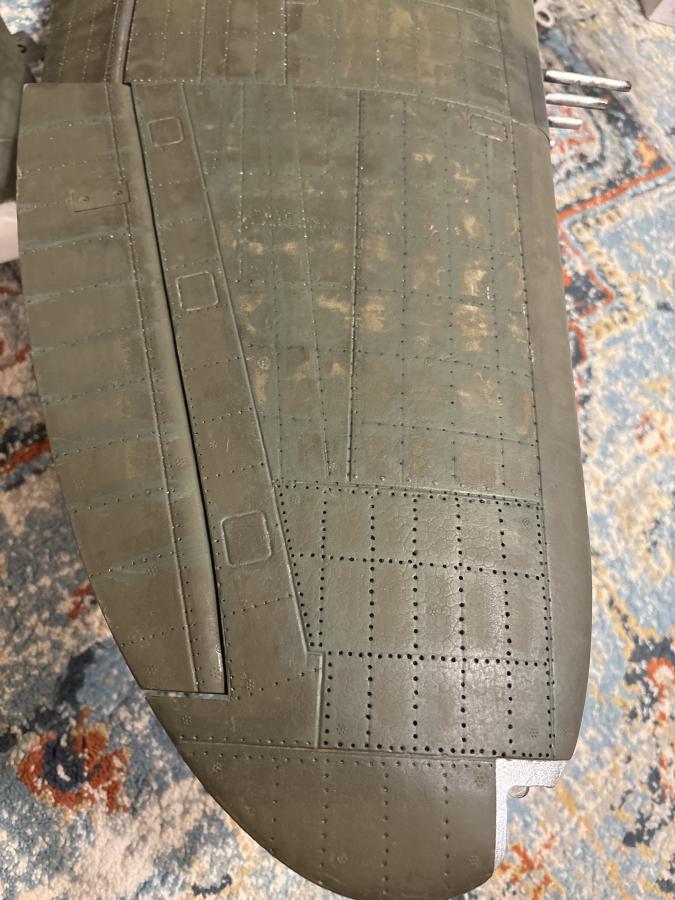

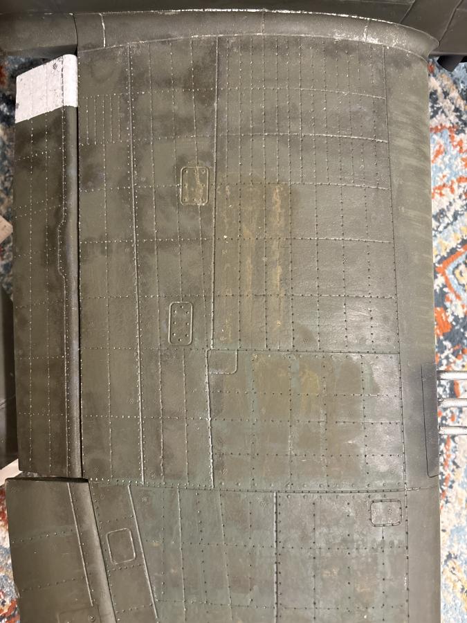

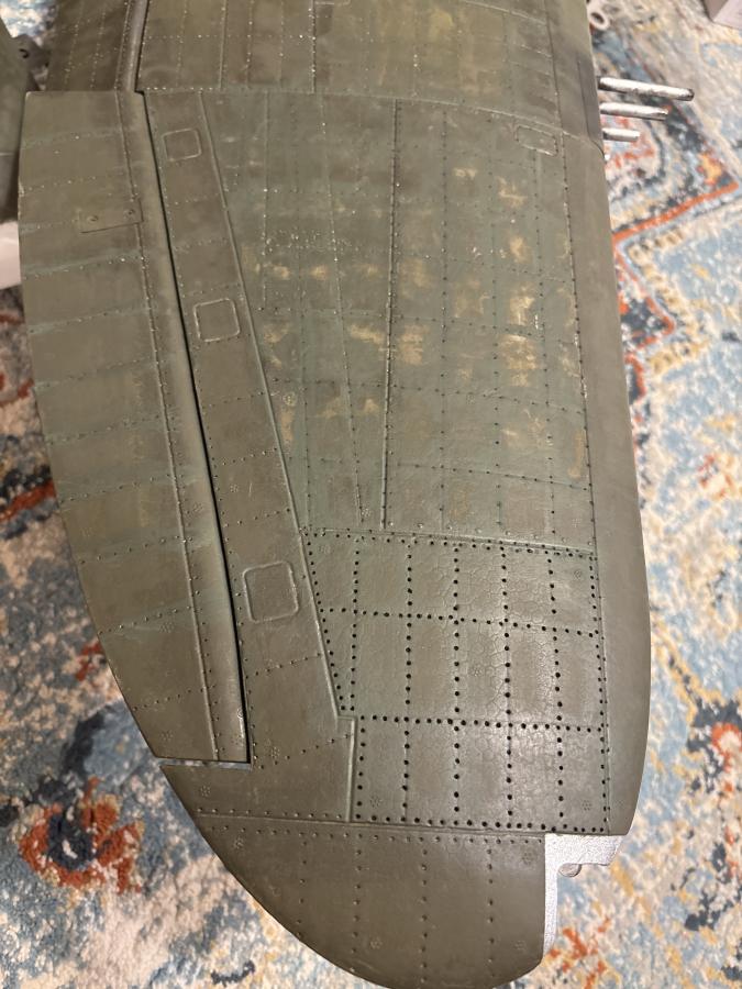

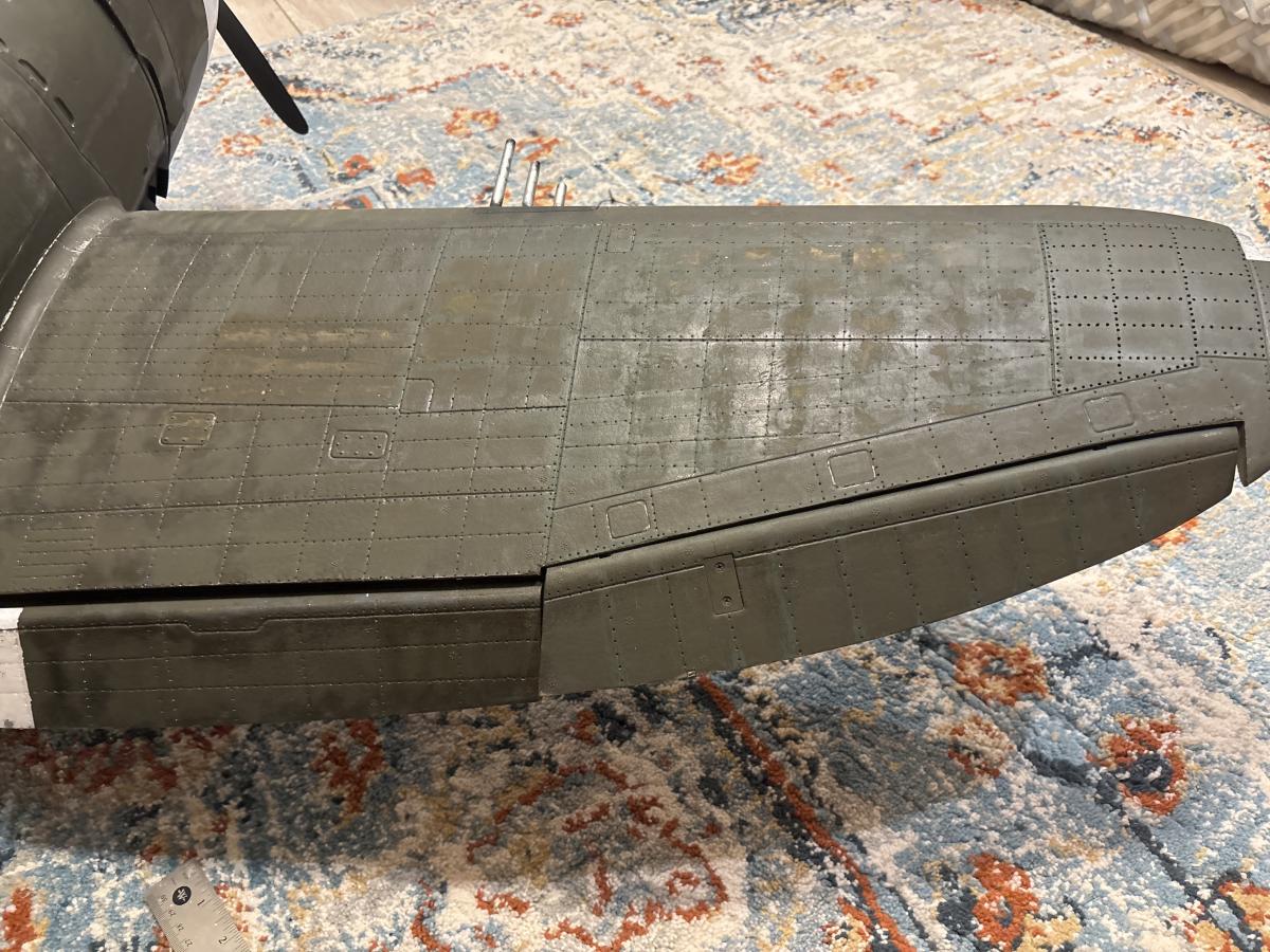

    • I have completed the top section of the starboard wing! Took a while, but I got it done. I’m not sure if the very front section, kinda the leading edge of the wing had any rivets… some photos show they do and some don’t. Any of you guys know? Click image for larger version

      • Eagle 15,
        Looks good. Keep posting progress.

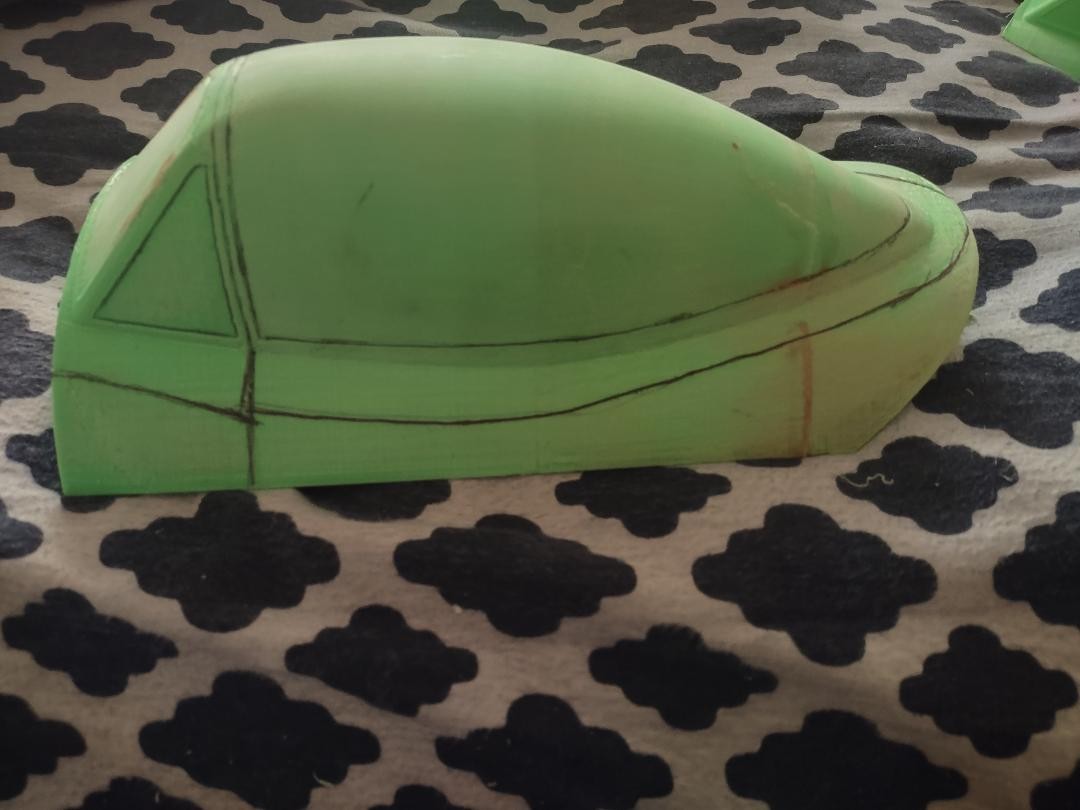

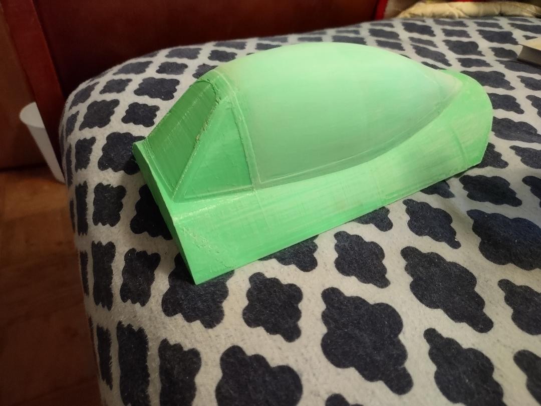

            • Re hand scribing all the frame detail again with an Exacto after sanding and polishing the canopy and the outer for the masses to have accurate reference point to cut ,is everyone liking the orange fools tariffs that are impacting the Chinese fms retail costs . the American public is being screwed while he and the gop bottom feeders are getting rich .worst choice EVER .just paid $170 extra to import a motorcycle gas tank from india . fn BS
              • Canopy is looking great. Costs have risen on everything, even domestic food. We always plant a garden which helps our budget.
                    Canopy/windscreen coming along Great, James! Can't wait to get the whole smash back in my shop to complete it for flying late/spring or summer!

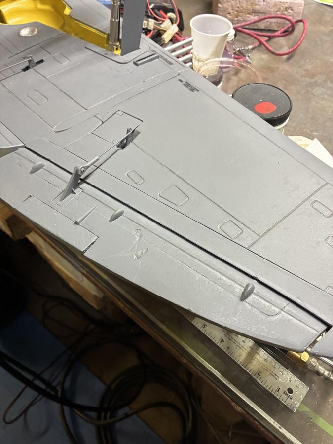

                                        Thanks, Rex. Dan just emailed me the STL for these parts. I printed them up and I don't think I could improve on them! I still would like the exercise of making these the "old school" way that you did and that I will attempt from my end on the part I carved last night. I still think some uses of the this method are a good way to go for certain parts. I know this technique has been around for a Long time...
                                        Thanks again!
                                        I'll post some pics of what Dan made up on my Hairless Joe.

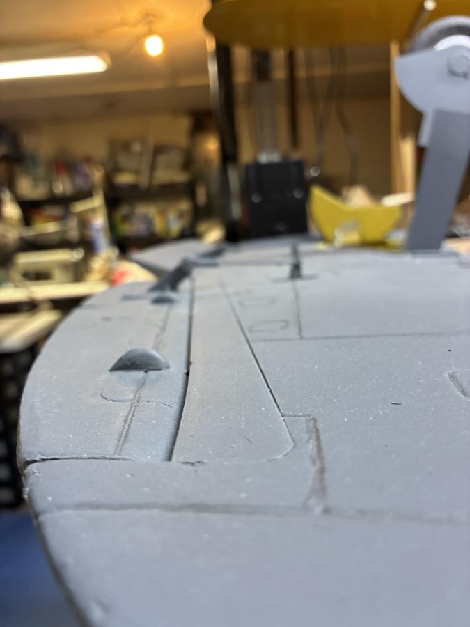

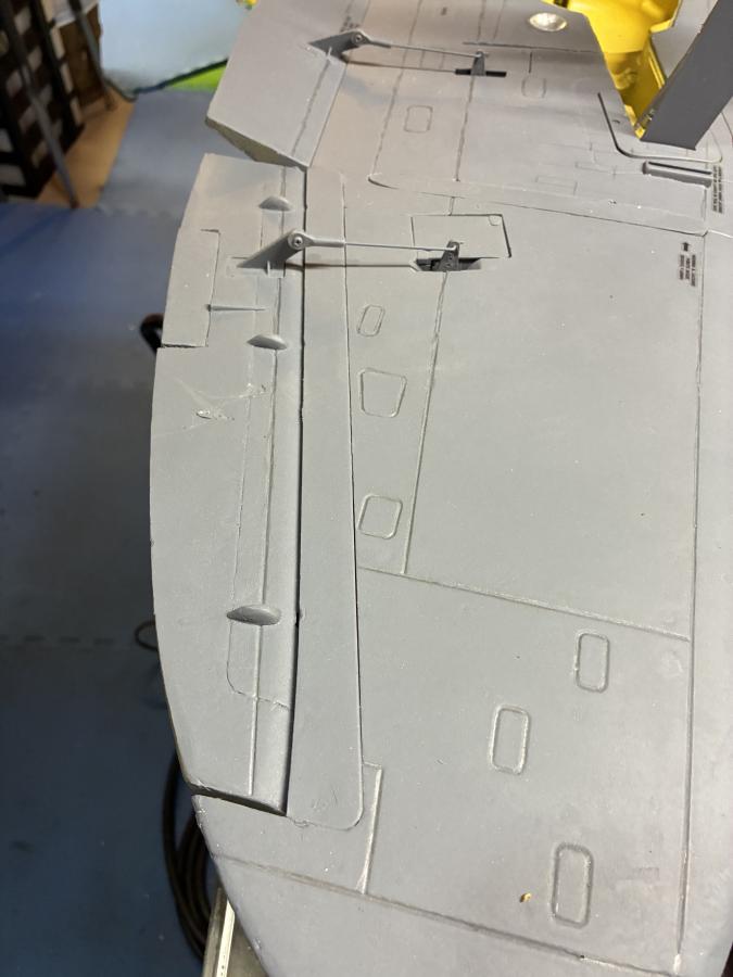

                                          Hi Rex: Dan just sent over the STL and I printed a bunch to use on at least one of my airplanes. I will still experiment with the "old school" way of using the clay molds and epoxy, which I think are still good to use in certain cases when 3D printing doesn't work out for some parts. I think it's good to keep a skill like this alive for some parts.
                                          I'll attach a couple pics I took of the covers on one of the wings. One of the pics has a 1/48 scale Tamiya P-47M model to use as a gauge for placing the pieces on the larger airplane.
                                          Thanks for your help. I can barely remember doing this method over 20 years ago with the P-47M that I was working with about 2004 or so.
                                          Cheers
