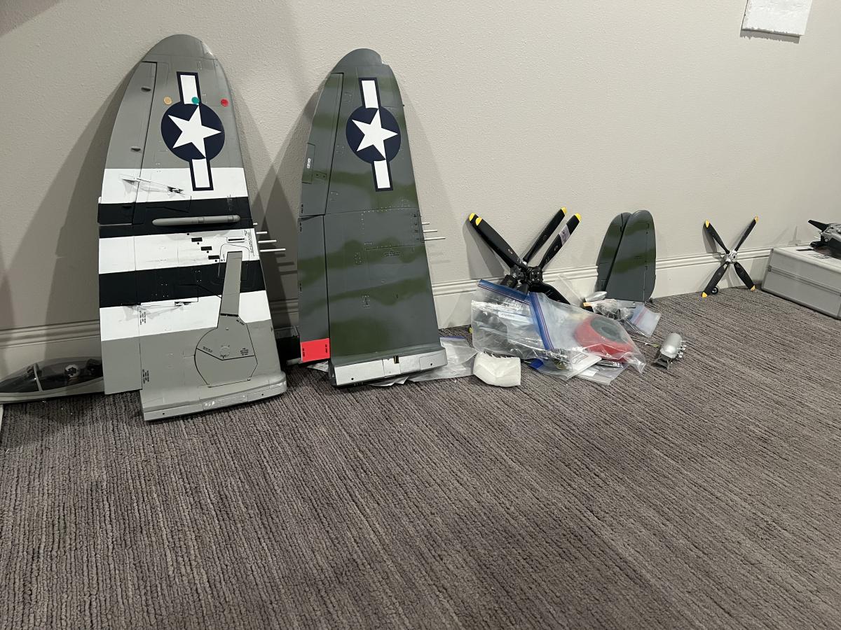

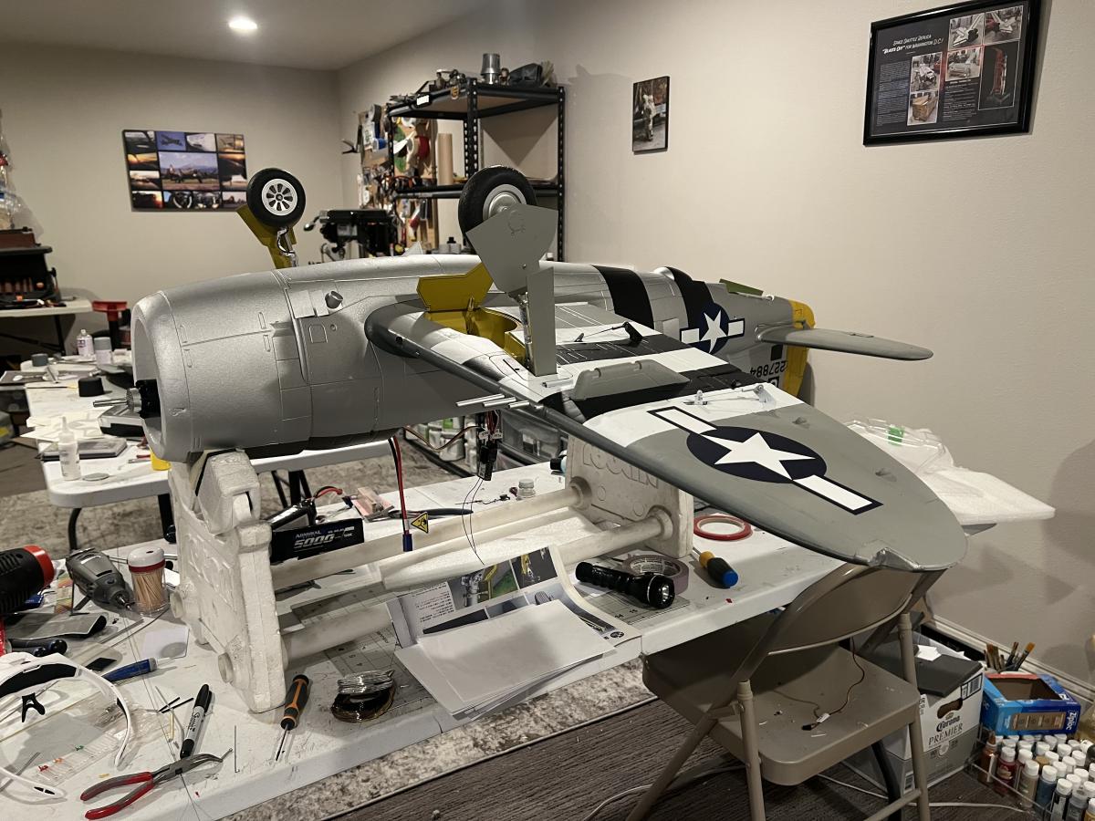

    We were out of town for a couple of days and when we got back Callie's packet of vinyl transfers were in my mailbox. Although tired, I Had to put on at least a couple of them on the bottoms of the wings. My aircraft is very time specific and at the time I have "frozen" for the airplane's appearance, the left bottom wing was not painted but sported a big 55 inch diameter circle with the star inside. The right wing still had the standard 40 inch circle and star inside. There are invasion stripes on the bottom of the right wing, but none on the new, unpainted bottom of the left wing
    Callie's work was again, beautiful! Lots more to do and then a LOT More to do once I get my converted bubbletop fuselage back from modifecation center in California.
    Tomorrow I hope to reinstall the main landing gear and doors and start working on details like hydraulic lbrake lines and the shrinker bars that on the real airplane mechanically shortened the gear during retraction by 9 inches so it could fit in the wheel wells. Upon gear extension, the gear would increase by that same nine inches for prop clearance. Imagine, this technology was available over 80 years ago!

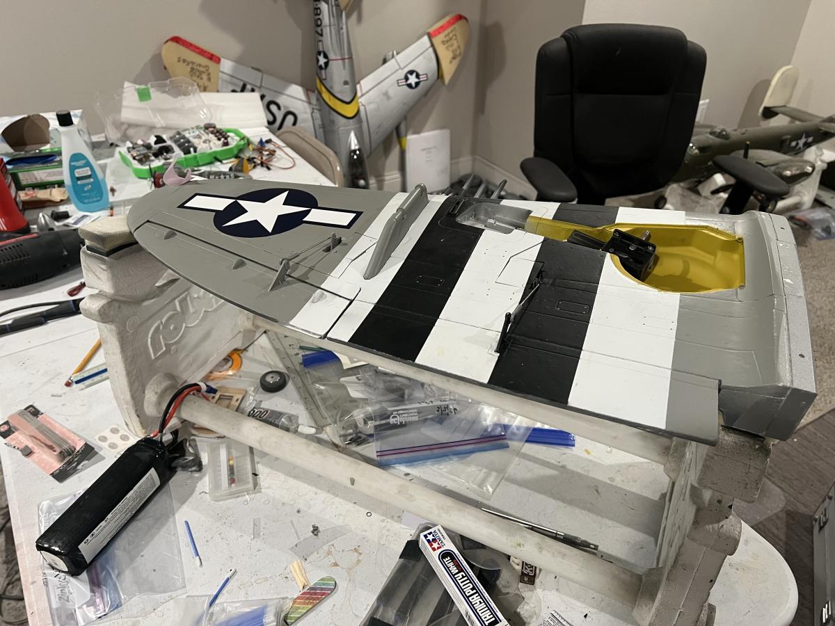

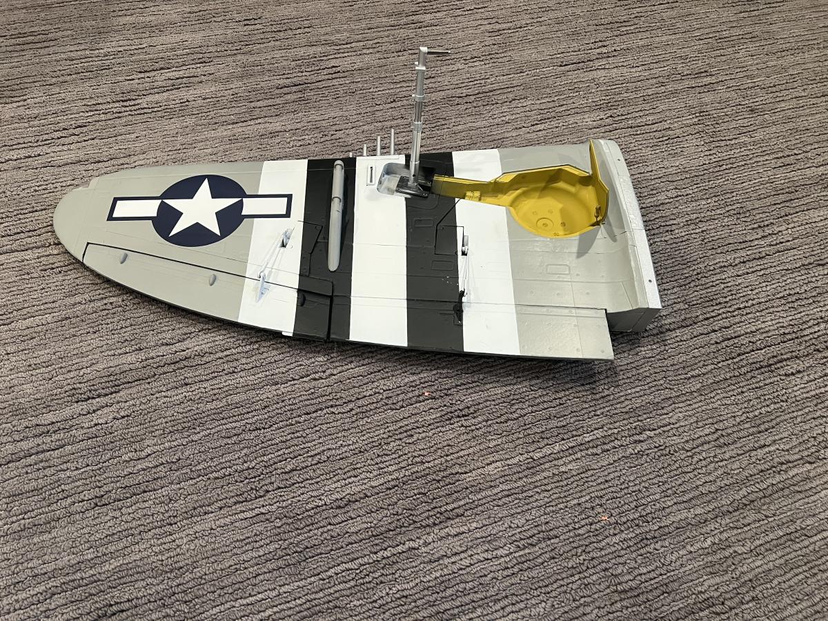

                  I just finished the redo of the invasion stripes on the bottom of the right wing. That was a few hours' work, but I'm glad I did it. It now conforms to period photos of the real airplane on that bottom right wing. I don't know why this is different than other planes invasion stripe painting, but it could be that this wing was replaced while they were still supposed to have the invasion stripes on the bottom of the wing and fuse, and it was painted differently the second time. I don't know, just a guess.

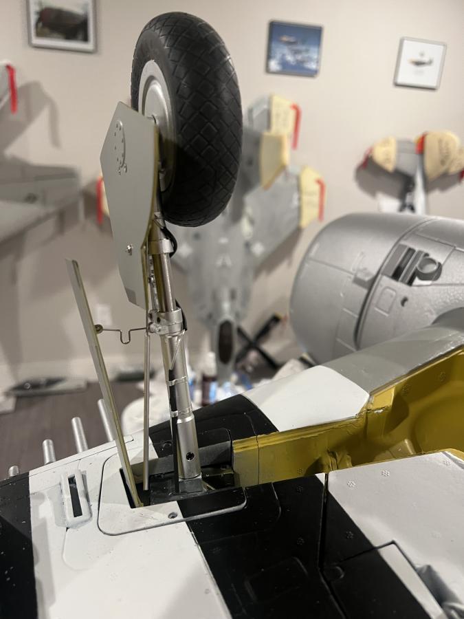

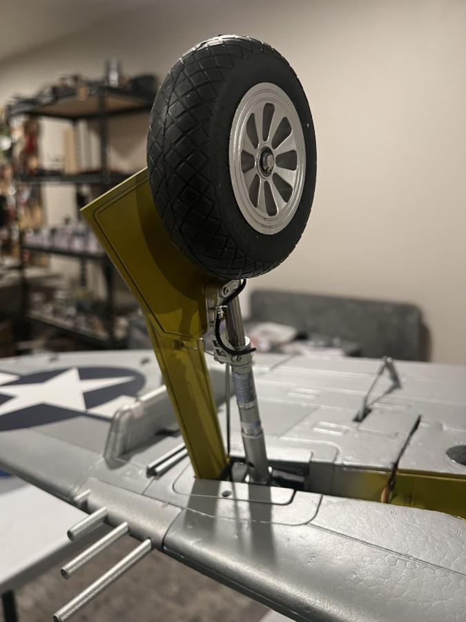

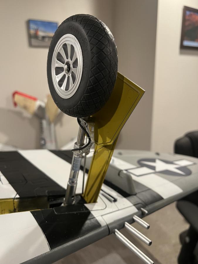

                    Today's assignment on the docket is making the simulated hydraulic lines for the brakes and the shrinker bars. They actually move like the real ones during gear operation but don't actually increase or shorten the strut length. Years ago, there was a company that made functional ones for large scale P-47s. I never built a jug in that larger scale, but if I did, I would have bought a pair of these beautifully designed landing gear struts.
                    A few hours later update: I got the detail parts of the brake lines and shrinker bars installed on my airplane. All totally scratchbuilt, going from photos of the real thing. Should improve the look from a stock model to something a little more realistic.
                    There are small things I can do this weekend like installing placards and nomenclature around the wings and tail, and once I get the fuselage in my hands it will be fulltime work on it until I'm ready to put the whole thing together for more testing. I'll attach a few pics of my work today. The angled metal tubes are the shrinker bars.
                    Like with my other P-47s, my E-Flite 1.5M P-51Ds, and my Corsair, they all have been fitted with the 3.5 inch diameter Robarts. In the photos there are spoked wheels that will be covered with hub caps on the P-47.

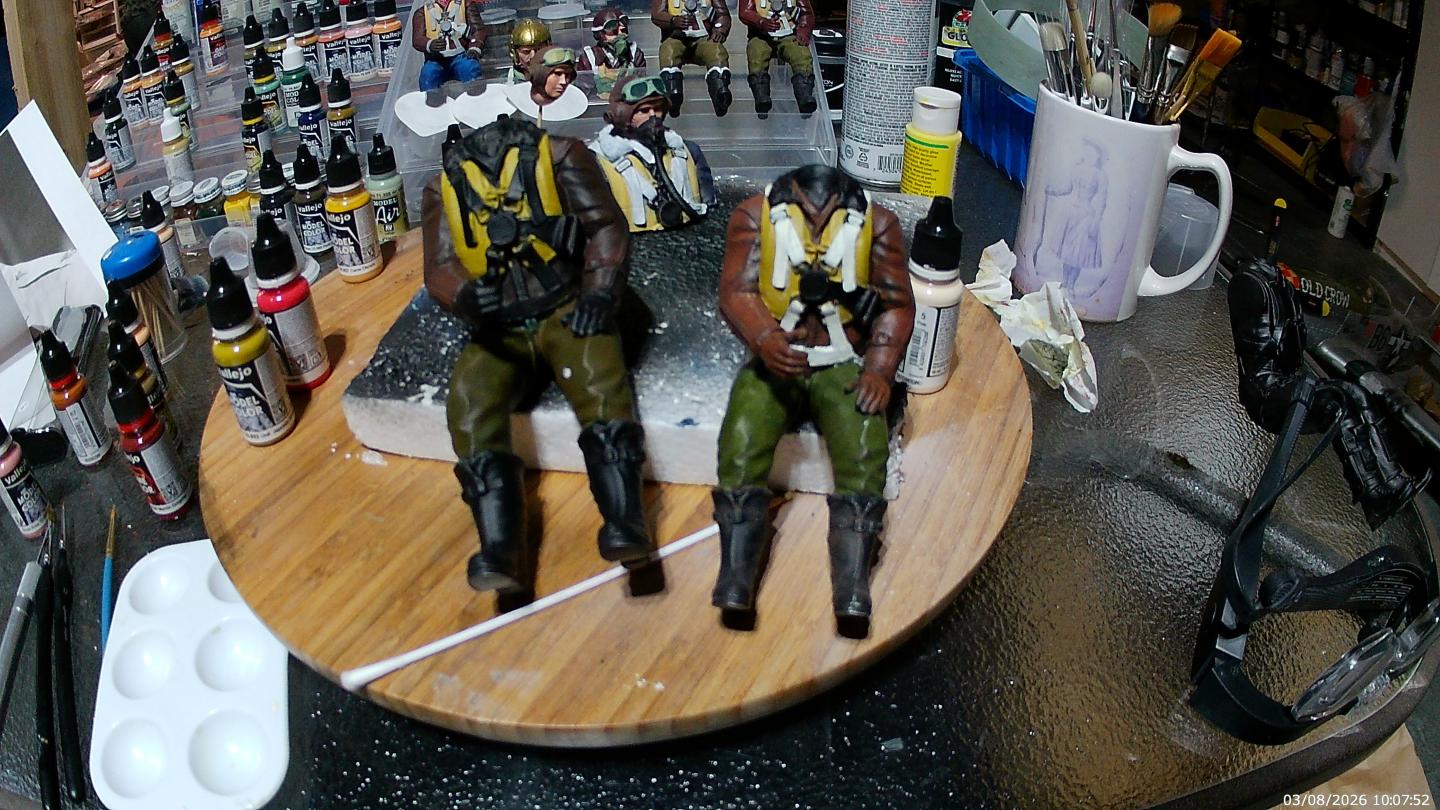

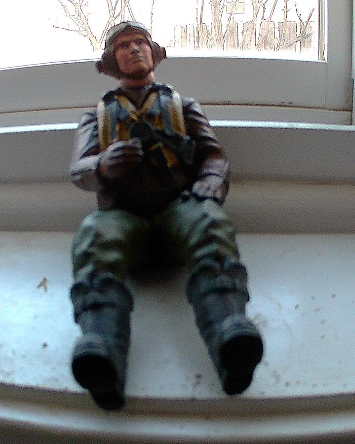

                                Christmas is coming early at Dave's place, or late depending on how you look at it. Pilot is coming along. Still getting the hand of the new camera. this is before the white straps...
                                And after, beside my "Big Boy'...
                                You can see the head on the spike in the background. It's interesting what a difference it makes when you add the white straps. Up until now the colors a pretty dark as I paint from the deepest crevices outward. He looks pretty good so far even though it was a rough session. I roughed up the boots by applying a watered down mahogany brown and then wiping it off, shows some of the dirt and mud that would accumulate on them. Still a ways to go , but looking good.

                                  Looking great, Dan! Schilling and a lot of other pilots were known to wear RAF boots (preferred) or something like it, for warmth (although the toasty cockpit of the P-47 didn't really need it) but mainly if they had to hit the silk, as they say, so that they would still have something on their feet for escape and evasion. Regular shoes would often fly off with the force of the parachute opening, and there you are trying to evade the Jerries in your stocking feet!

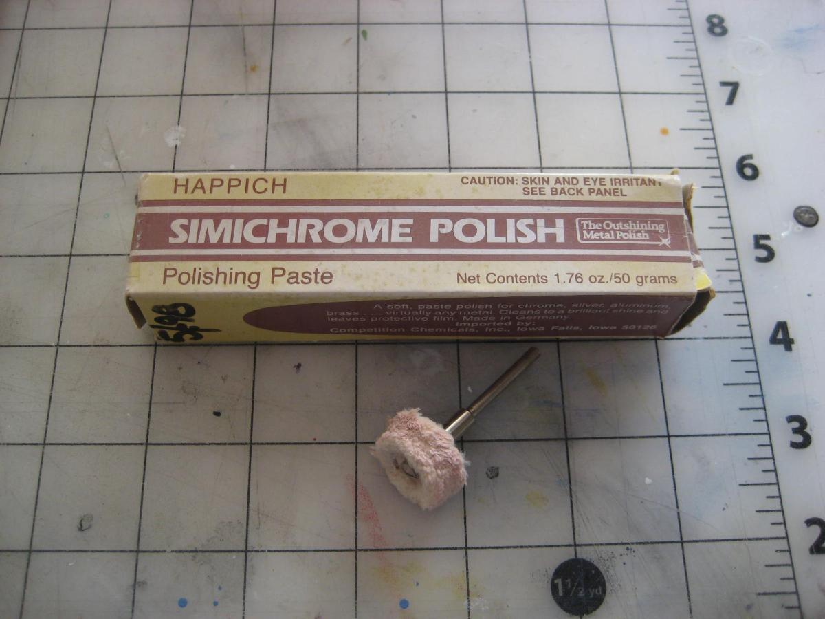

                                        Guys outside of water and a clean cloth do you put anything on the canopy to keep the clear windows crystal clear? With an open canopy I'm wanting to keep it clear for display.
                                        Best Regards, Rex
                                          • 4839
                                          #1960
                                          Rex,
                                          I use a fine grade metal polish called Simichrome and occasionally Mequier's Auto Glaze for tougher release agents.
                                          A little goes a long way as you see by the date on the box.
                                          After I polish the clear plastic with a Dremel buffing wheel, I use an ammonia glass cleaner to remove any residue paying particular attention to the inside.
                                          Work lightly as there are different clear plastics and those all seem to react differently to pressure and the heat generated by buffing wheel.
                                          The canopy is then clean enough to mask & paint.
                                          The beauty of this method (IMHO) is the clear plastic is easier to keep clean from that point forward.
                                          The clear materials being used by FlightLine one the Corsair and the Mitchell are very soft and wavy.
                                          These are not very clear after their vacuum processing.
                                          I have not found a good method to get very many flaws out of their canopies.​
                                          Hope this helps.
                                          Best, LB
