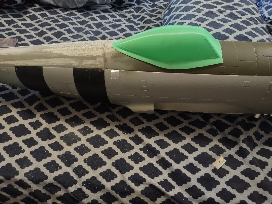

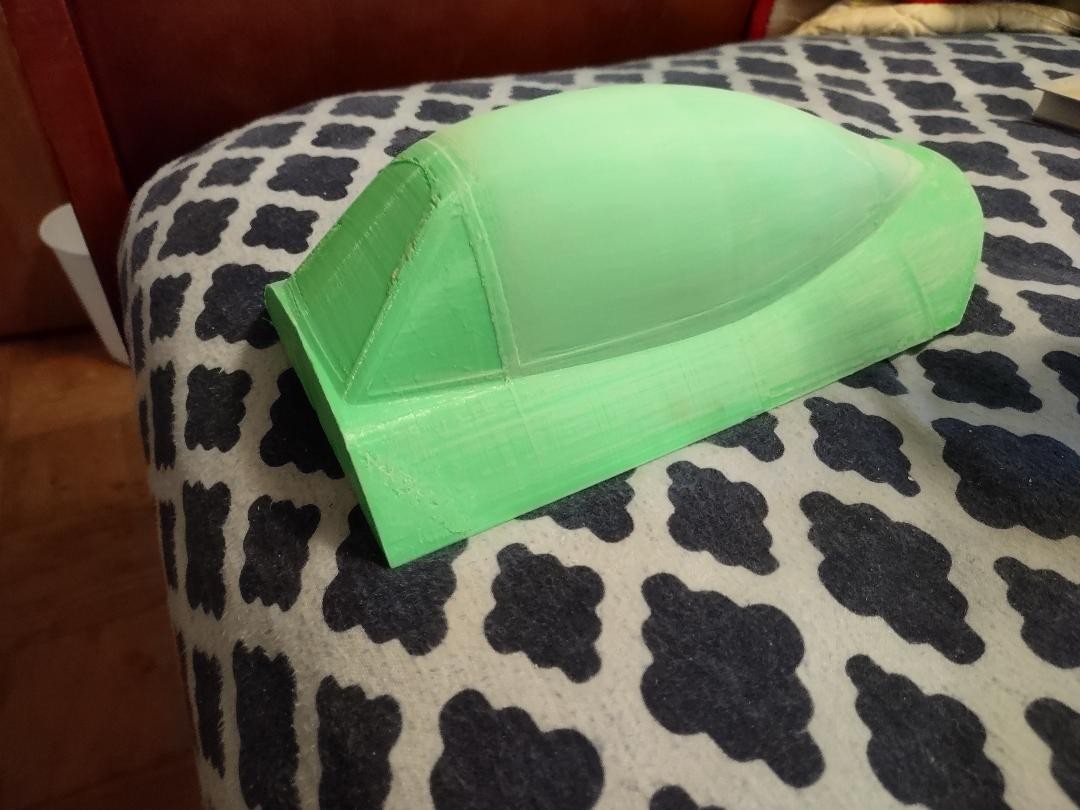

                turtle deck finalizing to match the hatch sanding ect is a pain but will be worth it and satisfying , the 3d plug will require about 7 more hours of sanding 100 grit 600 grit wet then 800 wet polishing . and mothers polish. the front needs some balsa to bring the front out a bit to be scale and angled to about 110 deg and the back the same so the canopy will let go after the pull . more flaws around the canopy frame but will fill nicely no big , then off to the vac formers for some test pulls in a couple off weeks . qty 4

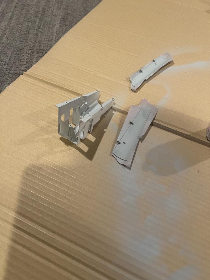

                  While we are getting the work done on converting the FMS P-47 fuselage from a razorback to a bubble top, I decided I could make myself useful starting in on some preliminary prep work.
                  As mentioned before, I did purchase a new FMS 1500mm P-47D razorback kit. I had an extra spare set of wings and fuselage that I bought a couple of years ago but didn't need it so far. So, the fuselage was sent to James in California, and he is busy working on the bubbletop conversion from the bare fuselage that I had purchased back when as a spare..
                  Meanwhile, I'm digging in on details that I can get started on. All the contents of the kit I bought will eventually be transferred to the fuselage that James is working on. Today, I pulled the tail wheel assembly, doors, etc., out of the kit fuselage and have been painting them first in primer, and then yellow zinc chromate finish. The kit comes with two springs that attach the tail wheel doors to the tail wheel strut, so that when you turn the tailwheel, the doors sway back and forth. That has been a silly idea to me, so the remedy is getting about a 1 1/2 inch long extension spring attached to each door and then looped around the strut so the gear door operate in a realistic fashion, both when the doors are open and when the gear is retracted, they close smartly using the spring idea.
                  I'm also starting the minwax process with the first coat of preparation on the rudder. With all the trim tabs on the plane, I use an exacto to make them slightly moveable for a more realistic look. The final look of the rudder will be yellow, per the paint scheme of the day for this unit: Red, 61st FS, Yelow, 62nd FS, and Blue, 63rd FS. Attached is a photo of the real Hairless Joe during WWII, about ready to launch for a mission.
                    That's really coming along, James. Nice Work!

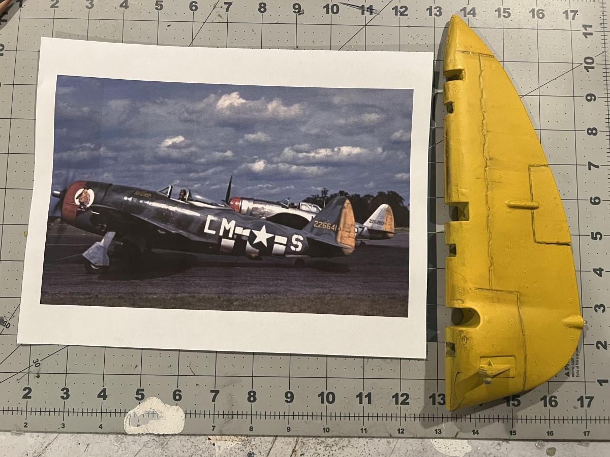

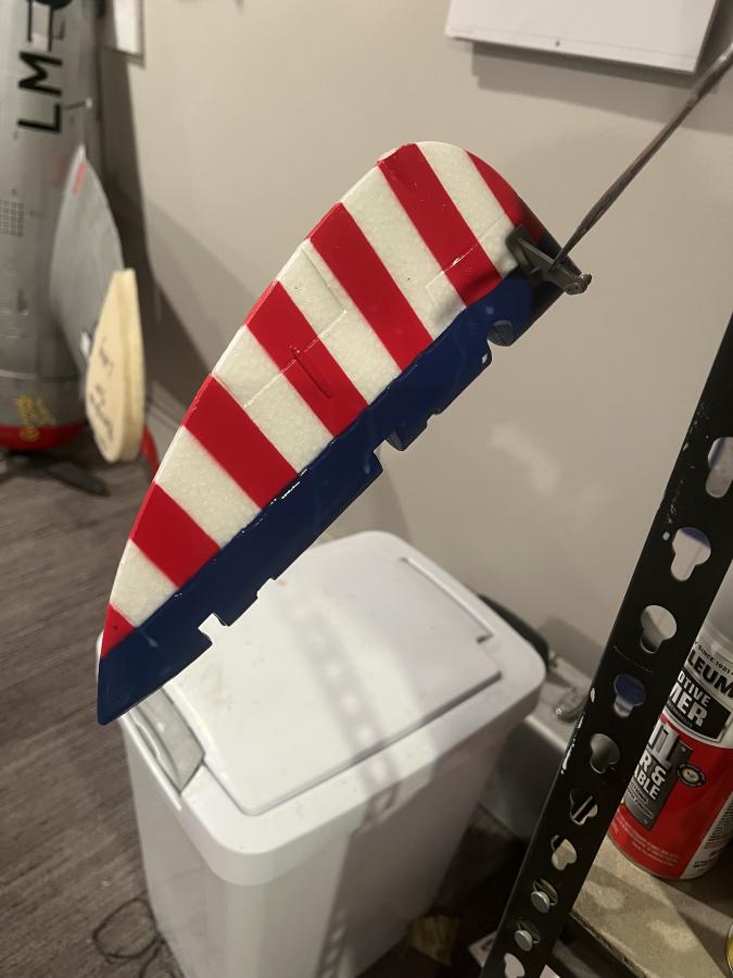

                                I've been busy painting up some of the control surfaces with acrylic minwax, priming, and in some cases painting parts. I just pretty much finished the yellow rudder for Hairless Joe that is an ongoing build. I added a LED clear light for the tail light on the rudder, although it won't be operable, just for show.
                                Starting in on the wings with light sanding and min waxing. Some details to the right wing will be a fresh air port on the leading edge and the small window for the gun camera and hatch for getting the camera in and out of the wing.
                                Cheers
                                Davegee

                                • jetfool
                                  • Nov 2022
                                  • 1280
                                  • Crawfordsville, Indiana
                                  #1836
                                  Rudder looks great. What do you think of the poly acrylic process?
                                  Rex
                                    • Nov 2013
                                    • 2676
                                    • Cody, WY
                                    #1837
                                    I like it. It definitely smoothes out the foam finish and provides some strength to the foam for dents and nicks.
