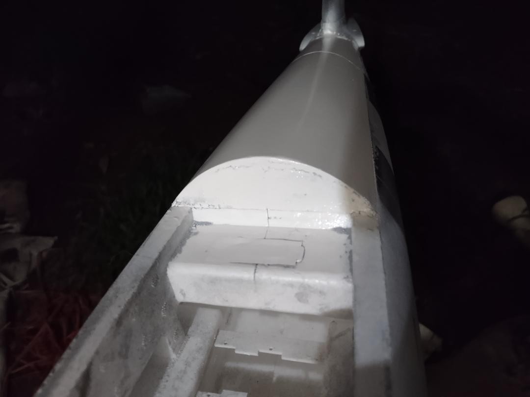

            The back turtle deck is nearly complete , some minor filler and we are done, I even added the back panel line .. the hatch needs minor work, both should be ready to ship back to Dave, in a week, then full attention to the canopy plug finish work.

              Nice craftsmanship vrosi 1963
                • 4874
                #1907
                Vrosi,
                That is Master Class level work, Sir.
                Just amazing.
                Best, LB

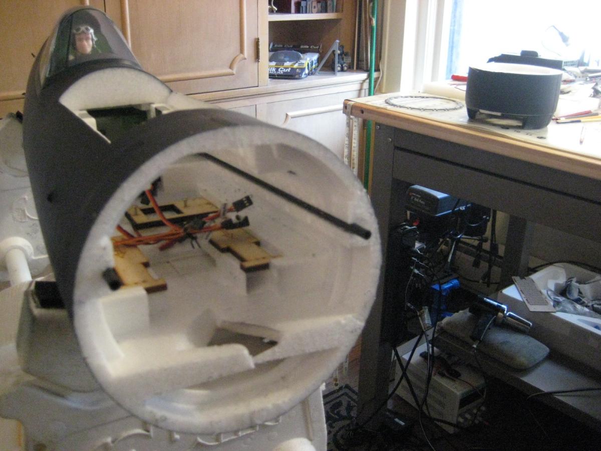

                          Dave,
                          IMHO, a servo actuated sliding canopy mod should be designed and implemented ahead of any fuselage work in a foamie.
                          In the case of my Corsair, the cockpit section was cut open and I performed various 'foam surgeries' as the design advanced.
                          Having NOT done this before and then adding the difficulty that EPO often presents, several iterations were made 'on the fly' as it were.
                          For me, any major mod like this should be sorted out first.
                          The same was true for me with the 'cowl flap' mods where the only way was to cut off the Corsair's nose.
                          Ya gotta break some eggs to make an omelette.
                          Best, LB

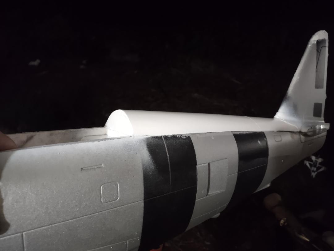

                                      making some progress on the painting of the wings. I'm putting the invasion stripes only on the bottom of the right wing, none on the nonpainted NMF bottom of the left wing. This is how the airplane looked for a short time in the summer of 1944 after the left wing was replaced. Callie will be sending out my dry transfers package tomorrow, Friday, and will evenually start on some of those. The tops of both wings are painted in RAF Ocean Gray and will have patterns of RAF Dark Green over the tops of the wings, tail, and fuselage. I'm hoping to get Danger Dan to design up a droppable drop tank of the type that was used for a while during that time period.

                                        Looking good.
