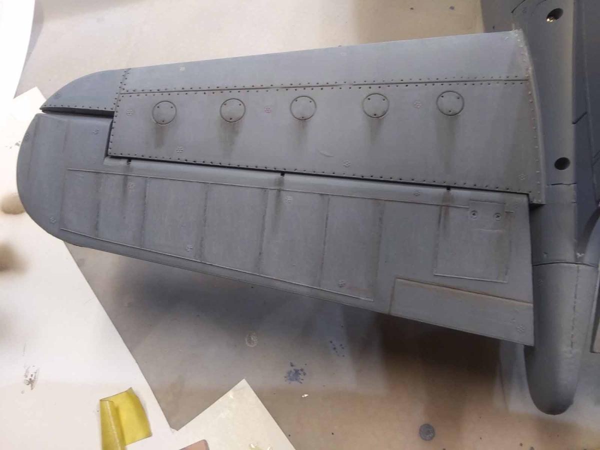

      As for riveting...
      I Sometimes used my little 6" ruler to evenly space the 'rivets' and where there were rivets on either side of a panel line, I staggered them. After a while, I just eyeballed them as my brain had the spacing down.

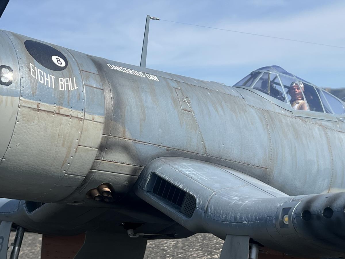

      As for the cowling, I used a Tee pin for a bigger diameter and the smaller ones in between. This is pretty accurate according to pictures.

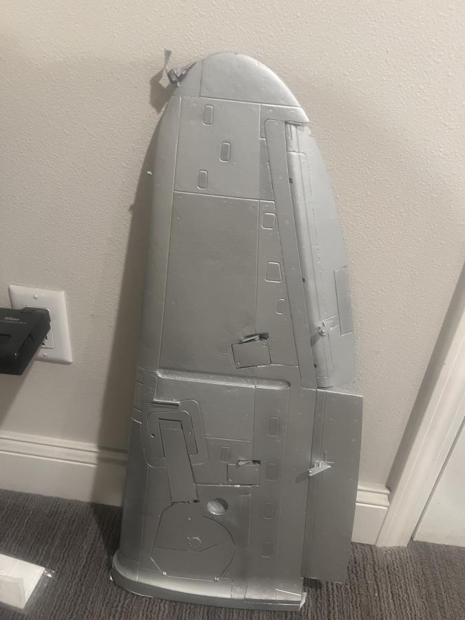

              • I'm working on the wings and horizontal tail at the moment. Specifically, I'm working on the bottom side of the left wing. This was a replacenent wing for one that was battle damaged, and the plane flew a couple of missions with the entire wing unpainted as they needed it to fly missions. When time allowed, they painted the upper wing surface in the Ocean Gray and Dark Green disruptive camo pattern. The bottom of the wing was not painted and left NMF aluminum.
                For this small window in time when the upper wing was repainted but the bottom of the wing left bare metal, I have been using a variety of silver paints to try and represent the new and unpainted lower wing surface. I masked off individual panels on the bottom wing surface, and used Alclad II Aluminum, Polished Aluminum, Duralumin, and a variety of silver rattlecan paints from the local Ace.
                Waiting on Tamiya spray paints from Amazon. They'll be here in the next week or so. In the meantime, I work on what is available and here.

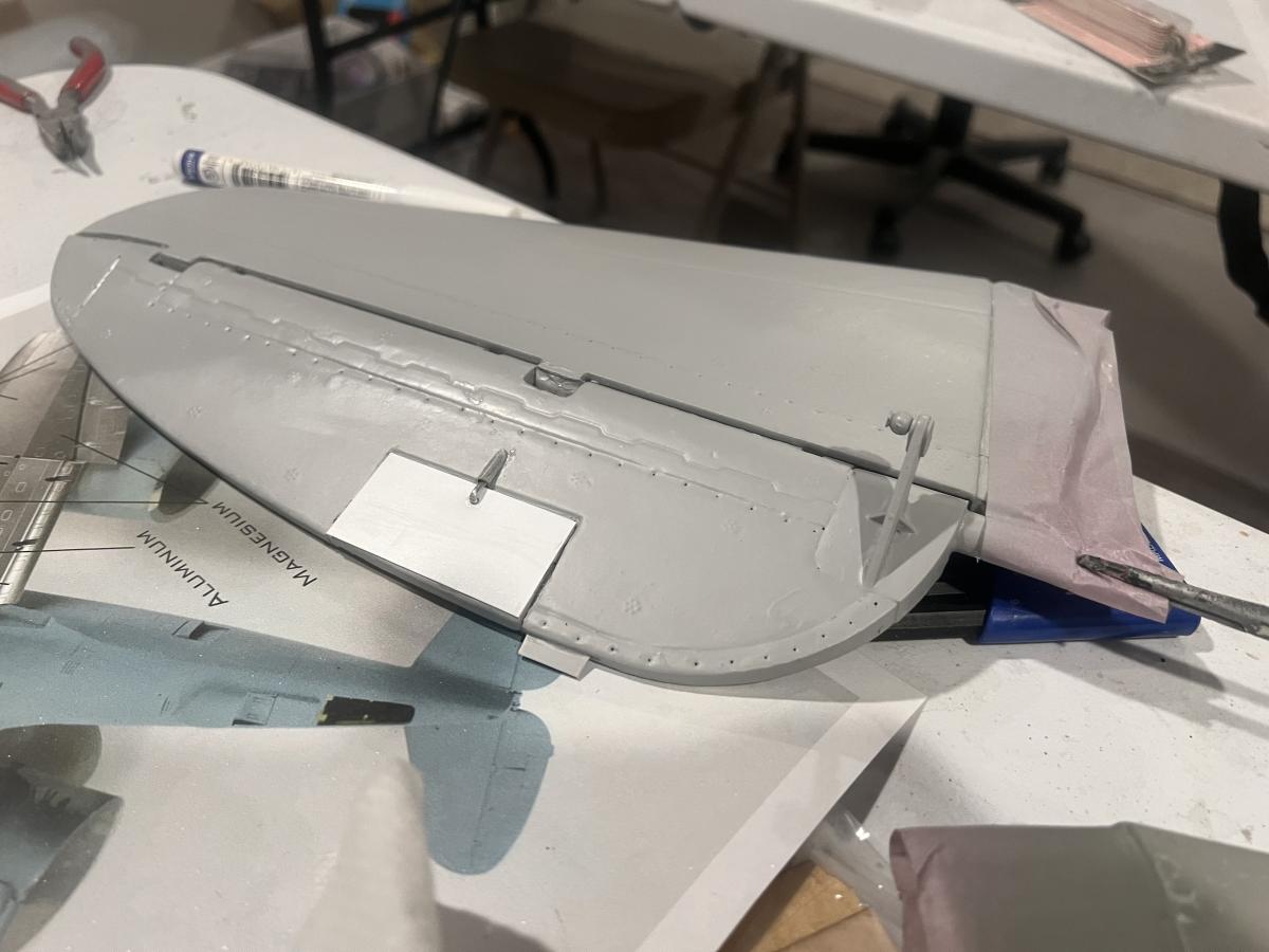

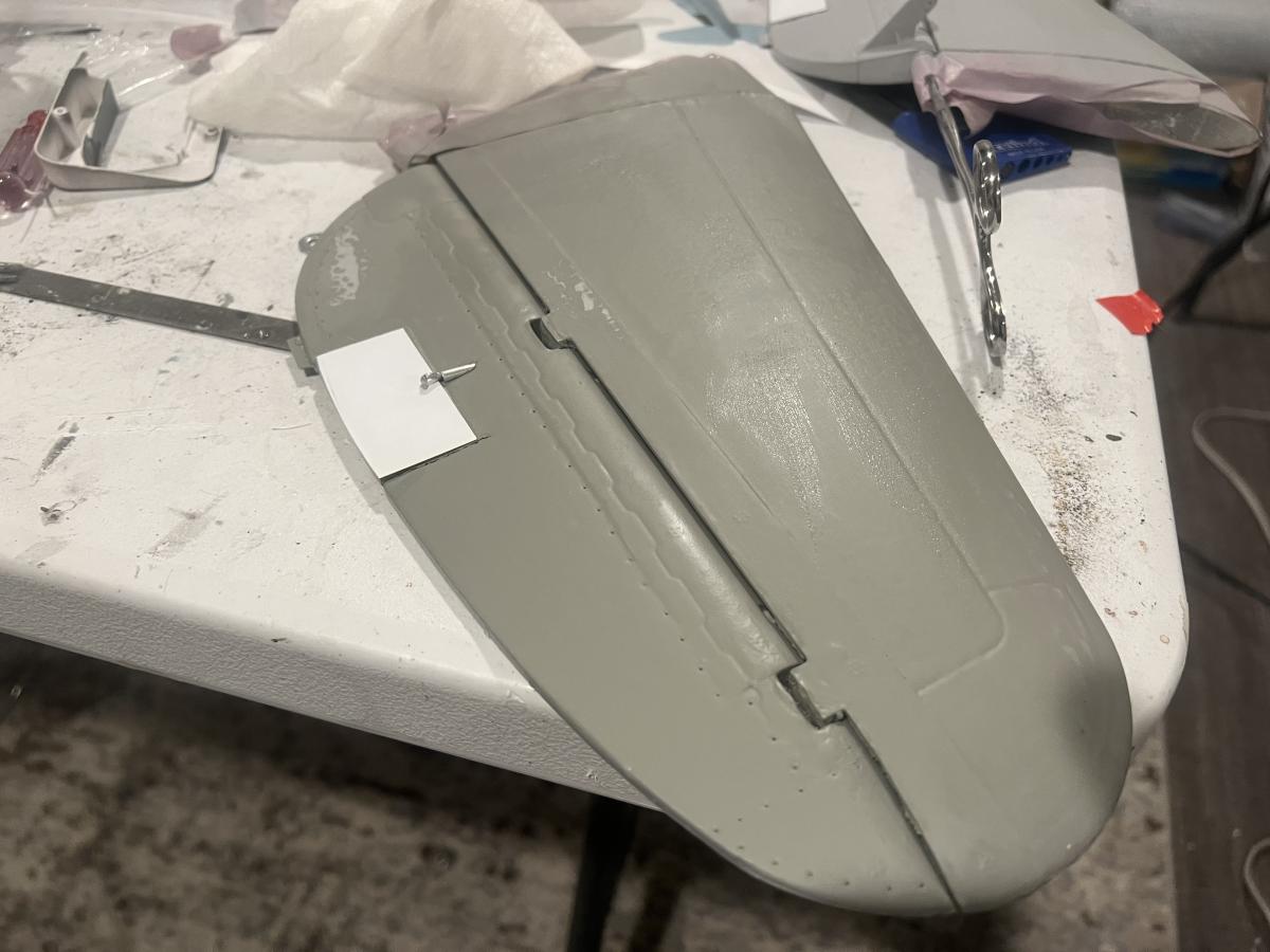

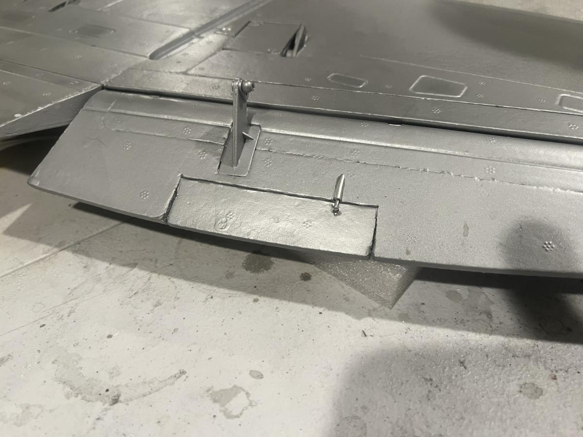

                  • I've been working on some detail work on the trim tabs for the elevators and left wing aileron tab today. I used aluminum tubes and a slightly larger tube sanded at an angle to get the effect of a tapered, drag reducing fitting on the elevators and left aileron.

                          • Completed spraying bottoms of horizontal stabs/elevators with Tamiya Medium Sea Grey. The very bottom of the fuse, plus the bottom of the right wing will also be painted Medium Sea Grey. The left wing underneath will remain NMF silver color.
                            James in California informed me that he is making good progress on the fuselage mod to a bubbletop, so that might be ready to be shipped back to me at the end of the month, or thereabouts. I'm really looking to seeing the results and working towards finishing the airplane for flight testing late spring or summer.
