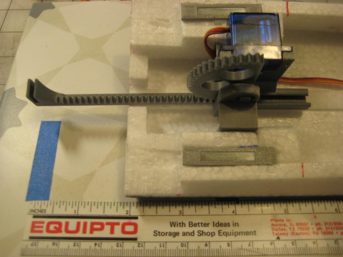

    Thanks, Rex. Got the new continuous motion servo yesterday and will be experimenting with it and my printed canopy drive system to see if I can get it to work for me. As a backup, I'll be talking to the Canadian folks with their very professional linear servo that might just work for this, too. We'll see.
    I don't remember if I told this story or not, but I read that when they first tried the powered canopies on the -25RE models, the windscreens were knocked clean off the airplane when they went to close the canopy! They eventually got it worked out!
    Cheers
    davegee
      Length of linear travel desired = 2.0”
      Rotation of conventional servo in degrees = 120o-160o
      Minimum radius of 360o gear = 1.9”
      Why?
      Servo travel (example) = 120o or 1/3 of 360o
      So through 120o a round gear OD should measure 2” (6”=360o)
      For simplicity, cut a half circle or 180o of the 6” gear in design
      Circumference is p(r2) /2 where r=1.9”
      Diameter = C/π = 6 / π = 6 / 3.14 = 1.90+ in
      Design the rack longer by a a couple of teeth either way
      Tooth size is whatever you decide, I choose 8 teeth per inch as I recall
      There are gear STLs out there, I designed my own to see if I could
      Yes, you could buy a linear servo with 2”+ travel, most are $70-$99 +/-
      50mm travel = 2”+/- with various speeds
      In any case, your canopy mounting/movement mechanism is the critical component
      Best, LB

        davegee
        Why?
        Best, LB

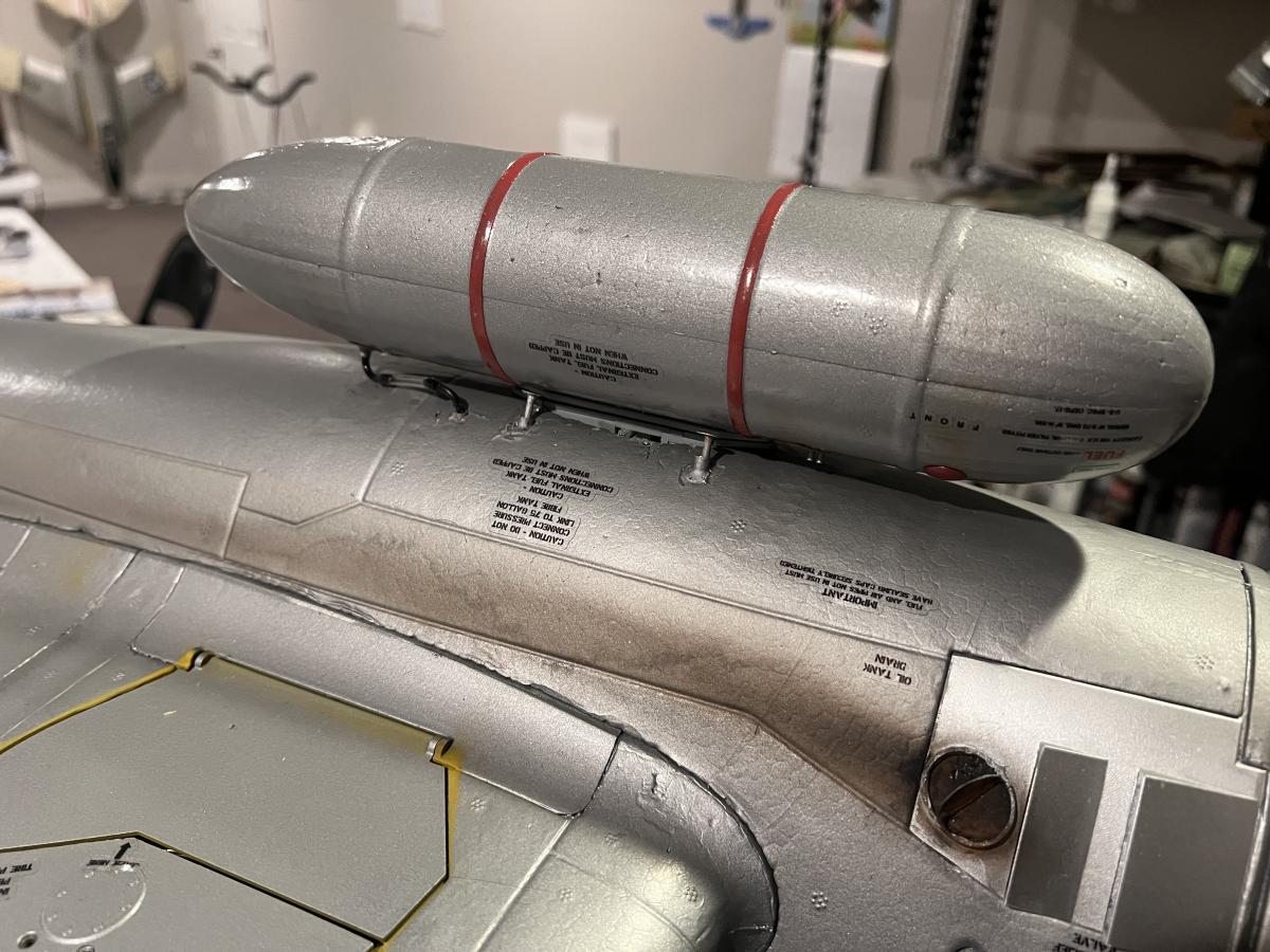

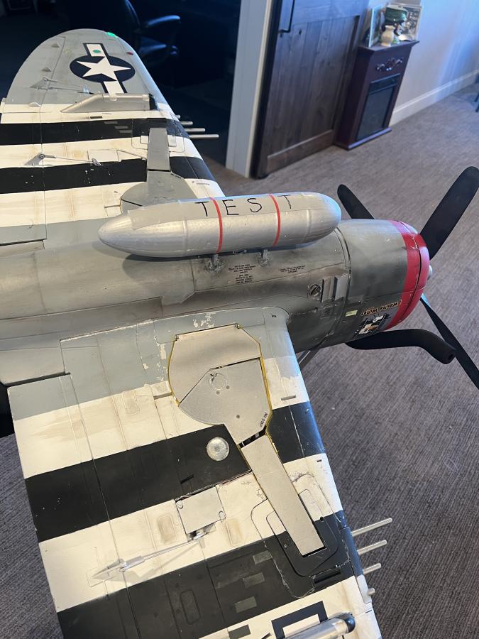

              • Today I installed the E Flite bomb/drop tank in my oldest FMS 1.5M P-47D razorback, "I Wanted Wings." I am going to try and test the dropping of a foam drop tank from the belly location on the airplane. It works flawlessly for ground tests this afternoon, and I plan on installing similar units on my other P-47s. I already have installed and ground tested this unit in my new Hairless Joe that I am working on now. I have two other P-47s that I'll be installing the unit in soon.
                I am impressed with this E Flite unit, seems to work great (on the ground.) If I fly tomorrow, or whenever I get to test it, that will be the "acid test" as to how it works. Danger Dan and I are also working on a printed STL design for a larger "flat" 150 gallon drop tank that is similar to another version they used in WWII. Once we have that design completed, I'll print it up and test fly it on these airplanes.
                Below is an old tank being used as a test tank on this airplane, hopefully tomorrow. This is a OEM part that came with the FMS kit. It represents one of the 108 gallon "paper" tanks that saw extensive use during the war in Europe, especially for aircraft flying out of English bases, where these tanks were manufactured in WWII.
                Update: Tried to fly this morning (Thursday), too windy crosswind. Will try again tomorrow. *sigh*

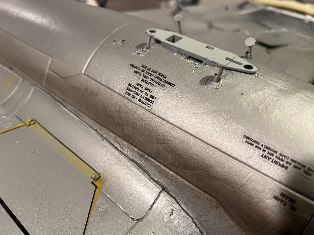

                • I had a successful drop tank release test on the EFlite mechanism yesterday. Dropped off just as I expected it would, began an end over end tumble and landed on the runway. I wasn't planning on that, but it is so light, that it wasn't damaged at all, not even a dent or chip.
                  Afterwards, I coated all the drop tanks I plan on using for the time being with Minwax PolyAcrylic with a brush. That seemed to harden them up some to avoid damage if they fall on a hard surface again, instead of the soft dirt and sage-filled surroundings.
                  I have now installed the E Flite mechanism on all three of my FMS P-47s and the new one, Hairless Joe, will use the drop tank release for some inflight pics later this spring or summer when it is done.
                  Here's a couple pics of the mechanism. For this plane, it is almost a "drop in" add-on, just had to remove the existing OEM drop tank retainers and drill a hole to feed the wire into the fuselage floor and receiver. I use the "I" button on my DX18 for easy finding without looking down at the transmitter while flying. I did have to clear out the foam just a little bit on the side to allow the spring-loaded release pin to be pulled back to attach the tanks.
                  Very happy with this after the first try, and will test it more next week with some other P-47s with the new mechanism. I'm hoping Danger Dan and I can jointly come up with the printed 150 gallon steel tank that was also used a bunch during this time period, especially on P-47s. it would fit using the same attachment as this foam "paper" tank, also used extensively back then.
