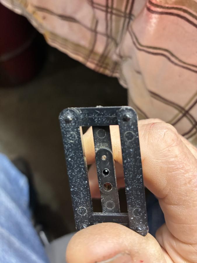

    Hi Rex: I got a very rough idea about the armored glass plate you requested. Since it is installed in the windscreen, I couldn't measure it directly except to take a caliper on the outside of the glass and got the best guesstimate of the frame size. You can take these figures, maybe make a template out of paper and see how it fits and trim accordingly. So, I used some plastic sprue about .15 inch wide and pretty thin. I made the frame 1.75 inches long for the side pieces, 1.25 inches for the top piece, and 1.75 inches for the bottom part of the frame. You should be able to glue the corners at the top to the windscreen frame and also at the bottom along the bottom part of the frame. I'll attach a couiple pics of mine. Let me know if you have any questions. The thickness of the glass should be around .15 inch thick or a little more if you make the frame a little more than .15 inches wide. The actual thickness of the real armored glass was 1.5 inches thick, for reference.

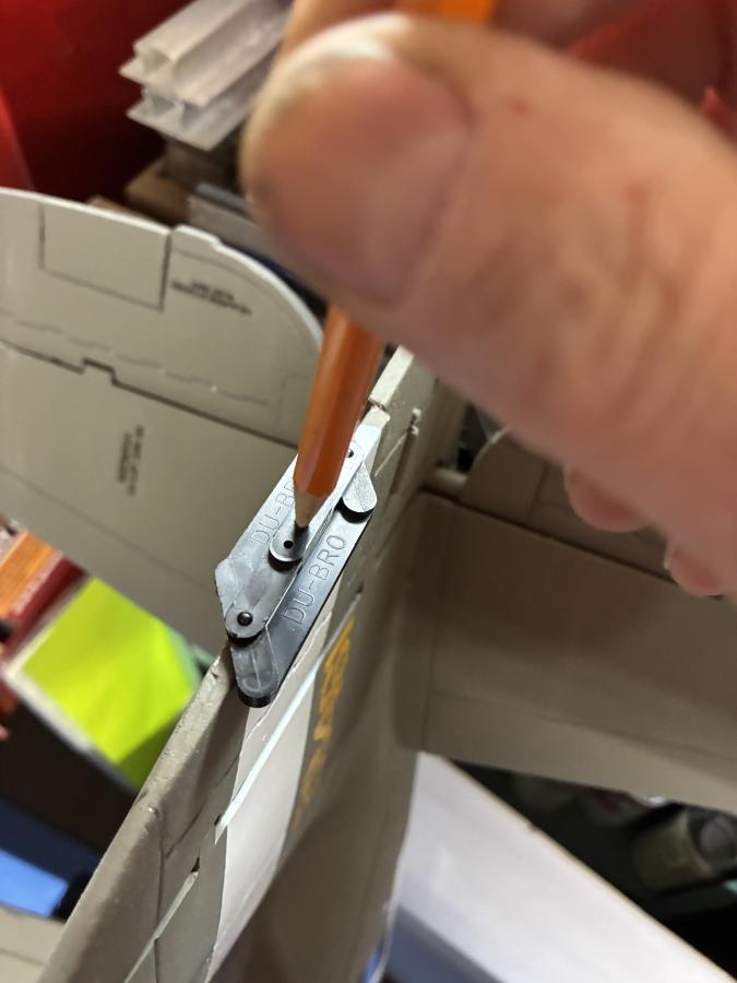

    Working on the sliding canopy rails. Used small/thin magnets and saw blades (steel) from my mini hack saw. Canopy slides easily and magnets hold it hard to fuselage. Cut and filed the saw teeth for a smooth install, will add filler where needed and finish sand/paint. Canopy/cockpit details and some landing gear details and this should be finished. Whew!
    Click image for larger version Name:	IMG_3932.jpg Views:	0 Size:	105.3 KB ID:	442677
    Click image for larger version Name:	IMG_3933.jpg Views:	0 Size:	112.3 KB ID:	442678
    Excellent, Rex! Some high anxiety cutting in two a perfectly good canopy, but it is worth it when it comes out. At least they are cheap and plentiful in case there was a booboo, but looks like it came through surgery like a champ, doctor!
    I sorta felt that way the first time I cut into the foam tail of my E Flite P-51D to make it scale and an early D model without the vertical fin fairing. I rehearsed it in my mind several times before I cut it out, and the preparation, planning, and some luck worked for a perfect cut.
    I think this can be a master stroke at the show provided the judges like cool and accurate details like what you are doing. Besides, beats shoveling snow on a cold day!
    Nicely done!
