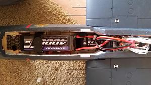

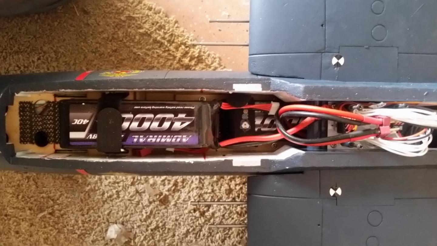

                        2) The long established CG SWEET ZONE for the Tiger is 70mm
                        Here's a pic of what I did with my 4000's(took this from a post Brandon did back on 11/25/16 on post #107
                        Click image for larger version  Name:	Tigercat batt placement.jpg Views:	1 Size:	125.7 KB ID:	152155
                        The tail end of the top batt and front end of bottom batt are 1 inch forward of that canopy magnetic
                        ps........I had a foam block support spacer under the front batt overhang.
                        Also serves to keep bottom batt from shifting forward.
                        These 4000 give close to 10 min of mixed throttle operations
                        For your 3300 use the below setup plan which is no different than for the 3600 or 4000.;)
                        Position placement of batteries so that Gear Up and CG at 70mm with tail about 1/2 inch down from level is achieved.
                        When gear is lowered the nose will drop 1-2 inches but this is fine because when full flaps is engaged it will want to balloon which is what Gman was referring to with down E mix which won't be as much.
                        This bird can/will fly very well in nose heavy position while you work out the inflight trim levels.
                        This bird really is a sweetheart to fly. It's like a twin engine trainer in warbird clothing so go have yourself some FUN:)
