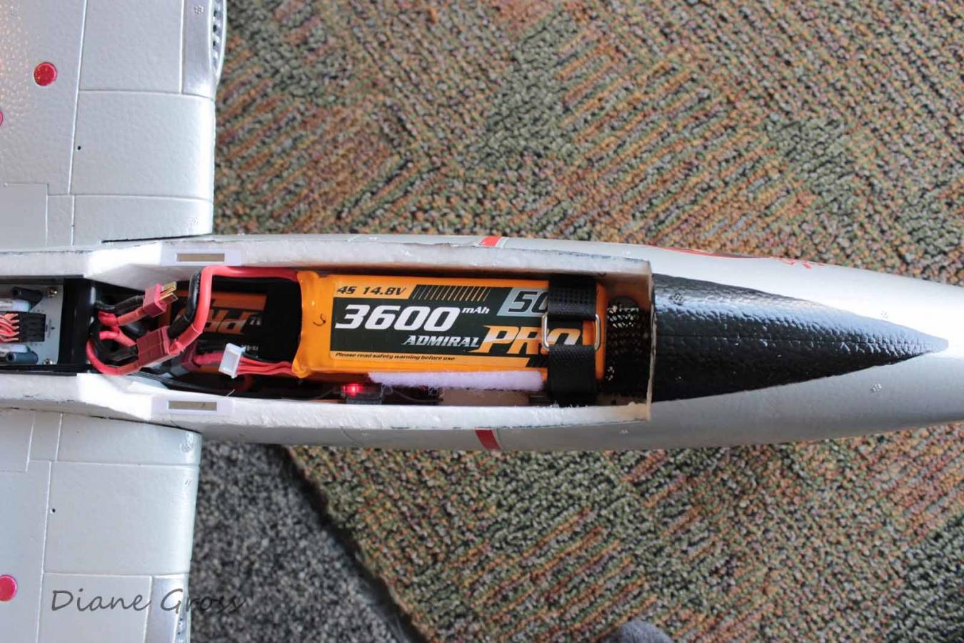

      • Hey MB, I did the same as Dave did, just followed the video, but I did check it out just now as a matter of interest. Now I had her up for three flights just this last weekend and they were flawless with the batteries in the forward position
        Click image for larger version  Name:	IMG_4034.JPG Views:	1 Size:	122.2 KB ID:	152313
        with the bottom battery placed at the forward edge of the plywood platform
        Click image for larger version  Name:	IMG_4032.JPG Views:	1 Size:	106.7 KB ID:	152314

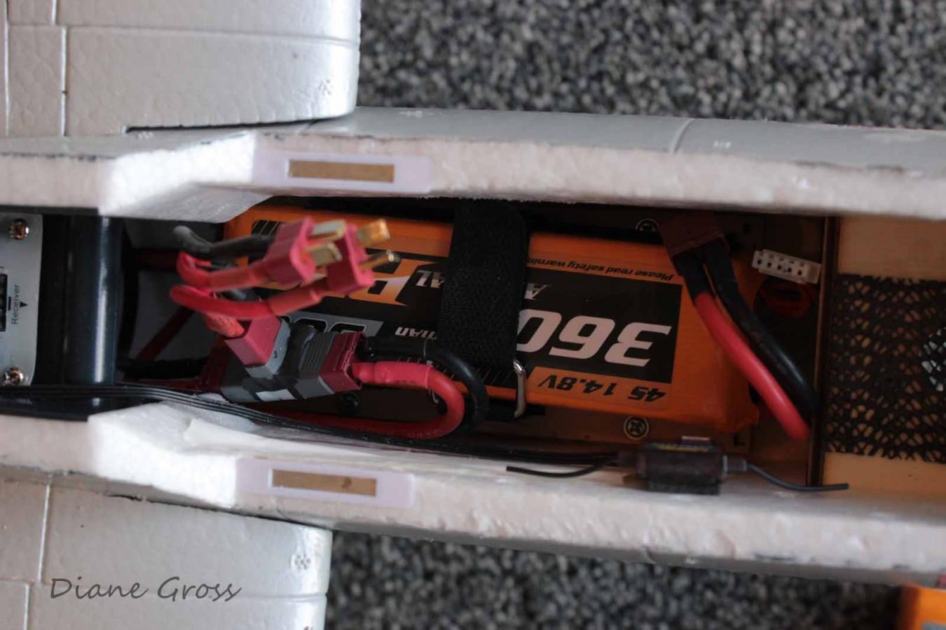

        Now, I have flown her with the top battery at the point of the strap...
        Click image for larger version  Name:	IMG_4036.JPG Views:	1 Size:	192.3 KB ID:	152315
        And she flies great there as well. With the battery at that position, the CG comes in about 65-68, close enough to the CG that CB is recommending...
        Click image for larger version  Name:	IMG_4035.JPG Views:	1 Size:	116.2 KB ID:	152316
        And of course, when the gear swings down, she'll get nose heavy, mine will touch the table and slide off if I'd let it.
        So, with that in mind and remember, both these positions have been flight tested, when I drop gear and half flaps, I have no elevator mix. At full flaps, I have a small amount of down elevator.
