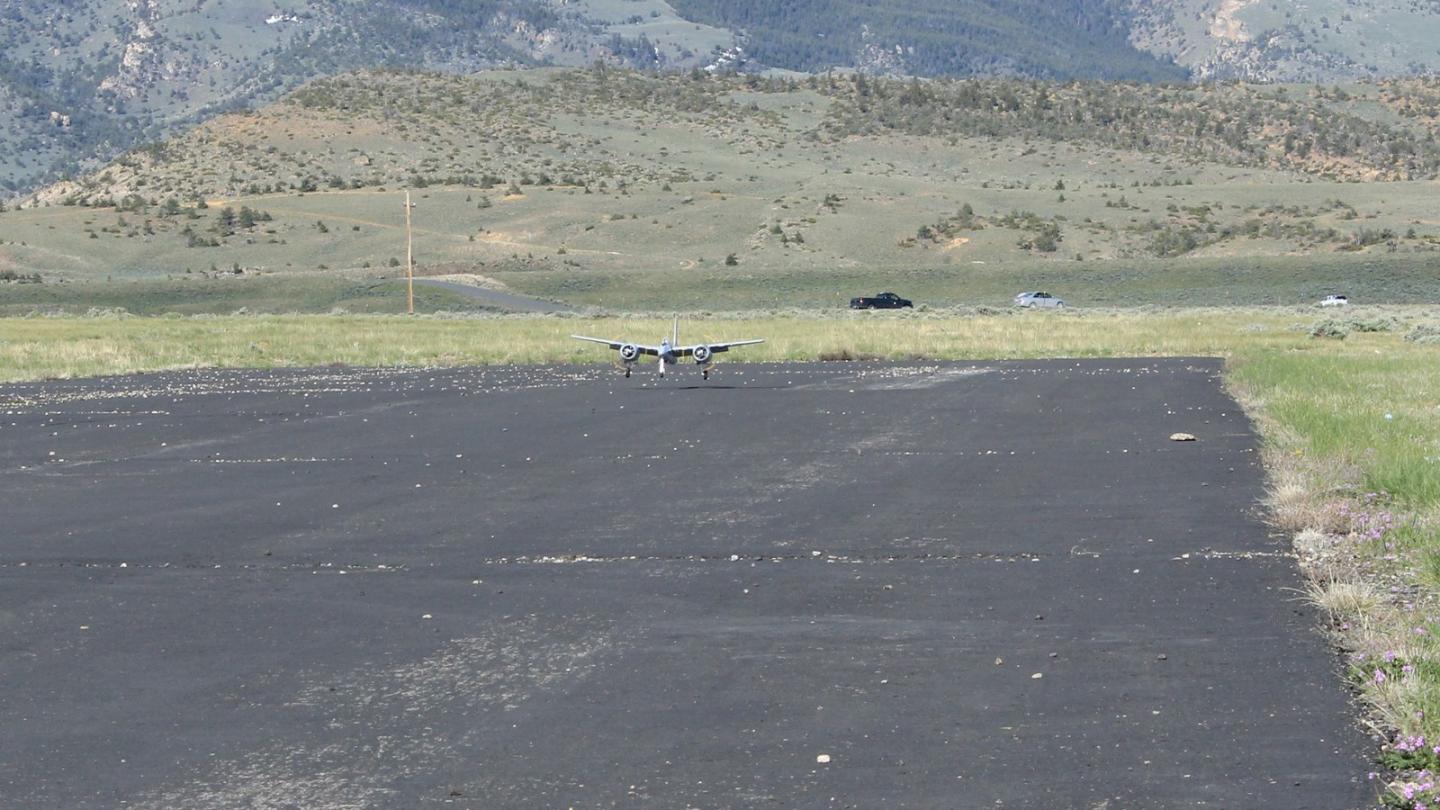

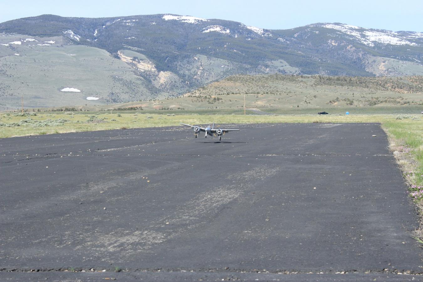

        Grossman, do you take off and land on grass?
        No, we're lucky to have a paved runway, although it has some cracks on it, the Tigercat handles it well

        These pics were from last year before we resurfaced it as well, so the cracks aren't near as bad, you can sort of see the improvement in this pic that I took this weekend.

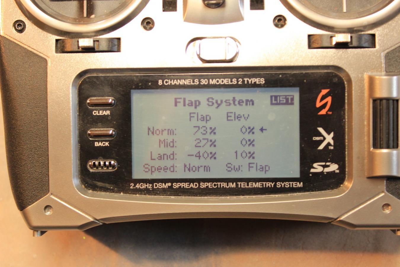

                                    • Ducks right Maddie, but watch how much you put in. I sit my forward 3600 parallel with the forward end of the hatch and it seems to work well. I have no trim on half flaps and just a bit on full.

                                      The flaps are 15 degrees and 30 degrees down, works great.
                                      • Hey Grossman, I had to look at my xmitter because I couldn't remember! LOL
                                        So I checked... like you, I have no mix set with flaps at the takeoff setting, and 25% mix set for the elevator with full flaps. (That's more than what you're using but I think I probably have my full flaps set further down)
                                        Anyway I think that having no elevator trim with takeoff flaps works fine, because we use takeoff flaps is to get off the ground quicker when needed. If there was elevator mix in, that would make it harder to take off! So in other words, we only really need that elevator trim to keep the model from ballooning during landing.
                                        I use the flaps for takeoff when I'm on the grass strip.
                                        Maddie I hope I didn't confuse the issue. The Tigercat is not going to give you a problem in any case. This is really fine tuning.
                                        • I rolled mine right off after the first flight because I had waaaaay too much mix.
                                          Tried half flaps and it was fine, no pitch while flying the circuit, full definitely needed some, so I landed and mix in 5% to start and tried again, the result was better, finally settled on 10% and it seemed just right. Now that I know what to look for, some of my other planes needed a slight mix as well. Our eye for what's right and what's wrong becomes sharper as we gain experience I guess. You're right though, you fine tune it to your personal preference, sometimes a single percentage will make a difference, worth trying to dial it in perfectly.
