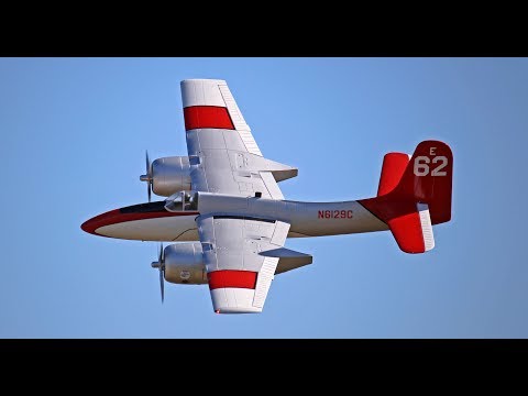

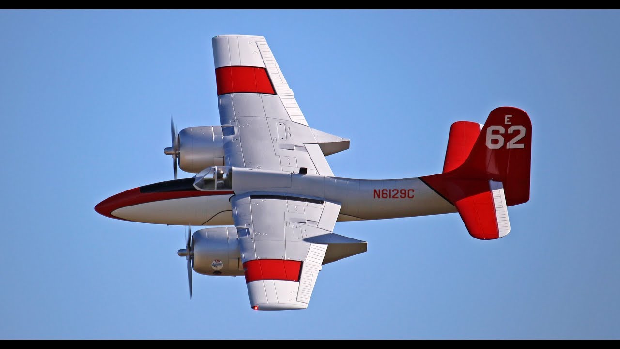

                                    • Hey guys, here's a little story I wanted to share. About 2 months ago I had the privilege of meeting Bob Forbes who was a pilot for TBM Inc. (the company that operated the F7F Tigercat Fire Bombers). He had a Flightline Tigercat that he had had custom finished by Bob Vanderveen in the airplane that he used to fly and in fact flew at the Reno air races. He asked if I'd help him get the model ready and flown for him. So, this past weekend we got 3 flights on the model for him and it was an absolute pleasure for me to do so and is a day that I will remember for a very long time. I also sat with him and he shared a little about his experiences on video which I'll have uploaded next week along with an article I wrote. I love the Fire Bomber Tigercats and this model was beautifully finished and flew amazing! Such a cool model with a great story behind it.
                                      Chris
                                      http://thercgeek.com
                                      http://youtube.com/thercgeek
                                      • Here are a few pictures from the day also.
                                        • Love that scheme Chris. Thanks for sharing the video.
