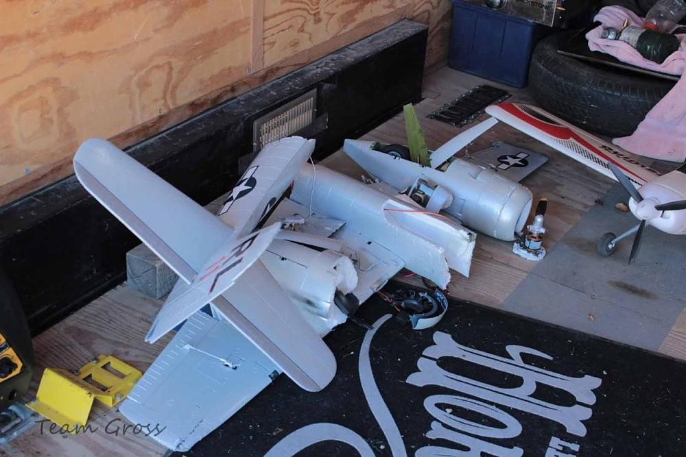

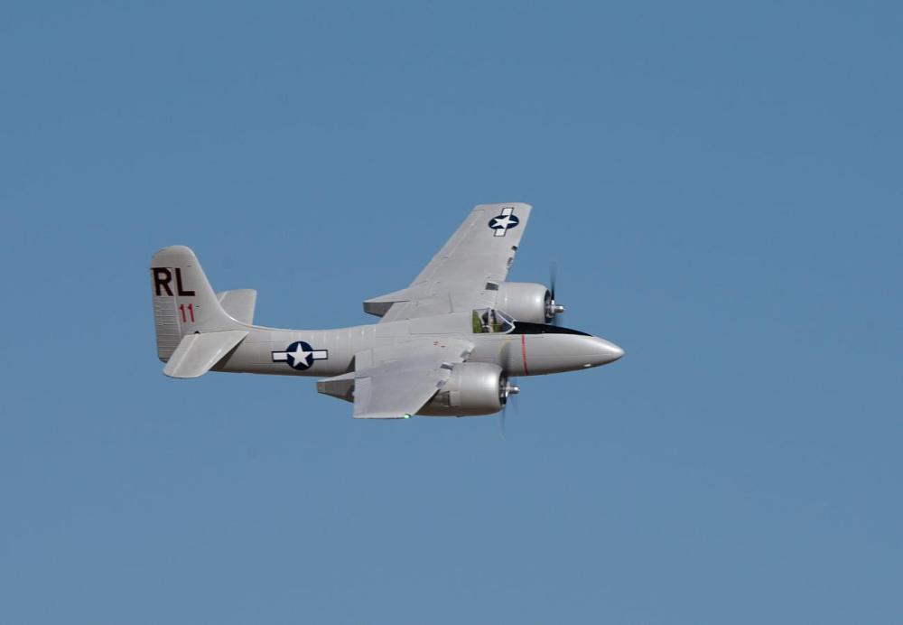

            • I'm thinking of using the B-25 system from the prop shafts forward, it looks more robust than the Tigercat system. I pretty sure the weakness in the upgraded system that I had on the Tigercat was they way the props attached to the prop shaft. The 3948KV760 motors gave her a big performance boost using the stock ESC's but I'd bet one of the props failed in mid air. Click image for larger version
ID:	387164 She's back in the air running the stock motors/props
ID:	387165 but man it performed better with the 760's.

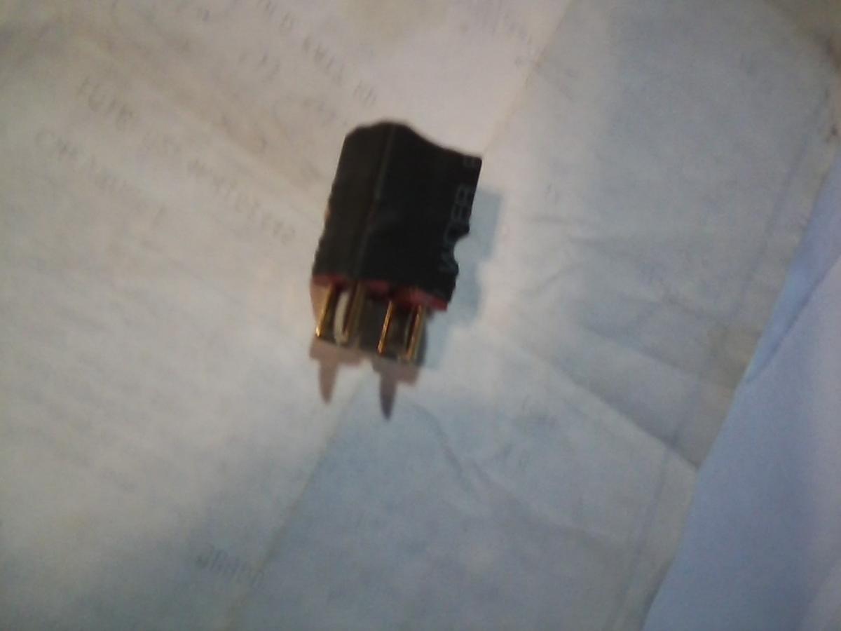

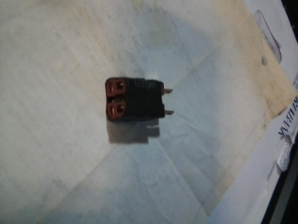

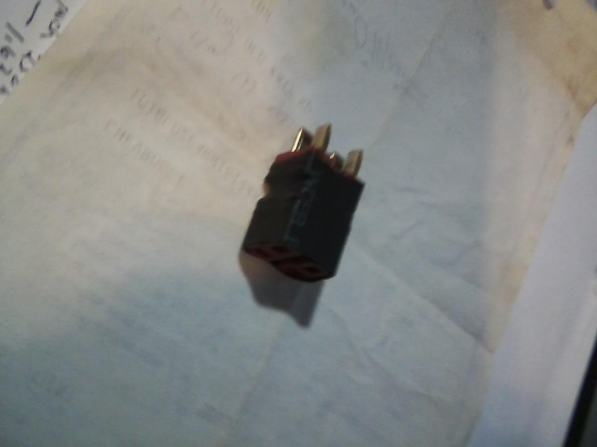

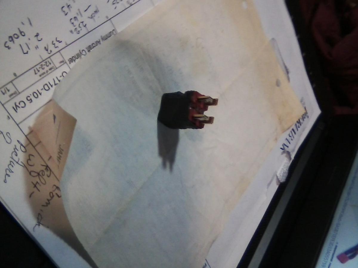

              • . I used T connectors,2sets, soldered male to female. I then glued them side to side with a spacer between them ..After glue dried Iran a jumper wire across + to + , - to- and then covered with heat shrink.I used 2, 4s 4600 batteries. This way you run both batteries on both motors.
