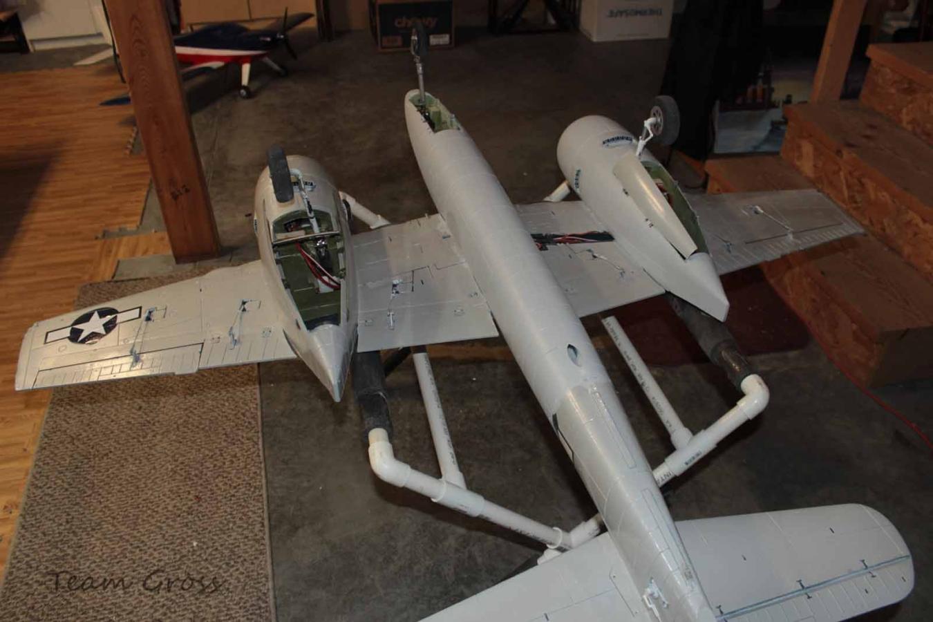

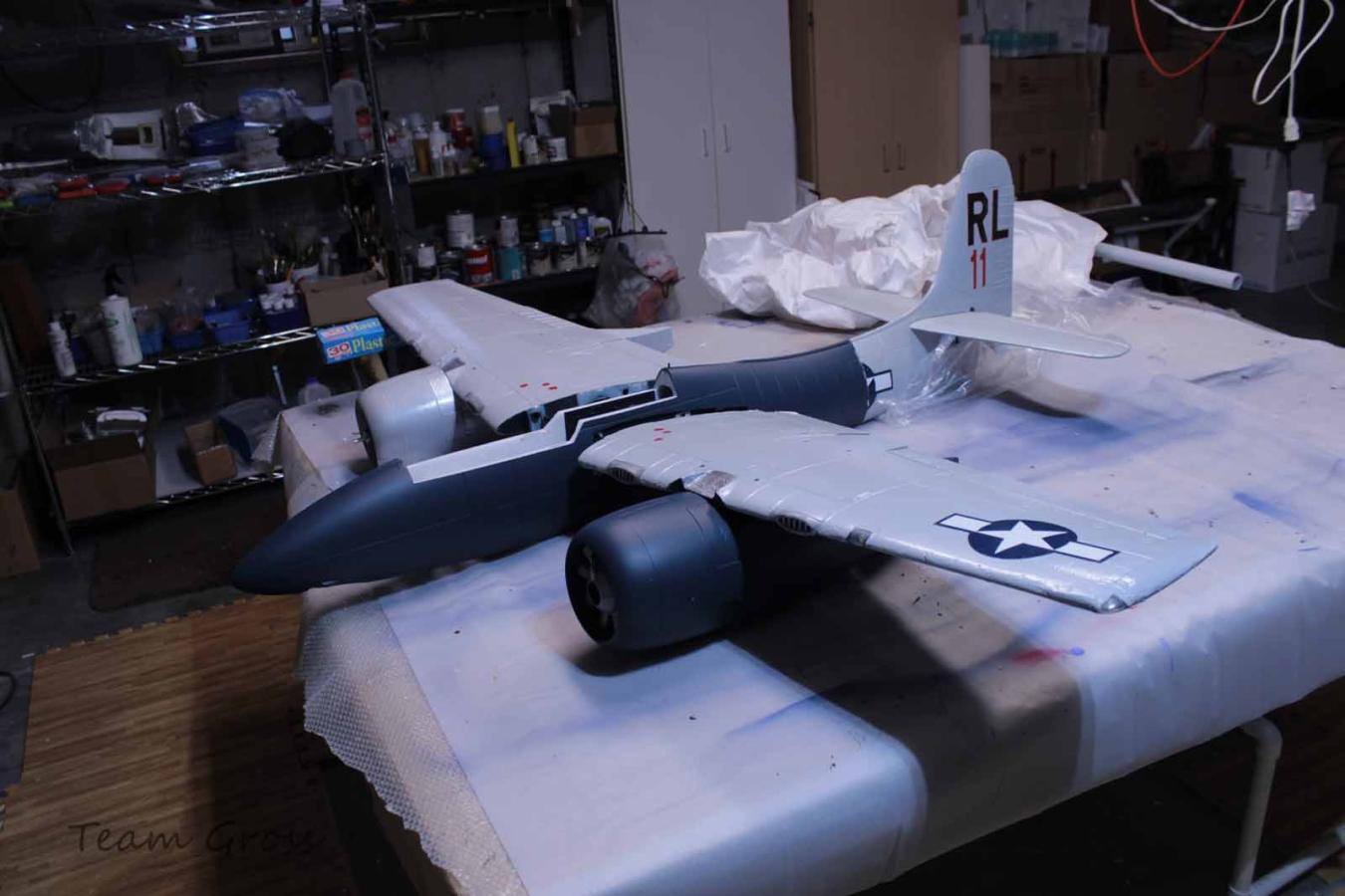

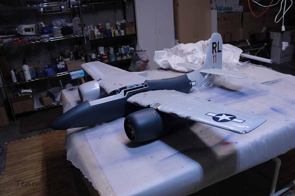

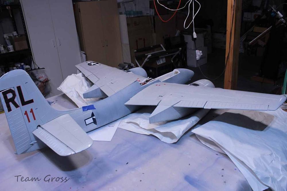

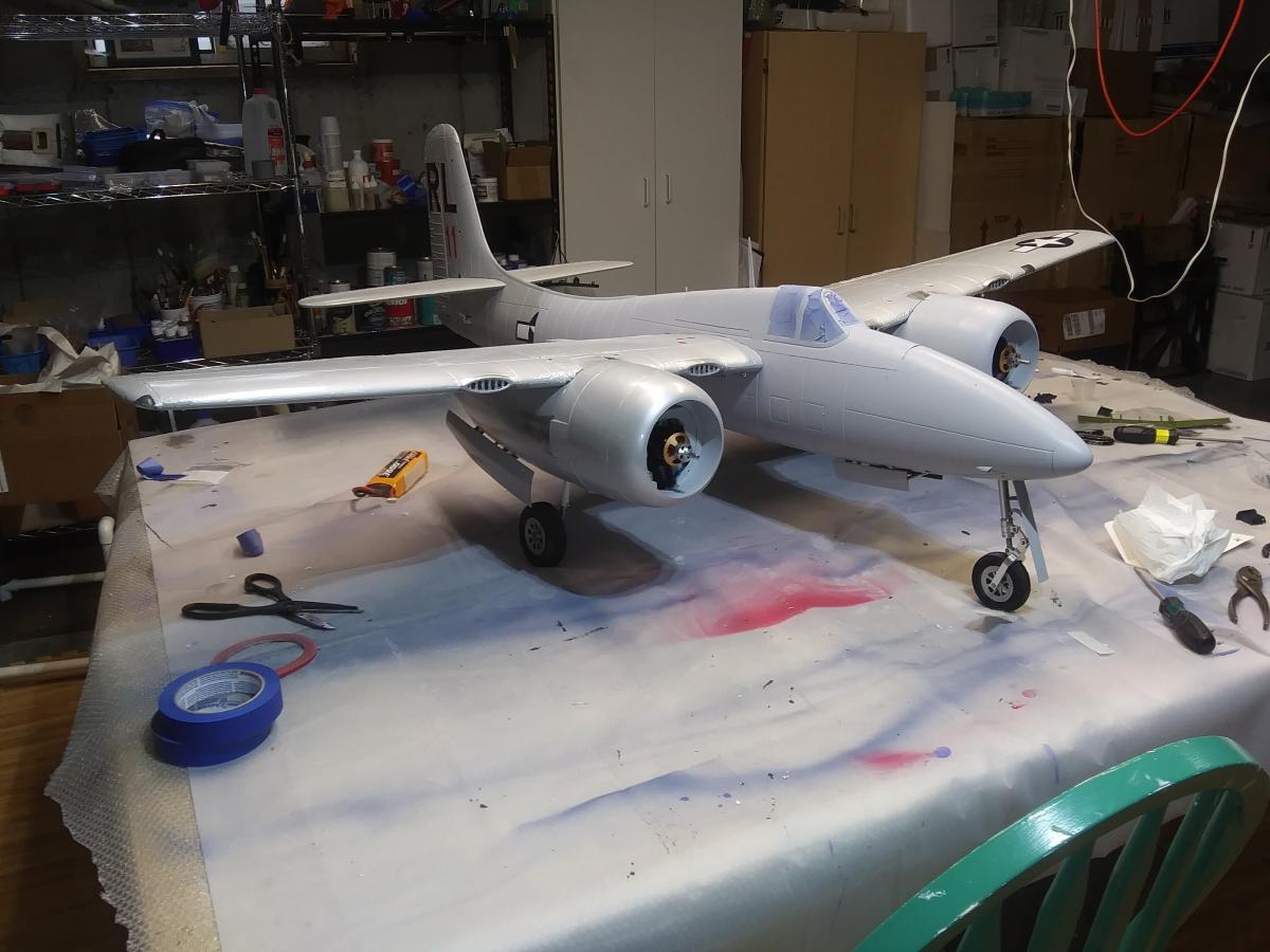

Parts came today, I did an initial lay out..
Then got down to work

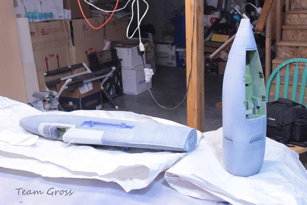

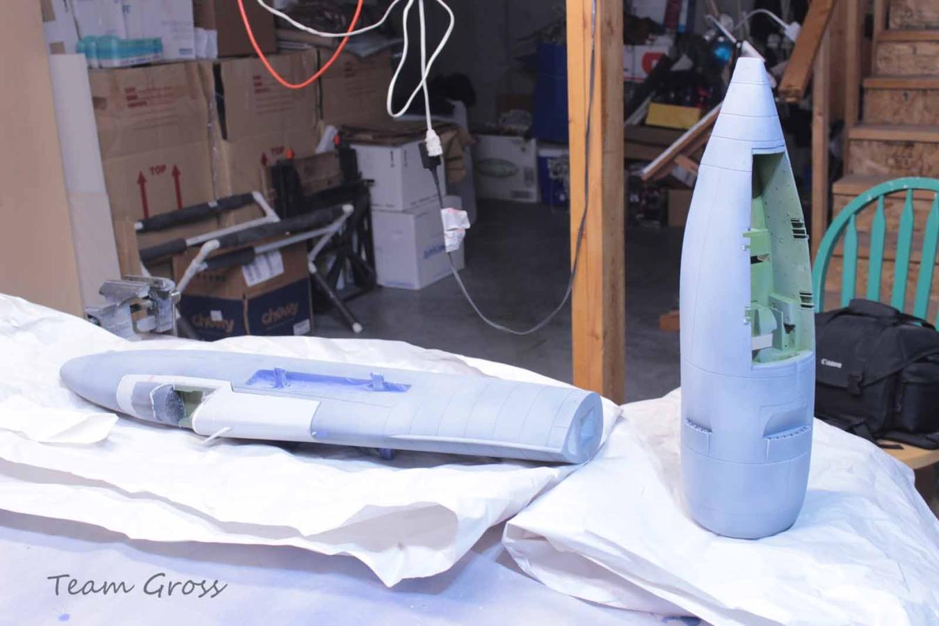

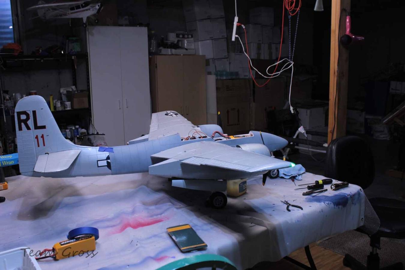

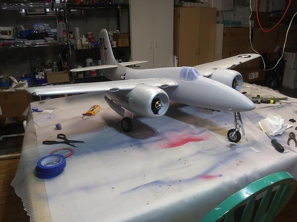

Fuse and nacelle were coated with Krylon Foam Primer. I used the old battery hatch cover as a paint block and stuffed the hatch with paper. As you can see, there are no L/G doors on either the fuse or the nacelle, so I'll have to do another order. Also, the hatch cover is too distorted to use so a new one of those as well.

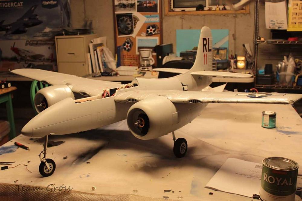

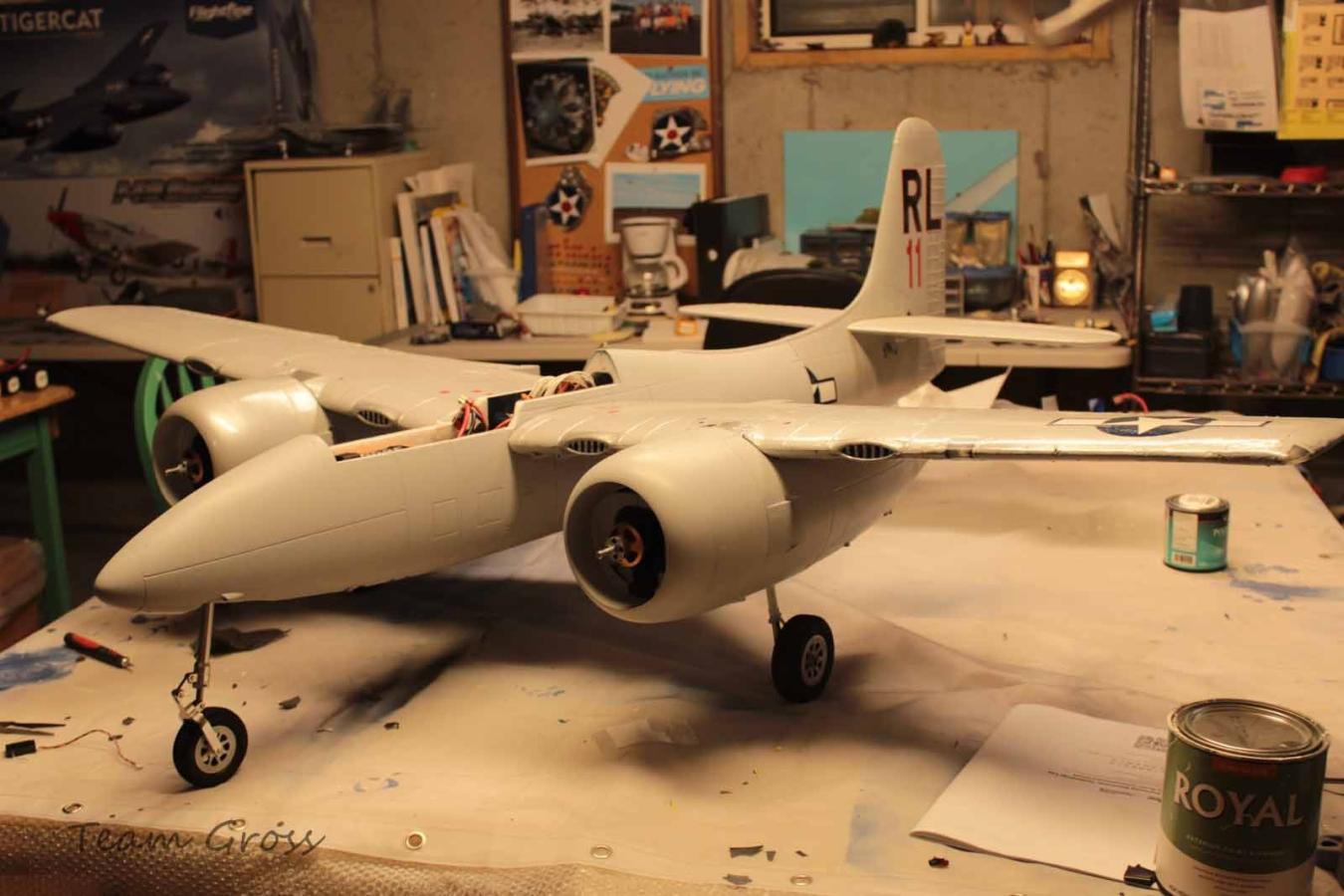

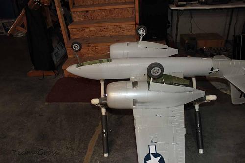

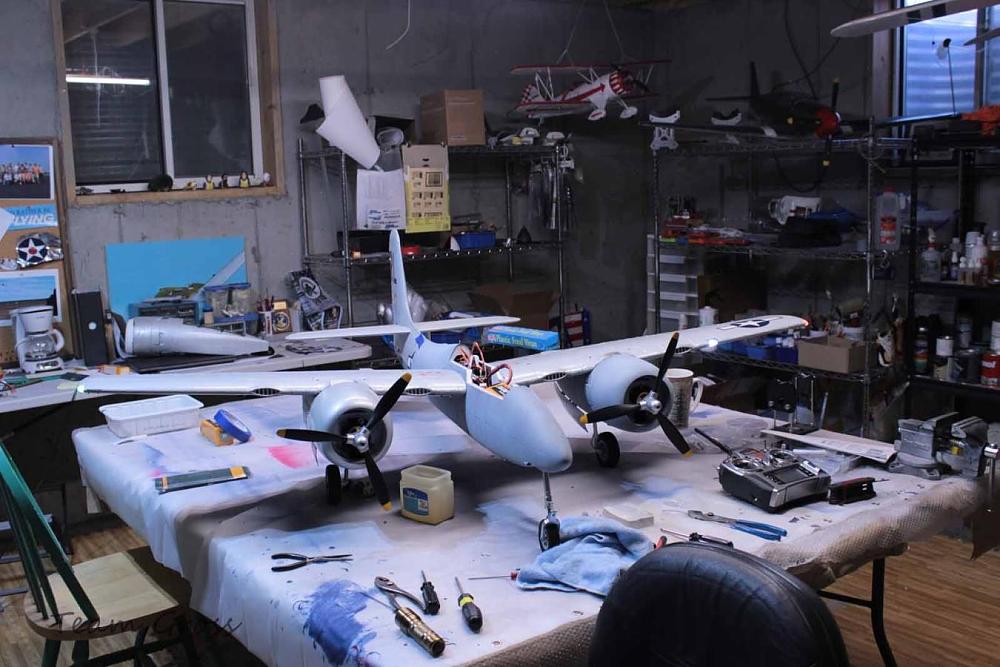

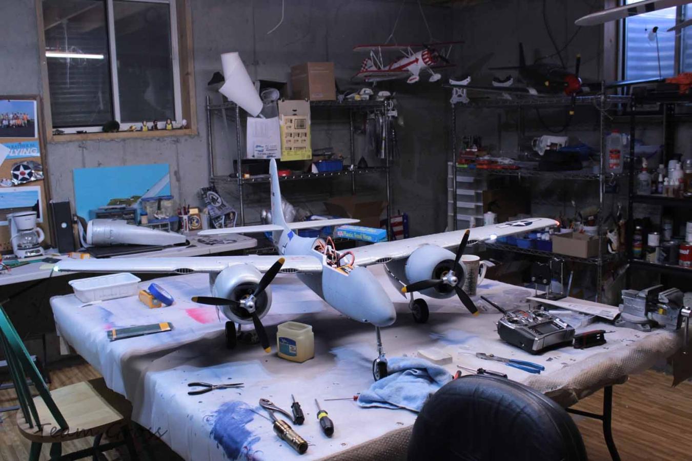

The beast assembled and the wiring harness all reinstalled as well as the receiver. I opted to go with the original motors and forgot about the ESC adaptors. Guess I had removed all but two and after a time of trying to figure out why one connection would work but not the others, duh, the brain kicked in.
Gear down and motors turning in the correct direction. The port side prop was wobbling so I pulled it and realized I'd forgotten about the screws that stick out from the back of the hub. Out with the Dremel tool and knocked those down, works like a charm.

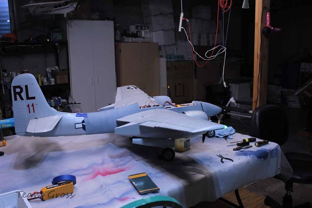

So far, everything checks out, all control surfaces are working, I only had a slight adjustment on one flap.

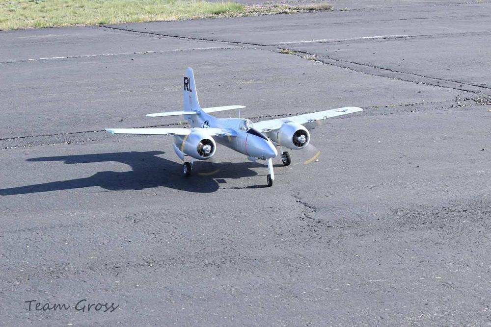

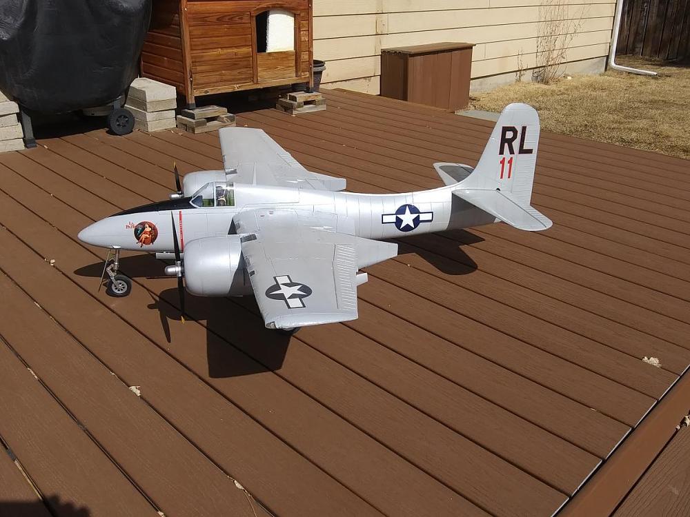

So once again there's a Tiger in the basement. I have a spare La Patrona decal and Callie is making me a new set of fuse Stars and Bars.
Tomorrow, I'll giver her a coat of 'silver' paint I had made up for her originally I believe it was called silver birch, but don't quote me. Then several coats of Pearl then the Spar Varathane if I can find any. Then she'll be back to her old self!!
YAY!!!!!!!!!

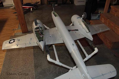

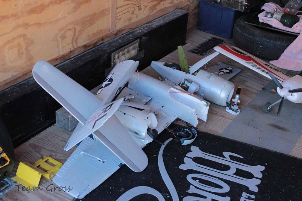

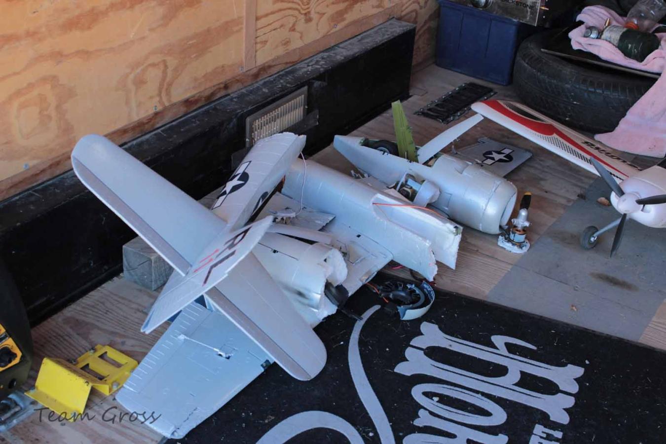

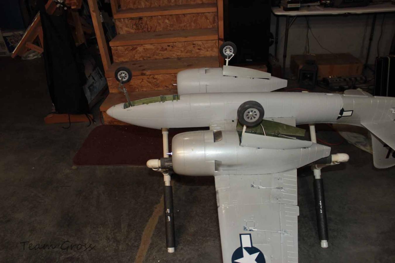

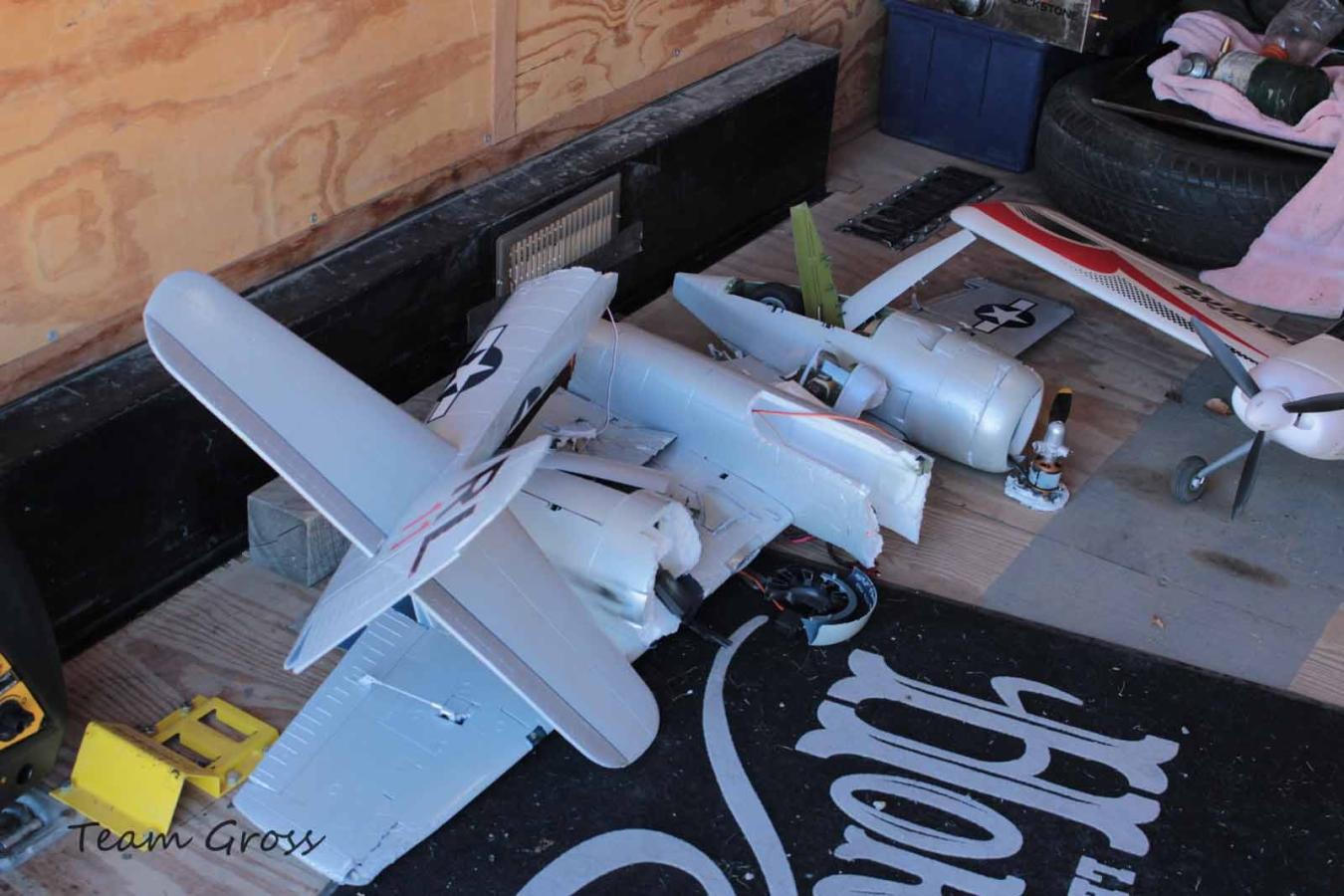

Oh BTW, I just found a picture of the wreck, here's where I started...
The forward fuse and the one nacelle got me where I am so far, the wing was actually in two foam pieces but the spare was good, so with a little glue they were good to go, or as my buddy Harry used to say, "They've been through the shop!"

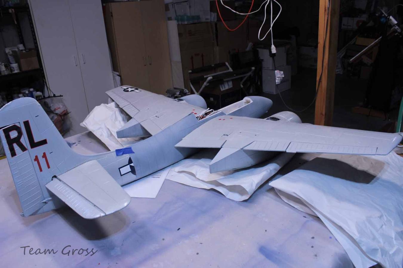

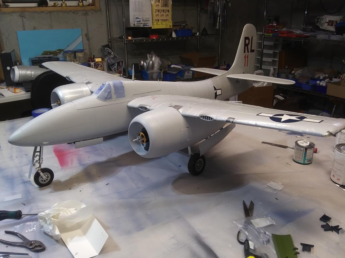

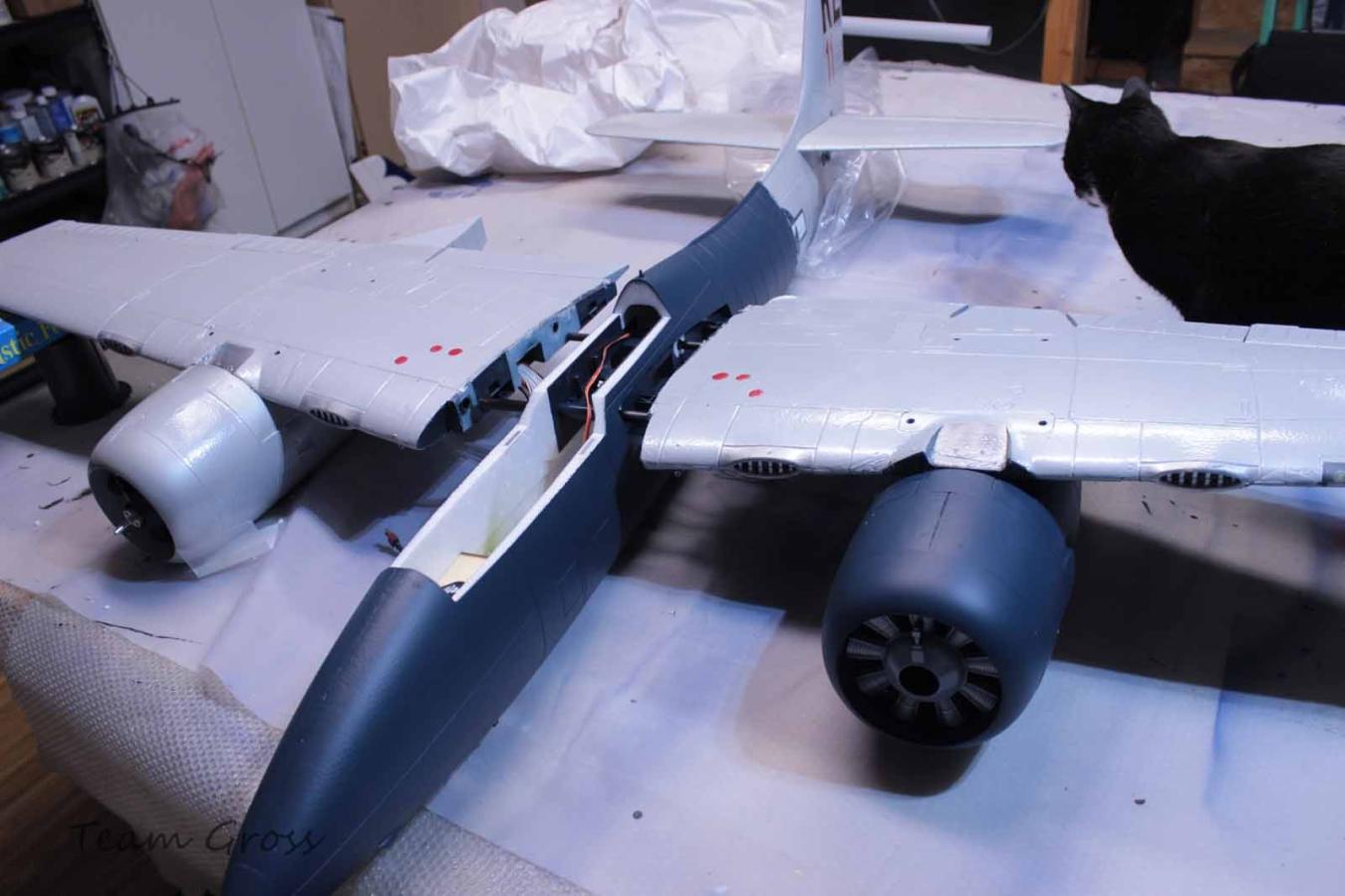

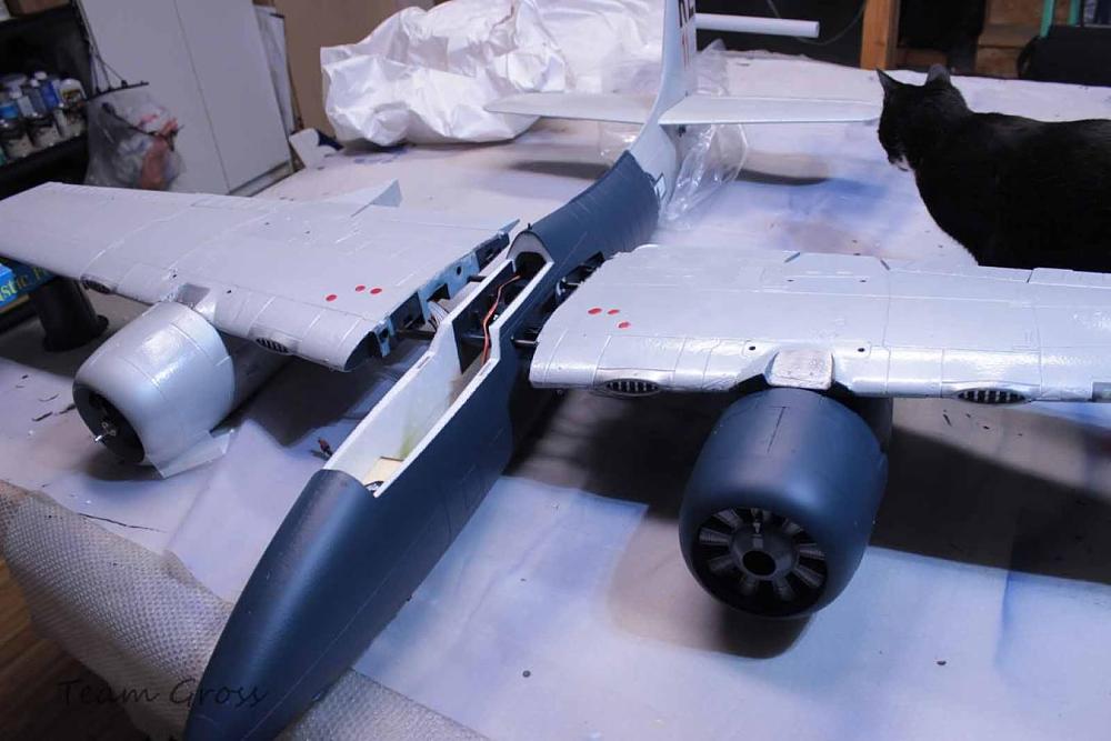

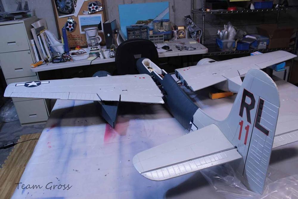

Thanks Dave, got the base paint on this morning (over the primer). It's amazing how far you can go with that $5 sample can! I did the original paint job, then a spare nacelle, then the wings again and now the third nacelle and the forward fuse and still have over 3/4 of the can left. I really like that Clark and Kensington paint from Ace!
The pictures clearly show the difference in the color that the Pearl and the clear coat make.

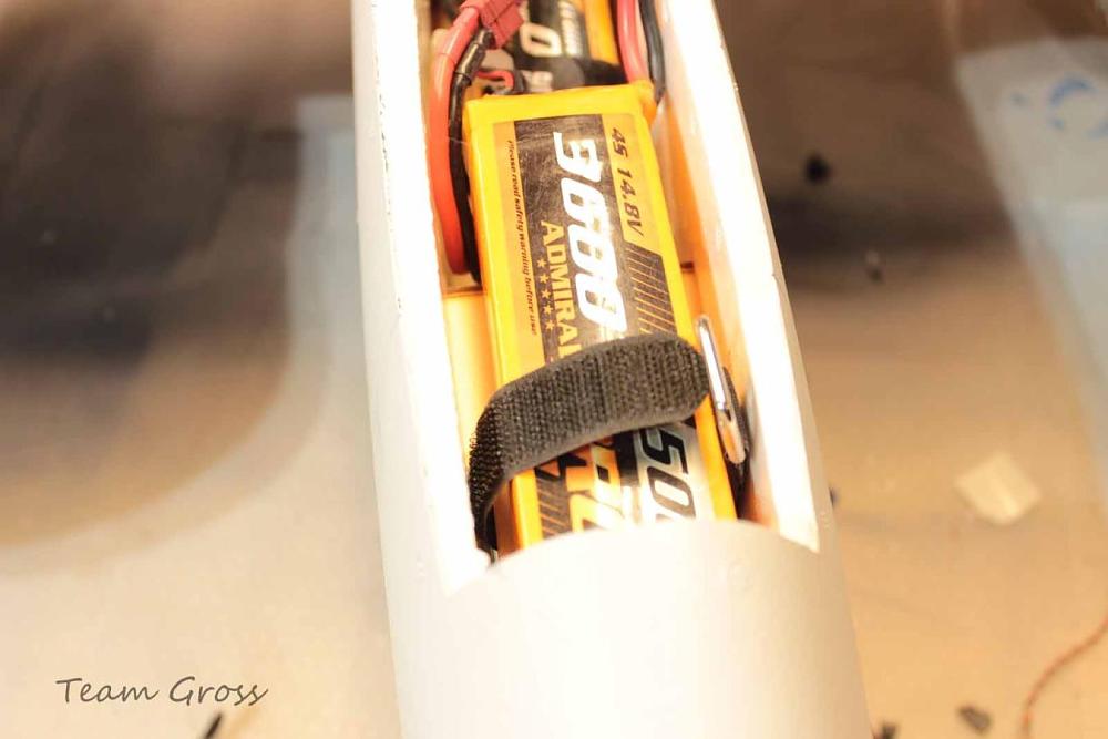

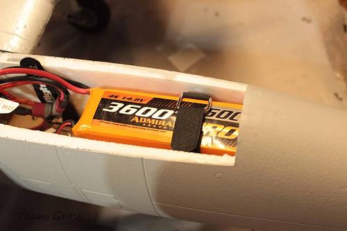

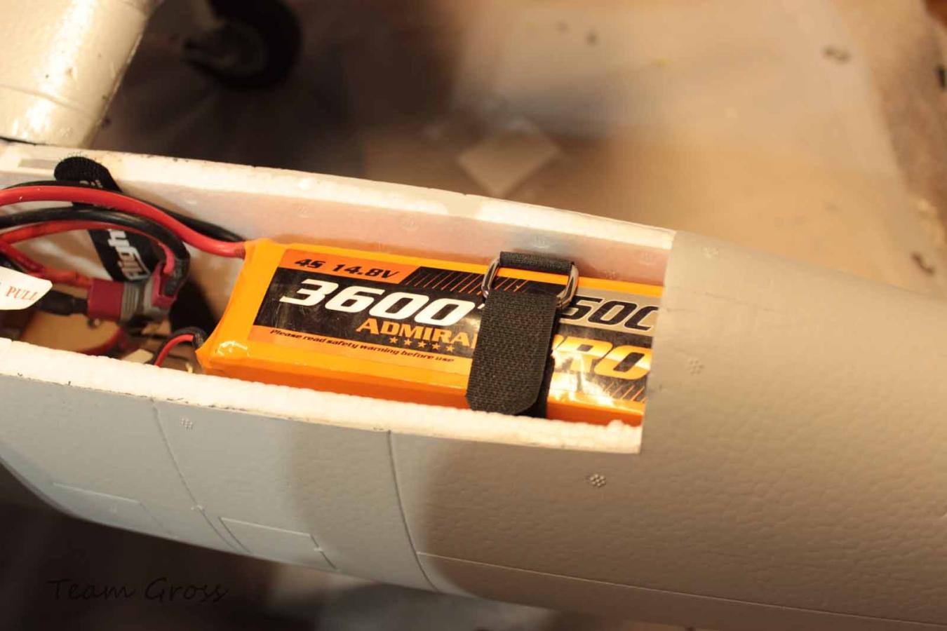

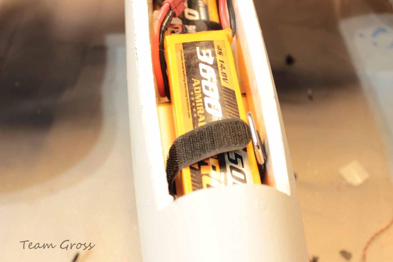

And once again, FlightLine has put a battery strap in that is WAY too short for a 3600 4S. I had the same problem with the last Bearcat.
Fortunately, I found one of the original Tigercat straps and installed it
What's with that??
Anyway, spent some time routing wires and she's pretty good now. The hatch and the gear doors are on their way, I made the mistake of thinking the were included. WRONG!
So once they're here and installed, I can finish the painting and get to the Pearl coats and clear coats.
Boy after all this she'd better fly like her old self!
What's with that??

I ended up going with a longer strap in the bottom bay as well. Anyone who has had the pleasure of installing a battery in a Tigercat would appreciate the advantage of a longer strap that sits vertically in the hatch, so much easier

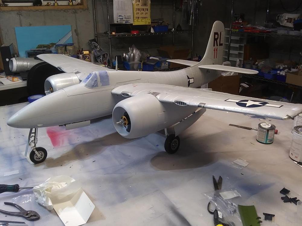

Got the gear doors on and painted today. It was interesting in that the nose gear door set didn't come with the tiny screws that hold the gear pivot point and spring or the gear doors in place. I had to old ones which was good. The Main door that I replaced needs a little filing to close flush with the old gear door, no big deal, I remember doing that with the original ones as well. I pushed the mast glue point and all, out through the bottom of the original hatch and took the Dremel tool to it. Got the mast cut out and now installed in the new hatch. So it's like a ghost, I haven't seen her in two and a half years, pretty cool though.

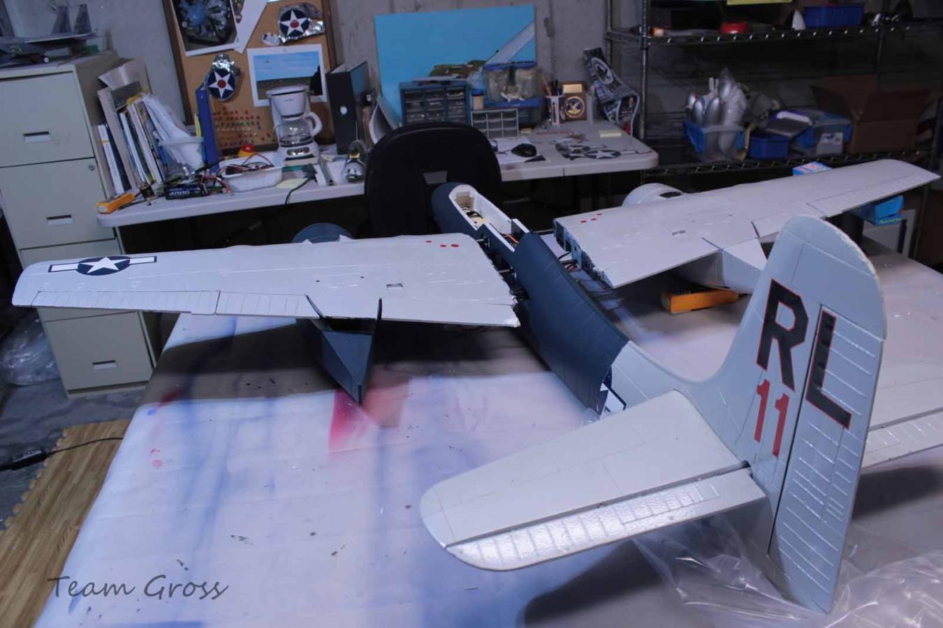

I'll let everything dry up then start in on the Pearl coats. There's a myriad of things to be gone over and checked and rechecked as this isn't a kit build but a rebuild from a major crash that I don't plan in repeating if at all possible
Let's not forget where this project started from....

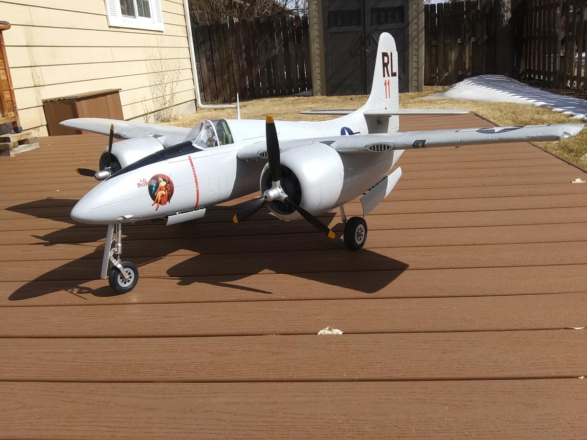

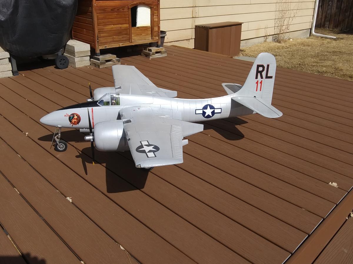

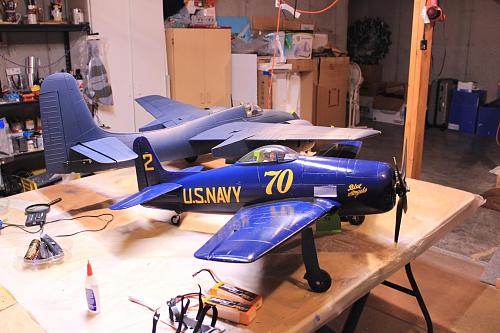

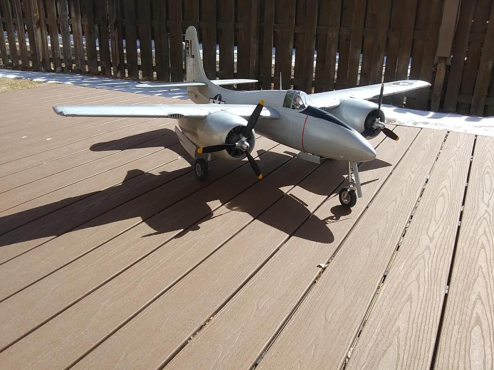

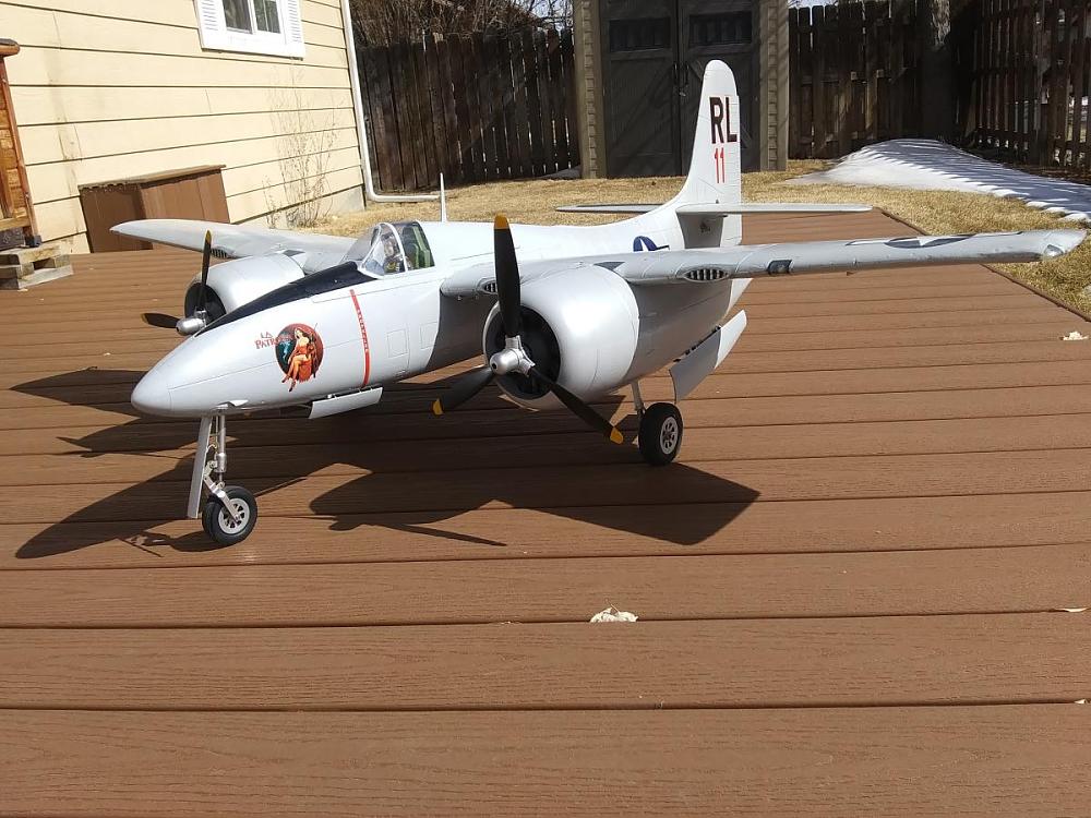

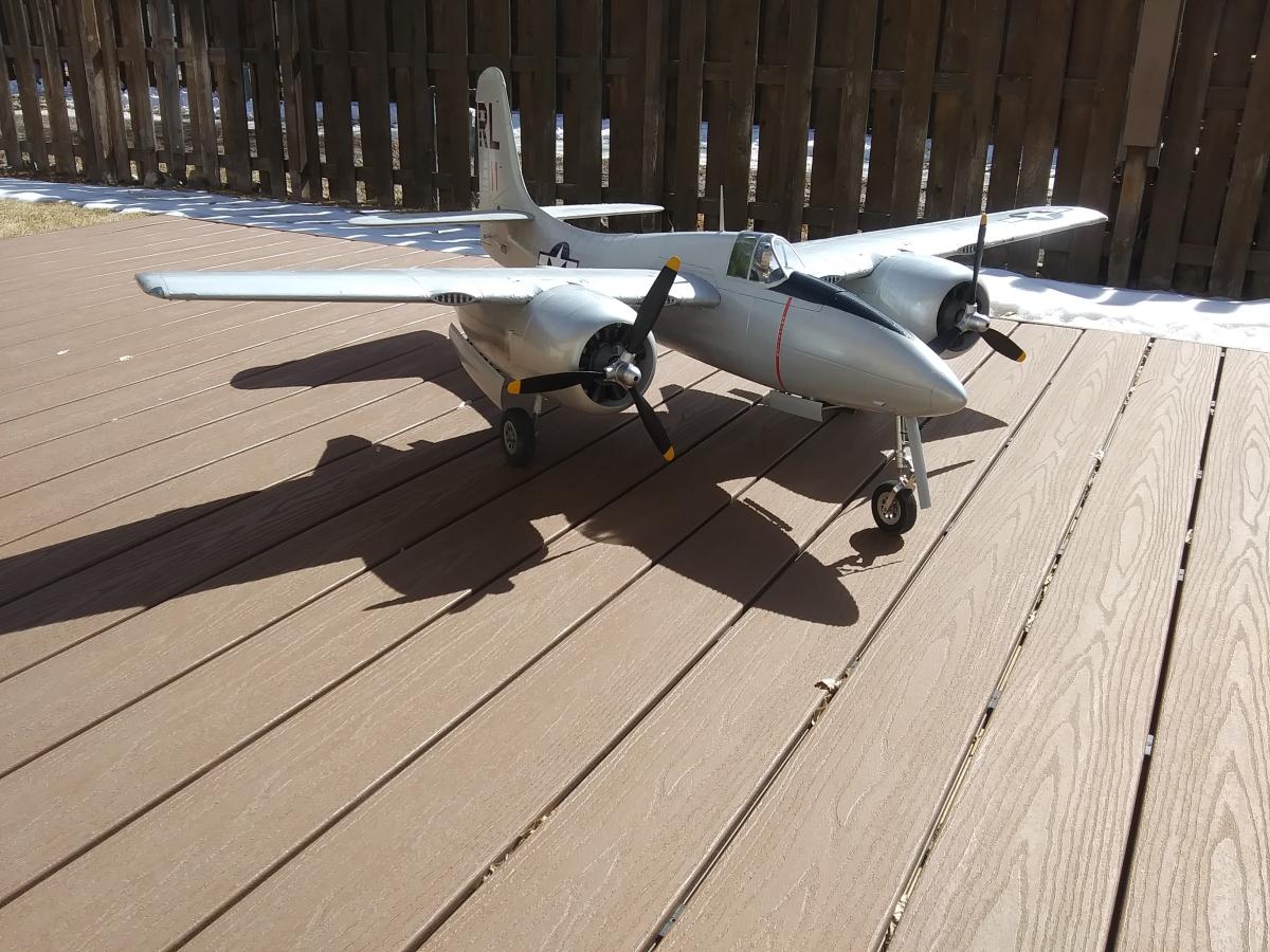

Another coat of Minwax on the bottom, La Patrona decal placed and Minwaxed over.
I was looking at the pics of the original build way back in April of 2017 and realized just how long I've been in this hobby, coming up 9 years!

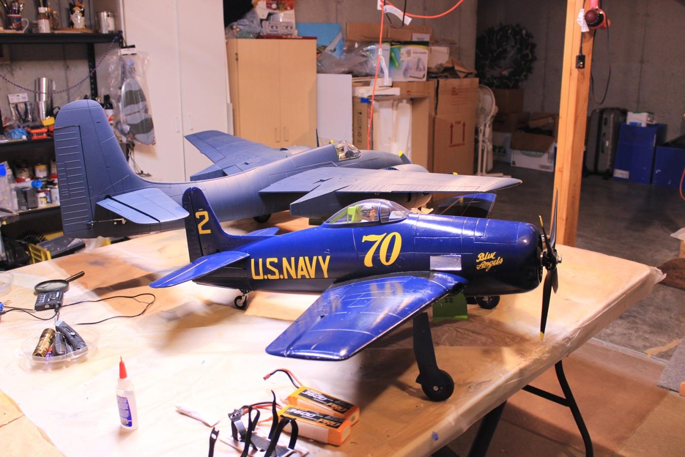

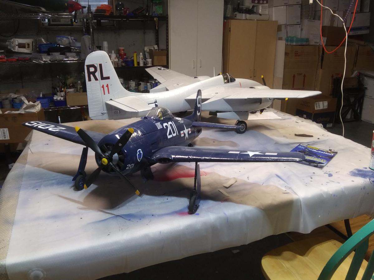

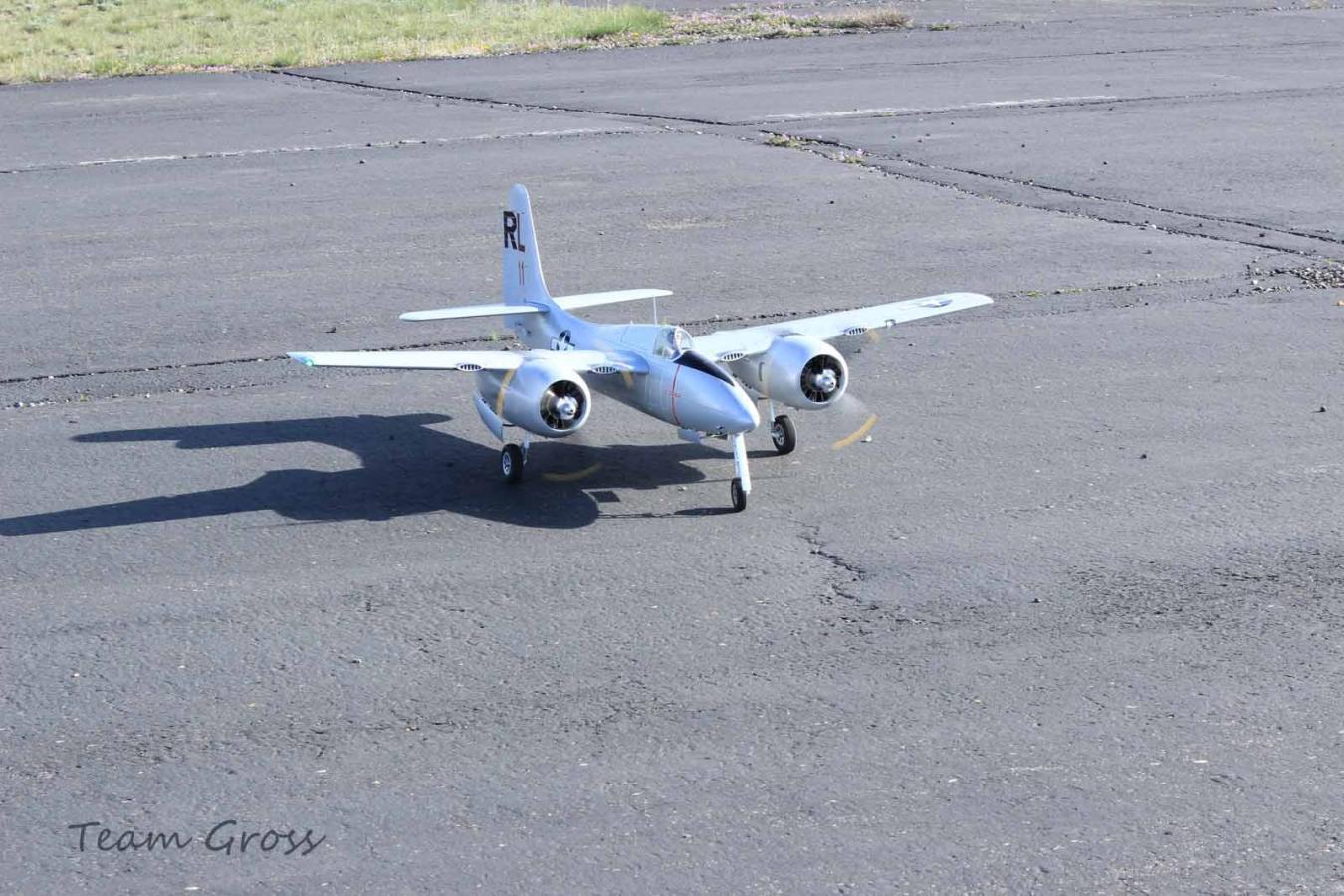

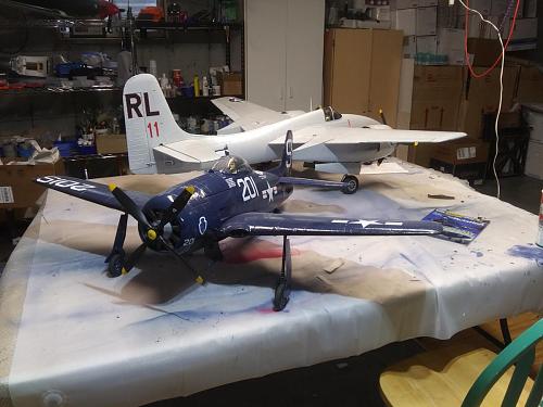

She was flown a few times at the home field before we headed for Nefi in 2017 our second trip from Wyoming to Indiana. Also taken was my original Bearcat which I lost while there, we had a bout of rain and she got wet, I believe it got into the receiver or the gyro because she was an amazing flyer up until then. Anyway, she sat in the junk box until I finally dragged it out and decided to make a project of her. Bearcat 2 was lost in the sun and was actually a new fuse and Bearcat 1 parts, so I now have Bearcat 1 back together and La Patrona well on her way. I came across this picture of the two of them when La Patrona was at about the same point as she is now and thought I'd duplicate it.
Bearcat 1 and La Patrona in April of 2017...
And the two of them six years later...
Some guys just get lucky! That Dang Bearcat has all the original parts except the stock motor and ESC (which I have in a drawer) including the prop.

Just nice to have her in the hangar again. Grumman is well represented with two Bearcats and the Tigercat.
