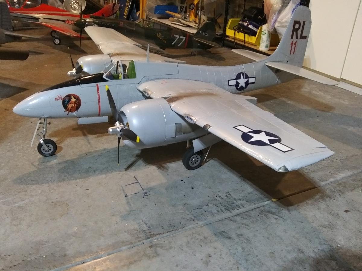

  • A buddy of mine and I got to talking about how good the tigercat would be for fpv. After a couple years of talking about it, I finally made it happen
    • It's about my best FPV platform.
      • I 100% agree

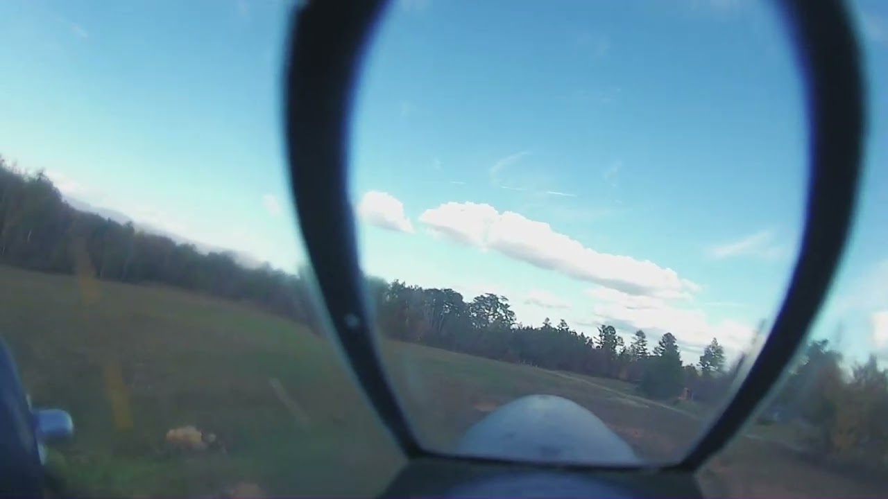

                  This is one of the best quality cockpit videos I have seen, especially from the perspective of the prop blades spinning. These look very realistic. On other videos there is a bad distortion of the blades somehow giving some really funky looking images of the blades spinning. I'm not sure why some videos do that, but in this one, thankfully, it was not present.
                  Good job!
                  Davegee
                  • His blades stay in a blur when you pause where mine don't so they look a bit odd as you say.
                    TigerCat 1st HD 11Mar2021
                      Yes, that's what I'm talking about. Is it due to a different frame rate of the cameras, or something?

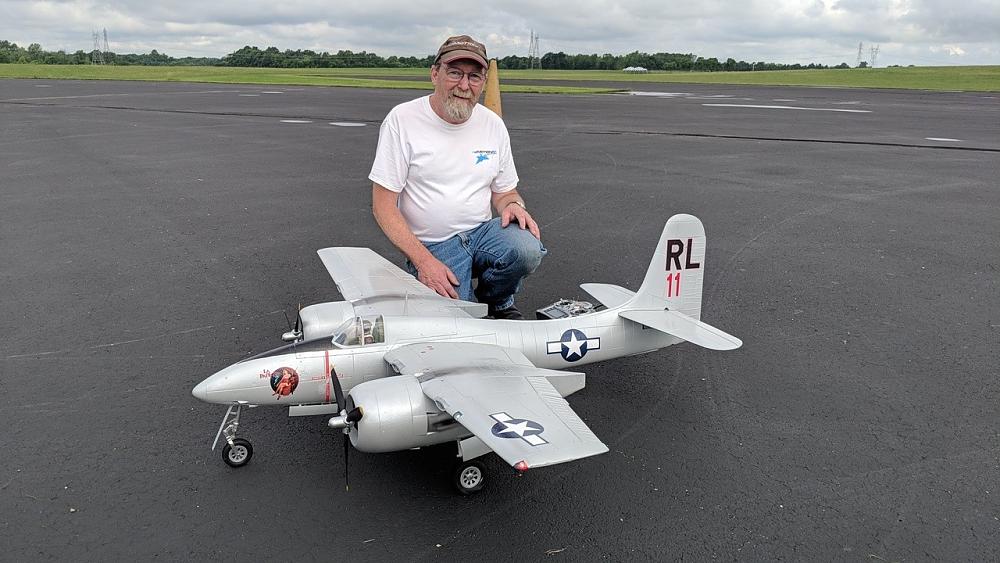

                      Is that your field, Evan? Looks first rate, very nice! Where is it located? Just curious.
                      Thanks
                      Davegee
                      • Huntersville, just north of Charlotte.
                          Thanks. Beautiful country down there!

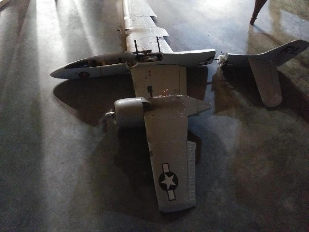

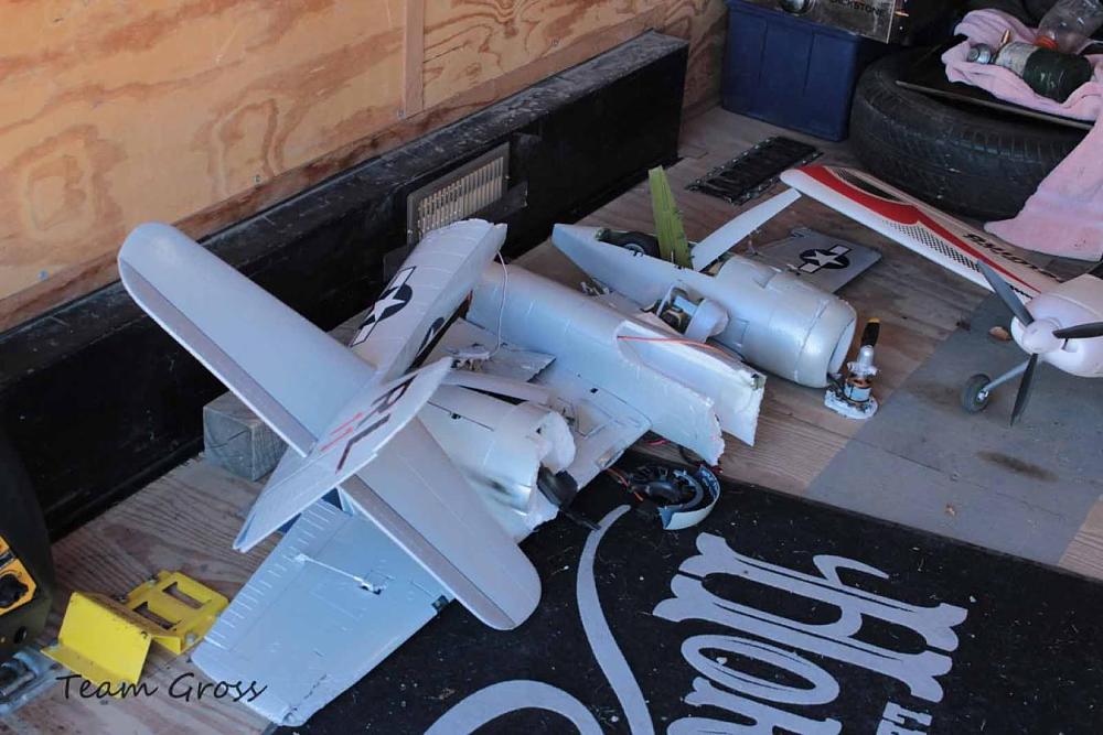

                            • Rebuilding my Tigercat and so far so good. Will post some pics soon, need to find main gear doors if anyone has some for sale, let me know. Most damage is scuff marks but the wings took the brunt of it, although I think they can be salvaged, time will tell.
                              Call me crazy but I just can't give up on this bird!

                              • Don't tell me it can't be done!

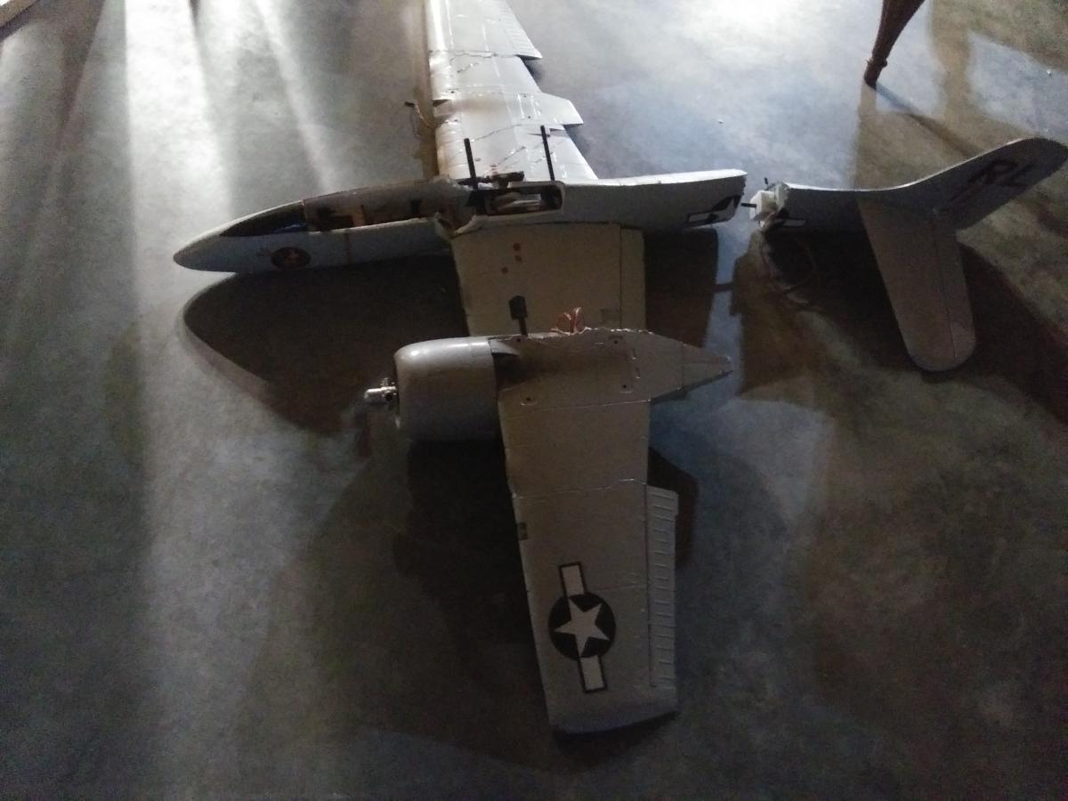

                                I started with this mess, just to convince myself she was really irreparable.

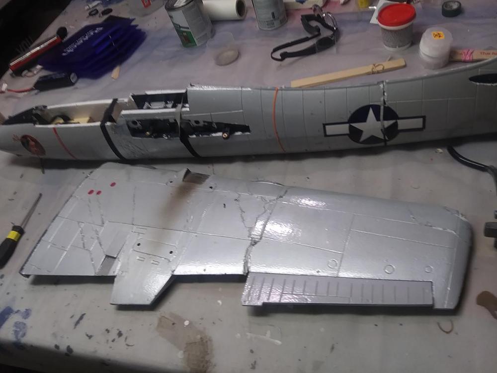

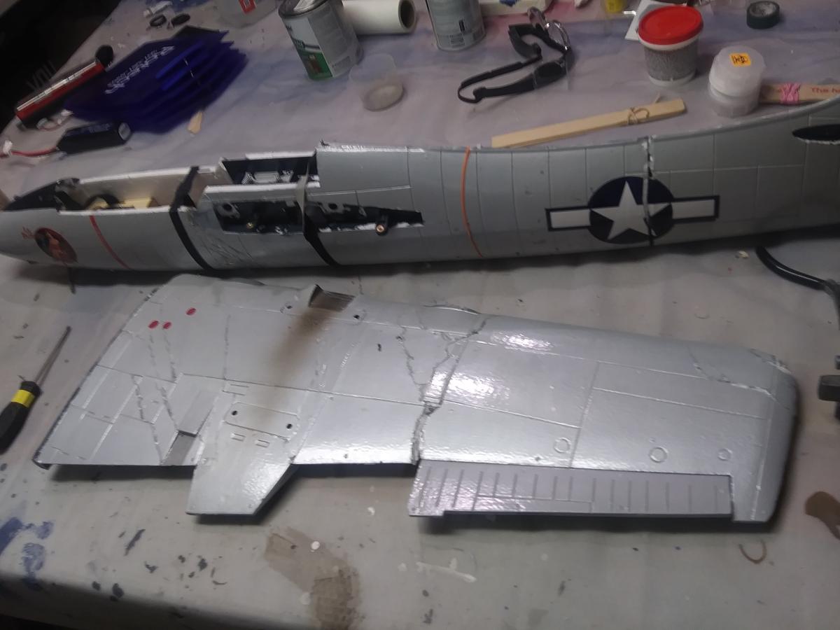

                                So, I disassembled the sad remains and found that most of the damage, short of broken off pieces was cosmetic. Fortunately, I had a big garbage bag on hand when she augured in and so I got all the pieces that I could find and brought them home. Both wings suffered breakage which I've repaired and am just waiting for some FoamTac to reinstall the flaps. Some broken hinges came off a totaled Bearcat as well as one flap servo. Sanding and filling, sanding and filling....

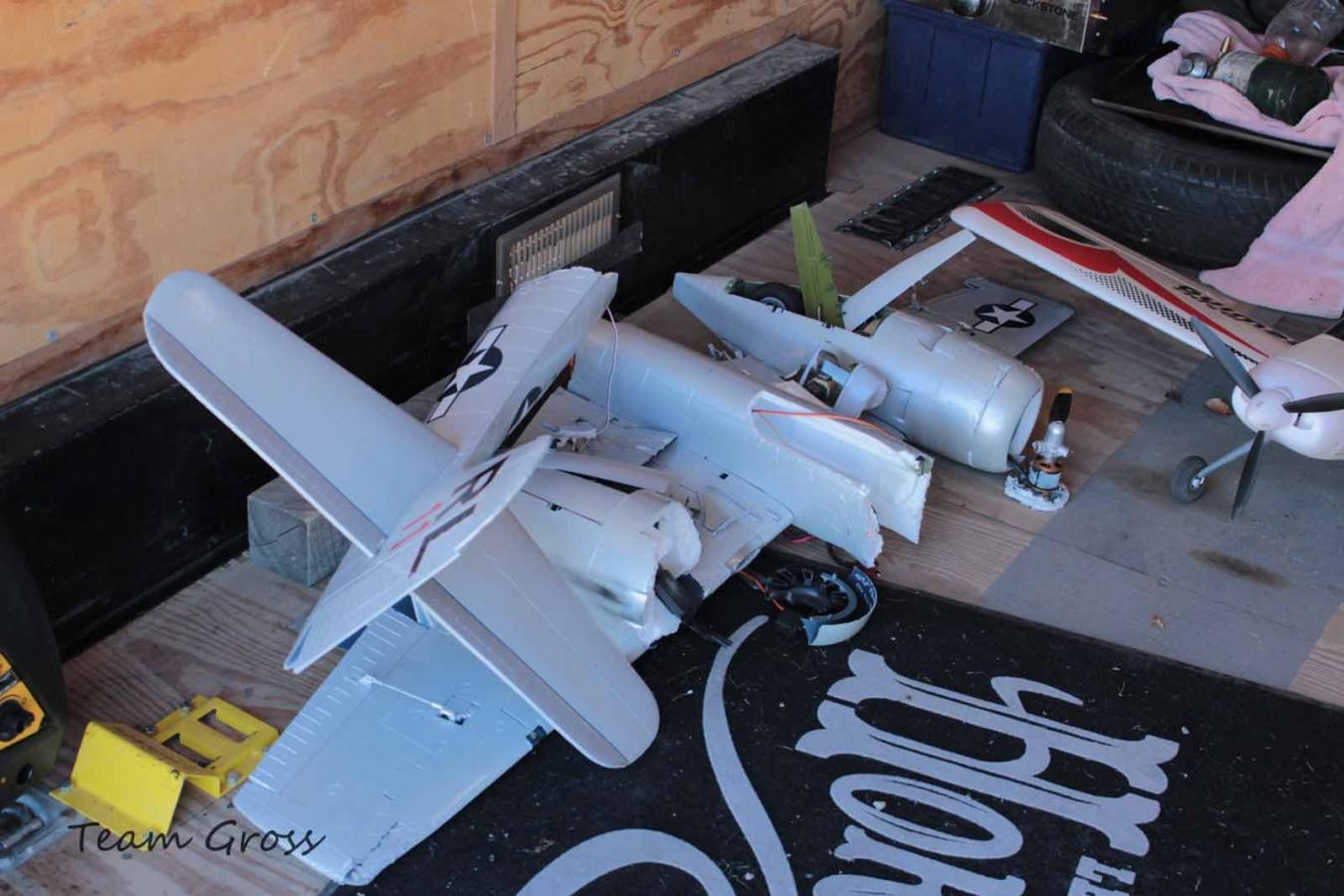

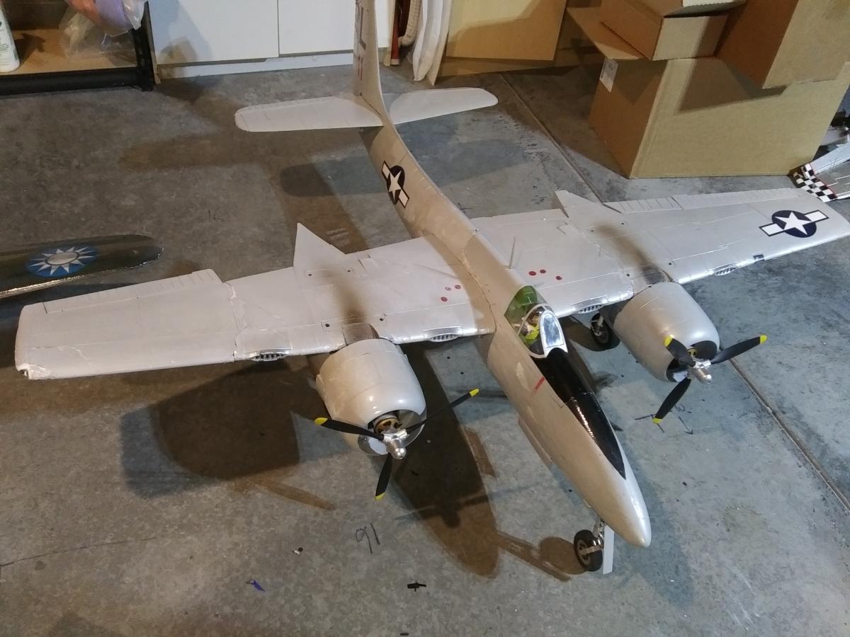

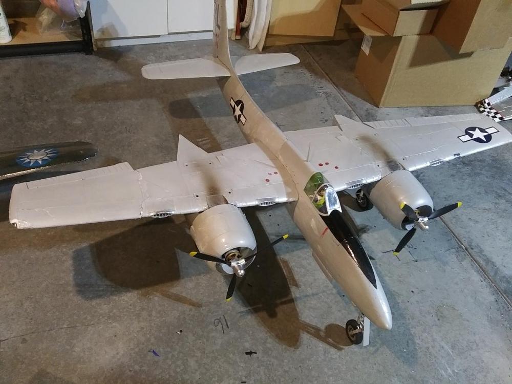

                                I did a trial assembly to get an idea of what I was looking at, and it doesn't look too bad in all honesty.

                                A lot more work to be done, I have a complete new horizontal stab coming as the Carbon Fiber rod is snapped in the original and tis glued in. I'll check out Ace Hardware to see if I can find new nacelle attachment bolts as these ones are getting up there and the heads aren't in the greatest shape. The battery hatch survive with no damage as well as the gear as it was retracted when she went in. Good news, the motors survived as did the B25 prop mounts, yeah, I know both props are the same, I correct that later. I found one right side main gear door which give me three good doors and one to hopefully modify to work again.
                                She's a way from being airworthy, but hey, winters upon us again and I guy has to have something to do!!

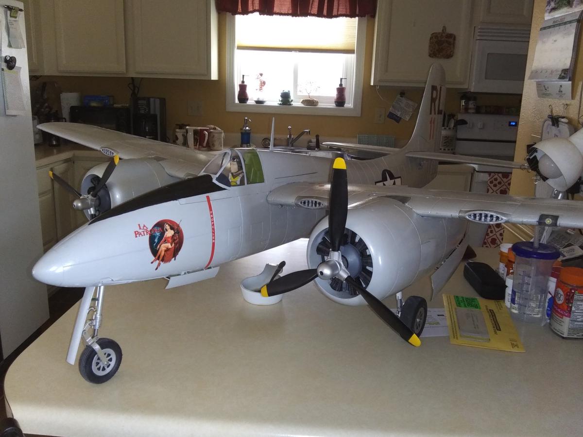

                                    • Thanks guys, a long way to go yet, I discovered a crack in one of the sides of a nacelle which is being worked on. One of the reasons why I tried assembling the parts again, screws aren't lining up quite right. That may be part of the problem.

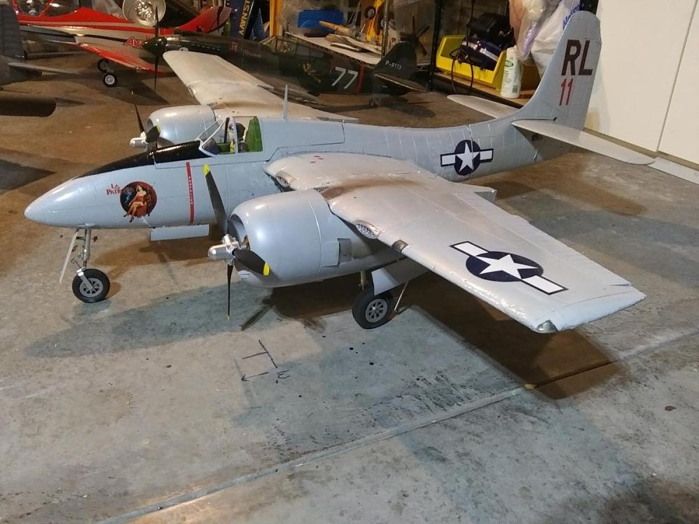

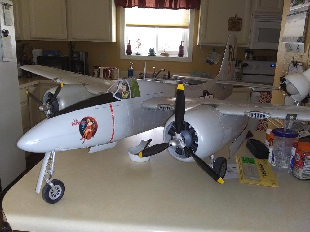

                                      8 years old and one of my favorite airplanes, here's a couple of my favorite pics with her.
                                      At NEFI in Muncie:
                                      And at the Powel Wings and Wheels event:
Name:	flightline-f7f-3-tigercat-1600mm-63-wingspan-pnp-motion-rc-3995825242225_1024x1024.jpg

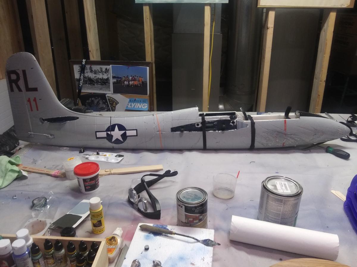

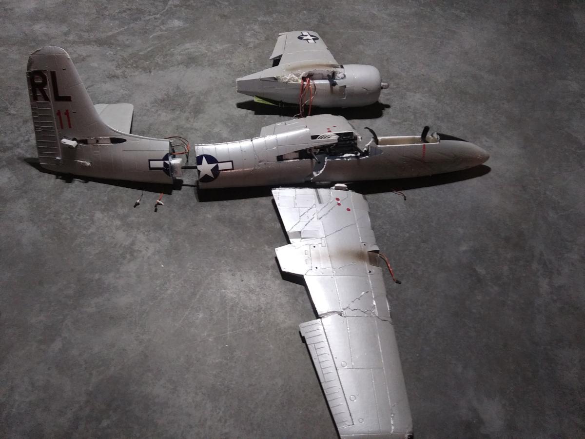

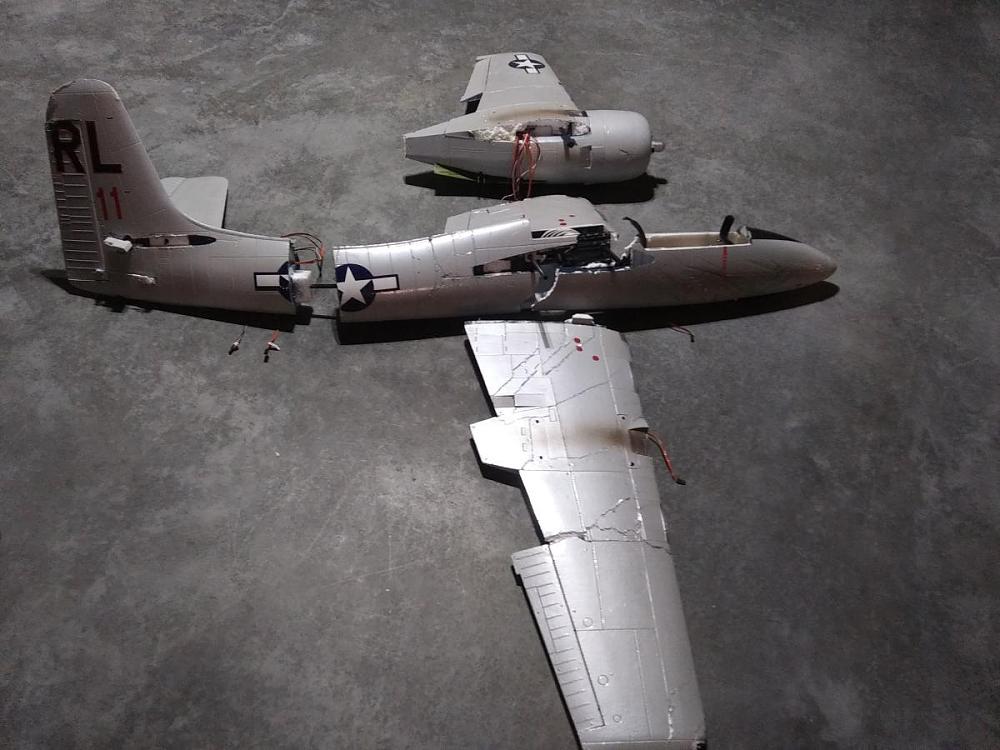

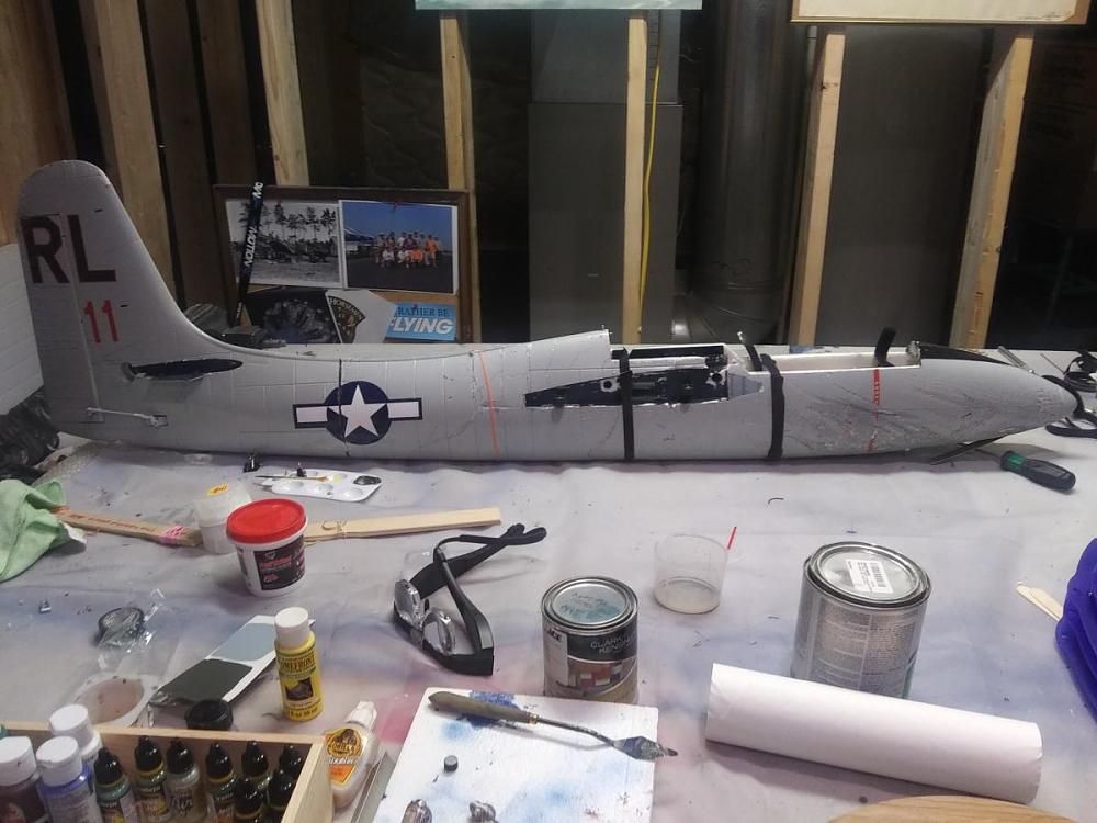

                                        • Priming sanding filling, you know how it goes.
                                          I had an accident with her a couple of years back and spent a lot of time repairing her then.
                                          To... Click image for larger version
                                          And now she's going through her second rebuild
                                          I was flying patterns and decided to roll her. Whoops, lawn darted to the mess you see at the top of this thread.
                                          Today, I solved the problem of the main gear door that had broken its top rear pin off. I drilled a pilot hole in the arm and inserted a self tapping screw of the same diameter as the late pin and then cut the head off the screw. With a little playing around, it made a great substitute for the plastic pin.
                                          So far so good, the Krylon Foam Primer arrived today from DK Hardware. Bought two cans as it seems to be getting hard to find. This company was very good to deal with and with a great response time.
                                          The crack in the nacelle that was allowing the forward end to droop slightly is repaired. I'm using the new Gorilla Glue that is like E 6000 and I like it. I carved out the crack and filled it with glue, then threaded a self tapping screw from one side of the crack to the other and sunk it into the foam, did a great job holding everything in place and I'll probably leave it in for added strength.
