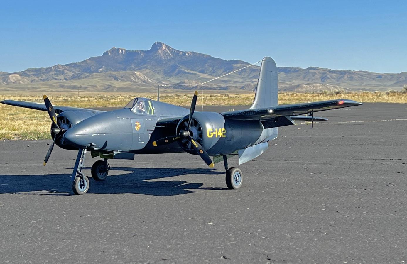

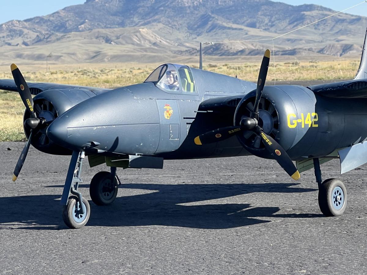

                                  • Got my Tigercat back up into the air this morning. Had to replace the prop hubs as a part inside on each one had cracked material and wouldn't cinch down properly on the motor shaft to fly safely.
                                    Stock build, pretty much. Did add some antenna wiring, but otherwise pretty much as I put it together out of the box a few years ago. Don't fly it much these days, but it is always in the "rotation" with the other planes to go up and do its thing. Really enjoy this plane.
                                    davegee

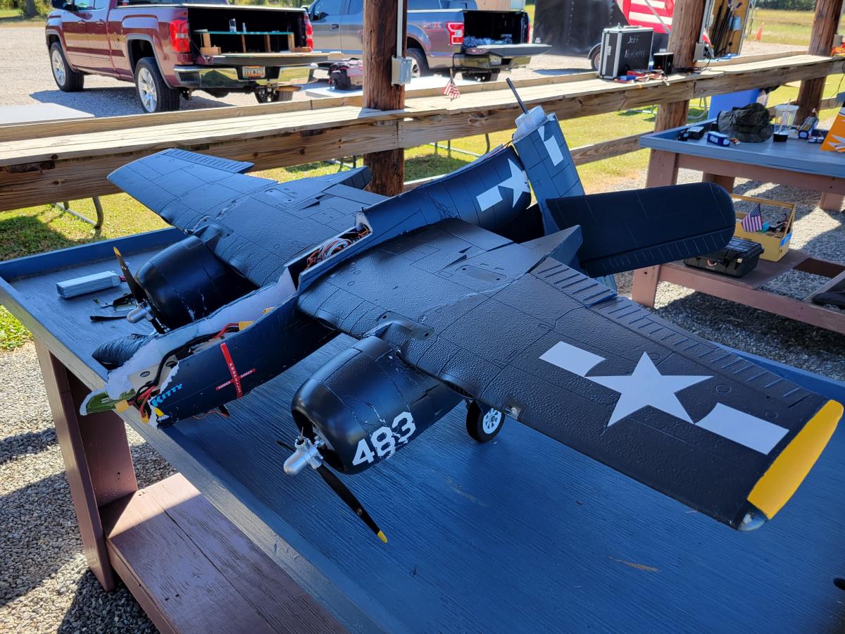

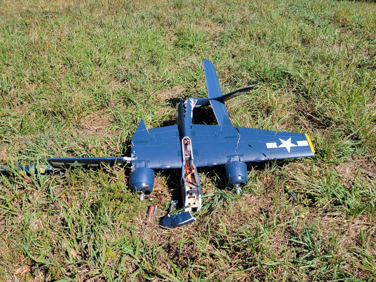

                                      • Well Damn!! It happened again last week. Perfect take off with a nice shallow climbing left turn on crosswind and the left wing dropped suddenly, and I lost a lot of power. I immediately corrected to the right but had no choice but to go left to avoid trees and try to get it back on the runway. As I turned back left, it rolled in! When I got it back on the bench, everything was still connected even though both wings were cracked, and the fuselage nose was pretty crunched. I put the battery back in and all the flight controls worked fine. When I spooled up the motors after removing the props, that's when I discovered the issue. The left motor thew a magnet and obviously took a big duce while climbing out on crosswind!! I happened so quick and dropping fast right toward the trees I didn't have time to think of what was going wrong at the time. Others at the field who were watching also started it looked as though the left motor had an issue.
                                        Ordered a new fuselage, motor, props, hubs, and nose gear door and already got the wings and nacelles back together but will have to respray everything all over again.... Arrrrrgh!
