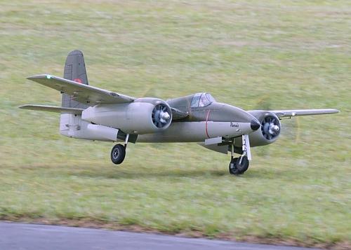

  • Here's a couple of pictures of a Tigercat that I saw in Idaho last year. I was kind of smitten by the kitten to say the least. I think I may go with new motors, master airscrew props with spinners like this bird has. I can avoid all of the hub issues and power up the speed however much I think I want to that way and it will still look fabulous and run smoothly. Mine should get here later this week and I'll try out the stock setup to see what I think. Check out the prop ground clearance on that thing.

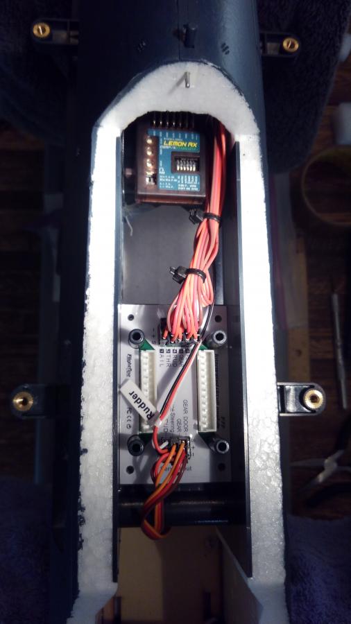

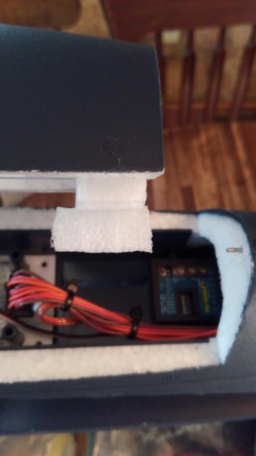

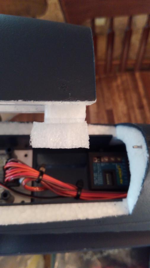

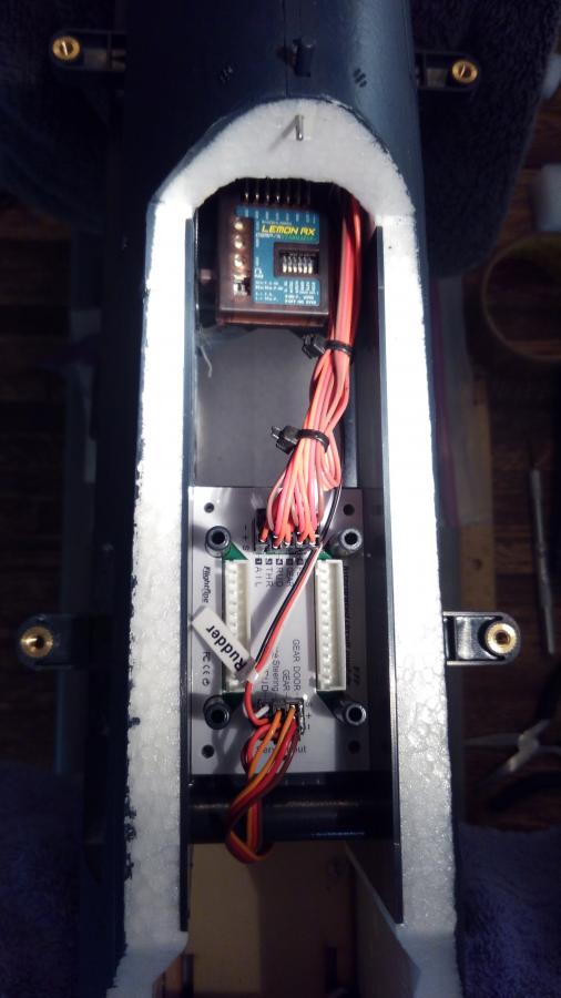

    • Here's how I installed my receiver. I turned the fuselage module around so the wiring could reach the rear of the receiver. It's a receiver that has to be mounted facing the front of the aircraft so the wires have to go around to the rear of it. I stuck the receiver down on the sticky pad it came with and then I added a piece of some squishy foam onto the bottom of the rear of the canopy that will lightly press down onto the receiver to keep it more secure. I wasn't comfortable relying on just the sticky pad to hold down the stabilizing receiver. The receiver is mounted just far enough forward to allow access for making adjustments to gains, and one of the antennas can point down vertically to the bottom of the plane and the other one points horizontally to the rear of the plane. Looks like it's going to work pretty good.
