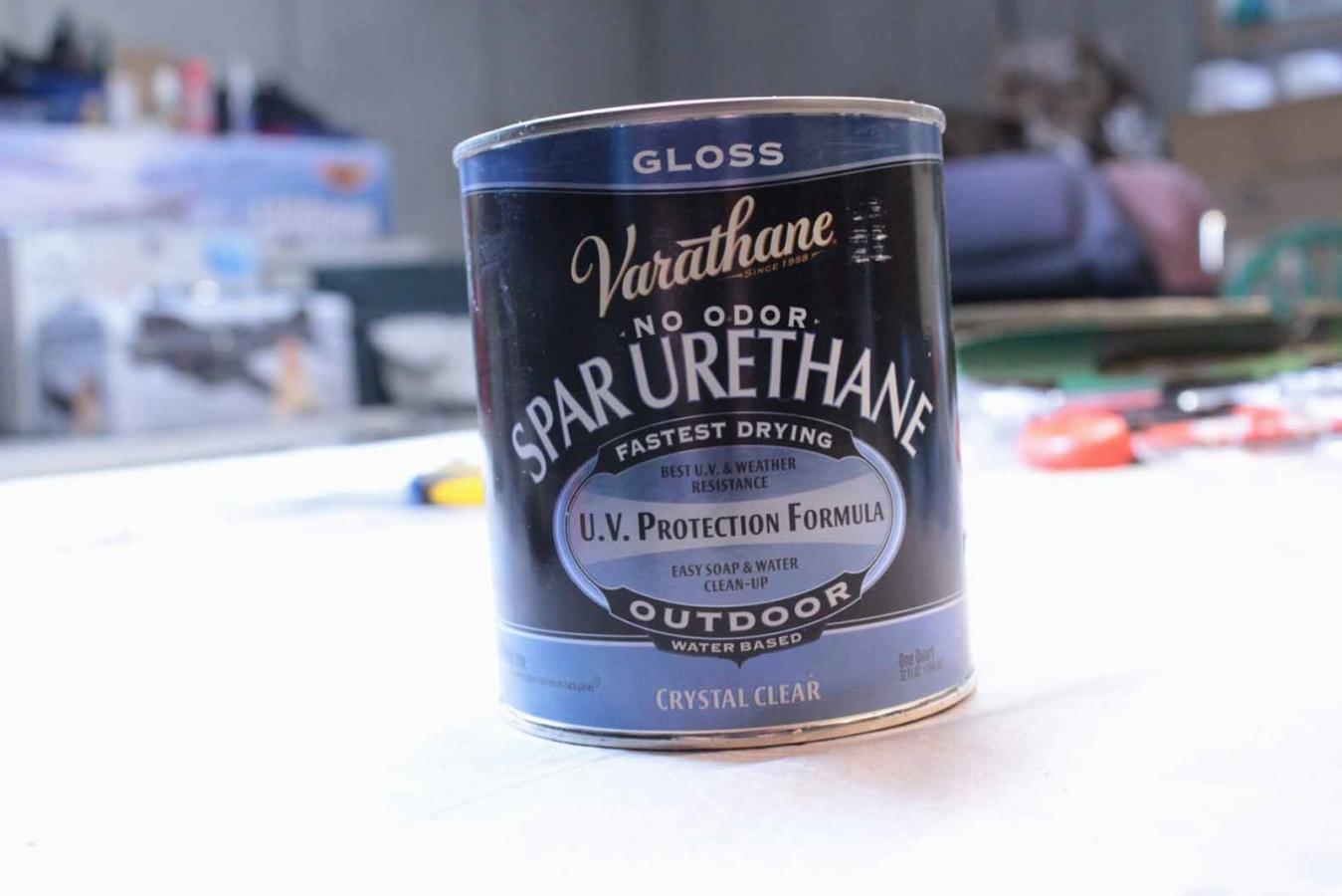

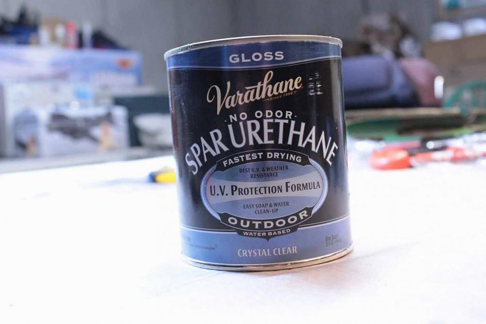

      Peel the back of the decal, the clear side off first, then line up the decal, then rub the upper surface, the paper material to stick the decal on, then carefully remove the upper/paper surface.
      To ensure that mine are going to stay on the bird, I coat my planes with water based Varathane. Click image for larger version

      I should start charging the company for all the times I've posted this pic.
      Yes, water based Minwax will give you the same results, just try to find a product that will give you some UV protectant. Remember to keep any dark colored plane out of the sun when not in the air .
