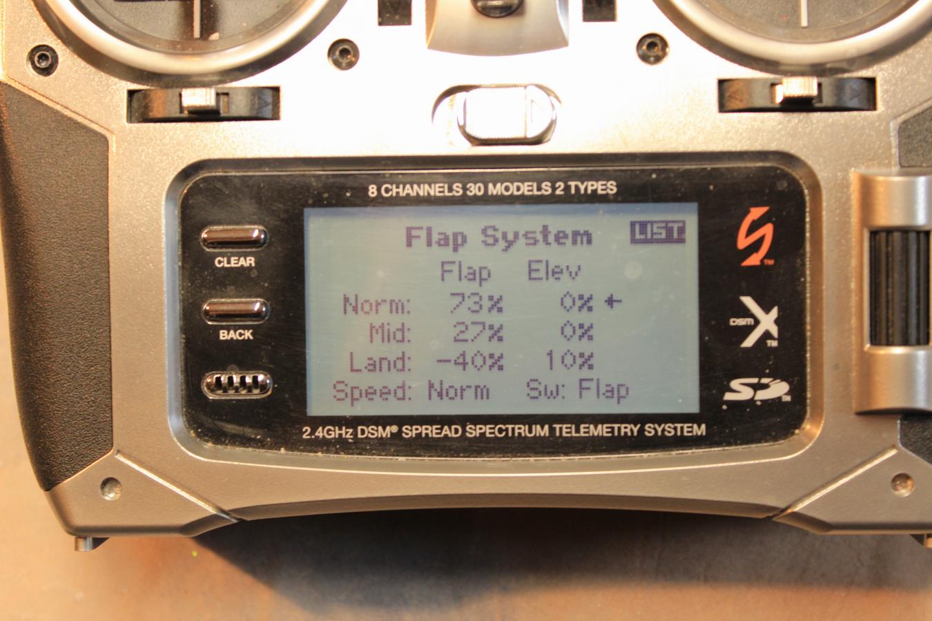

            I got everything set up according to the manual but the down mix on the flap settings looks like too much down on the elevator. You guys that have flown this for a while what kind of mix are you using.
              #1166
              2mm down at half flaps, 4mm down at full. Works perfect.
                • 7387
                #1167
                Nothing on half flaps and 4 mm on full. Because of the delay on the gear when it extends, drop the gear first, once its down, drop the flaps. It's not a huge thing, but it looks more scale. Trial and error. Find a starting point and add to it. I had way too much at first so rolled everything back to no mix. I found that half flaps didn't need anything, and full needed a bit so I added some in, in small increments.

                  #1168
                  That's exactly what I had set up so I'll go with that to start with then change if necessary.
