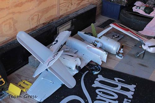

    Rushed home today because, well, today is Tigercat Day!!
    Sure as heck, she was there waiting for me!!

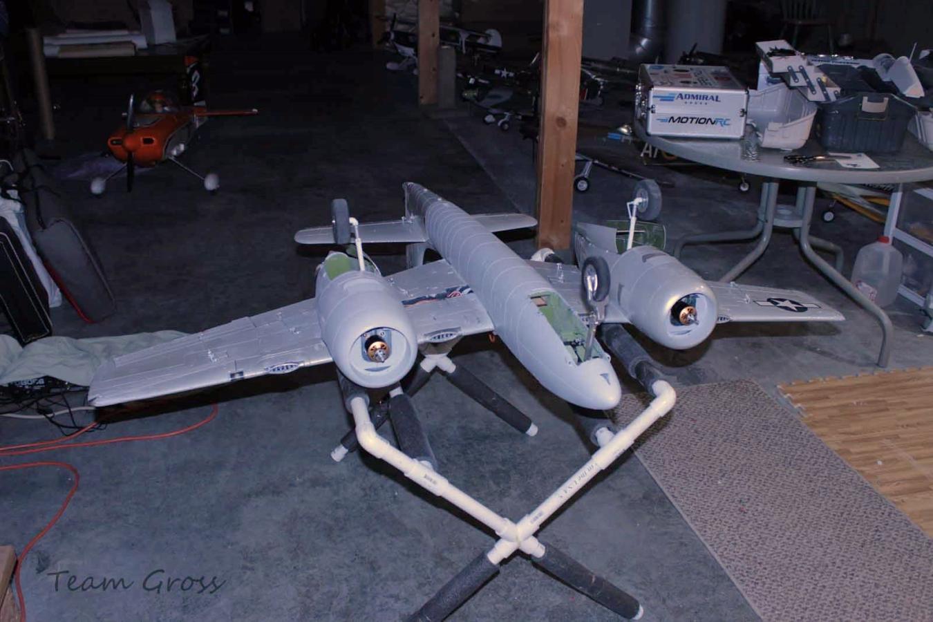

    So, not to bore you with Grossman enthusiasm, let's skip to the finished product!!
ID:	72233Click image for larger version
    Note the difference between the Bearcat and the Tigercat colors? That's the same color, just with a few coats of Spar Varathane, incredible difference.
    Anyway, take a good look 'cause she won't be that color for long. I assembled it and made sure everything was functioning. This weekend, I'll remove the wings and start the paint job.
    First impressions, this thing is BIG!!

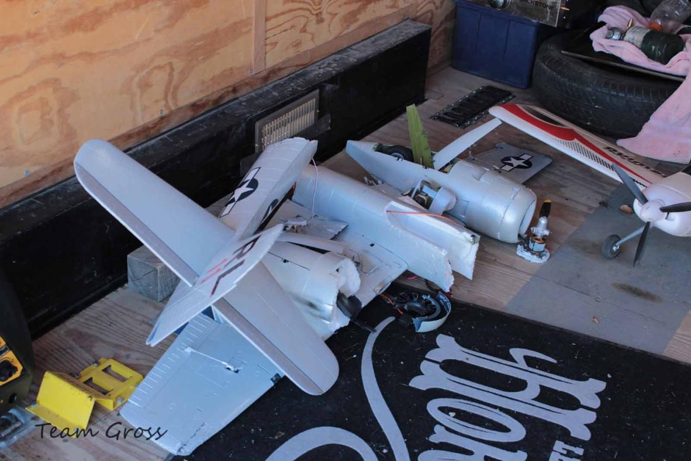

      Yay!! I finally have the second prop shaft on order. My big question, when the B25 came out, was whether the prop shaft was compatible with the Tigercat motors and more importantly, with the780 kv motors that I want to reinstall. The props on the B25 are more robust than the stock Tigercat and since I'm convinced it was a prop blade that let go and put her in the ground...
      Now that I have her rebuilt and have flown her with the stock motors, they just don't cut it at 5,000 feet.

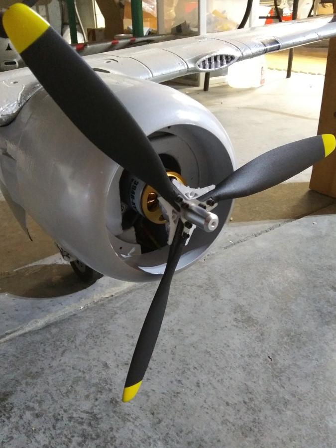

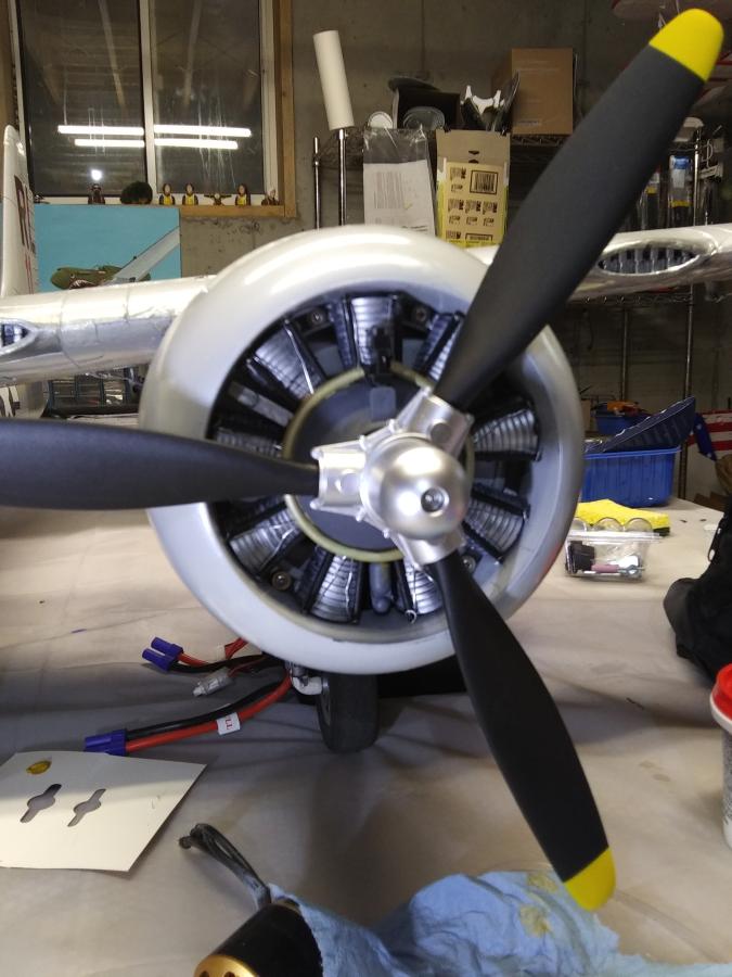

        Everything came in stock so I ordered one more motor shaft, two sets of props and two spinners. A much better system of locking the props onto the prop shaft! I also reinstalled the 3948 kv760 motors. I ordered one in from Porcupine Hobbies (Hong Kong). Turns out its a Predator make and as I would prefer two of the same motors on the airplane (duh) I pulled the 760 out of my Bearcat and put it on the Tigercat. The Bearcat got the Predator motor, so she's happy! I refined my method of drilling the new holes for the motor mounts as well. Used the same centering device, carefully lined it up to what I considered the best position and drilled the two bottom holes. I then pulled the centering device (which is anything that will nicely fit in the hole of the nacelle)
        and enlarged the two holes slightly, then screwed the motor mount to the nacelle. This gave me a definite pattern for drilling the two upper holes. Removed the motor mount and reinstalled it on the motor, using Gorilla Glue to ensure the dang thing stays tight! GG has this great product for doing detail work, it's excellent. I also put shims on the back of the motor mount on the two lower arms to vertically increase the angle of the motor as she looked like she flew nose high in the last flights, again GG comes in handy to hold those pesky shims on. All said and done, everything went smooth as butter. Prop clearance is great and it retains the stock appearance only now I'll have the old power back. From stock 600's to 760's made all the difference. Now she moves out like a racer/fighter, even at 5000 feet.
        This is a fairly cheap mod for your Tigercat and a much better way of mounting props, sure beats that one tiny screw holding the whole thing on. Now, all the screw does is hold the front half of the spinner in place.

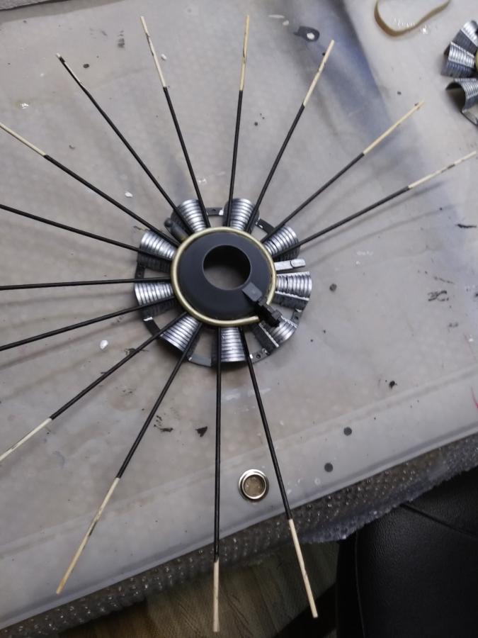

          Mods to the Tigercat
ID:	402866 Click image for larger version

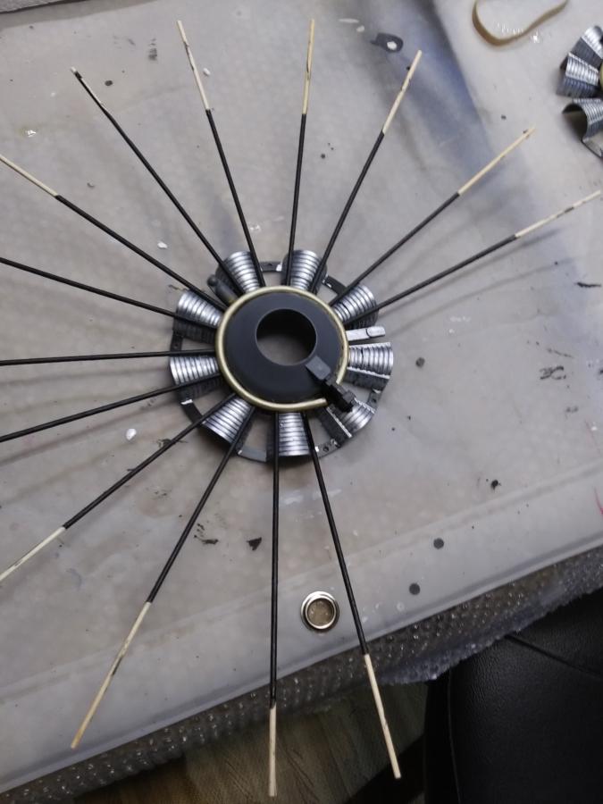

          The motors getting modded. Pushrods on the cylinders, letting the glue dry.

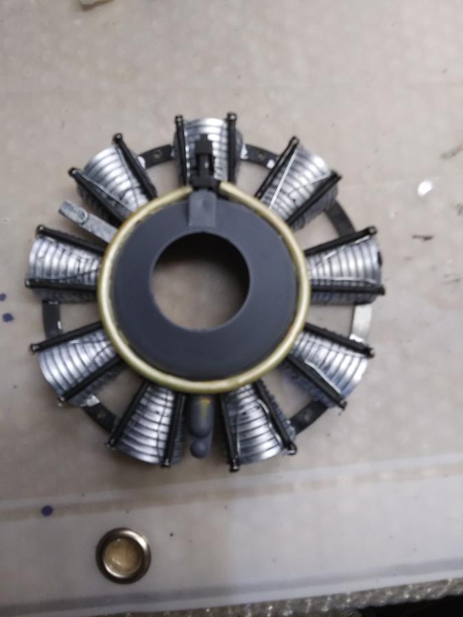

              Thanks Elbe, here's the finished product...
              And here it is installed
              The wire is packing slip wire I collected over the years, the ring is tubing interveineous days. and the pushrods a small wooden dowlings. Stuff you see laying around that usually ends up in the garbage but does great detail work.

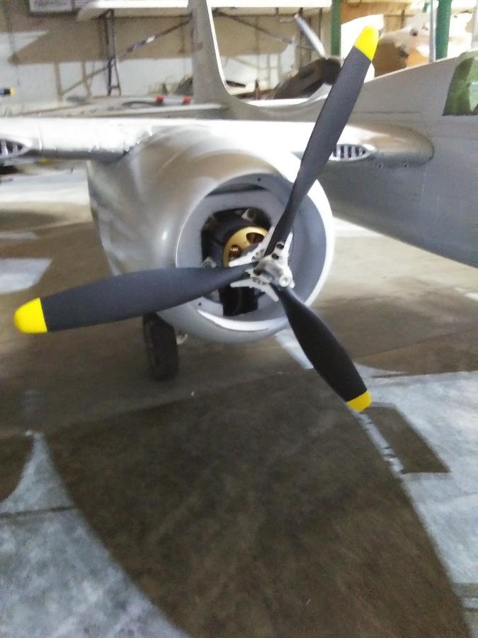

                    Had the Tigercat out at the field today, first flight on the upgraded motor and B25 prop system.
                    She SCREAMS
                    The method of attaching the prop to the prop shaft is so superior to the stock method, well worth the investment. The item numbers on the props are one number off, so I check and sure enough the blades are the same as the stock ones, it's just the hardware that's different. Good news all around.

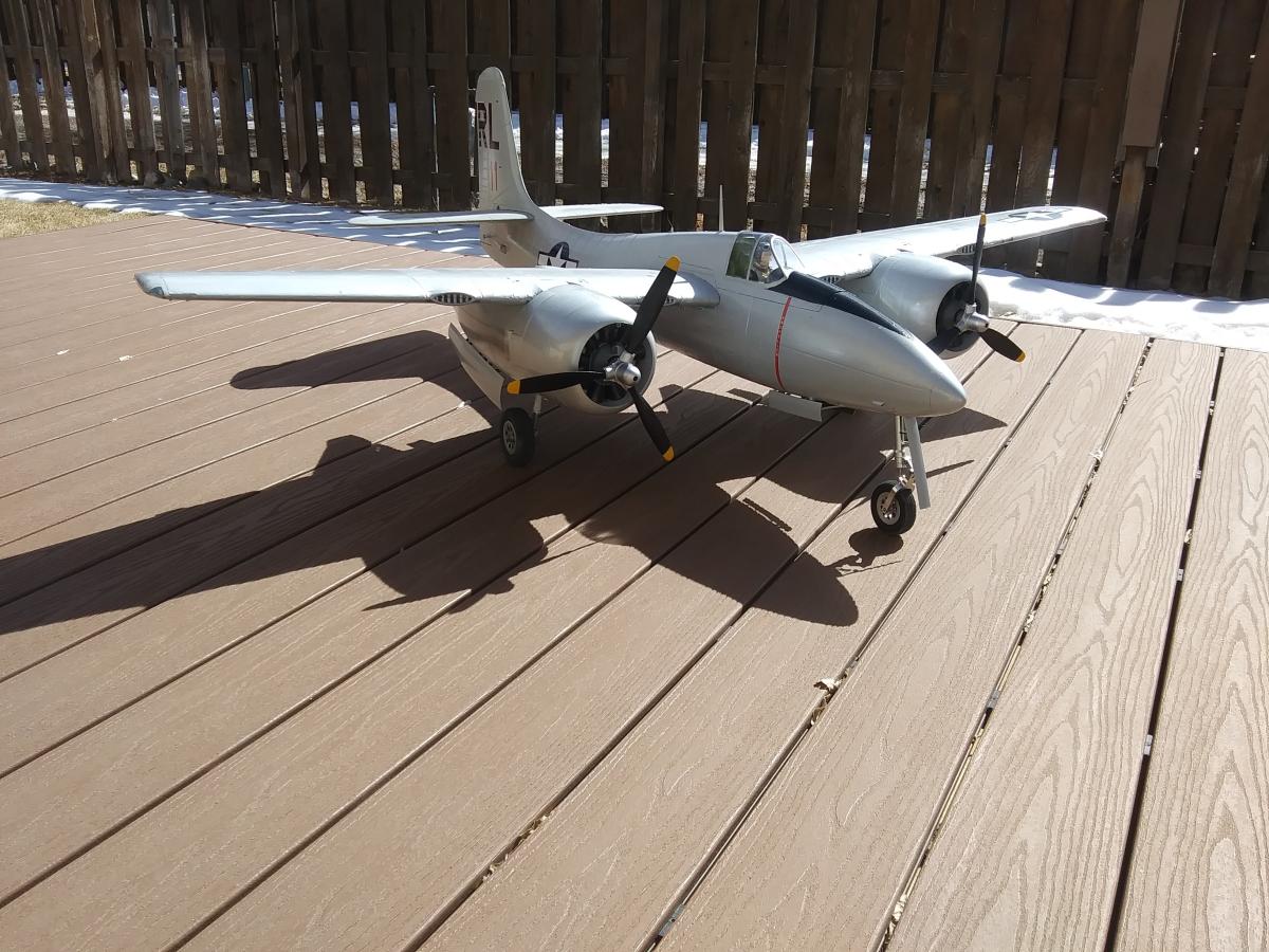

                                          I guess I have a hybrid, my nose gear is the upgraded, but the mains are stock. I recently replaced one retract mechanism and when I tried to install the strut, the hole was too small, it felt like a typical 'bur' or something and I fully expected it to finally drive home. No such luck. Now its in so tight I can't get it out, but the good news is that it works fine, I figured a couple of landings would knock it into place but so far, no such luck, that's how tight it is. Now, I have a set of upgraded main struts but I had trouble with the set screws always backing off, so I went back to the stock struts. I've doctored the upgraded struts so that now I wouldn't mind trying them again, but I'd have to replace that retract again, which is just a p.i.t.a. so she's staying the way she is. Frankly, I've flown it for over 90% of her life with the configuration I have now and I'm fine with it.
