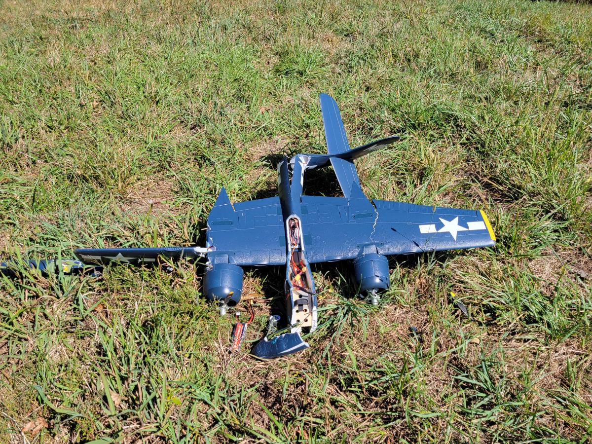

            • Originally posted by Denniswpb View Post
              Well Damn!! It happened again last week. Perfect take off with a nice shallow climbing left turn on crosswind and the left wing dropped suddenly, and I lost a lot of power. I immediately corrected to the right but had no choice but to go left to avoid trees and try to get it back on the runway. As I turned back left, it rolled in! When I got it back on the bench, everything was still connected even though both wings were cracked, and the fuselage nose was pretty crunched. I put the battery back in and all the flight controls worked fine. When I spooled up the motors after removing the props, that's when I discovered the issue. The left motor thew a magnet and obviously took a big duce while climbing out on crosswind!! I happened so quick and dropping fast right toward the trees I didn't have time to think of what was going wrong at the time. Others at the field who were watching also started it looked as though the left motor had an issue.
              Ordered a new fuselage, motor, props, hubs, and nose gear door and already got the wings and nacelles back together but will have to respray everything all over again.... Arrrrrgh!
              Man that sucks! Sounds like mine. Something let go, i think it might have been the prop or the motor mount, but she went into self-destruct mode after a nice take off and turn. The result being, well, not very nice. The good thing about it is that I've managed to salvage and repair everything except one nacelle and the forward fuse. (new props of course) so it wasn't as bad as it looked at first. She'll be back in service for the next season.

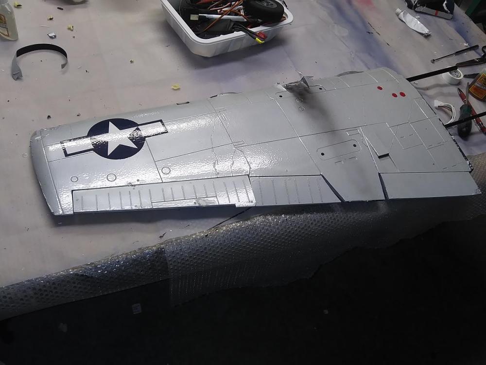

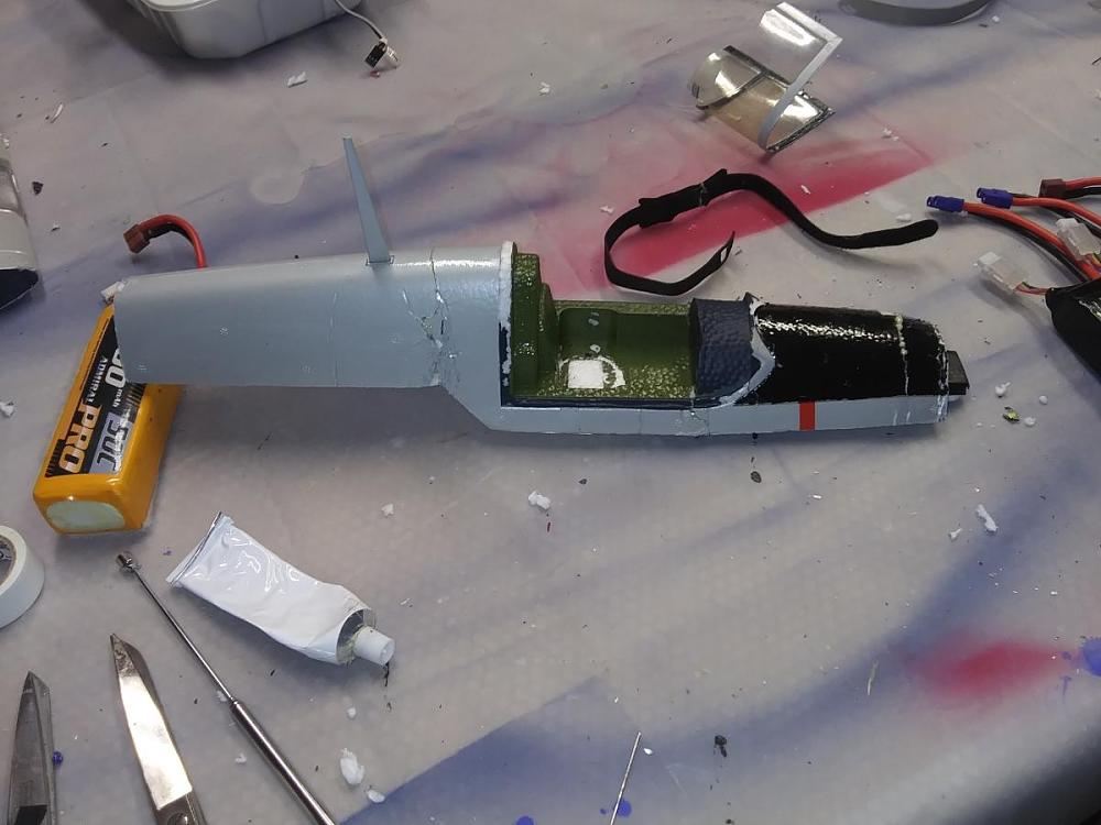

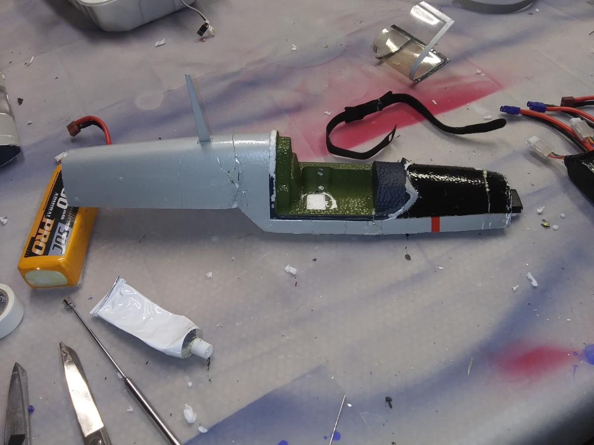

              • I got her back together and ready to fly again. I just need to go through everything and do a good run up and power check before flight. I bought a new fuselage, props, and a new left motor. Everything else, I was able to salvage and rebuild.. I then spray painted everything and clear coated it.
                Click image for larger version  Name:	Rebuilt Tigercat.jpg Views:	0 Size:	149.9 KB ID:	361585

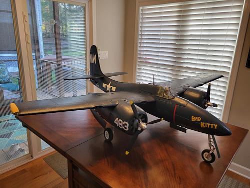

                      • Your Tigercat looks great! I had to put mine back together again, but haven't flown it since the rebuild. I had a left motor go out and had no choice but to turn into it and it didn't end too well. Amazing how fast it started to descend once the motor quit. Try that with the front strut and it will take care of your issue. Inside the strut there is a ridge on top of the pin and on the bottom of the pin. That screw has to travel in between those two ridges, but if you tighten too much the screw is up against the pin and won't allow it to travel. Hope that helps!

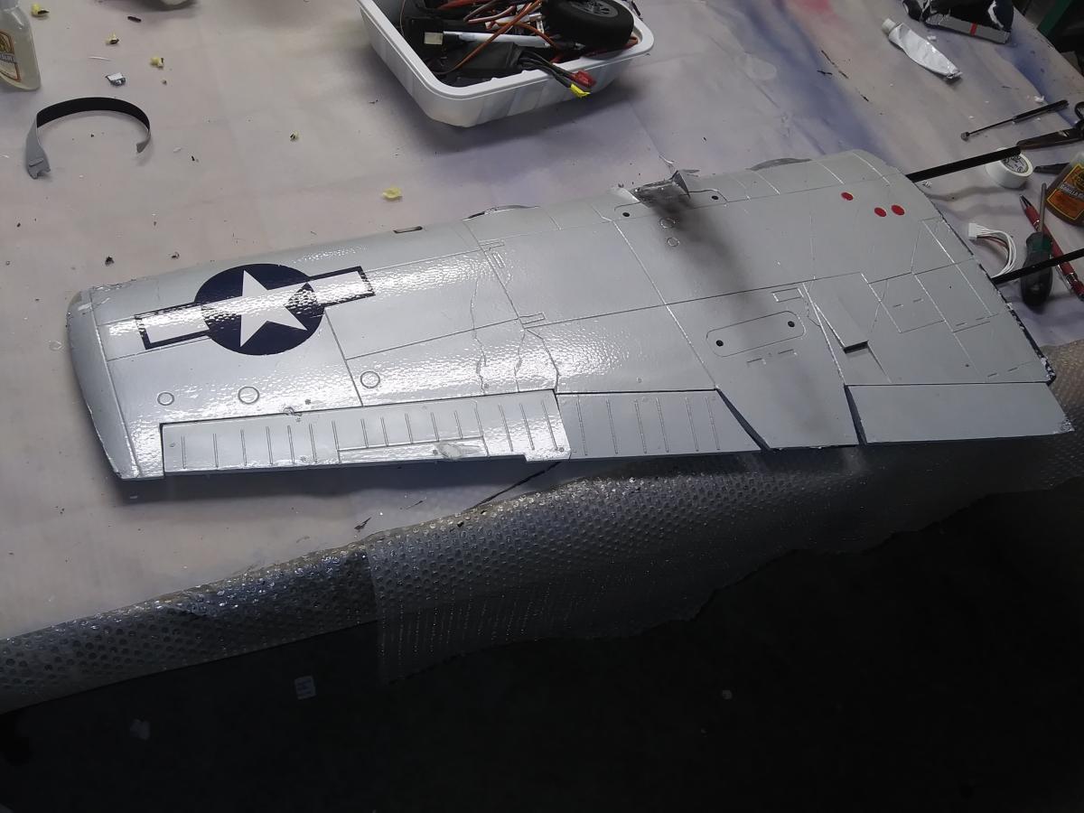

                        • Thanks Dennis, now that I have this info, I'm going to get into this weekend and get her fixed before the parts get here. I'm just hoping that the paint matches the old parts as she's seen many a year at the fields from here to Indiana. But at least she'll be airworthy again. When she piled in it was an absolute mess, I thought she was a total write off, but I managed to fix the wings and surprisingly, the carbon fiber rods were intact, it was just a matter of gluing them back together. I had a spare nacelle and the tail section came off the wrecked fuselage fairly easily, I just kept cutting away foam until I could see the glued joint then trimmed. I think either a motor mount let go or a prop, she chewed the fuse to junk and both nacelles were destroyed. It wasn't pretty, but for just under $120, she'll be back to airworthiness. I'll track the rebuild on the forum.
