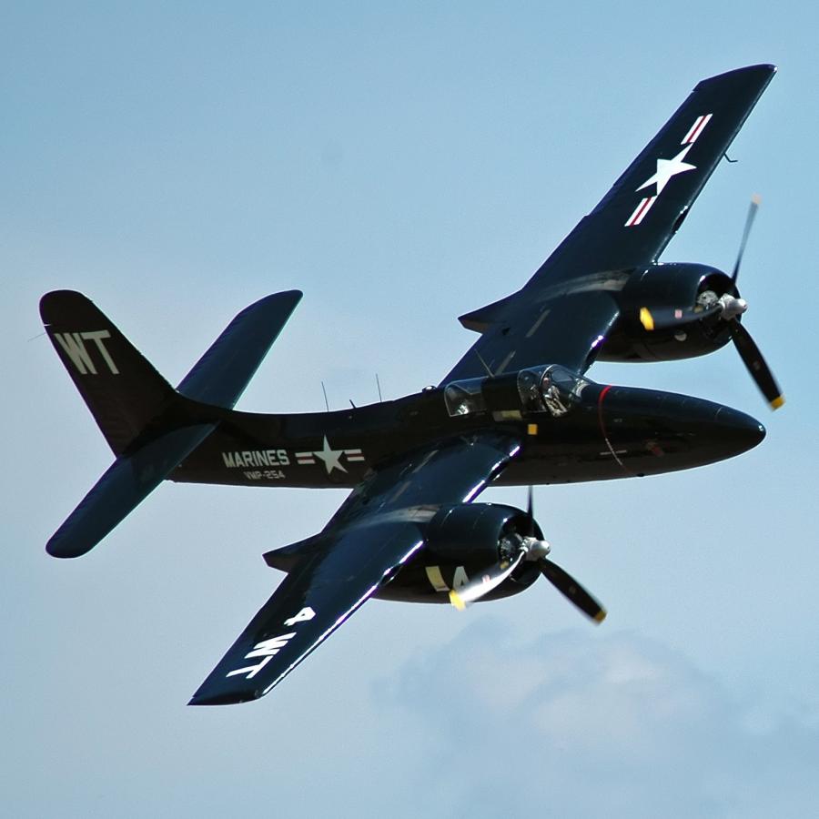

          Has anyone reversed the directions of the motors for the correct top in rotation of the propellers on their Tigercat? The P-38 is correct with outward rotation due to buffeting of the horizontal stabilizer with inward rotation, but you remove the critical engine problem with top inward.
          I know the full size Tigercat doesn't have counter rotating props but this change would add a small safety if we lose a motor or prop. Click image for larger version

              No need for confusion. The FL Tiger comes from the factory with contra rotation. As modelers you can then decide whether ya want top in or out rotation by simply reversing 2 of the 3 leads from the ESC to the motors.
              ​​​​​​To answer Puregreen7 question, this bird flies equally well on any of the 3 prop rotation direction cases of CCW/CW, CW/CCW, CW/CW.
              Most electric twins are set up as inward turning contras for Pfactor stability incase of a motor loss. Yeah contras on the Tiger do not reflect the full size beast whereas both the motors were norm CW rotation and this was to keep maintenance parts the same for both engines unlike the P-38 Lightning which had separate reverse gear box parts for the port engine. Again on the P-38 model, prop rotation is not a aerodynamic factor like it is on the full size.

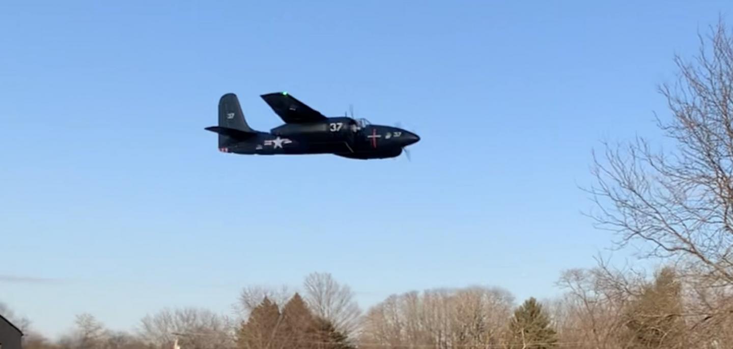

              • Maiden complete, what a great flying warbird! Was a little windy but it handled it great. Some adjustments to be made and I think I will swap the props and change the motor rotation. It just seems weird to have the props turn tip out.
                • Here's the video of mine at our club event several weeks ago. Love this plane and the wheelie landings

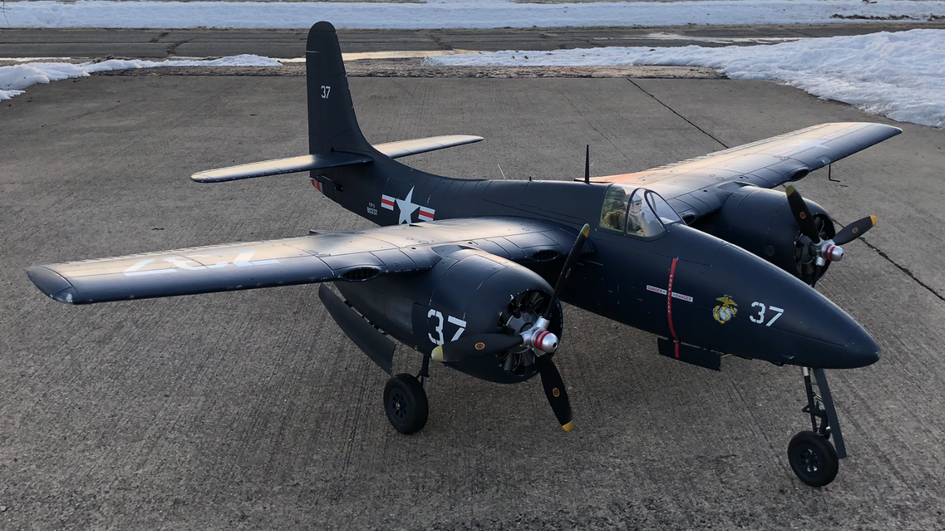

                        • I recently picked up a Tigercat that was in pretty good condition. I decided to remove the existing decals and sand the entire plane down and fill in any minor dings. I then used a HVLP touch up spray gun and resprayed the plane. Put new graphics on it from Callie and then put 3 coats of clear over it.
                          I upgraded landing gear, but man, what a beoch to get the grub screws out of the landing gear retracts!! Here is wat I did to get 4 of the 6 stripped grub screws out: Even heating the grub screws with a soldering iron and using WD-40, they still stripped. I had to take a 1/16" drill bit and drill the down the center of the grub screws then use a 3/32" drill bit and carefully drill down the center again. Next use a #2 screw extractor to back out the remaining shell of the grub screw. Using that process, they then came out easy.
                          • Great job on the restoration Dennis! I recently ran into a grub screw issue on my new P-38 when trying to change out the wheels. Thanks for the "this is what I did", it will help me tremendously. enjoy your "new" Cat. A wonderful aircraft. I have enjoyed mine a lot.
