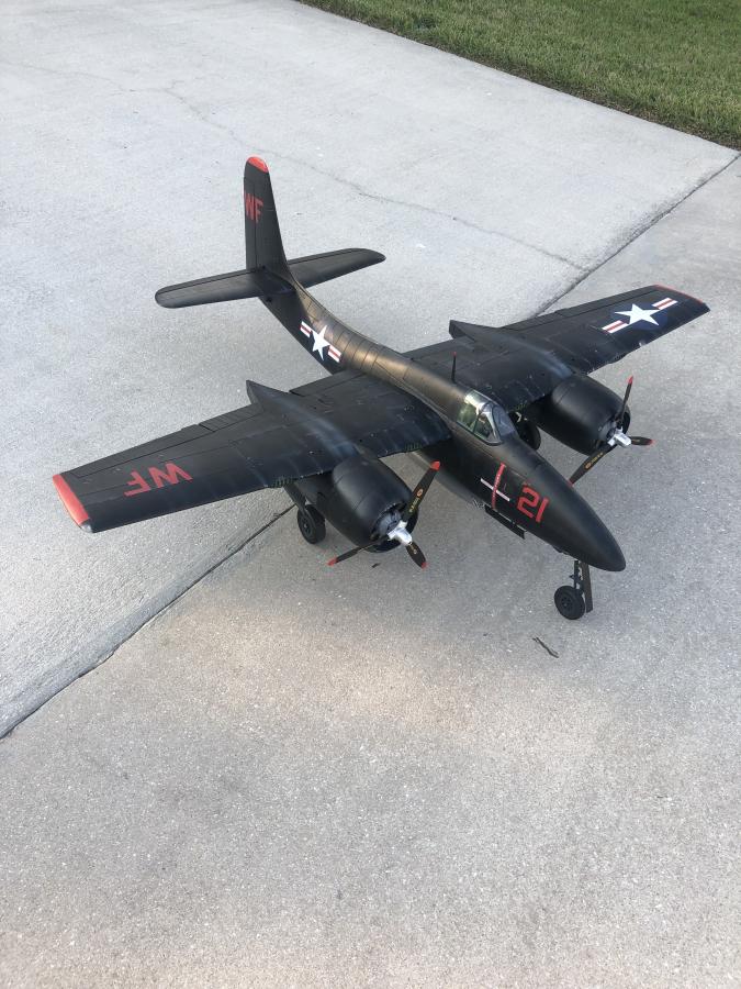

                            #1893
                            Click image for larger version  Name:	939F9E1E-EE2A-4F56-A930-0A315E0BDF4D.jpeg Views:	0 Size:	107.6 KB ID:	189650
                            Maidened the Cat this morning. Some up trim and right trim was all that was needed. I forgot how well this aircraft flies . I’m glad I decided to replace my destroyed “Here Kitty Kitty” (RIP) - #21 is a keeper! :Cool:
                            The Korean War scheme confused some of the guys at the field who asked if ishe was a “Black Widow.” :Whew:
                            I’ll just have to keep an eye on the electrical connections so the same failure that killed the “Kitty” doesn’t occur with #21!
