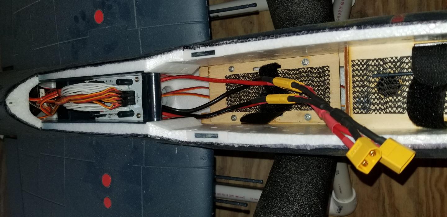

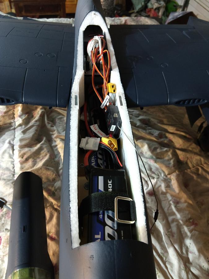

    Where did everyone put their receivers?? I have mine tucked right against the fuse at the lower battery tray it makes it a real pain in the butt to get that lower battery in I'm thinking about moving it.
    See the attached pic..

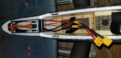

        • Hello sfmadmax,
          I mounted my receiver behind the inside control board Click image for larger version
          A bit of a pain but it's out of the way! :Angry:
          I put all my flap mixes as per the manual and they work just fine for me.
          Hope this helps.:Cool:

            Thanks Dave, I may mount my receiver under the board as I saw this was a likely area when i was initially reviewing the possibility.

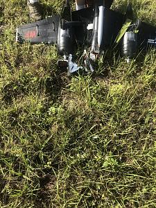

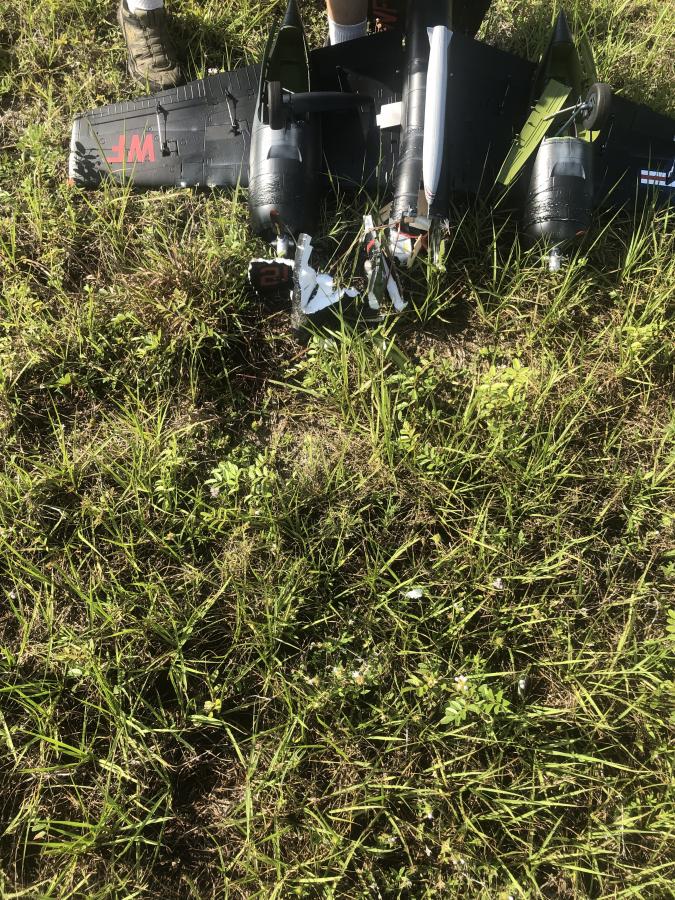

              Second Cat bites the dust because the damn electrical connections come loose AGAIN - elevator went to full up and stayed there - nothing I could do but watch it loop itself into the ground - on the third consecutive loop.
              Time to rebuild for the third time. Will glue the connections in place this time.
              I have to wait for the fuselage to come back in stock however. :Angry:
              :(:Angry:
