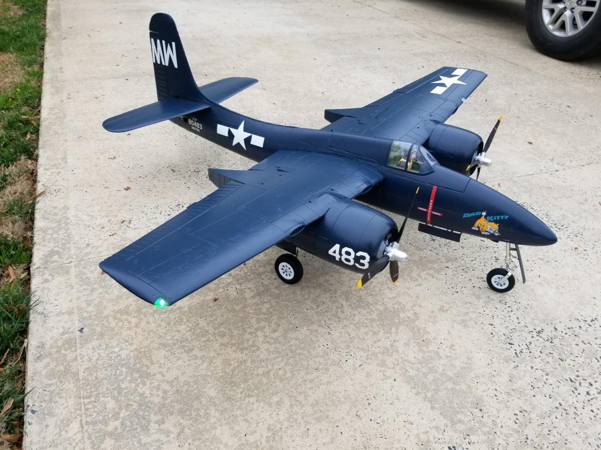

  • I just ordered my first before the price increase. Got it last week. Man, what a gorgeous bird.
    • New F7F fromFlightline. Can't get port side inboard flap to respond correctly. Plug ground is correct but can't coordinate with the other flaps.

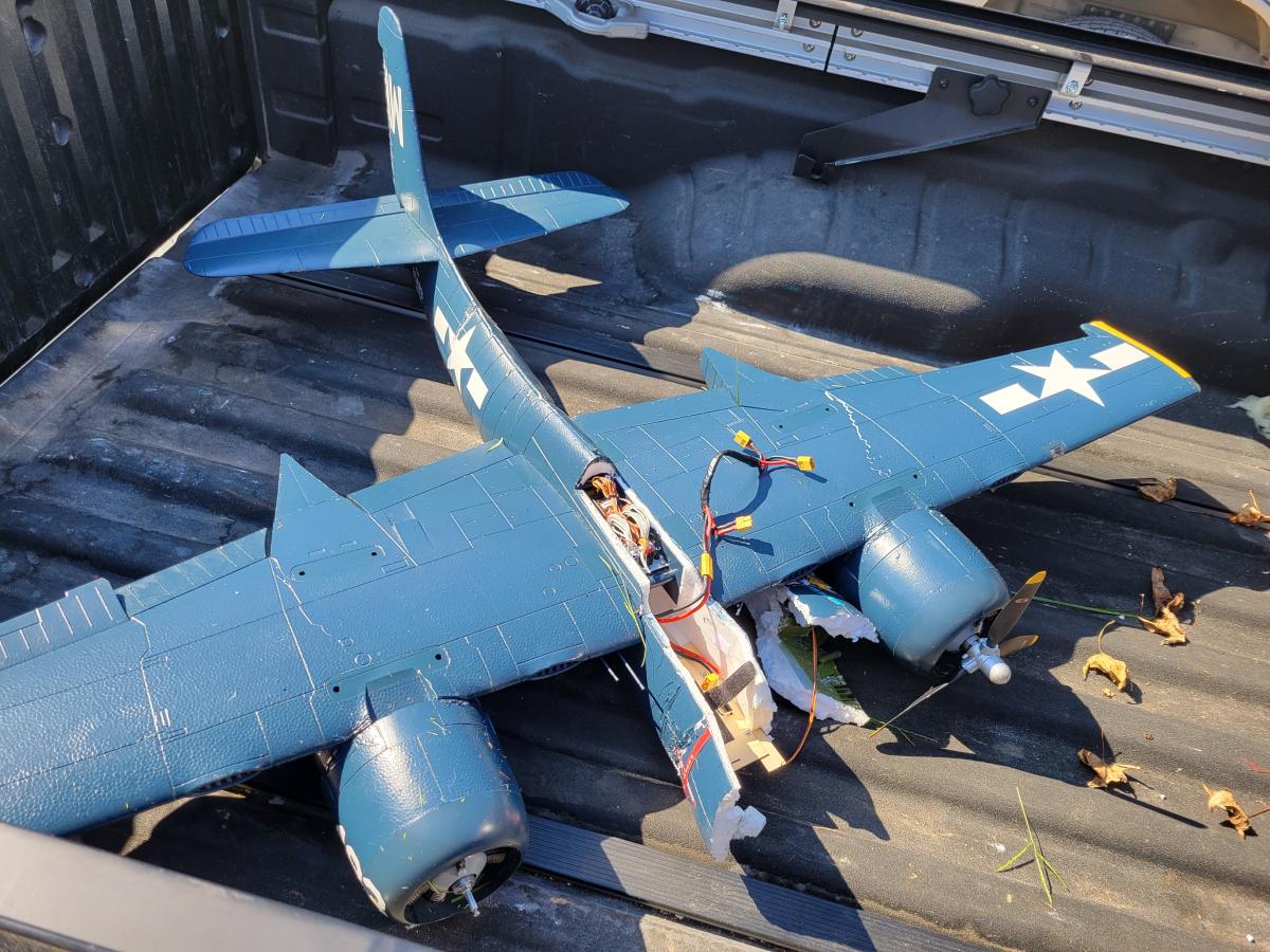

              • Took the T-Cat out for a flight 2 weeks ago and everything was going perfect, until it didn't... I was on downwind turning left base to do a flyover the runway and then drop the gear and flaps. I tried to turn left base, and it would not respond, then she made a graceful right roll into the tall grass. I had no control of it on the way down and I'm beginning to think we have a "Bermuda Triangle" in that corner of our field.
                Overall, I was surprised to see it would be repairable with a new fuselage, nose gear doors, props, and hubs. I had to glue a crack in each wing and repair some slightly crinkled foam on the front of the nacelles. I decided just to scuff sand the entire plane down and respray it along with the new fuselage and then reorder the Callie Graphics. I'm going to replace the Admiral receiver with a Lemon receiver and a satellite and hopefully that will provide better redundancy reception. Just for S&Gs, I had Jeff at Horizon check out my NX10 while at Joe Nall since he had all his equipment and it tested perfect.

                • I'd seriously rethink the LemonRx. I WAS a tried and true LemonRx fan up until last year. I had 3 different models fail in the same spot at the field. All were using LemonRx receivers. From what I hear online (and please take this with a grain of salt!), there was a run of bad LemonRx receivers in the past year or two.
                  When I switched to a Spektrum rx with Telemetry I got warnings that the signal strength dropped off in that section of the field (our Bermuda Triangle). But the difference was that the planes with the Spektrum Receivers didn't loose control like those with the LemonRx.
                  • I'll recommend that whatever Rx you use, do use satellites as well. Big battery packs can hide the signal for a split second. Although most Receivers will pick it up in an instant, there are times when it takes a split second longer. A satellite (or more) is cheap insurance and redundancy. Small 3s jobs are one thing, but as we have moved into higher powered planes, it becomes more of a requirement if you want to have a safe flight. Just from what I've experienced and seen.

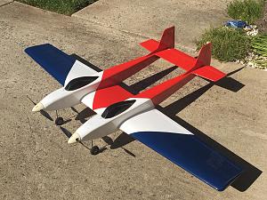

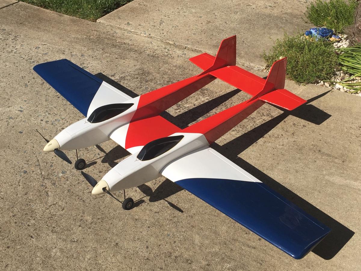

                            • Let me add that just swapping the stock prop to a APCe 2 bladed prop significantly improves performance. You'd probably want a bit more pitch on the prop due to the stock motors lower kV. As an example on the Spitfire 1200mm I went from the stock to a 12x12 APCe and got a lot of performance. The TC has a similar motor to that and would probably do well with the same 12x12. If you do it I would check A's with a watt meter to make sure you are not going too high with the 60A ESC. I used a pair of the TC motors and 12x12 also in this plane. When I did it I used 100A ESCs I had laying around. I think they pull right at 60A max on a fresh charge.
